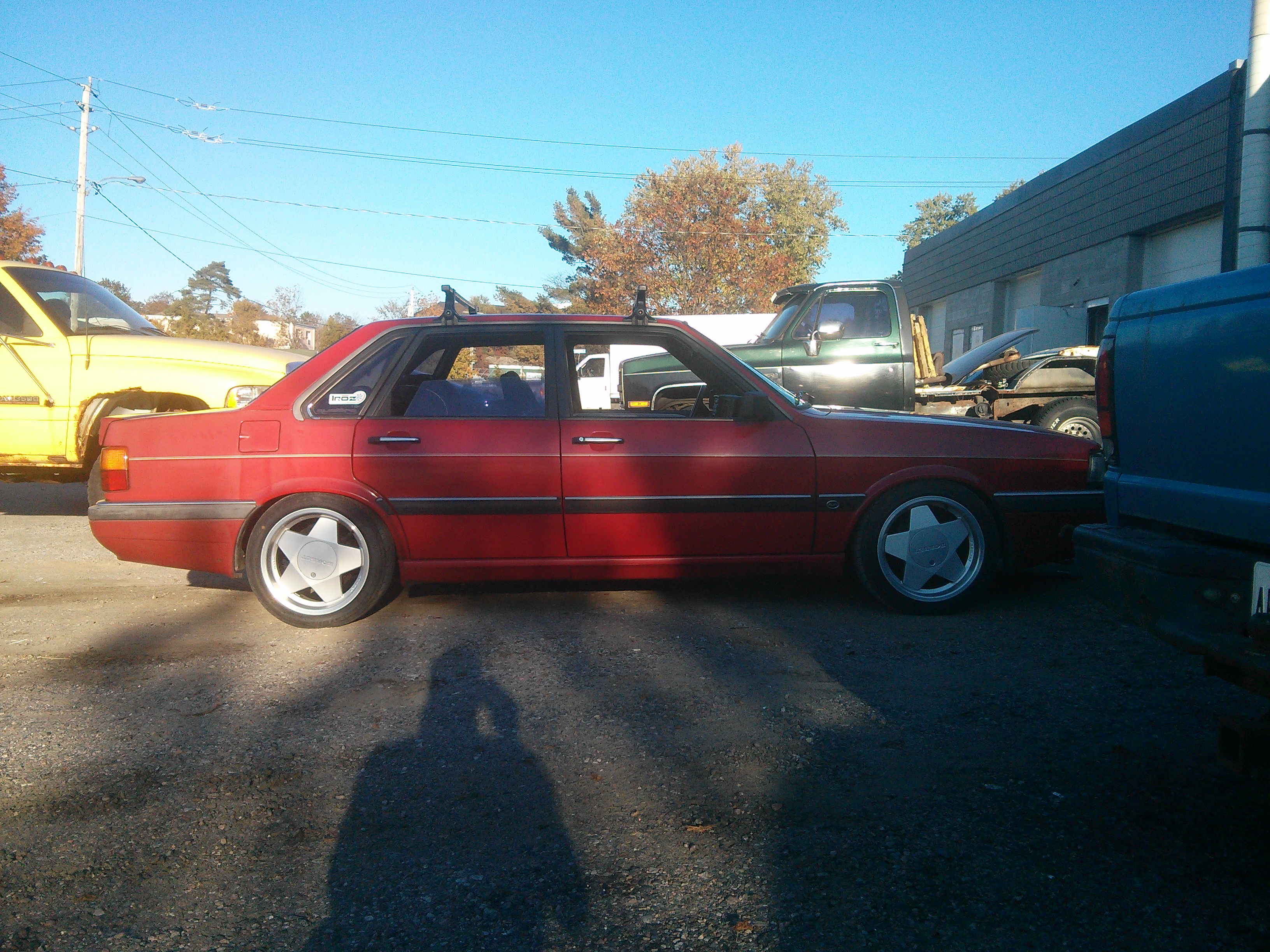

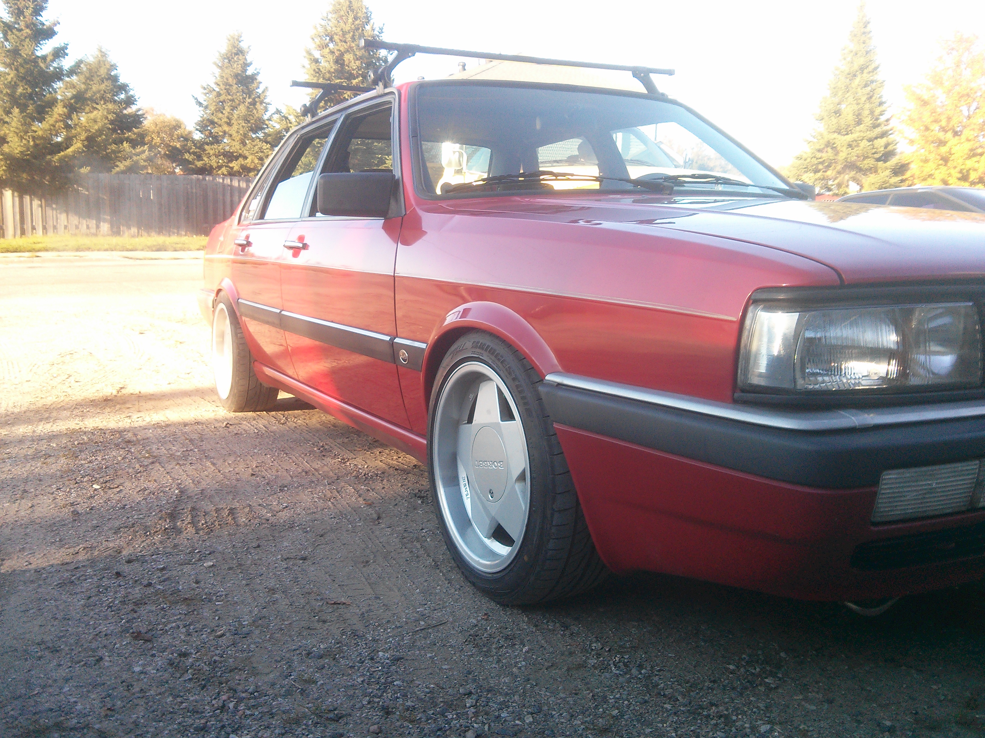

Rolled the fenders today with Andrew (okay, andrew did the rolling, I did the grunt work). no rub! even over big bumps
So my dwell settings are standard. The pulse width in logs appears to be around 10 or so way up at 6-7krpm. And lower down low. I don't know man, I'll post a log. It's time to retire the car back to the shop anyway seeing as how the ignition problem is slowly returning. What the FUNK.

Looks fantastic man!
Re: Matt's 87 4ktq -
Posted: Sat Oct 12, 2013 12:36 am
Definitely looks very nice!

absolutely love the car dude the type A's couldn't look better on your car - hopefully you resist the urge to keep turning things up :).

What a nice car... but DAMN do I hate those wheels...lol :shame:
