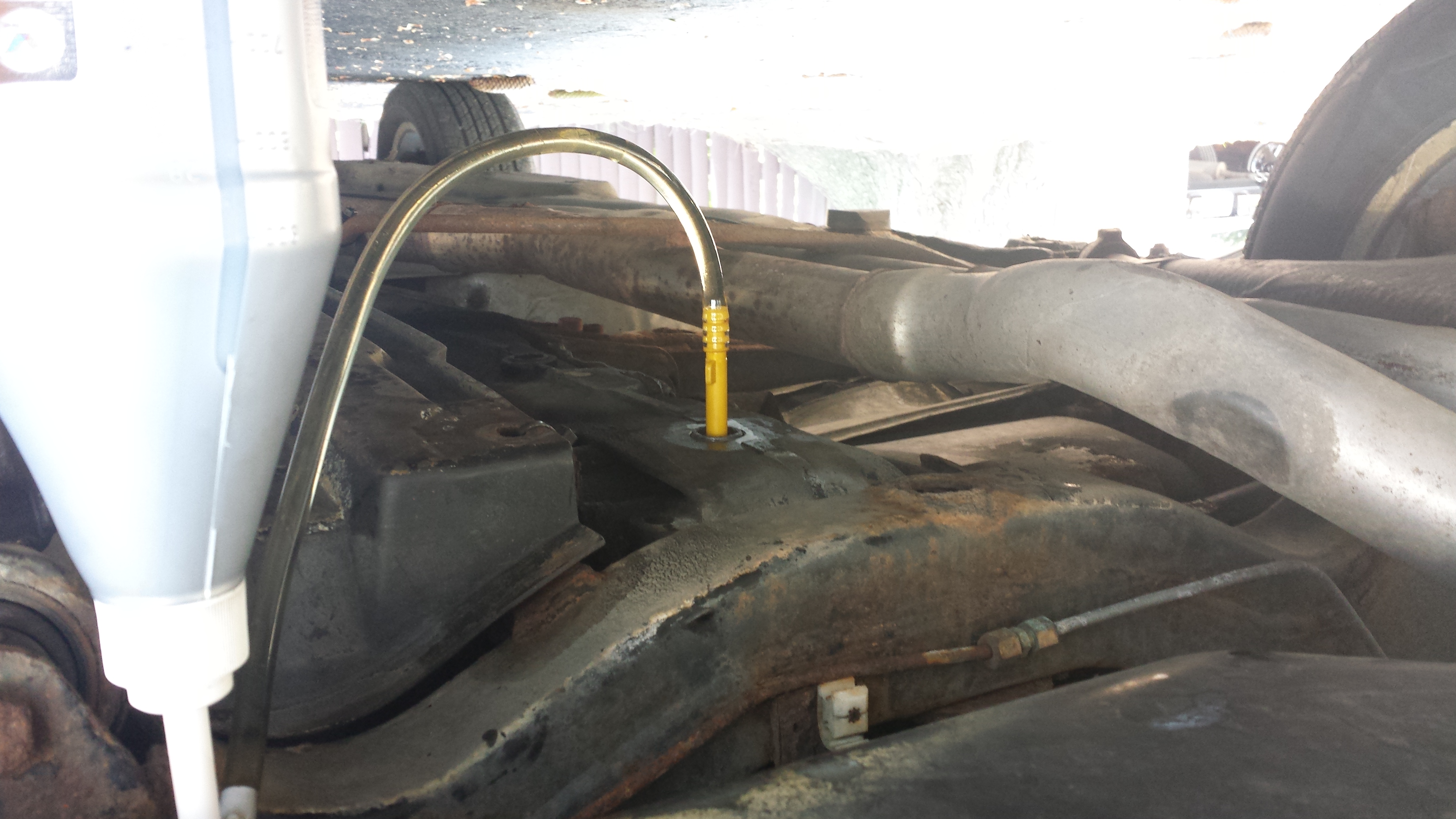

If you're all embarrassed of my methods, please comment lol

Filling the rear diff from the drain?

Good eye Dave. That's the pump I got when I did the 5k's. I love finding tools from the past. It's only $10 for the pump but still, savings.

If it works, do it. No embarrassment here!

How did you fill it from the drain without it all leaking back out?

Drilled/tapped for my Walmart outboard motor oil pump. It has a threaded Yamaha motor fitting which I plugged with an identically threaded hex head bolt. Works like a charm. I put an oil resistant oring on the bolt and then cover in ultra black sealant to prevent tampering or leaks.
