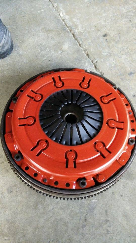

I have been recommended to go 8 puck clutch instead of full face when upgrading the clutch.
Ideas?
Re: B4Q 80-AEB; 8 puck or fullface clucth?
That's bad advice in my opinion. A full-faced clutch will give much better driveability and will hold almost any amount of power when selected properly. Go Southbend full-face and never look back!
I'm with Chris on this one. I have a spec Stg3 6 puck in my 80q, and it is very on/off. I'm thinking when I install my 01E I will be getting a full face to put in.
Posts: 875
Location: Bangkok, Thailand
Post by ChrisAudi80 »
Yeah, that is what I thought. I will get the clutch done locally as importing one is way out of my budget. Its 200 bucks local.
Importing one would be more than double.
Full face it is.

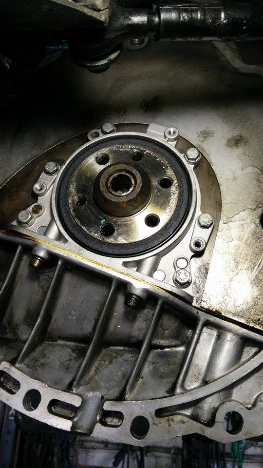

Re: B4Q 80-AEB; clutch work started!

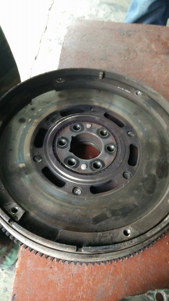

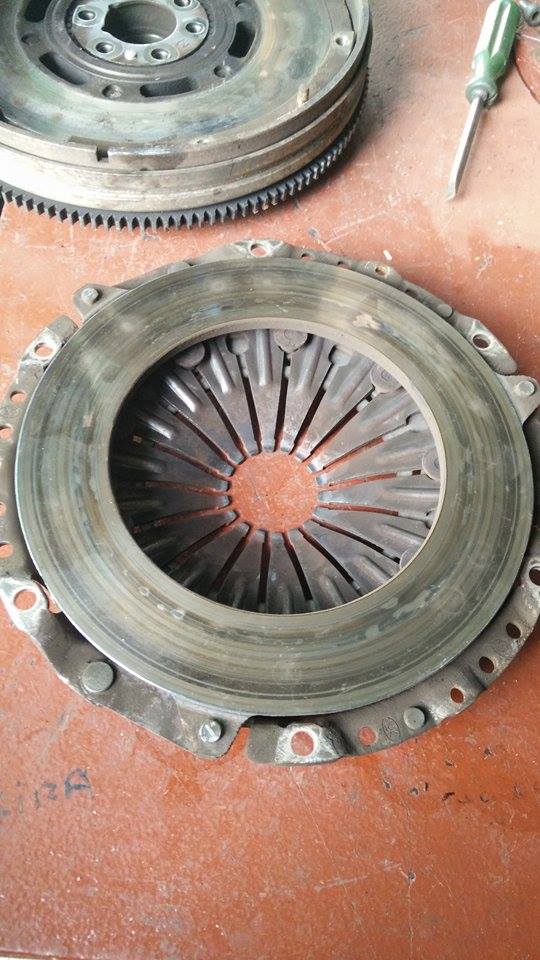

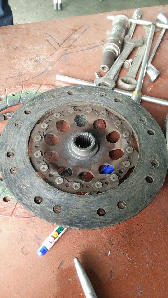

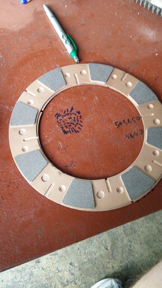

Dropped the FW and clutch package off at the shop today.
My trans has code DJJ, BTW. According to the manual it has final drive 3.889, but it should be 4.111. The rear diff is 4.111, so it must be true.
The new friction discs will be swapped over onto the original disc. This shop is used by all the local diesel drag truck guys. Friend of mine has used them before for his AEB and vouches for them.
Surfaces will be cleaned. Oil all over the bellhousing due to leaky rear main seal. The TO and pilot bearing will be replaced, too.
Some pics.
stock FW.jpg (63.98 KiB) Viewed 66926 times
pressure plate.jpg (90.74 KiB) Viewed 66926 times
new friction discs.jpg (77.68 KiB) Viewed 66926 times
friction disc.jpg (91.06 KiB) Viewed 66926 times

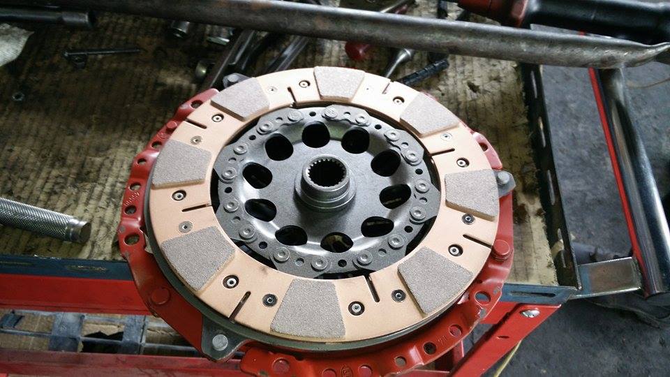

Clutch was done sooner than expected. It is being put in today.
However, we found out that one of the drive shaft CV joints was bad. The rubber sleeve was gone and the CV almost dry! :bangshead: Managed to find another.
Also found out for sure that I don't have 4.111 final drive at all. :shame: Its 3.889. Trans code DJJ, rear diff code DAJ.
Tomorrow: :drive:
Now: Pics
new rear main seal.jpg (88.89 KiB) Viewed 66872 times
new friction discs mounted.jpg (88.04 KiB) Viewed 66872 times
new clutch assembly.jpg (80.9 KiB) Viewed 66872 times

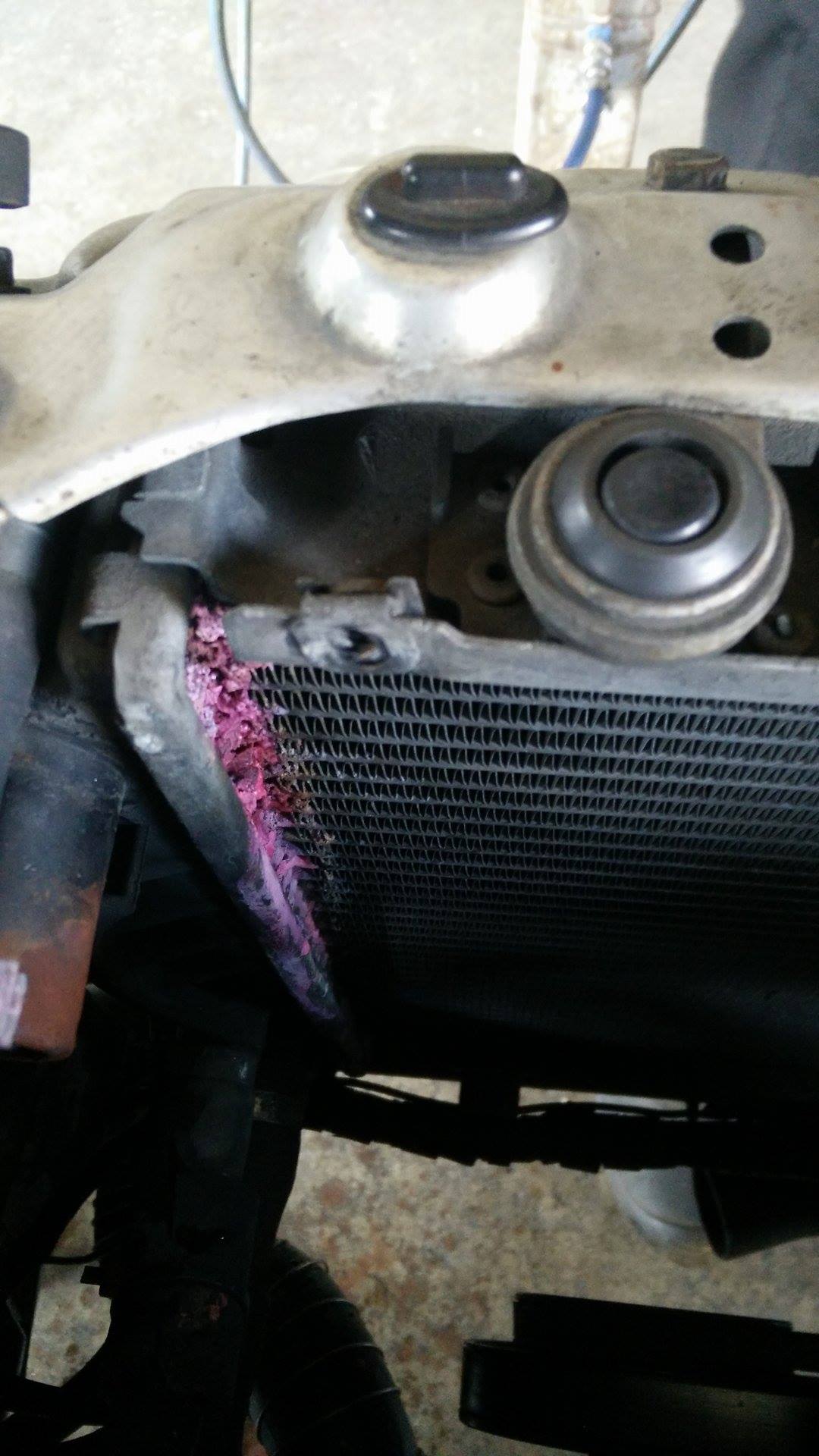

While doing the timing belt service, I ran into another issue. Leaking rad. Not the end tanks, but still wanted to replace it.
Turns out getting a custom made all alloy rad made here is cheaper than a Nissen replacement rad with plastic end tanks.
Installed a catch can, too.

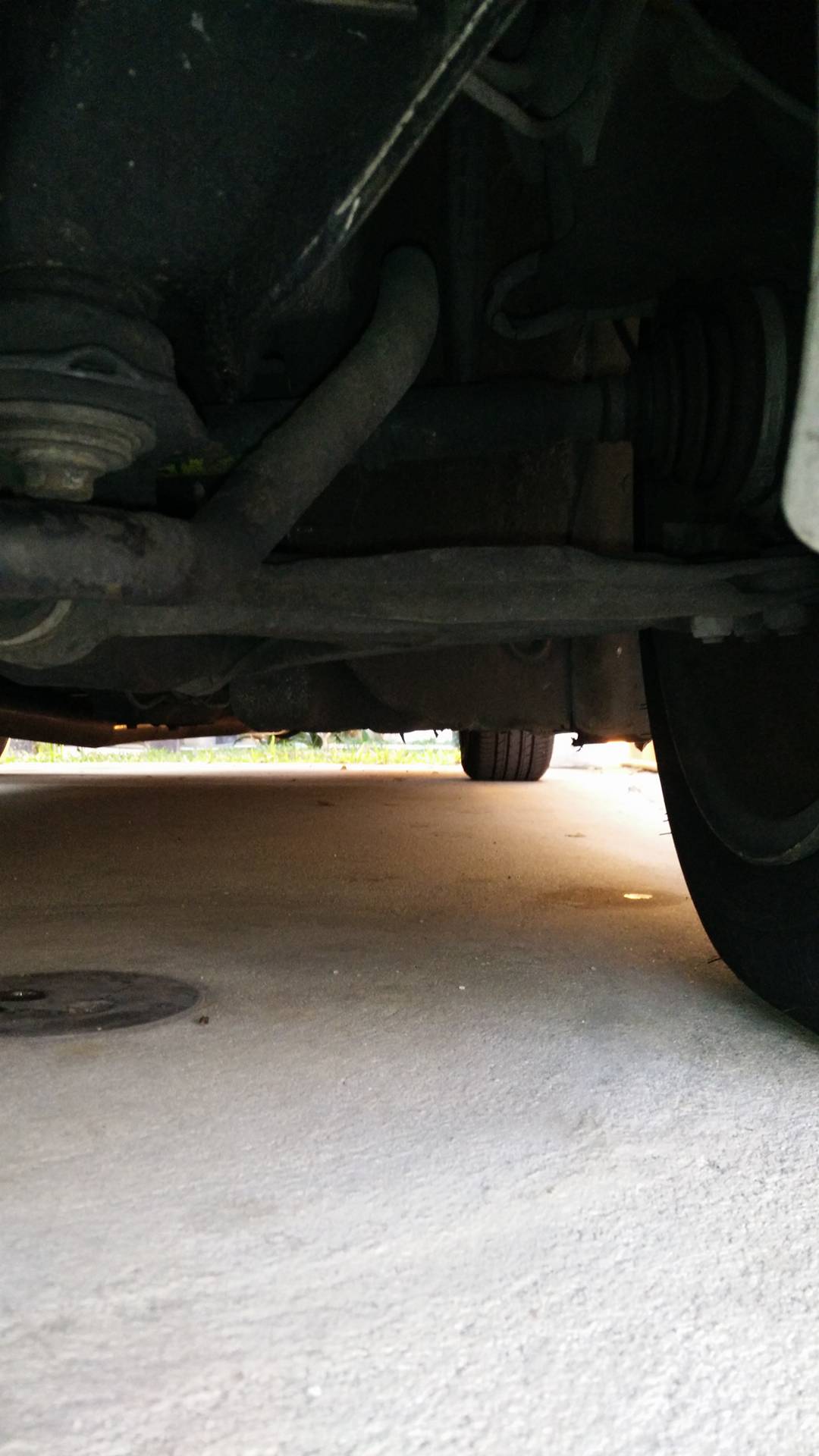

From now I am going to focus more on handling. It does not have the optimal set up now, but I should be able to improve it.
I have Weitec springs (-40mm) and KW shocks in the front and the stock B5 1.8T sport springs and shocks in the back. Getting a dedicated spring and shock set (never mind coil-overs) for this car right now is out of budget.
However, since this car was a 4 cylinder, it did not come with a strut bar like most V6s. I have a spare C4 strut bar and will probably just get some brackets fabbed up and welded in. That should help some. This car does still roll a bit in cornering. I can also turn the wheel quickly about 20 degrees off center while still going straight.
After that, it might be a good idea to replace the old control arm and sway bar bushings all around. If Jared H. goes ahead and makes a full set for the B4, I will go for that.
Now, ball joint extenders. A buddy of mine here has had some proper ball joint extenders fabbed up for his lowered UrS4. As far as I can tell, B4 ball joints are also 19mm. My front control arms do point up a little. Worth it?

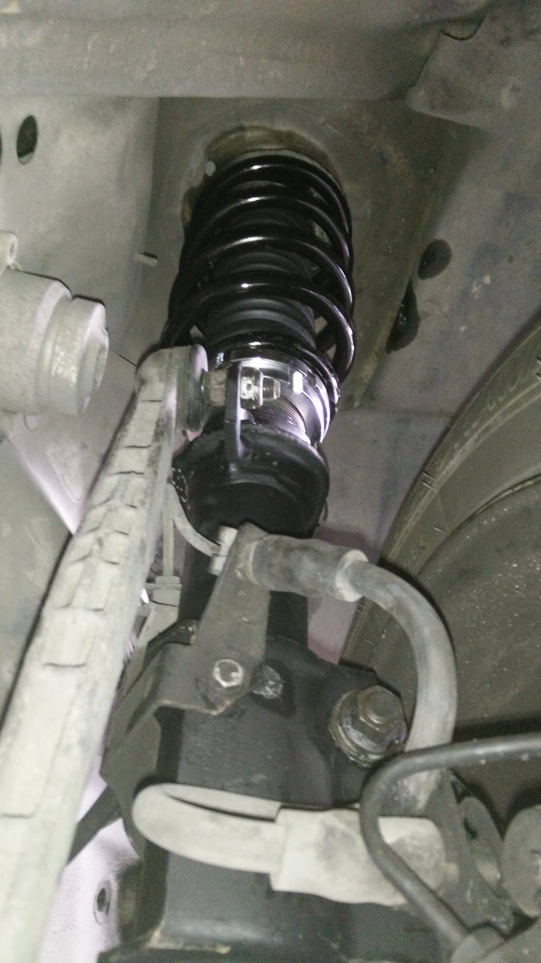

Re: B4Q 80-AEB; Custom Coil Overs!

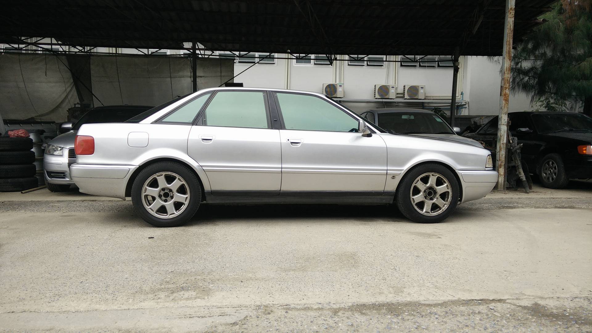

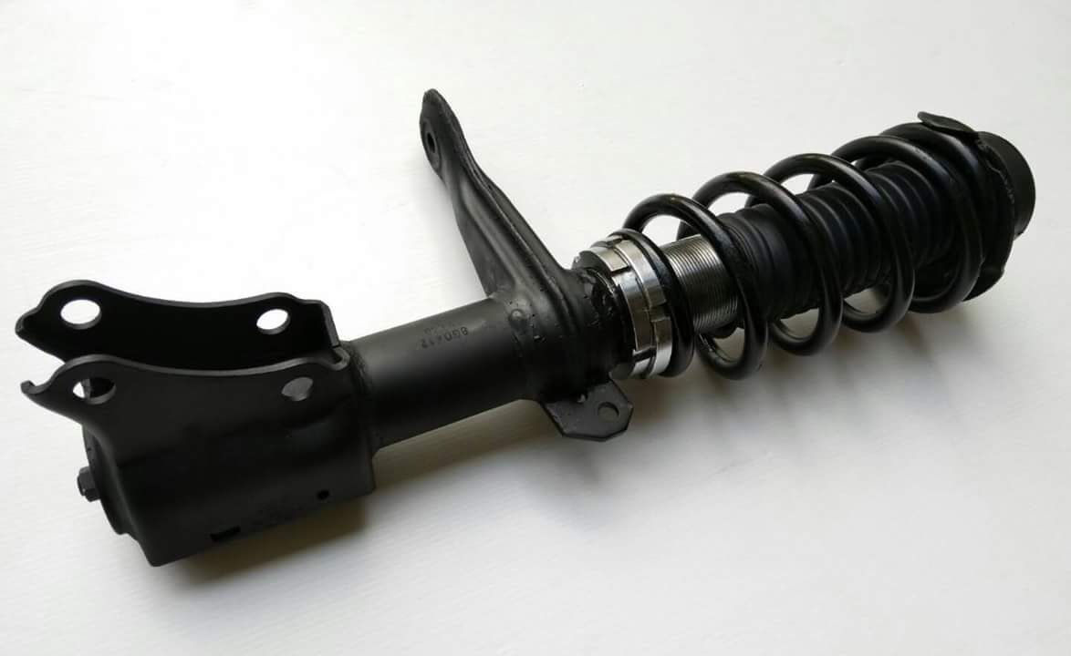

Picked up the car from the suspension shop today!
It now has custom Monroe coil overs. Don't know the exact specs. The ride is firm, but not harsh. A tad higher than before. Way better than the mismatched set up I had before (Weitec springs and KW shocks front, stock B5Q sport springs and shocks rear).
I post a side view picture later. Forgot to take that.
Pics.

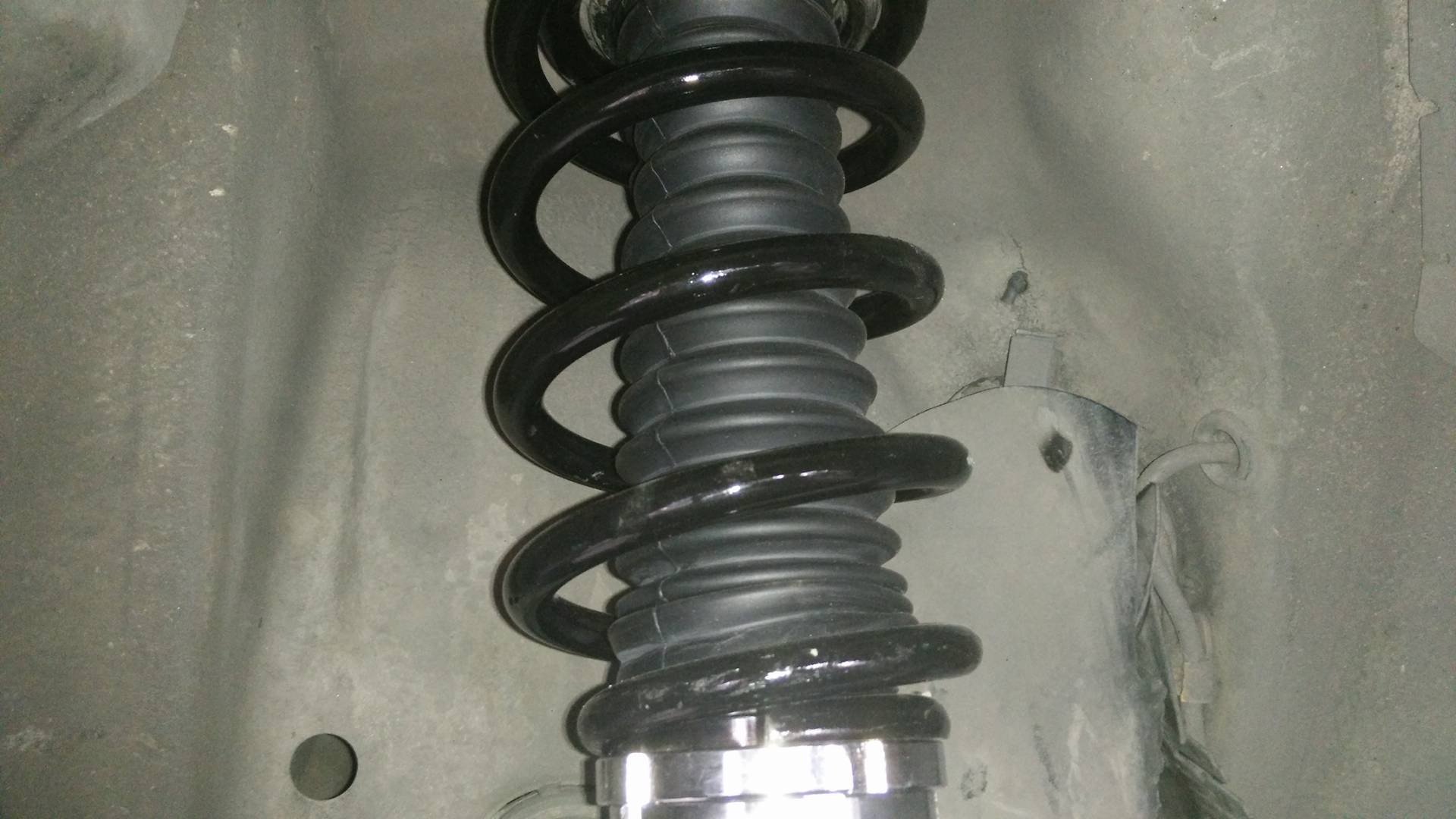

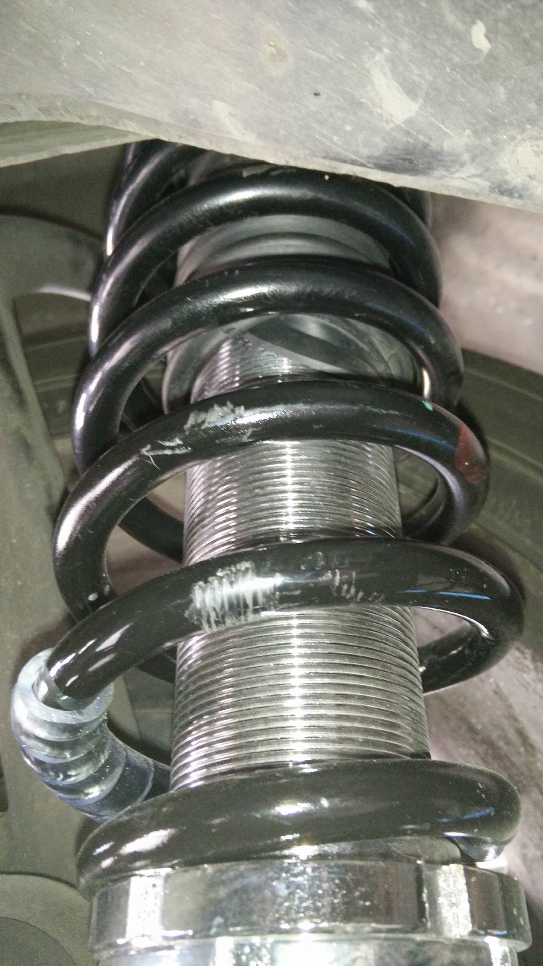

Posts: 875
Some more pictures.

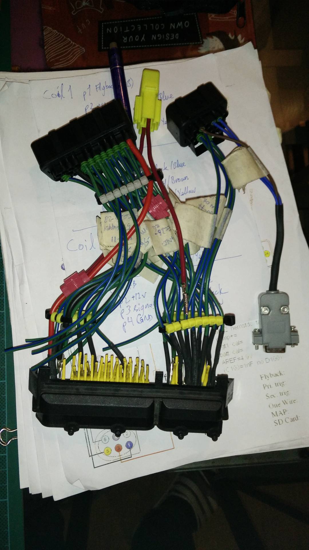

Been working on making a EconoSeal to Motronic adapter. The Jake W adapter sheet has been very helpful. Making it was fun. Got a lot of help from my teacher/buddy Kot.
Decided that having to route through the firewall a fully terminated harness meant for a VW 1.8T was too much hassle. I did have to go through the harness to check the pin out. That was very educational.
So now I have to try and sell a very nice Lugtronic-made VEMS harness for a 1.8T.
I know the dust plugs are not all the way in, but the wire was just a little too thick. I will have to route the wideband harness through later. I also have an EGT probe I will wire in.
The car is now back to stock power (besides the AAN injectors and E85), no more piggyback. Its soooo slow now. :shame:
