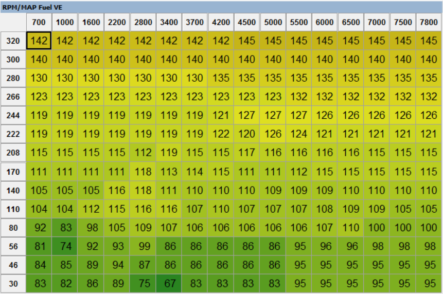

I used the live VE analyzer today on 2 separate occasions to tune the low rpm blocks. I REALLY like the autotune function but may use it less in the future as I get more into the setup and software. Heres a snap of my VE table.
I have three concerns/questions: first, on the base tune, is knock due to ignition timing a concern on the base spark timing map? I haven't changed it at all so far. second, no matter what I change my req_fuel value to, whether it be 6.2 or 7.5, the car just wont start (as far as I remember) unless its set to 6.1. I know I need to change my VE table to accommodate the change in that value too but it seems very sensitive on my car. You can see I had to completely revamp the stock VE map values to something less scaled down. I used Phil's map as a sort of ratio interpretation for both ends of the spectrums like with lowest and highest RPM values, then used the differences and added them to my low values. Turned out quite well, except I know my base map shipped out with 7.5 but it wont start on that. Lastly, with my idle control, currently I have BOTH ignition based idle control and idle valve control activated. Without the ignition based one turned on, the idle goes up another 300 to 400 rpm to around 1800 RPM when the valve is activated. Before getting the flywheel repaired it was around 900. I have the warm idle set to 900 with 250 hz selected now but it still only gets as low as 1200 when warm with only the ignition based idle turned on. When only pwm idle valve is turned on, it still wont go any lower that 1400. seems odd. Any pointers people? Heres a snap of the ignition based settings that I believe I pillaged from one of Marc's old S2 forum posts to a gentleman inquiring about it. Thanks for all your help so far Marc and everyone else that put up with my b#tching so far lol. Although, I feel it was warranted and public interest needed brought to the table even if it hasn't swayed them yet... TIA
