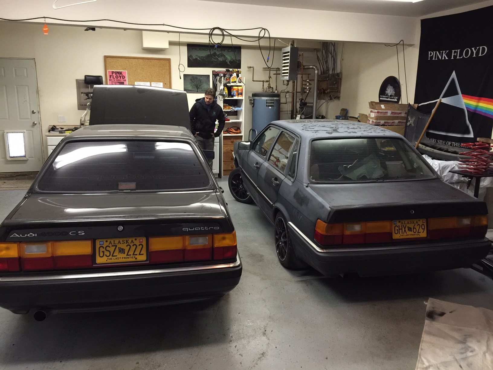

Making progress on the 3b conversion on my buddies quattro
- Chaudi.jpg (76.87 KiB) Viewed 51897 times

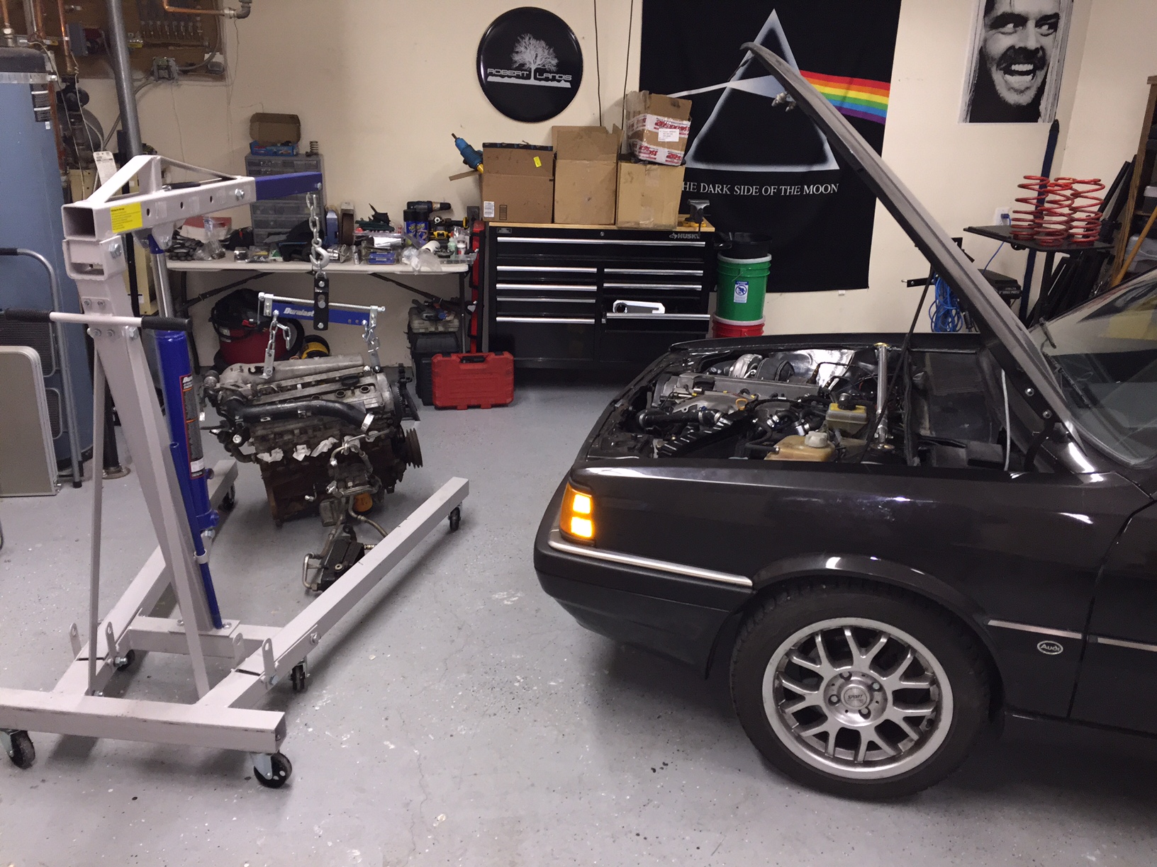

Apprently since my last post I have gotten some stuff done.
3b swapped a 4K we brought back to life just prior to the owner junking it.
Swapped out the old grey cloth with some Quattro script we found in another car about to be junked as well....
Then we swapped the motor and did a Gt3071/RS2 EM/IROZ Exhaust ect... swap on my brothers S6 avant. The motor that was in it was done. Heavy scaring on #5 cylinder and pretty much all valves in the head were loose to the touch with major surface damage in all the domes.

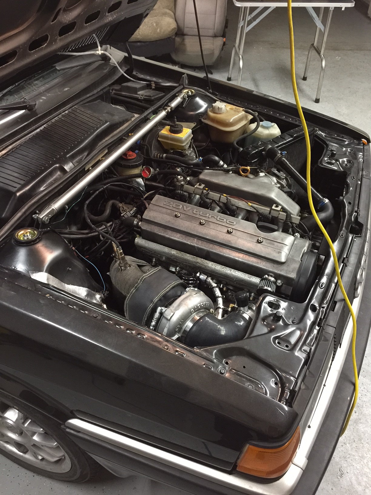

Audi S4000 - Alaska
Some more random pictures of the last 8 months or so.
So much head
Full Hersh performance upgrade with HR springs and Bilstein HD shocks.
The only laminar flow MAF setup for the S4000 that I could come up with in that tiny bay.
3+ in the S4K
Low mile AAN ready for install into the S6 Avant brought to us from the boys at 2Bennet. You get what you pay for.
Marc Swanson actually sent that beer with this little package, that guy is a genius.
And my dogs, "4000" and "Quattro"
