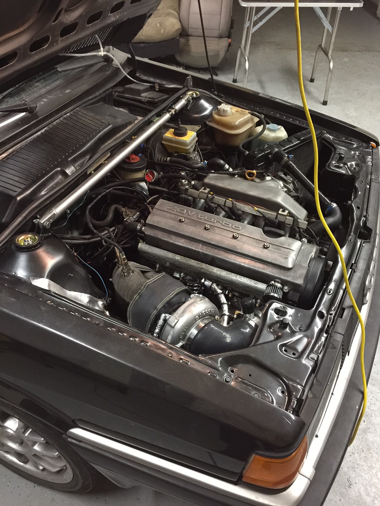

Here is a pic of the strut tower brace we installed on my 4K
4k strut tower.jpg (548.53 KiB) Viewed 52034 times

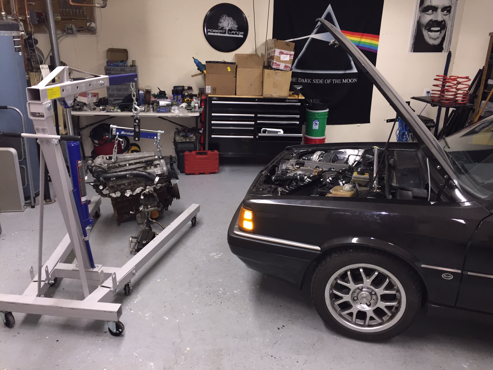

Started working on a little more tame (for now anyways) 4K AAN for the wife to drive :)
Anyways, this white 4K has about 30 years of grime in the engine bay. I've spent more time cleaning shit then actually building. Here are some pictures.
Brought it inside for the first time in a while. I finally got all the details dialed on the black 4K.
Pulled the old power horse out.
Lots of cleaning-not very fun but I did have Opeth and Tool to keep me company as well as some Neil D. Tyson and Joe Rogan.
That hood though....
