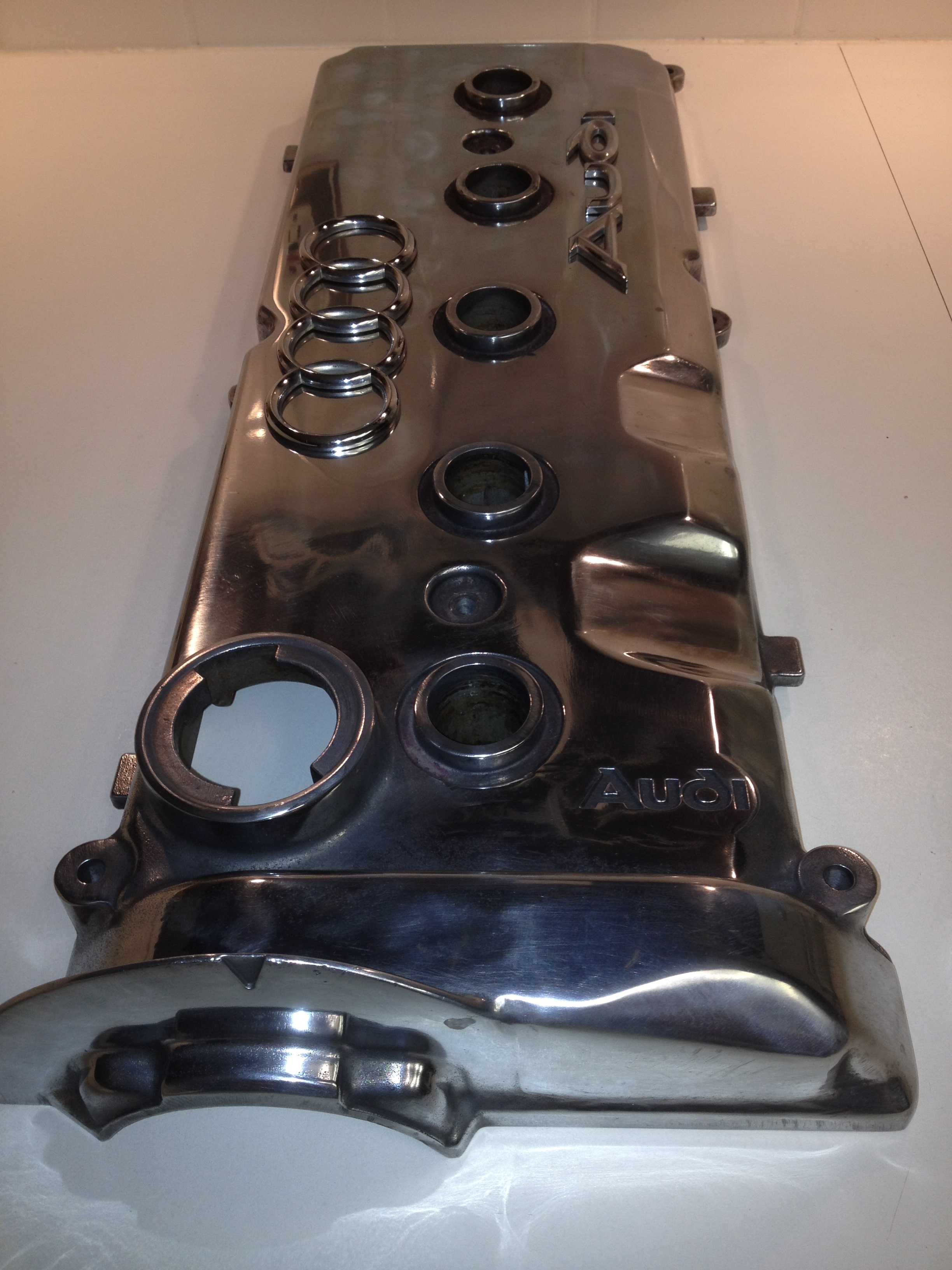

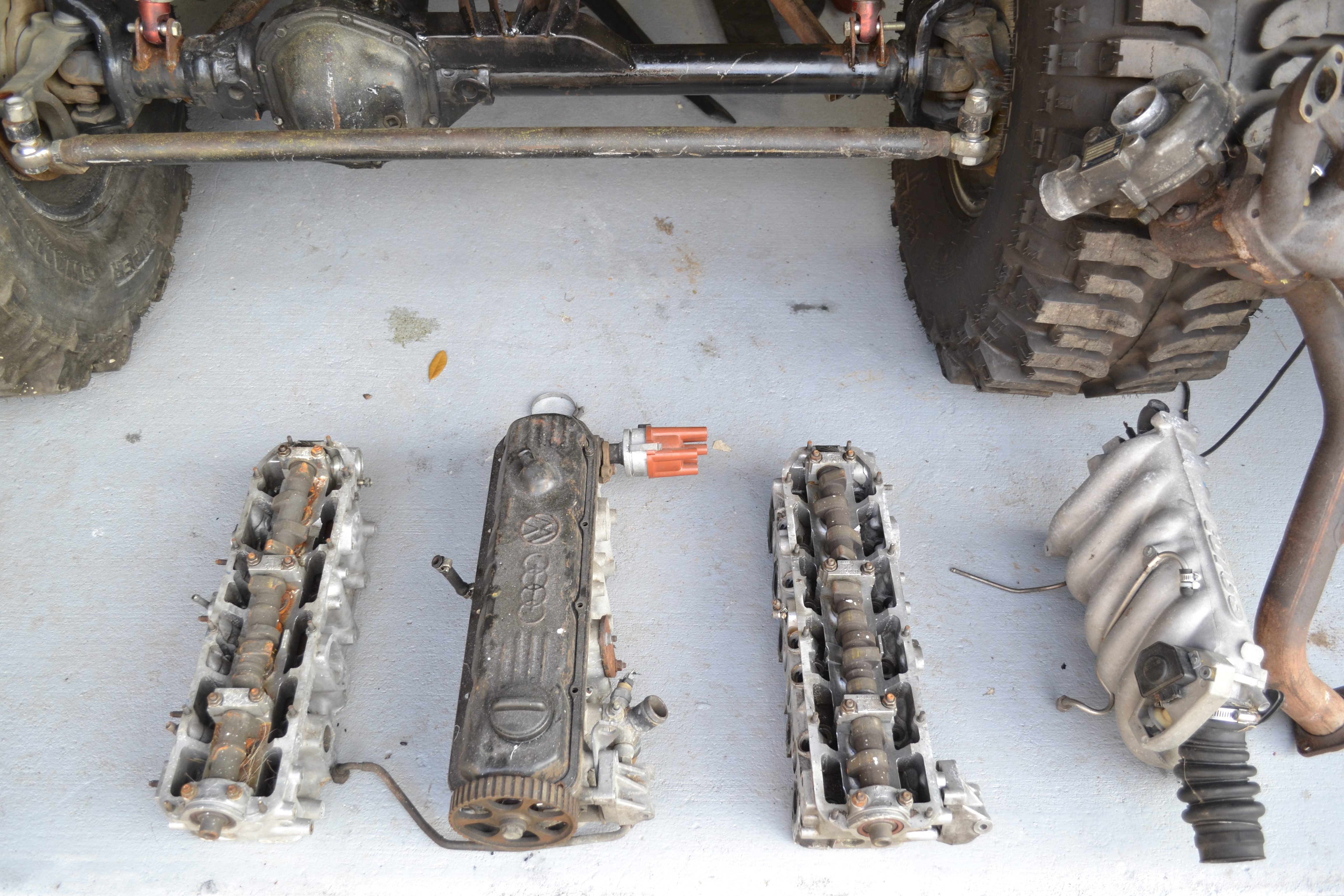

this looks a little better than when I started. I had to take the cooling fins off to make it easier to polish.
Ideas for valve cover..jpg (1.64 MiB) Viewed 42473 times

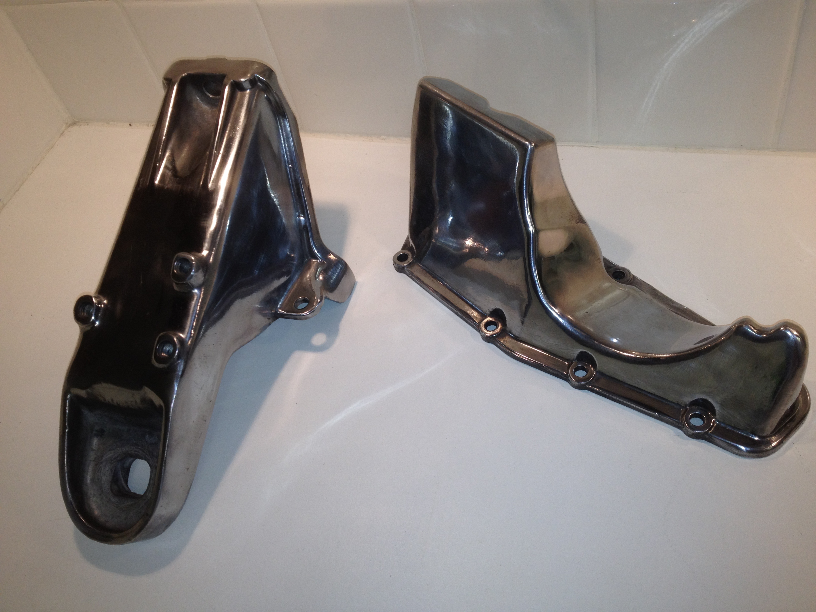

random pic of motor mount and 7A oil pan side pouch.
motor mount.jpg (1.62 MiB) Viewed 42473 times

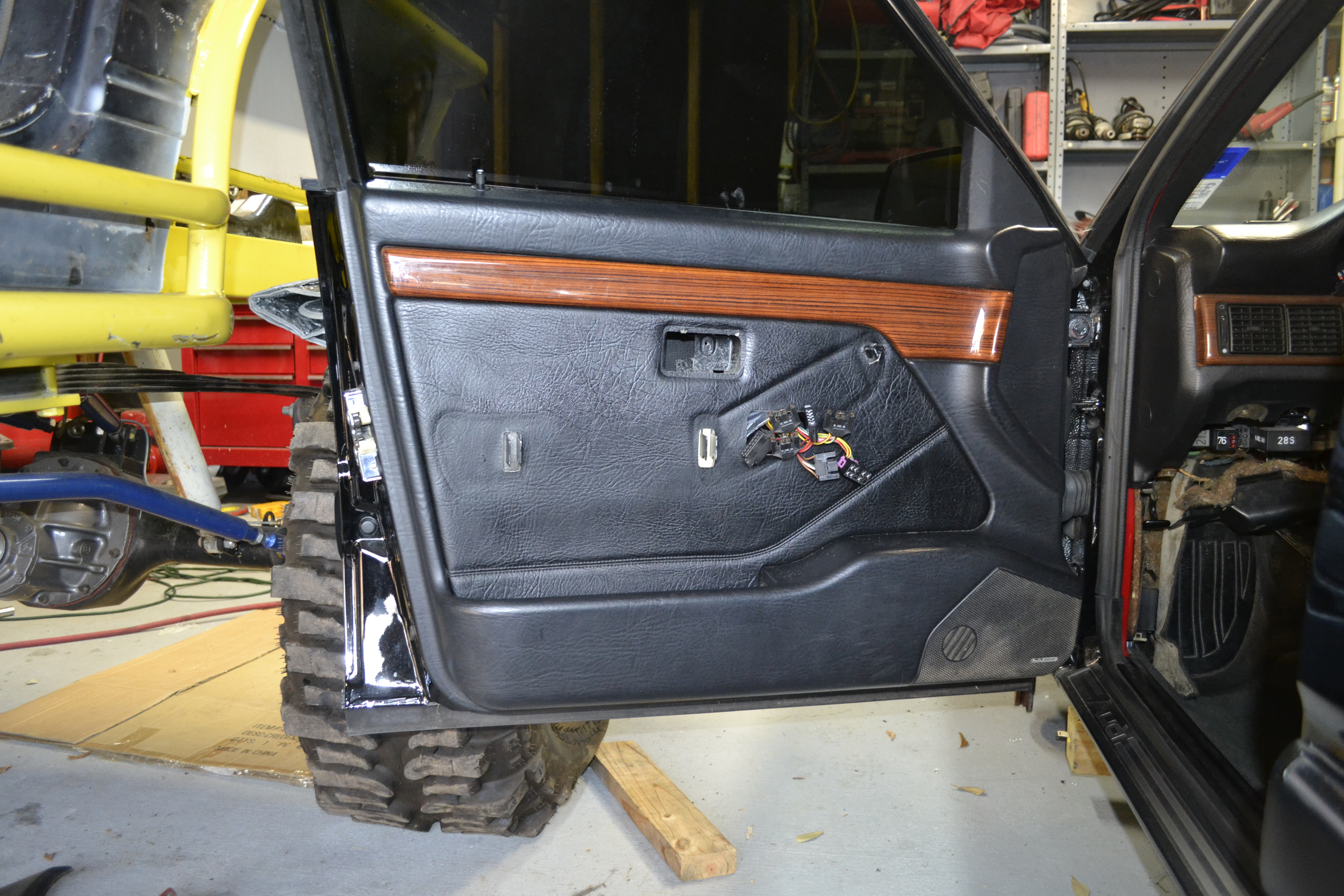

I'm working on converting my door cards to the 200 Bose door cards with the ported boxes. My car originaly came with two tiny speakers in the dash and two in the rear deck. It has got to improve the sound and still keep it factory looking.

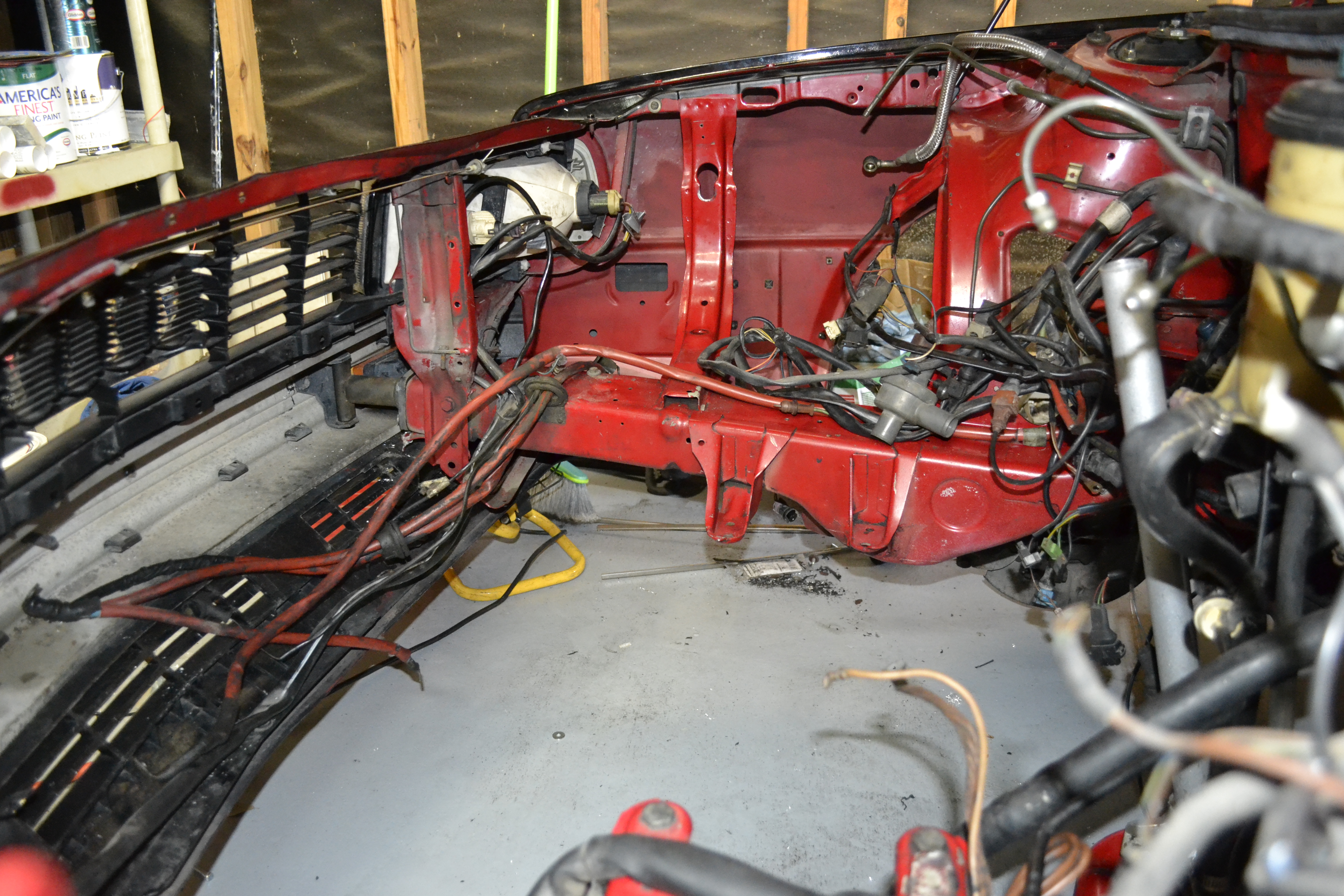

Another project I am working on is cleaning up the engine bay and seeing if I can re-route some items to open up some space and take the clutter away. I have decided to do without the ABS module and that huge bracket. I also want to get rid of the hydro boost or whatever the proper term is for it. There are brake lines everywhere and I can't even stick my hand down in the hood because of all of the brake lines in the way. That will definitely get simplified. I will do a big brake kit and convert to a vacuum brake booster. I just hate hydraulic/oil leaks! :mad: I'm thinking I might add some porportioning valves mixed with small residual valves to help with the small master cylinder to keep line pressure at the pistons.

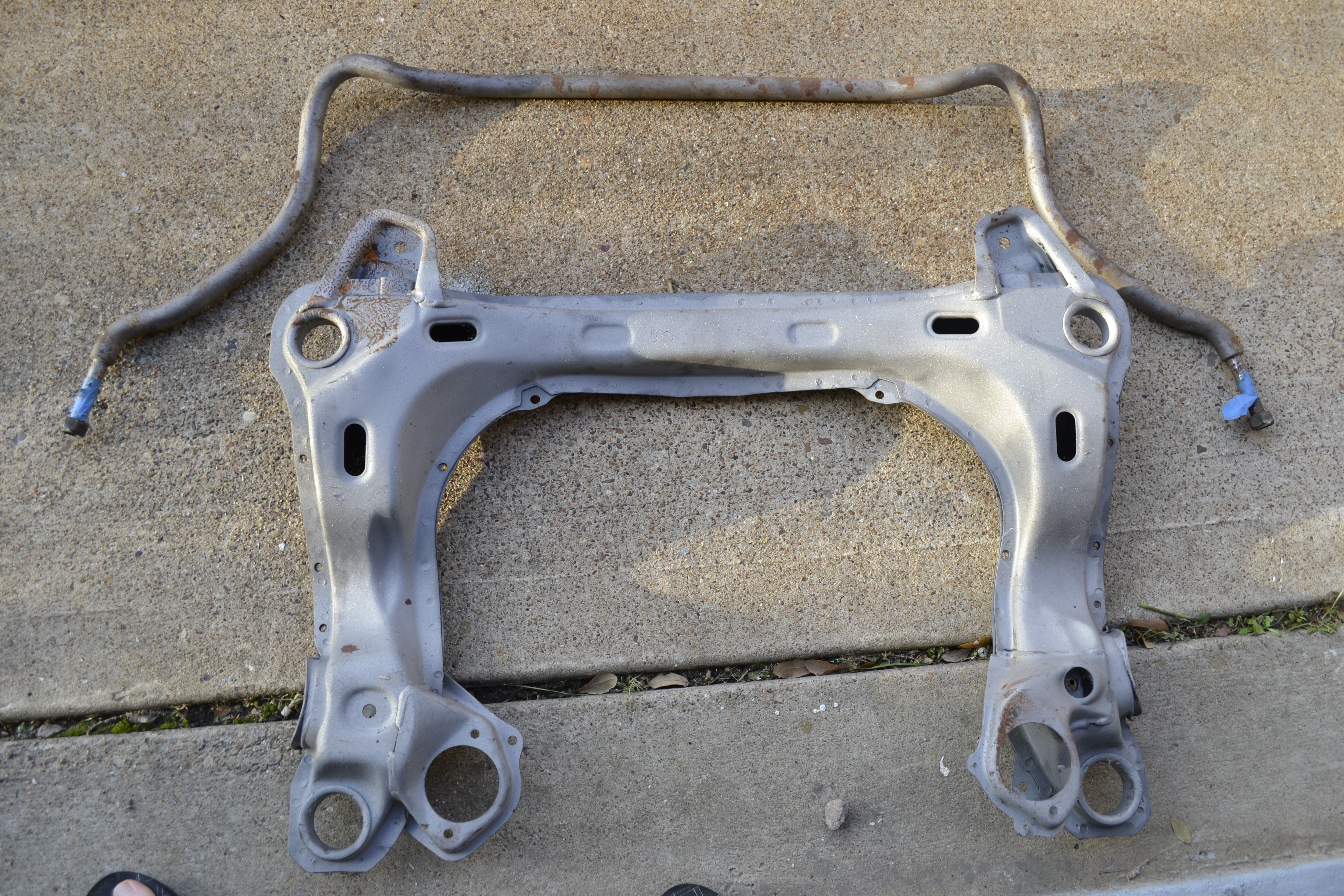

You can probably tell that I like things to be cleaned up before going back in... I'm also sand blasting my sway bar and ''K frame"... I think that is what it is called... or engine craddle? Anyway... I am sandblasting them and getting them powdercoated. I don't know what color yet. I was thinking silver or red since the bay is red. I like brighter colors because it makes it easier to see under the hood and all the different components seem easier to identify and single out. I don't like everything to be one black camoflauged blurr under the hood.

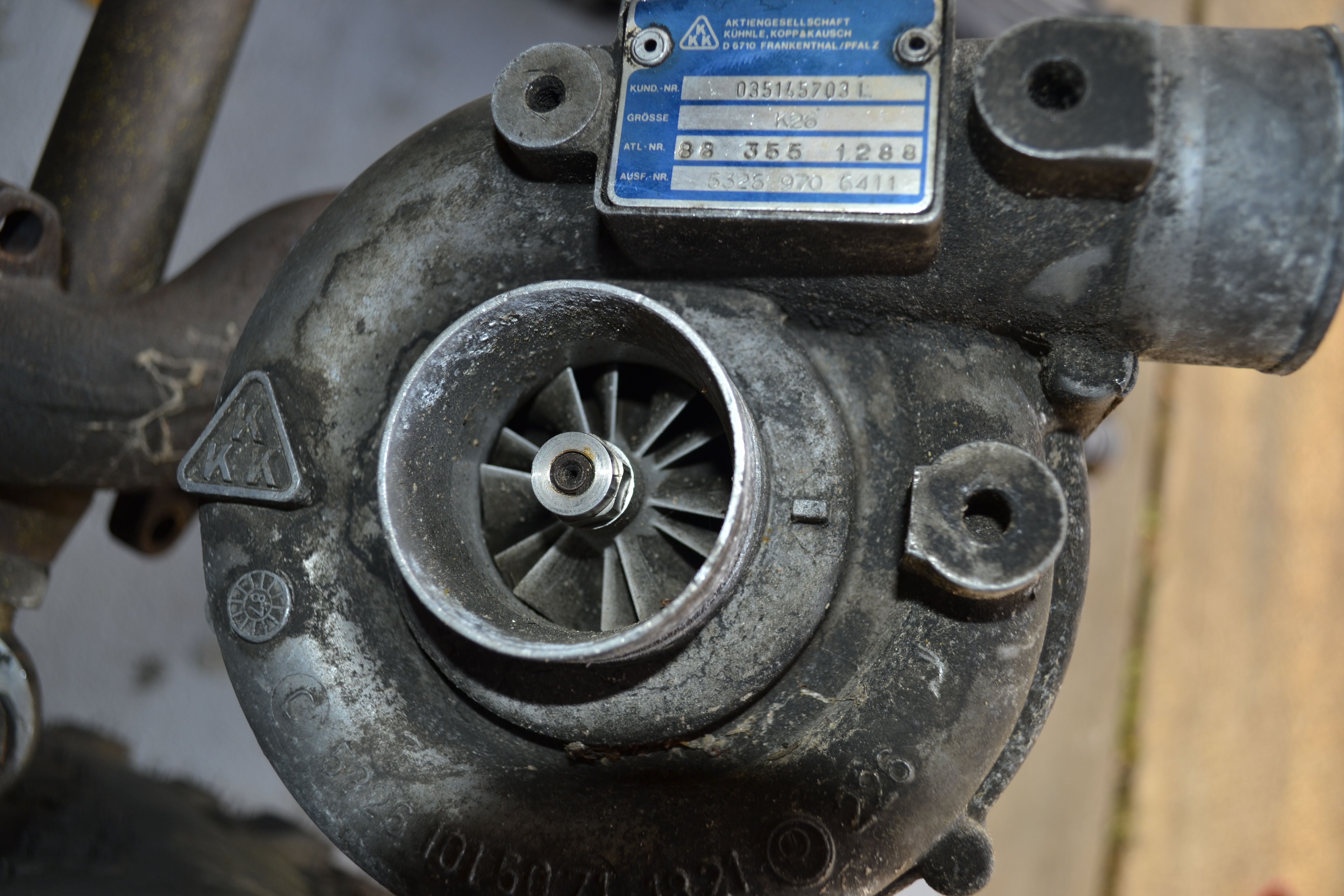

On my phone right now but I need to message you about the turbo. Mine is smoking more and more. And possibly the head

Ok, just send me a message and I will reply with detailed pics of heads and turbo. Back in the day when it was my uncles car, he was always doing things with the waste gate and soldering some of his mad scientist stuff to the ECM... He was always bowing head gaskets. We would hit every junkyard in the houston area grabbing what we could of of them. We grabbed an extra head to experiment with porting and different valve jobs. The one in the picture with the valve cover and distributor was the last current head I was driving with. It was making great power but I had massive problems with the fuel injection and pulled everything out as you can see in the pictures. The turbo was making decent power too when I was getting fuel. I can check it for shaft play. I have been lugging these parts around for at least 5 or six years.

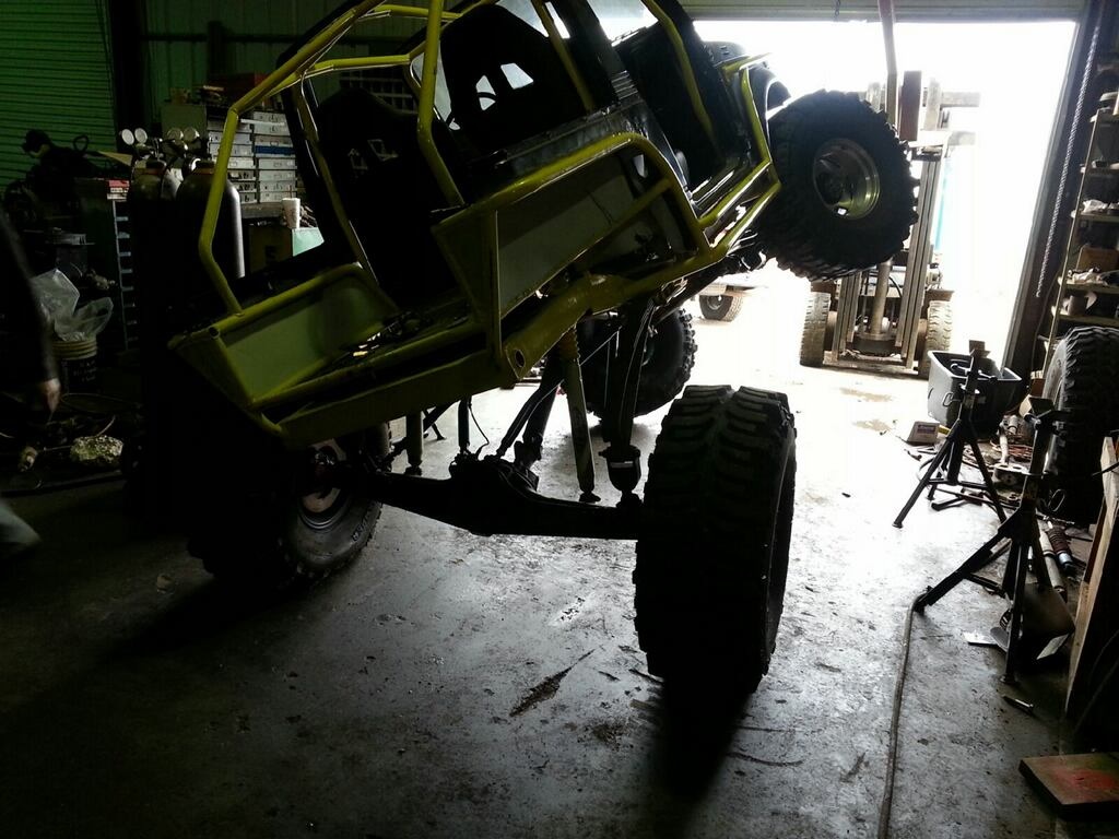

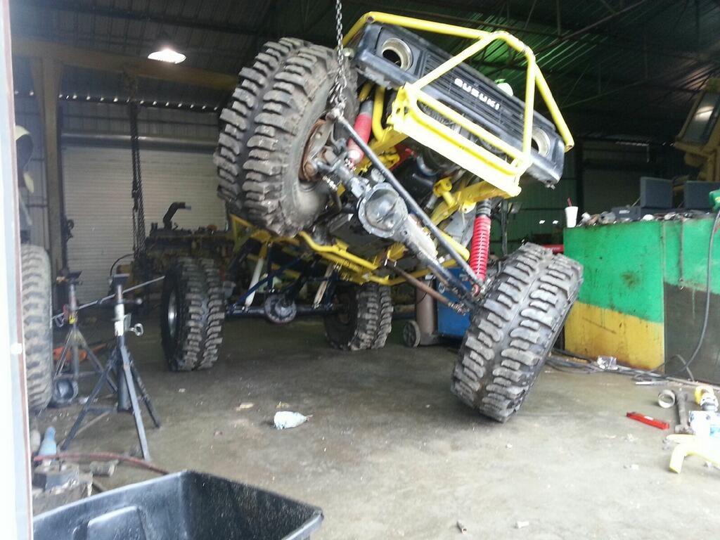

Here some newer pics. Checking the flex and making sure nothing binds

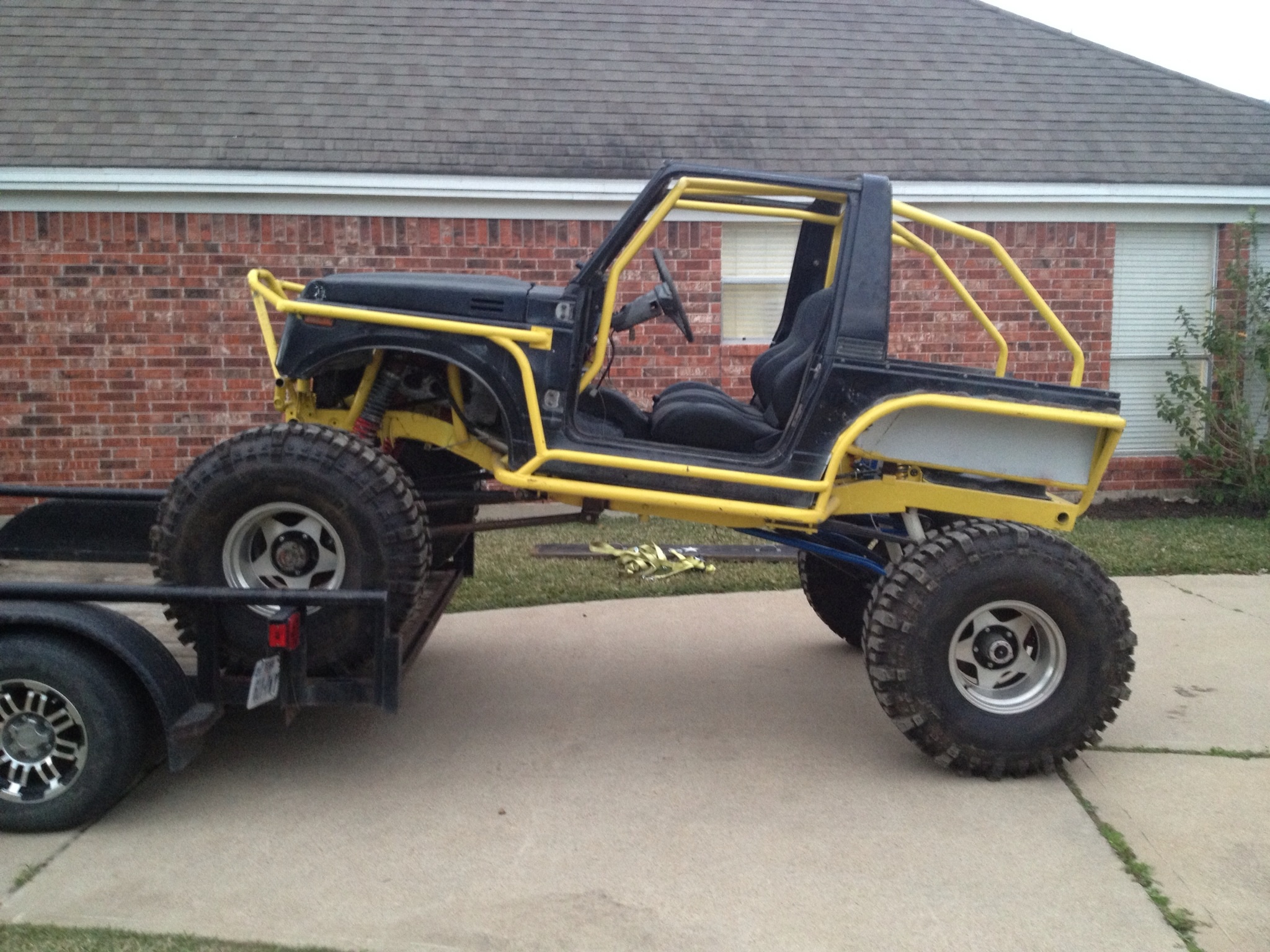

It is a creature of many makes and models.
88 samurai body
Full age and I can still put the factory top on.
Chevy 4.3 fuel injected V6
700r4 automatic
Dana 300 transfer case
Advanced Adapter
Ford 9" rear housing shaved on the bottom for extra clearance, trussed for extra strength, full floating Warn hubs, Spooled, Dodge 3/4 ton discs with Monte Carlo calipers, 5:13 gears
International Scout Dana 44 front axle
Painless wiring
Optima battery which is the one I was telling you I have had for about 6 years now
38.5" Boggers
