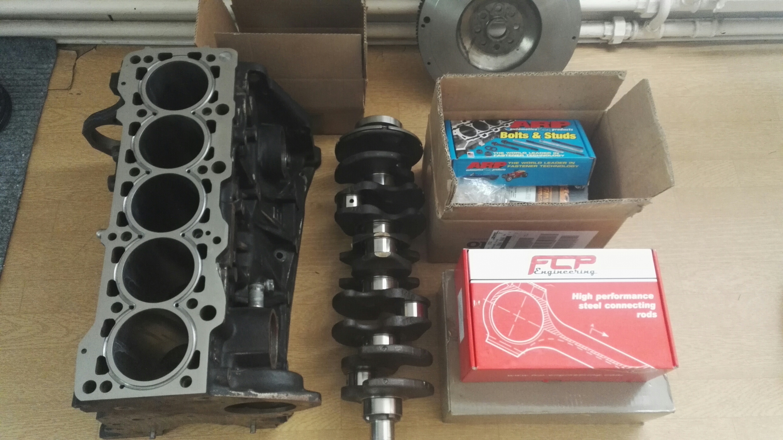

The stroker engine is slowly coming along!

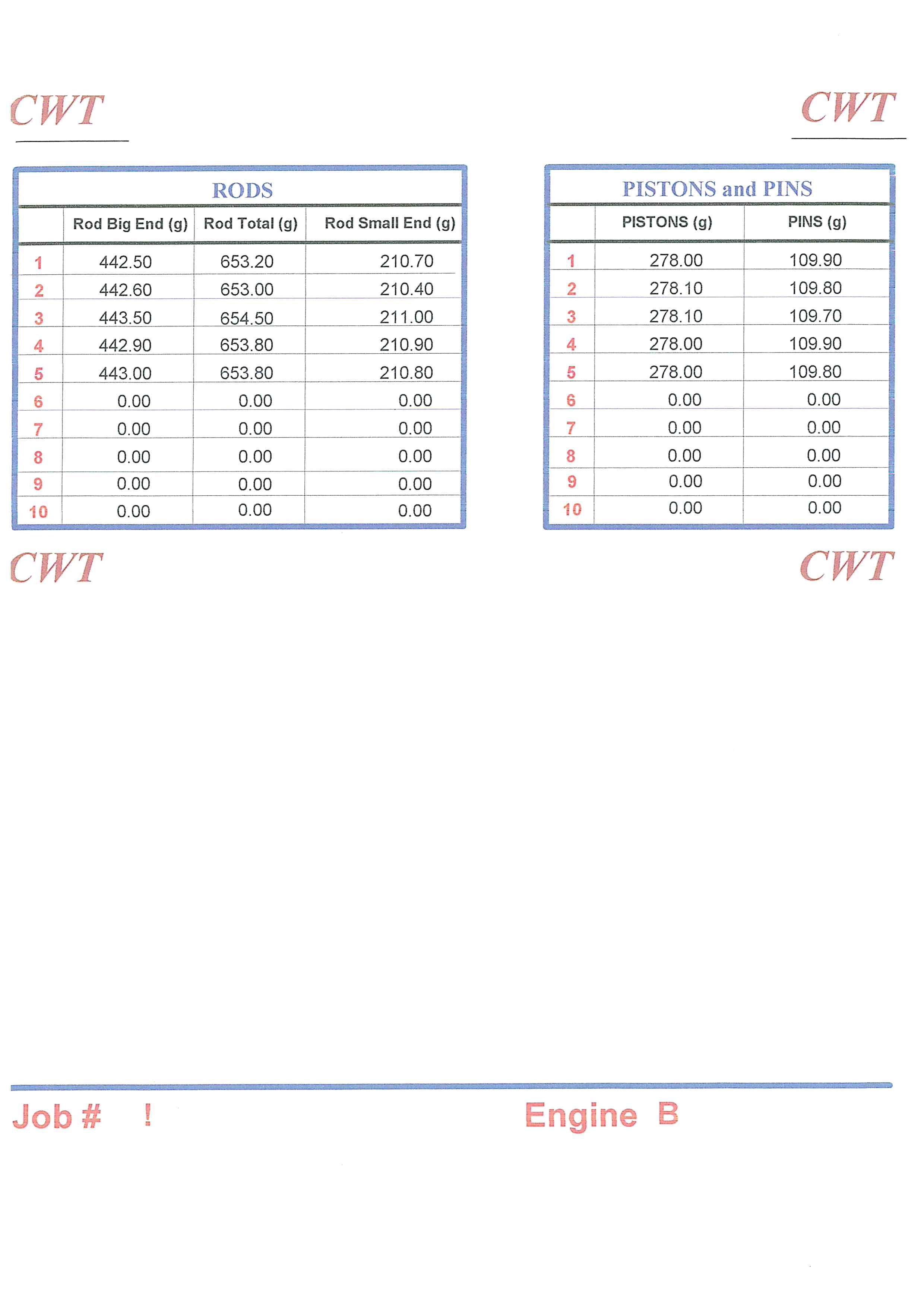

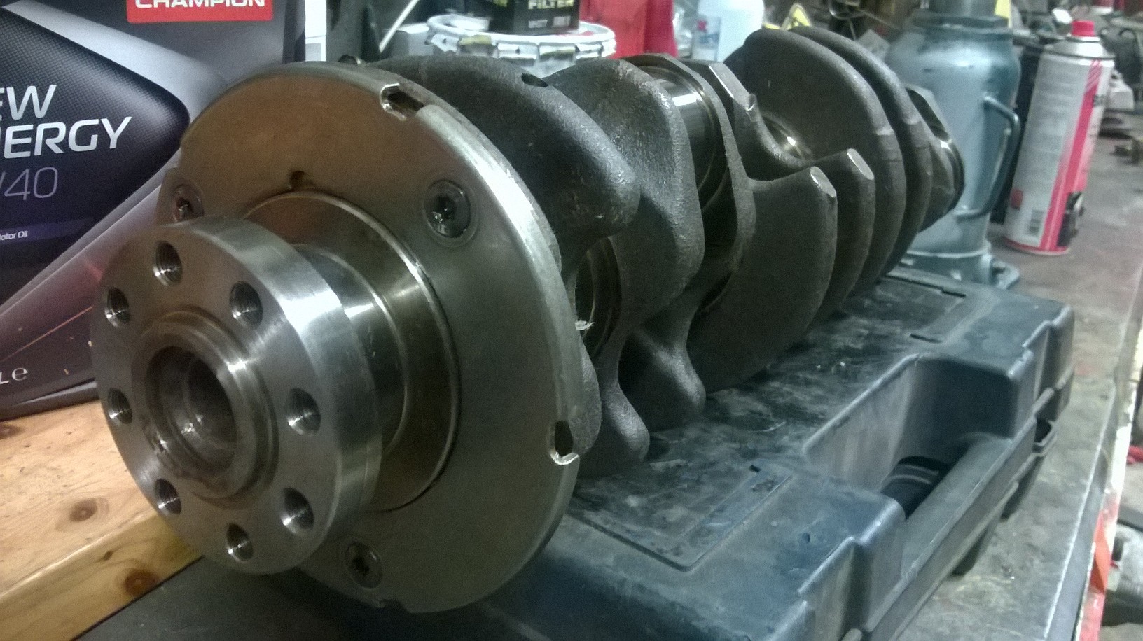

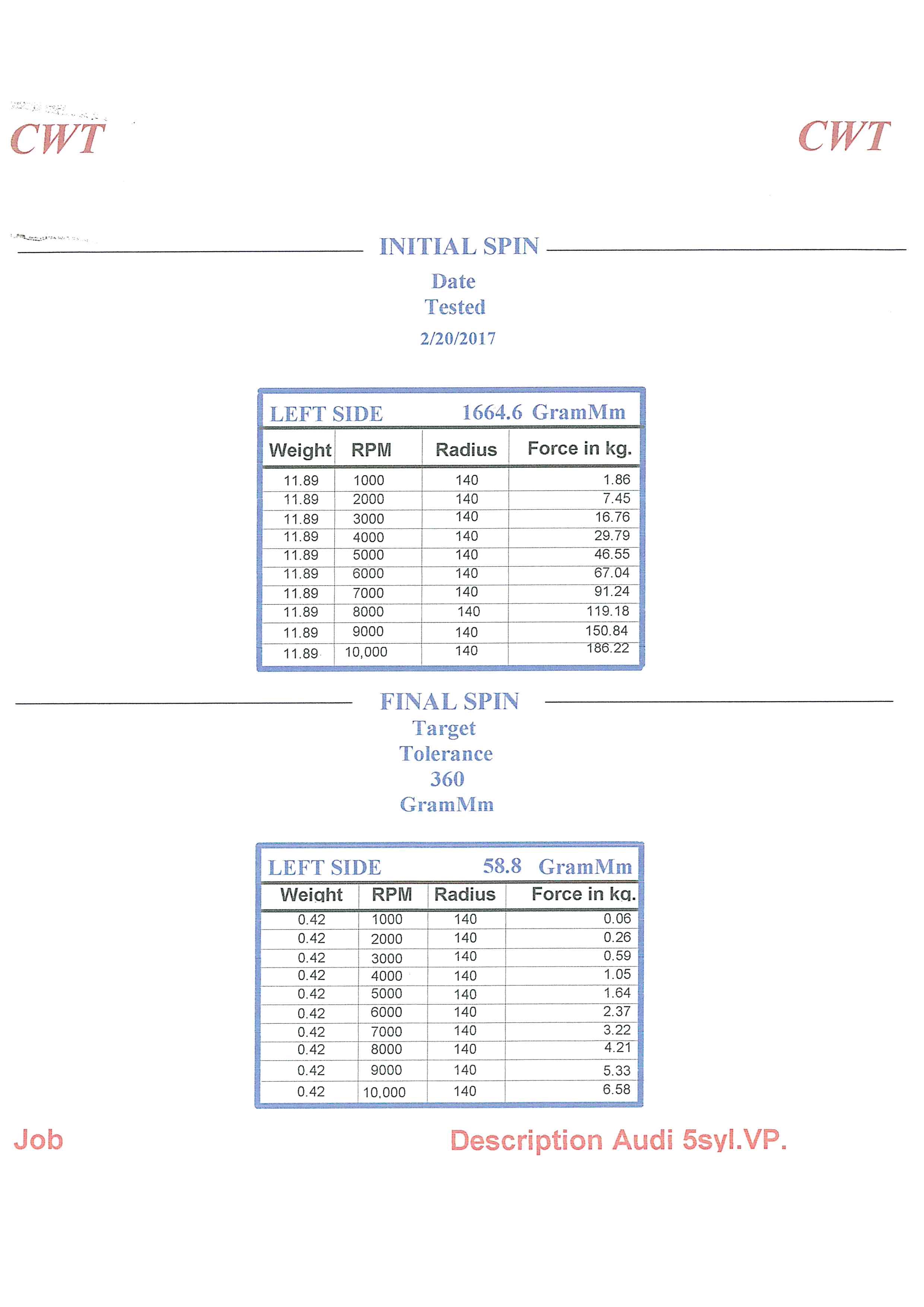

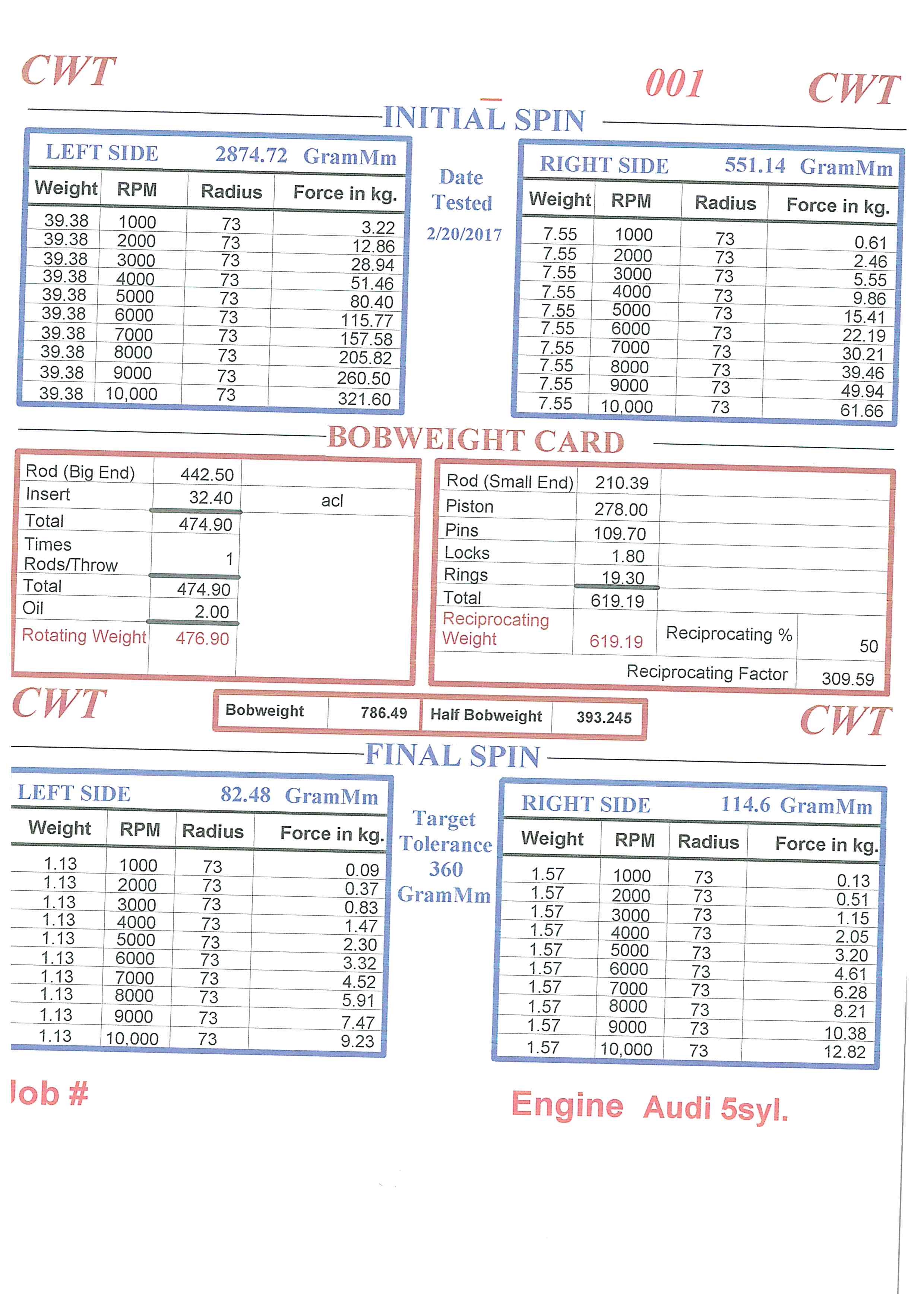

Got the rotating assembly balanced last week.
balance
balance
pistons rods weight
pistons rods weight
flywheel balance
flywheel balance

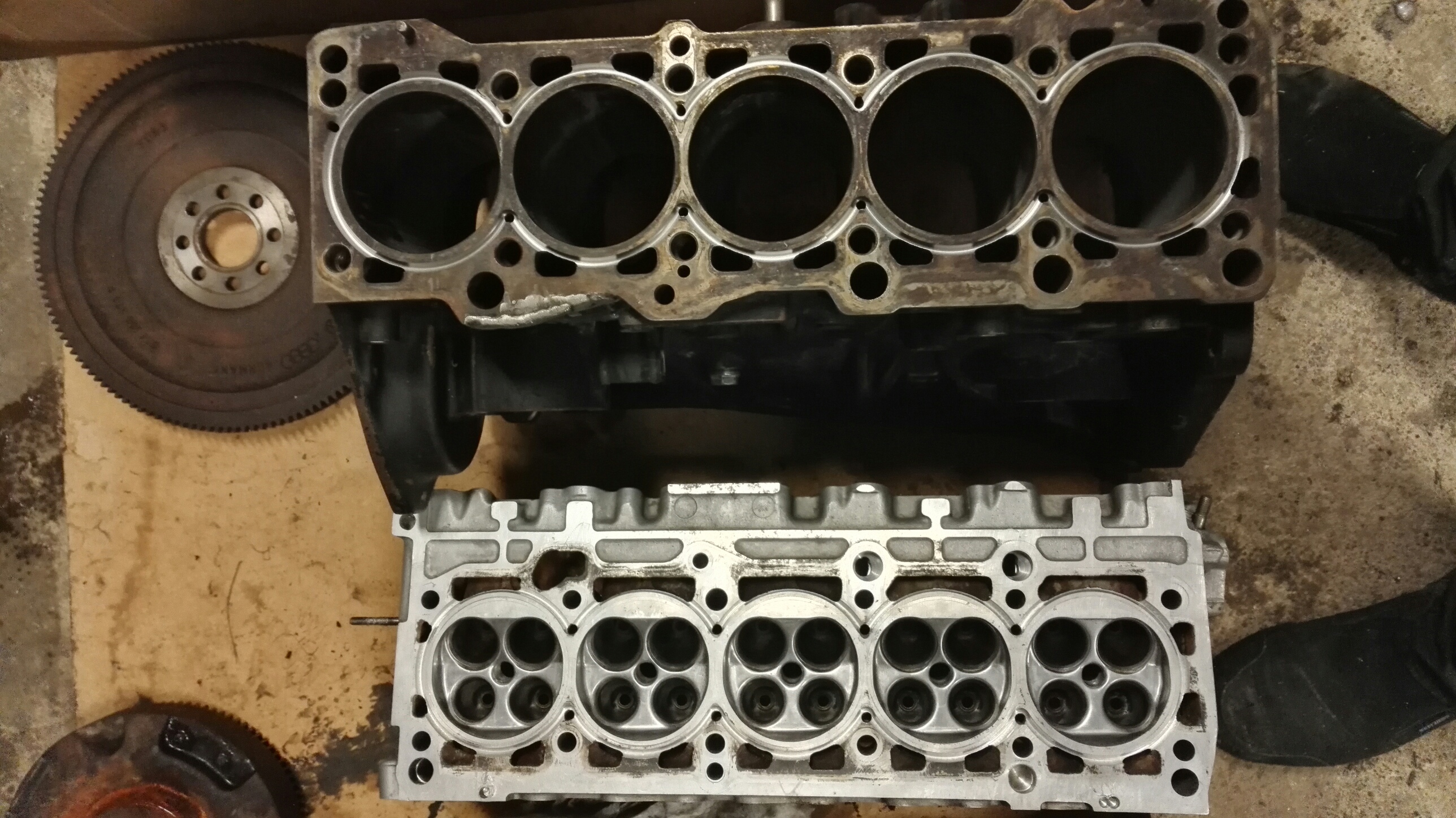

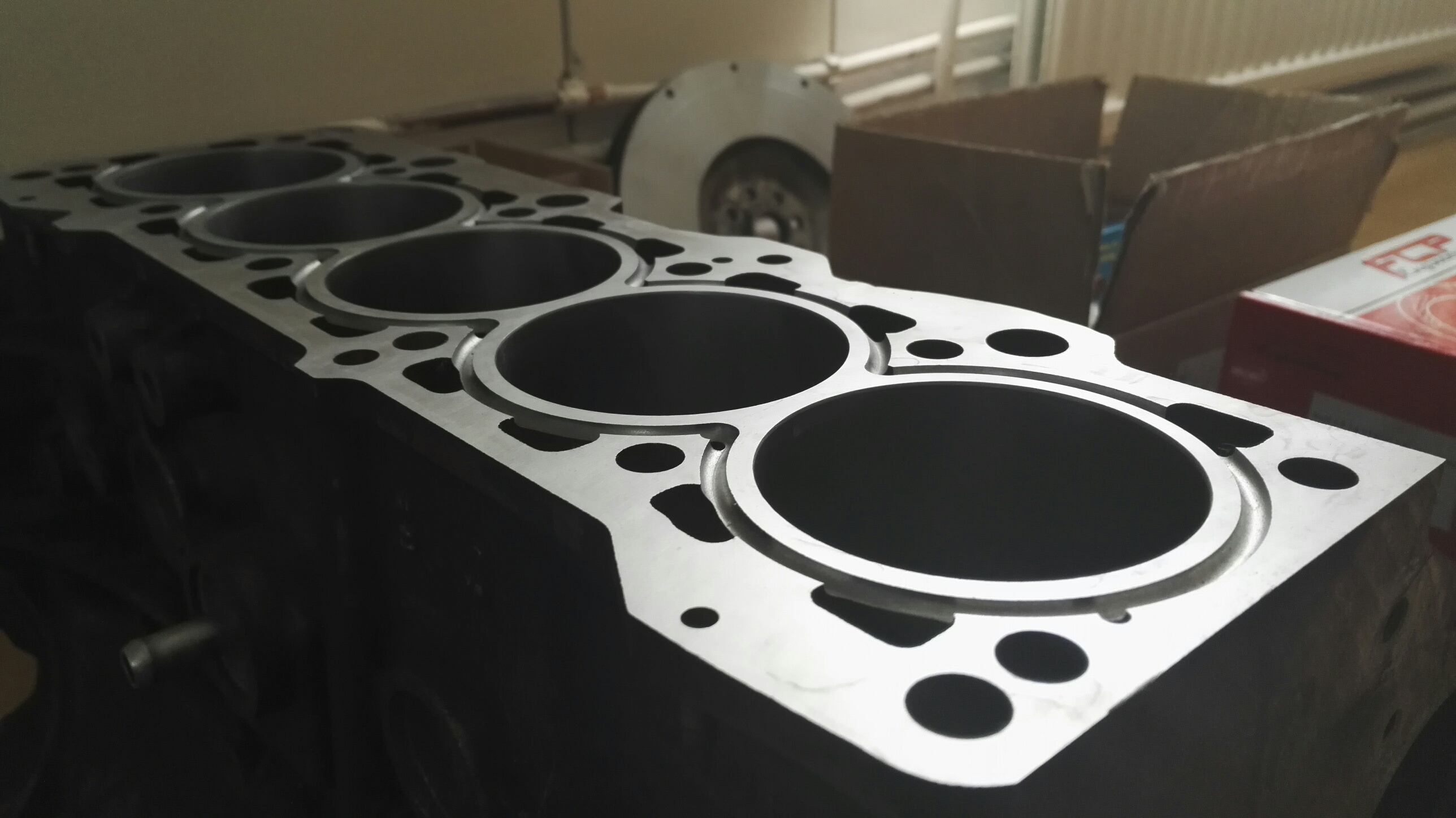

Water jackets are done to head and block.
Went with 4x4mm round shape.
water jackets
water jackets

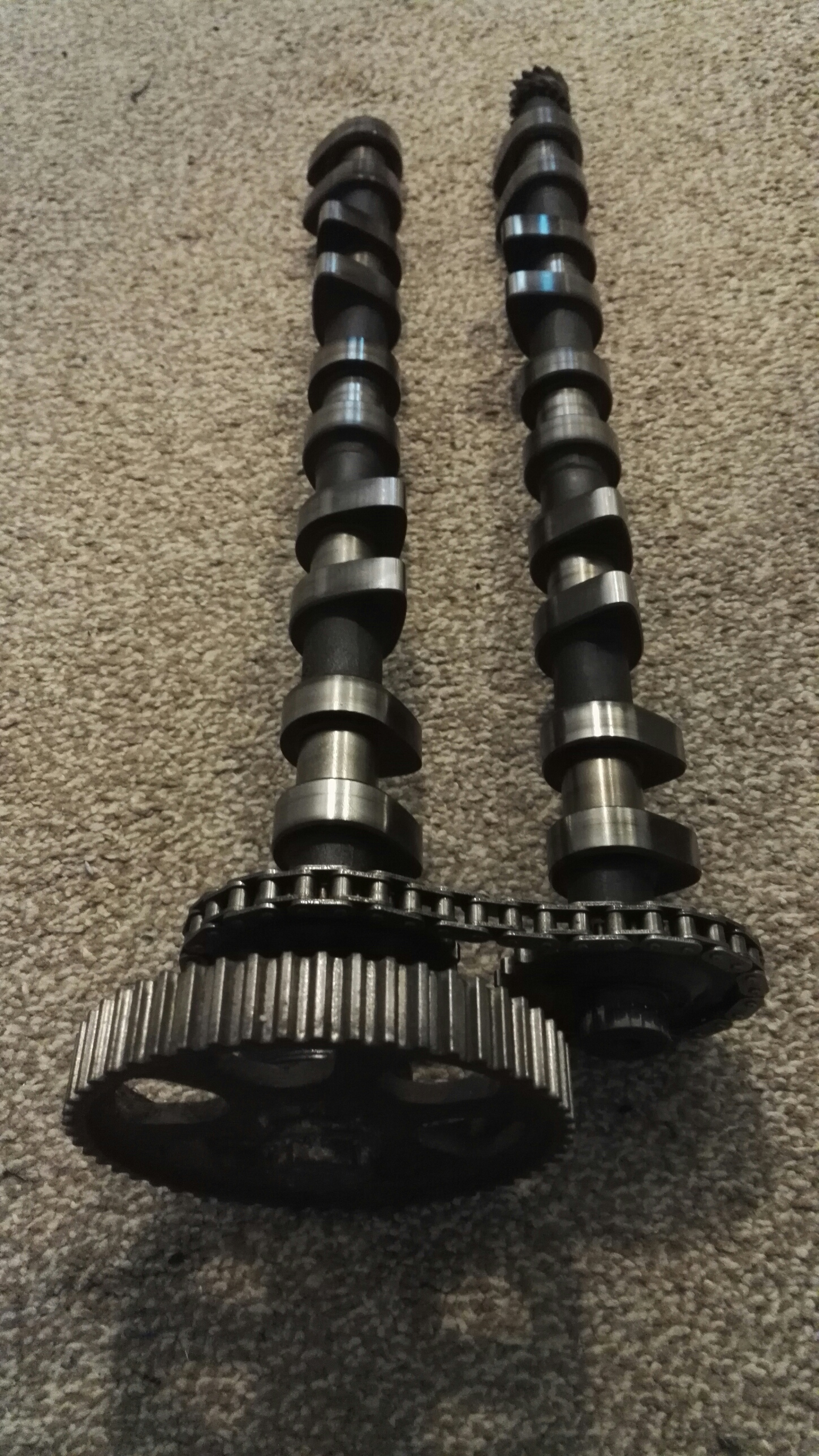

7A cams from same guy who sold me 200 20v flywheel and 7A dampner.
7A cams
7A cams

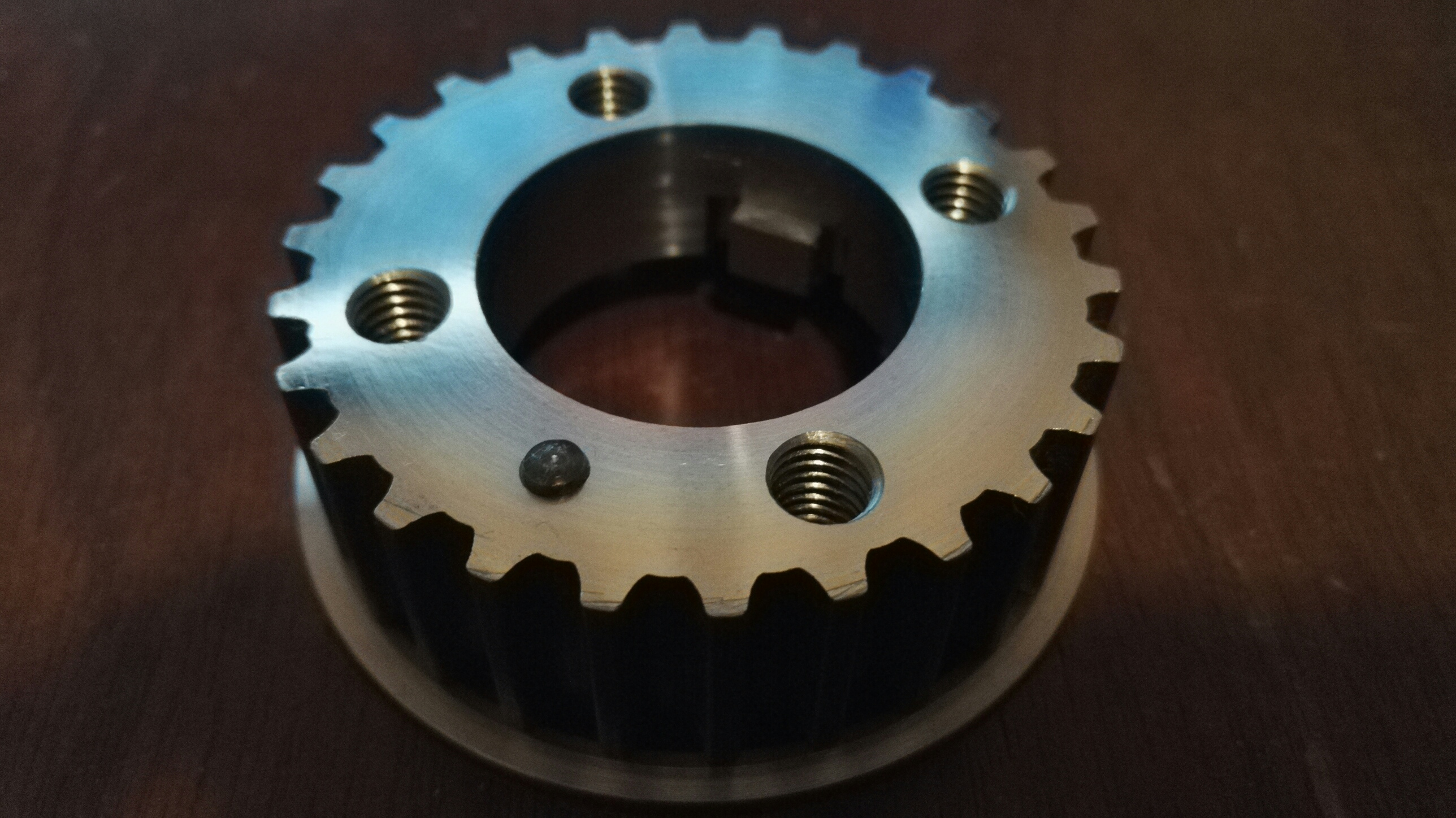

Terrybullwon cranck gear
gear
gear

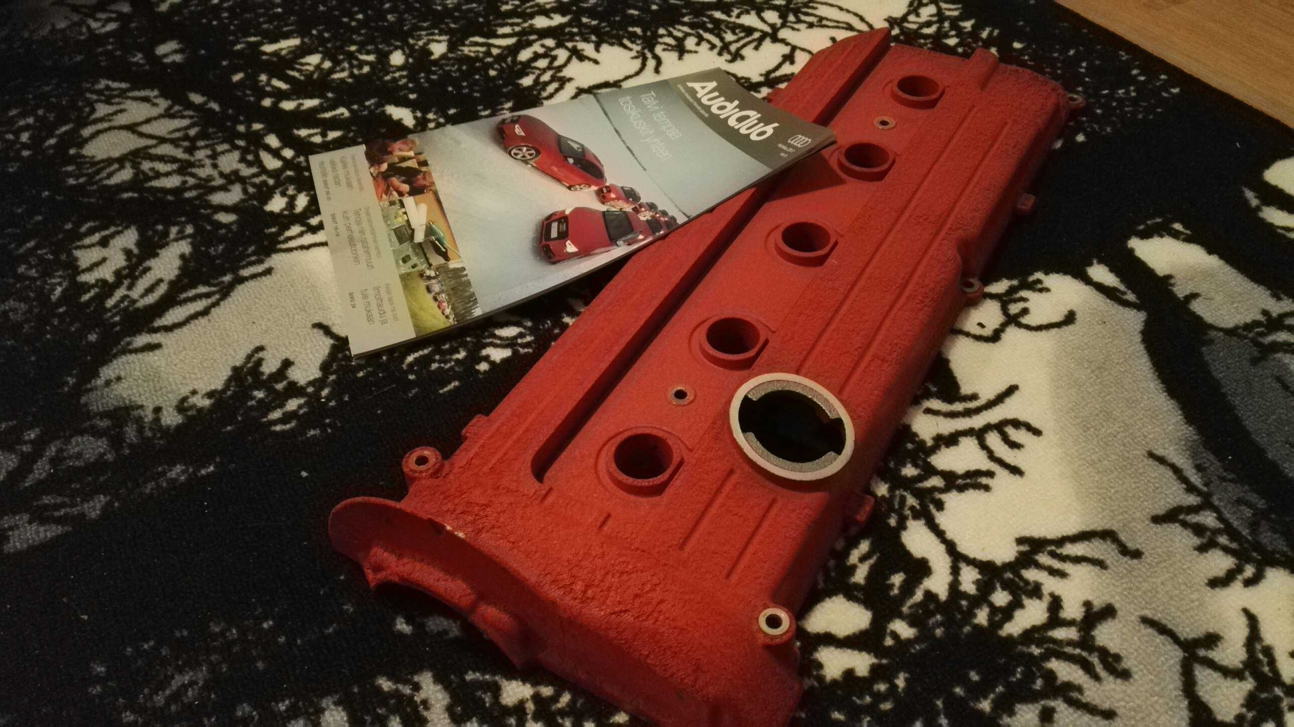

Fancy red camcover and some propaganda newsletter ;)

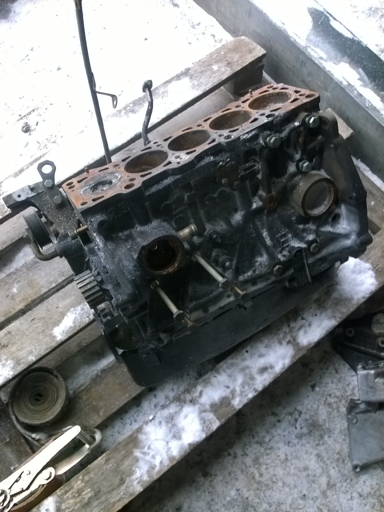

A few old pics when decided to start building the engine, just because started spamming with photos:
Treasure just as found from local junk yard, ACV block from -97 transporter 8-)
junk
junk

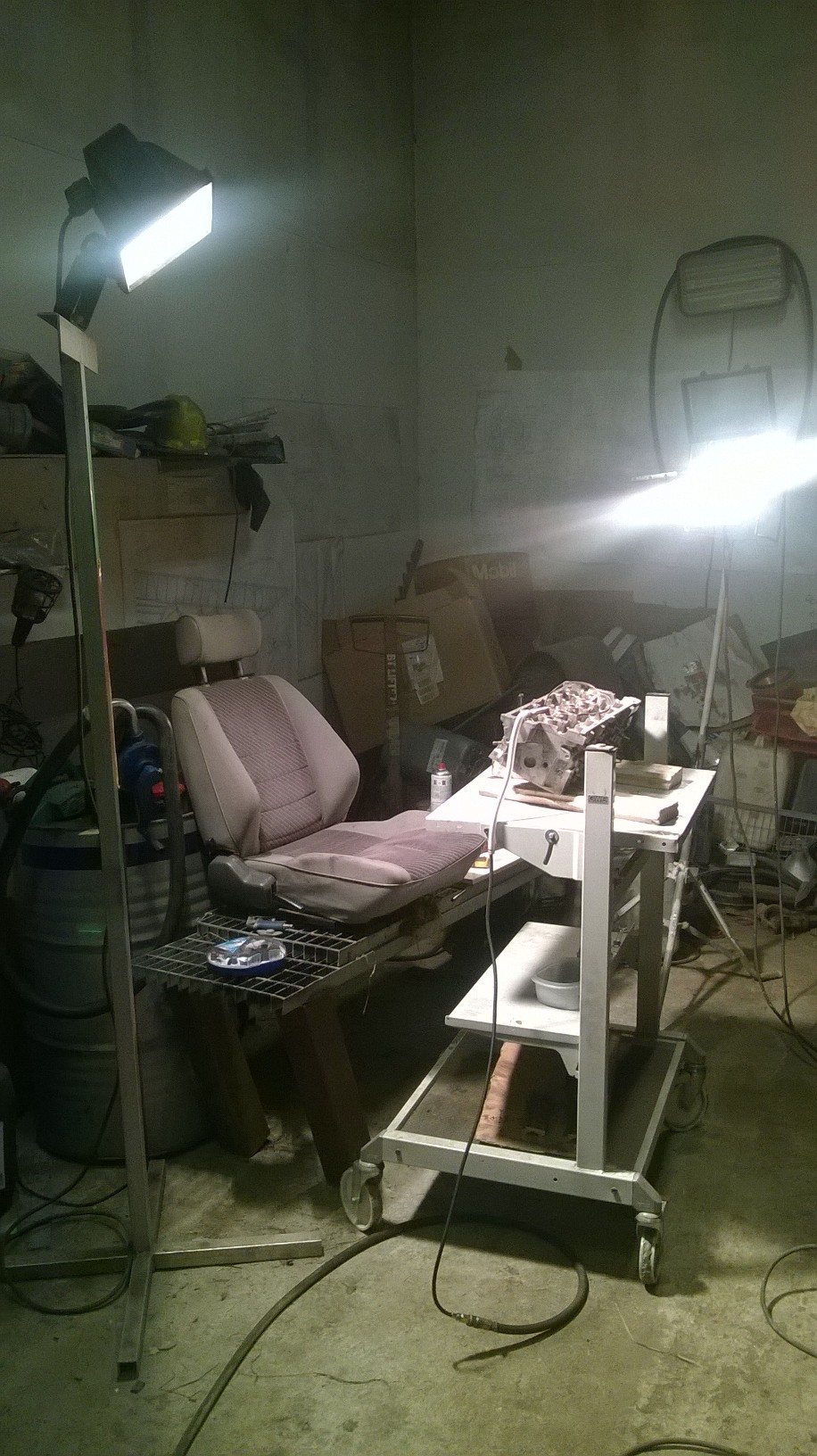

This is how to do head work :rofl:
Polished exhaust ports and combustion chambers, or did try atleast. :drunk:
LOL
LOL

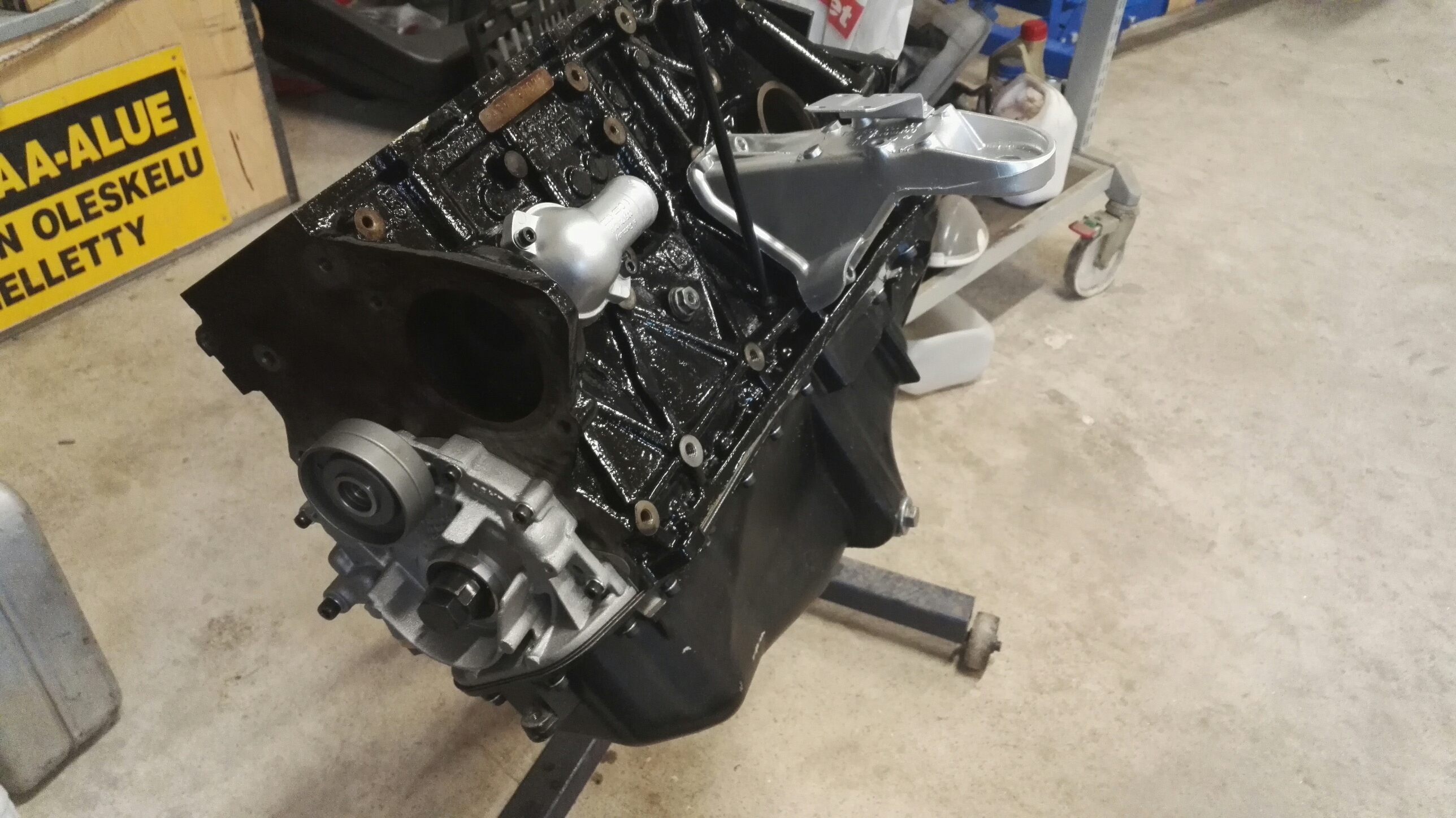

Driving this thing for 2 weeks now and some 1500 kilometers (930 miles..) with no hiccups what so ever.
Got the stroker block from the machineshop, waiting for head to be ready. Might start to assemble the block slowly..

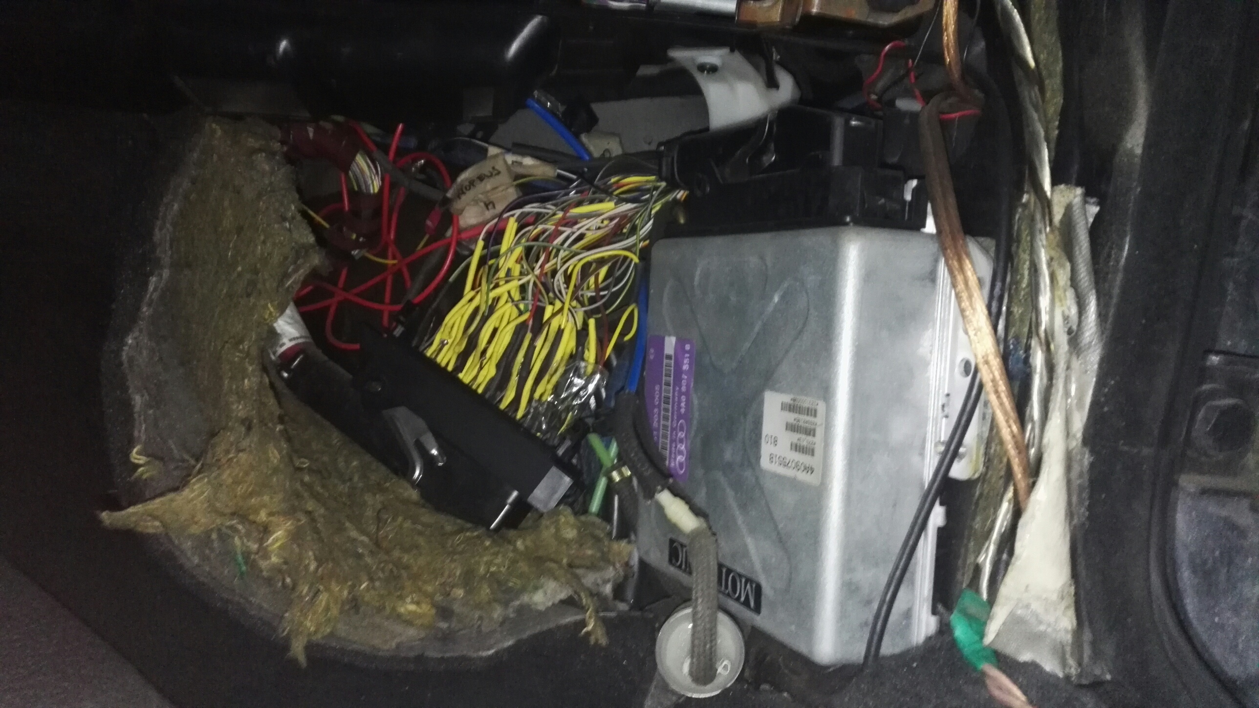

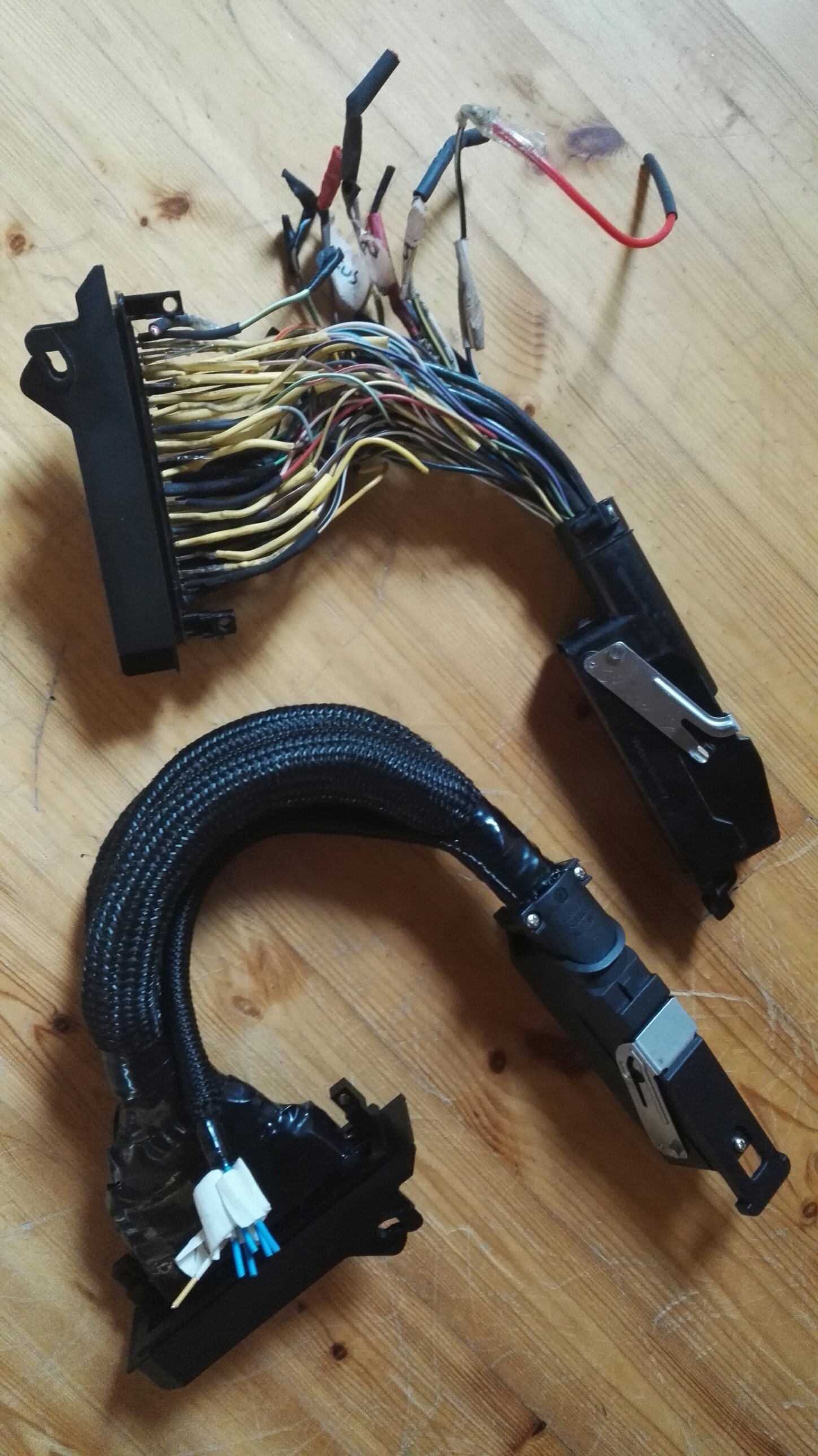

Took a look at current ecu and found out some electrics needed some attention... :roll: .. so I made new 3B wiring harness to AAN ecu adapter.
mess
mess
There were some Audi S6 ecu judging by the numbers, I took a look inside but didn't dare to mess with the boards..
The more I find this stuff, the more I'm amazed it even runs..
3B - AAN
3B - AAN

1. Old engine and trans out, all of the pistons have substantial side rocking at tdc, explains the blow by?
2. New bottom end mostly assembled with everything new and in upper end of clearances

Re: 220vt slowly turning into a stroker, pic heavy
Purdy... the coolant passages in the block are awesome - are they going in the head as well? Dad wanted to do that very much on his "to be" stroker build.
Juizer
Posts: 72
Location: Finland
Post by Juizer »
Yes, they are in head as well. 4mm x 4mm with a round milling head if I remember correctly.
