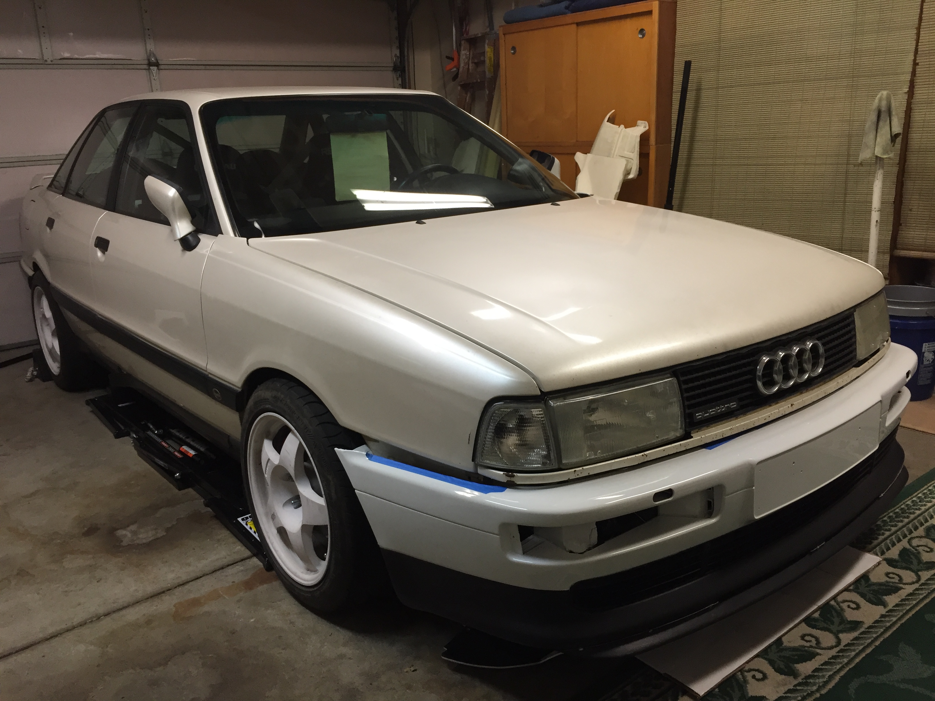

S2 front bumper mock up
90q_S2 front bumper mockup.JPG (1.9 MiB) Viewed 44933 times
Re: 90q IMSA GTO (wanna-be) build
Ohhhhh yeah... that's the stuff.

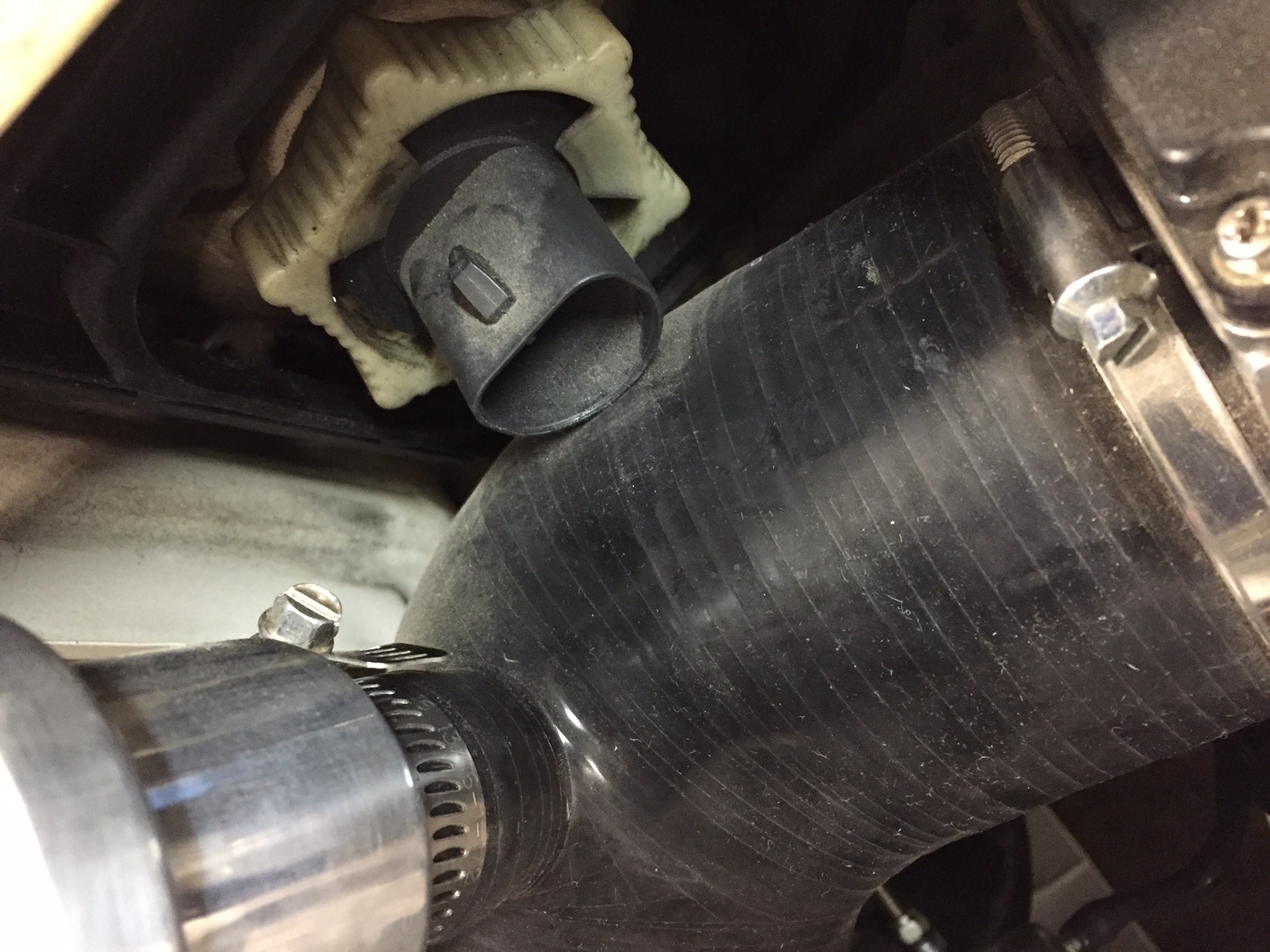

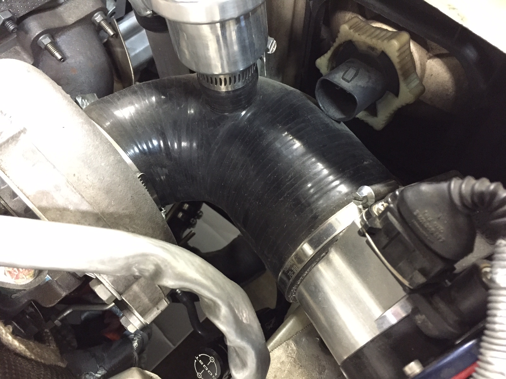

Would any of you have a suggestion for a better solution to this clearance issue between the backside of the right headlight and the Turbo Inlet hose?? Kinda not liking the stress it will put on the headlight connector and the way it forces the light to be aimed down and in.
Thanks
90q_TIP_cu copy.jpg (594.02 KiB) Viewed 44832 times
Cobra head style hose may help.
