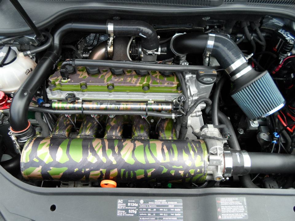

How many failed cast cranks has anyone here witnessed?... I only know of 1 which was used in an AWD drag strip setup, which I would say is more abusive with all the launching needed to get a good time... In a Hillclimb setting I'd bet it would last longer, and perhaps even more durable in 2WD setup... I only say this because of my past experience of seeing soo many boosted ABA's without any failures, granted all have been 2WD but they did see rigorous strip and street abuse using the stock cast crank... I have a nearby fully built 6262 07k mk5 Rabbit thats had NO issues whatsoever in 2WD form...
- 391280_446379995394170_2100949432_n.jpg (120.12 KiB) Viewed 124301 times

mushasho wrote:How many failed cast cranks has anyone here witnessed?... I only know of 1 which was used in an AWD drag strip setup, which I would say is more abusive with all the launching needed to get a good time... In a Hillclimb setting I'd bet it would last longer, and perhaps even more durable in 2WD setup... I only say this because of my past experience of seeing soo many boosted ABA's without any failures, granted all have been 2WD but they did see rigorous strip and street abuse using the stock cast crank... I have a nearby fully built 6262 07k mk5 Rabbit thats had NO issues whatsoever in 2WD form...
Obd 1 aba's were forged, and that is what most people are boosting (fyi).
