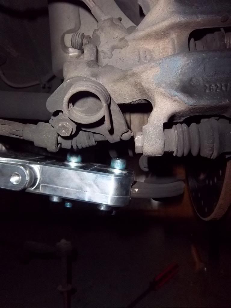

Spent a couple hours at Chris's place lathing out the spacers for the control arms. They will be moving back in the wheel arch about 1/2" at most. Thanks again Chris!!!

The front tie-rod is definitely an issue, and why I ended up rotating it so the wheel and tire can be flush against the strut. It completely destroys ackerman, makes tight parking spots difficult and adds some inside tire squeal on the track, but I guess it is worth it. I have not really noticed a difference in handling.
