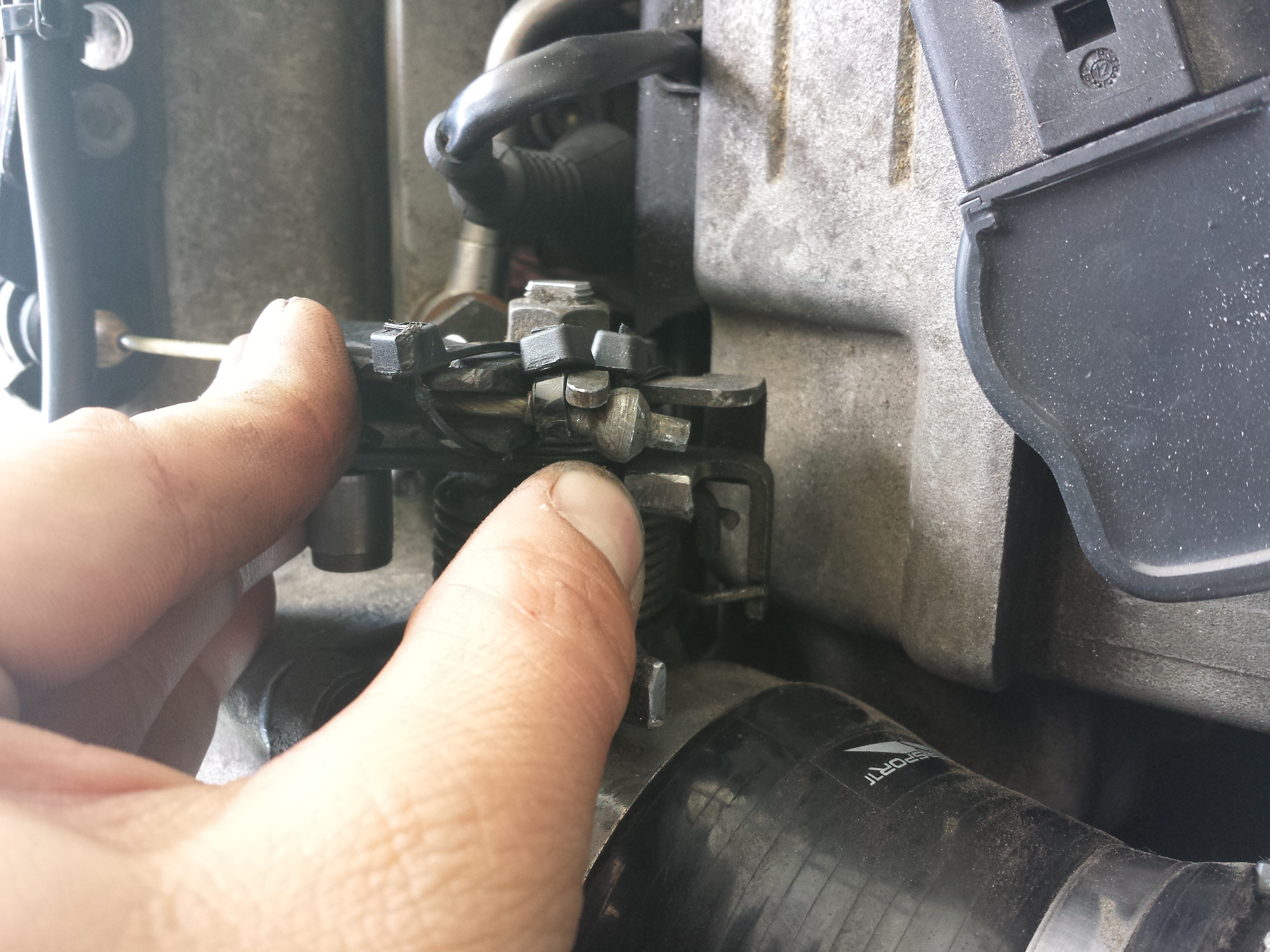

Okay since not many of you may have deleted your IAC valve on the 3b, I figured this would be interesting. I was getting a bit of a drop-off feeling in power up top and the inability to hit my target boost since removing it. I looked at my logs and saw my tps was only hitting 98 max. I adjusted it and it was a little better after seeing 99%. I decided to take like .001 off of the surface shown below and now I'm hitting 100% again.
This occurred after adjusting the throttle open slightly at rest to raise the idle with the IAC valve gone. It was apparently enough to make seeing 100% physically impossible so I had to get creative...
- Shiny surface right under my thumb nail
- 14427715693901733480483.jpg (3.76 MiB) Viewed 24416 times
It shouldn't matter if it's not exaxtly 100%... You can just adjust it in VEMS anyway lol

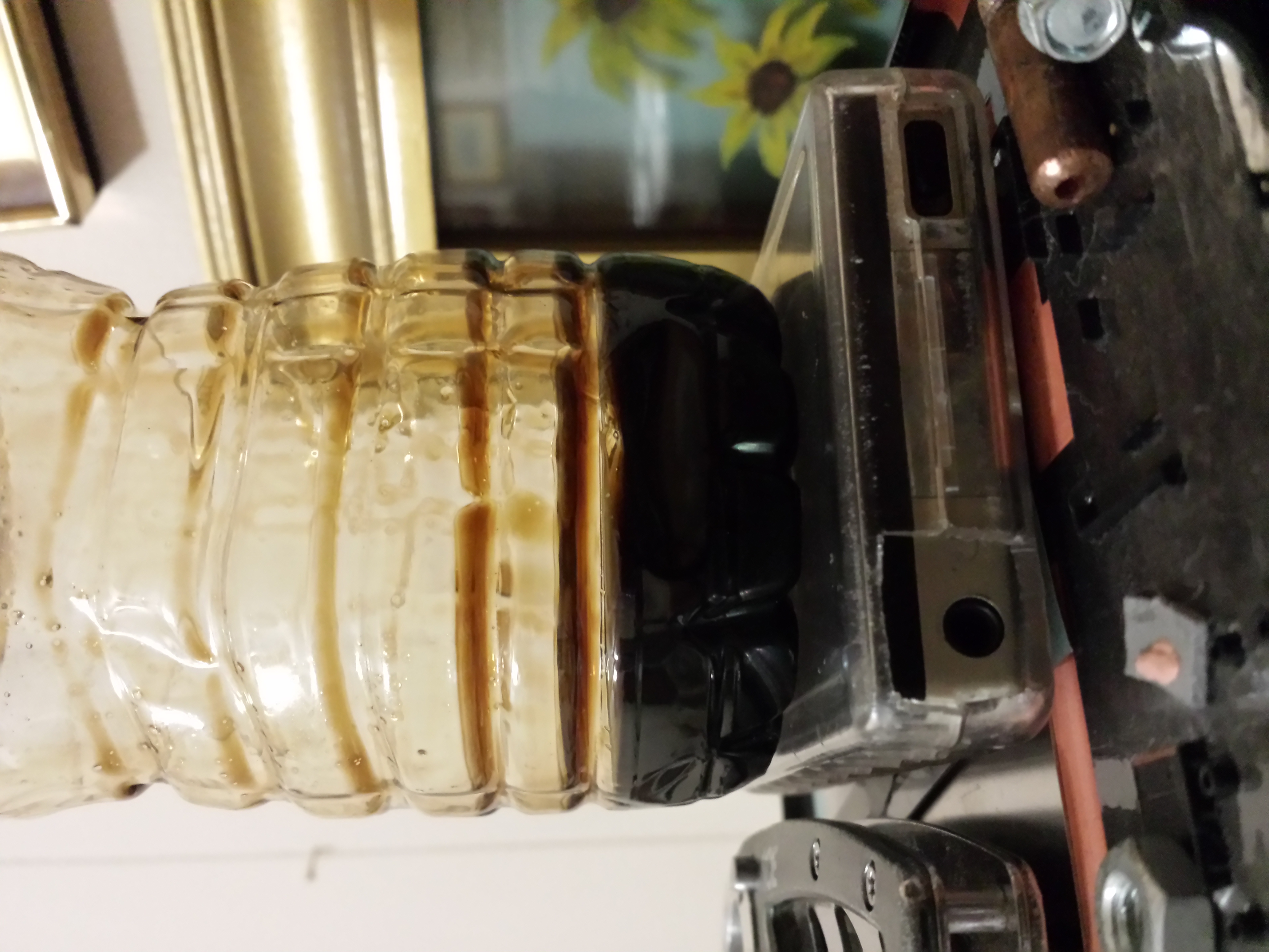

I just checked my catch can vac tube off the intake and I put my finger in it to plug it while revving the motor in neutral (of course lol). I got ZERO vacuum off of it. I need a better place to tap into besides right before the huge k&n.
What prompted me to test the vacuum was I cleaned the CC with brake cleaner and left it vented. Then when I saw steam coming from there with the hood closed I began to panic
because I wasn't sure if it was exhaust or steam which was likely exaggerated by my hard pull right before that and using w/m all the time. When I put it back on the intake tap point I checked vac. IVE always suspected it wasn't doing shit there!
because I wasn't sure if it was exhaust or steam which was likely exaggerated by my hard pull right before that and using w/m all the time. When I put it back on the intake tap point I checked vac. IVE always suspected it wasn't doing shit there!1991 Audi 200q Holset
Have you ever done a comp. test? That's a lot of blow by to fill that can.

This is how much oil was in the CC tonight after 2 days and heavy abuse in 1st through 3rd gears.
