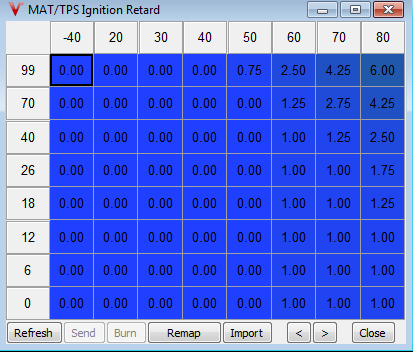

Heres my MAT table if that helps.
MAT table.png (18.28 KiB) Viewed 28082 times

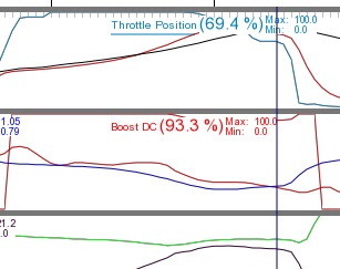

Also heres part of a log from yesterday showing the timing above the threshold of boredom (above 5k).
See where it still appears to hover at a certain RPM before moving upward, in the log anyways?
Heres the log excert saved. I dont think it literally hovers on the tach. I will try to watch the tach when I do a similar pull today. Makes me wanna puke looking at the RPM charter.

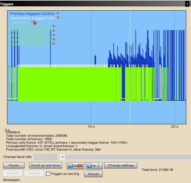

by 88a5tq

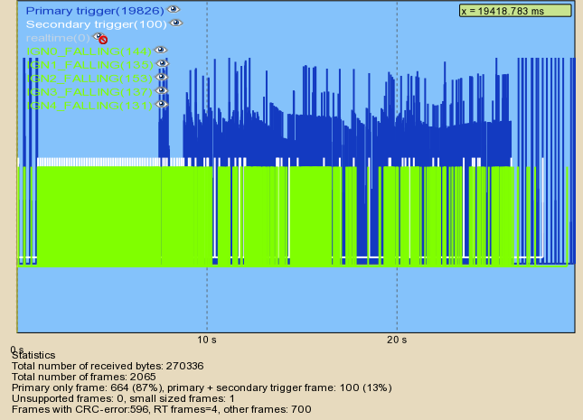

Im putting this trigger log up not because I beat on the engine while recording it, but because it shows 755 errors at the bottom of the analysis window if Im reading it correctly. Can anyone confirm that its losing the secondary trigger elevated rpms? I will order new sensors pronto if thats what this indicates as an issue. Or maybe I need to clean off the flywheel teeth or something?

Posted: Sat Sep 26, 2015 2:11 am
Didn't you say you had a long bolt in the vr sensor housing?
Posted: Sat Sep 26, 2015 11:36 am
by 88a5tq
Don't worry I'm not big enough of a moron to not stack a bunch of washers on the bolt. I made it stock length on the threaded end using washers I had so as not to rip the FW pin or teeth off with it. I didn't add any spacers to the sensors though so they are at the correct distance still. Could dirty FW teeth cause a signal loss at high RPM maybe? When the distributor was leaking into the top of the bellhousing for forever I think I saw some dried oil and grime on a few FW teeth a week ago. My sensors are original on the bellhousing as well. I think VEMS recommends brand new ones in a PSA for audi people lol
Thing is, the primary and secondary triggers were perfect when starting up the car. They gradually lost signal on the seconday one I think it was as I increased RPM and drove longer.
So what the heck is a CRC error here?
trigger error.jpg (95 KiB) Viewed 27973 times

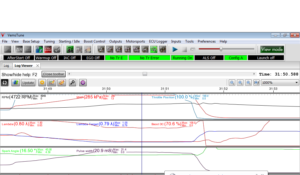

This is the log screen pull where you can see the PRM's sweep upwards again correctly (top row in black):

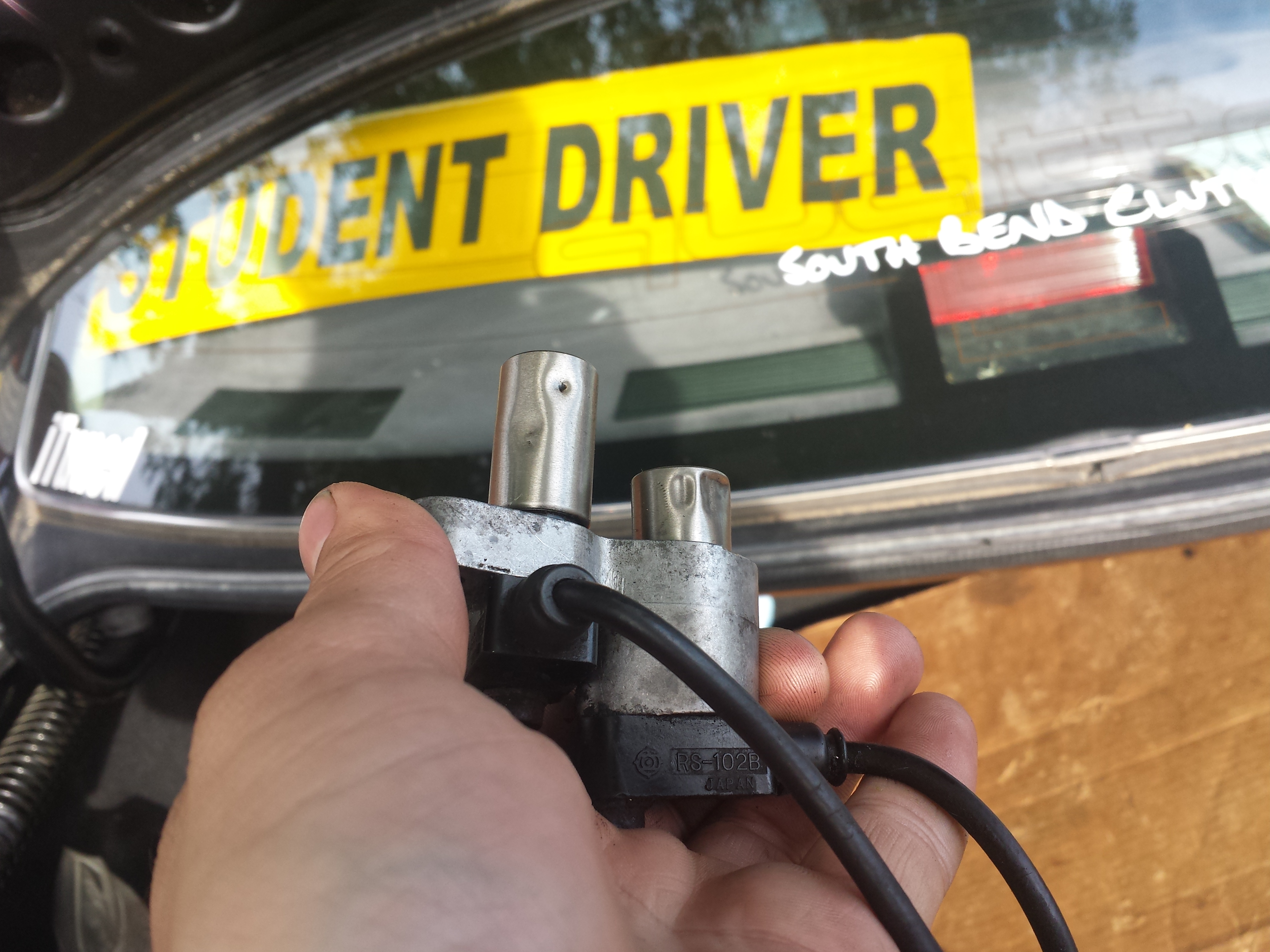

Olds sensors, look like they were beat with rebar. I forgot how beat up they were I guess:
