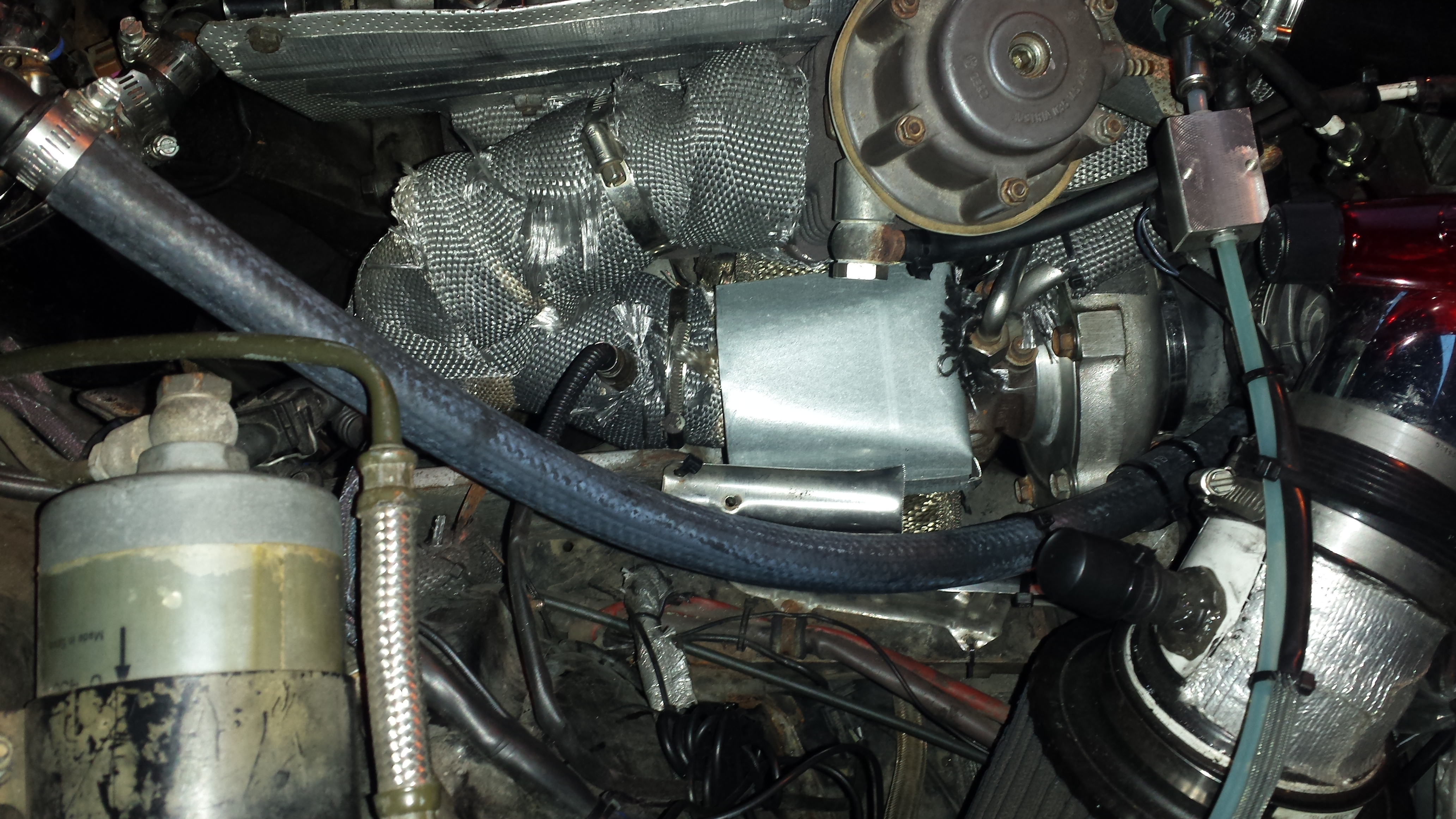

With some available time I moved the catch can intake port from the k&n filter area to right in front of the turbo and tapped into the cobra head elbow. I think it turned out well.
There fixed

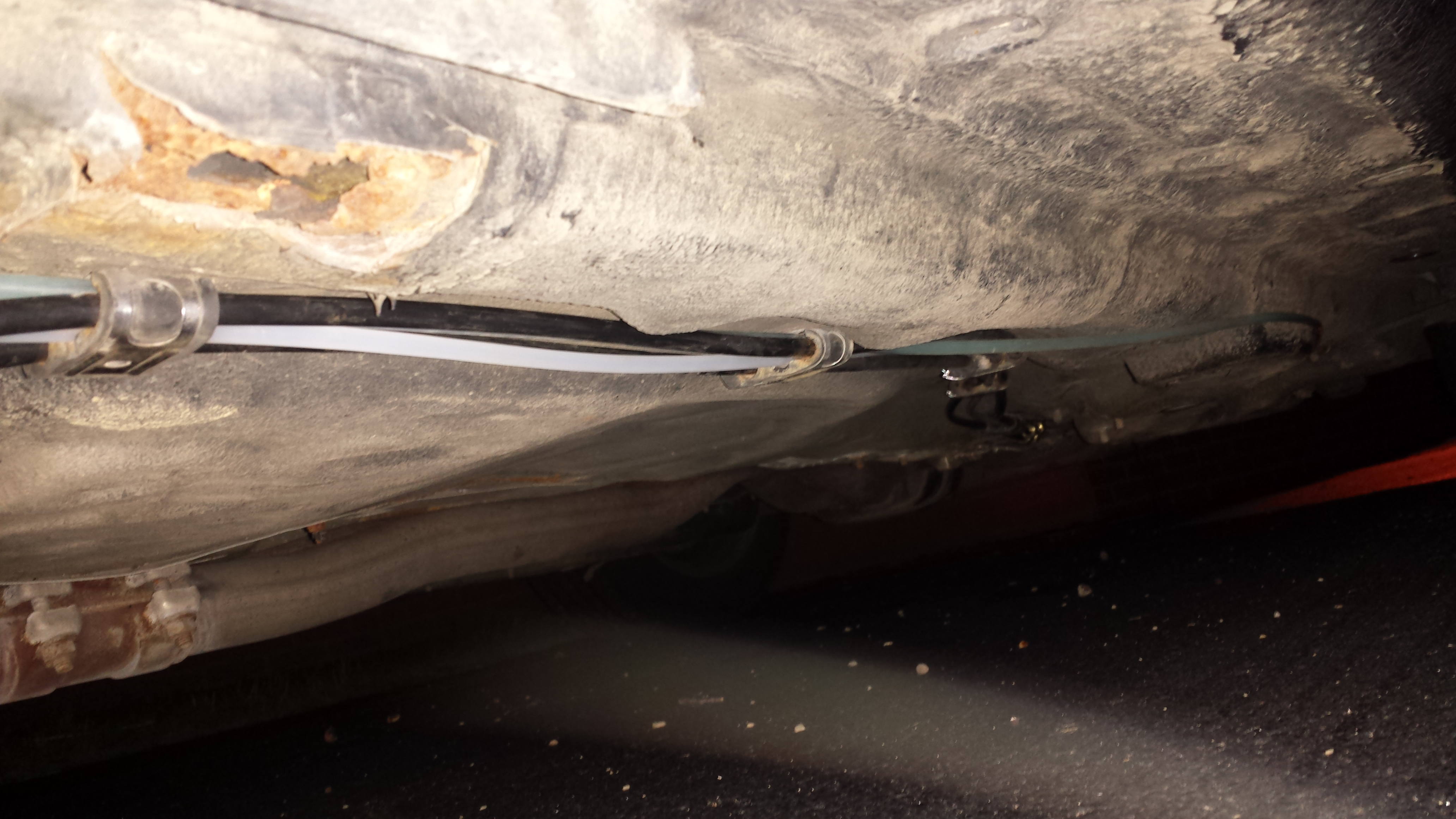

Also in a strange stroke of luck concerning the fuel vapor line only under the car (which if you recall those shady mechanics refused to do...), I found that a 5/16" steel fuel line to 5/16" nylon fuel line adapter has a sort of pipe on the inside that 1/4" nylon line can be forced to sleeve over. I am pretty surprised it fits. The end by the fuel tank can be joined to the factory nylon line thats ~1/4" using a shark bite butt connector. Pretty cool. I may try doing the line today real quick after buying a HF pipe cutter for $6. I think the line will only see vacuum anyway. No risk of blowing apart. Its a damn tight fit though.
Great success
Even cleaned everything up down there and got all the new lines, along with my w/m line, run in the OE keepers
