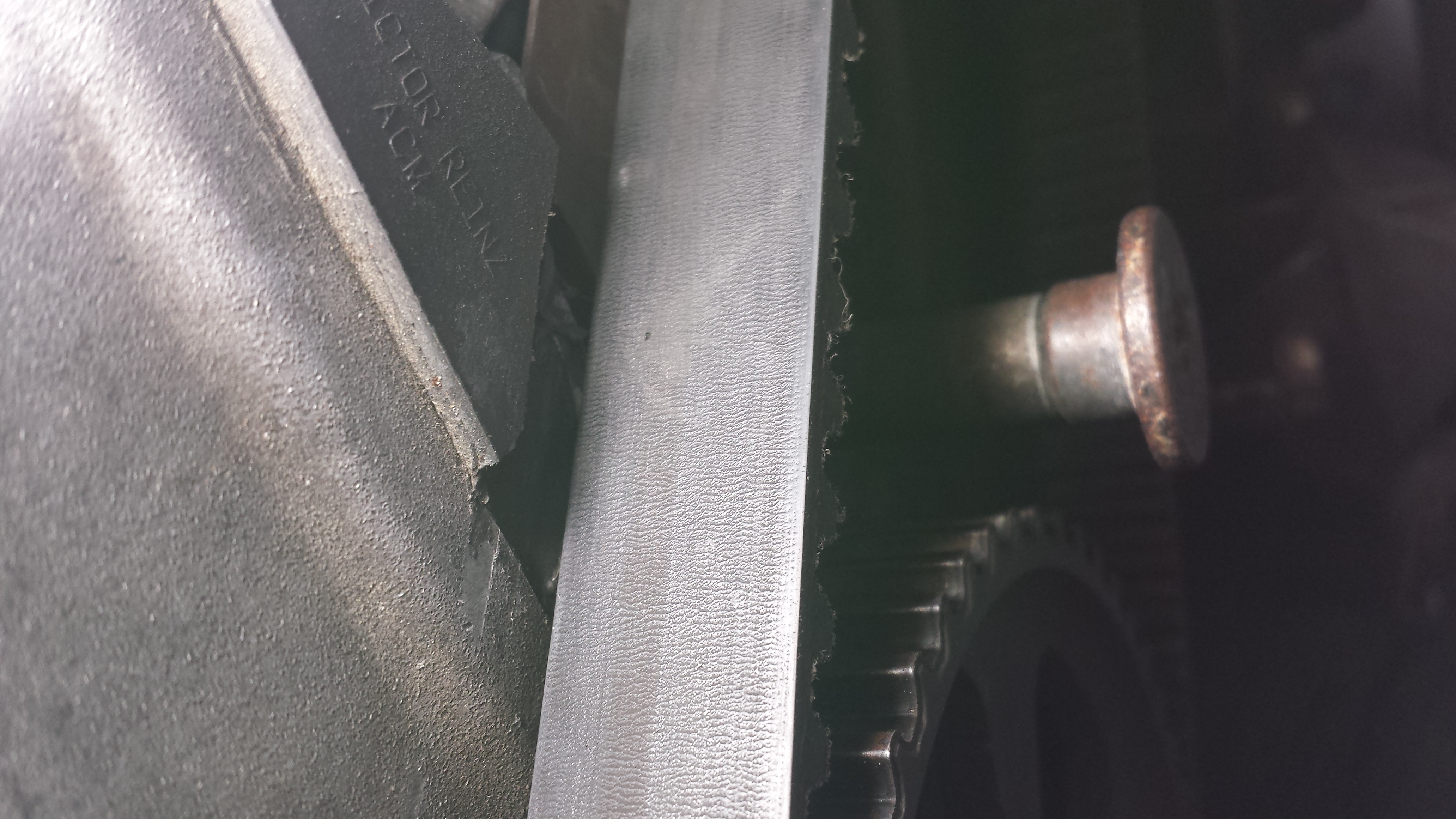

Is this wrinkly look okay?
Yes, that's a microscopic needle hole in just the surface of the T-belt.

And yes that wrinkly look is pretty normal.

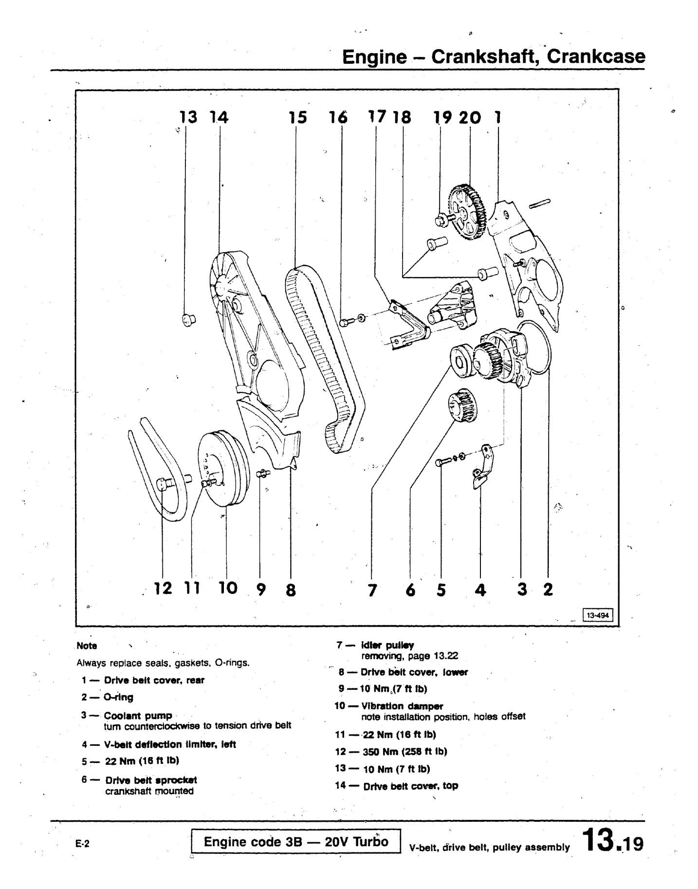

In general, unless you're dealing with something where the torque must be specific or uniform like head bolts and knock sensors, you can pretty much get away with varying degrees of "snug." I don't trust my torque wrench in the low range, since it seems to overtighten before it clicks, so I just base the feel on the thread size of the bolt and the material it's going into. If it it's an important part, I'll always pull out the torque wrench to make sure to get it right.
Also, water pump torque spec is 16 ft-lb ;)
Screen Shot 2015-10-09 at 11.55.26 PM.png (431.43 KiB) Viewed 25722 times
Lol ya I had everybody up in arms with my guess of 7. I was thinking of the lower pulley protective cover. Sorry guys hahaha. If you're a harbor freight guy and gave their standard torque wrench, it's fine print says it's only accurate from 25 and up. I invested in an autozone in-lb torque wrench specifically for the lower range.

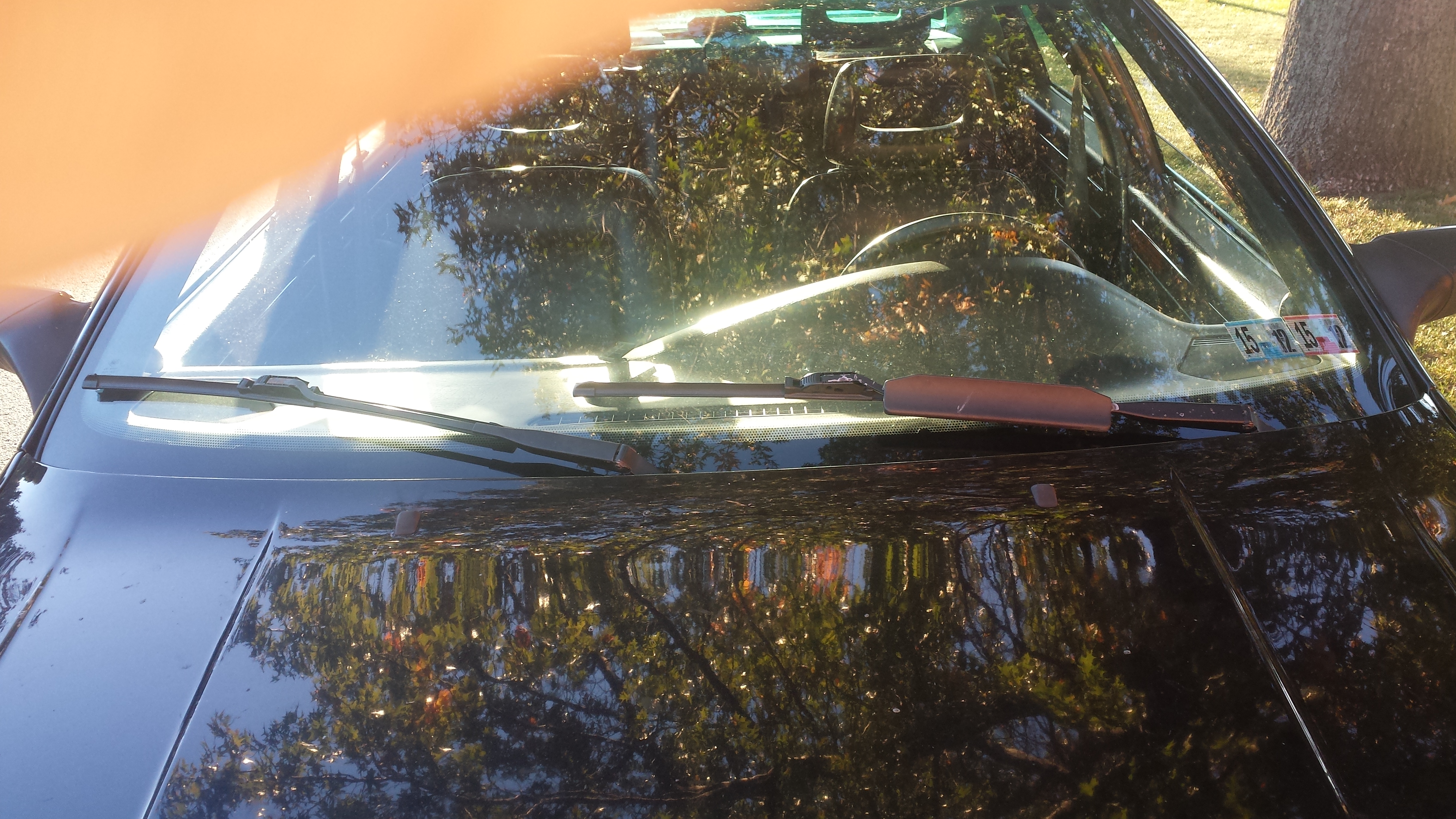

Is this about how low your guys' wiper arms are adjusted also? If I lower them anymore they get pinned under the hood. ??
My spare DS 5k arm is too low profile to even bolt in

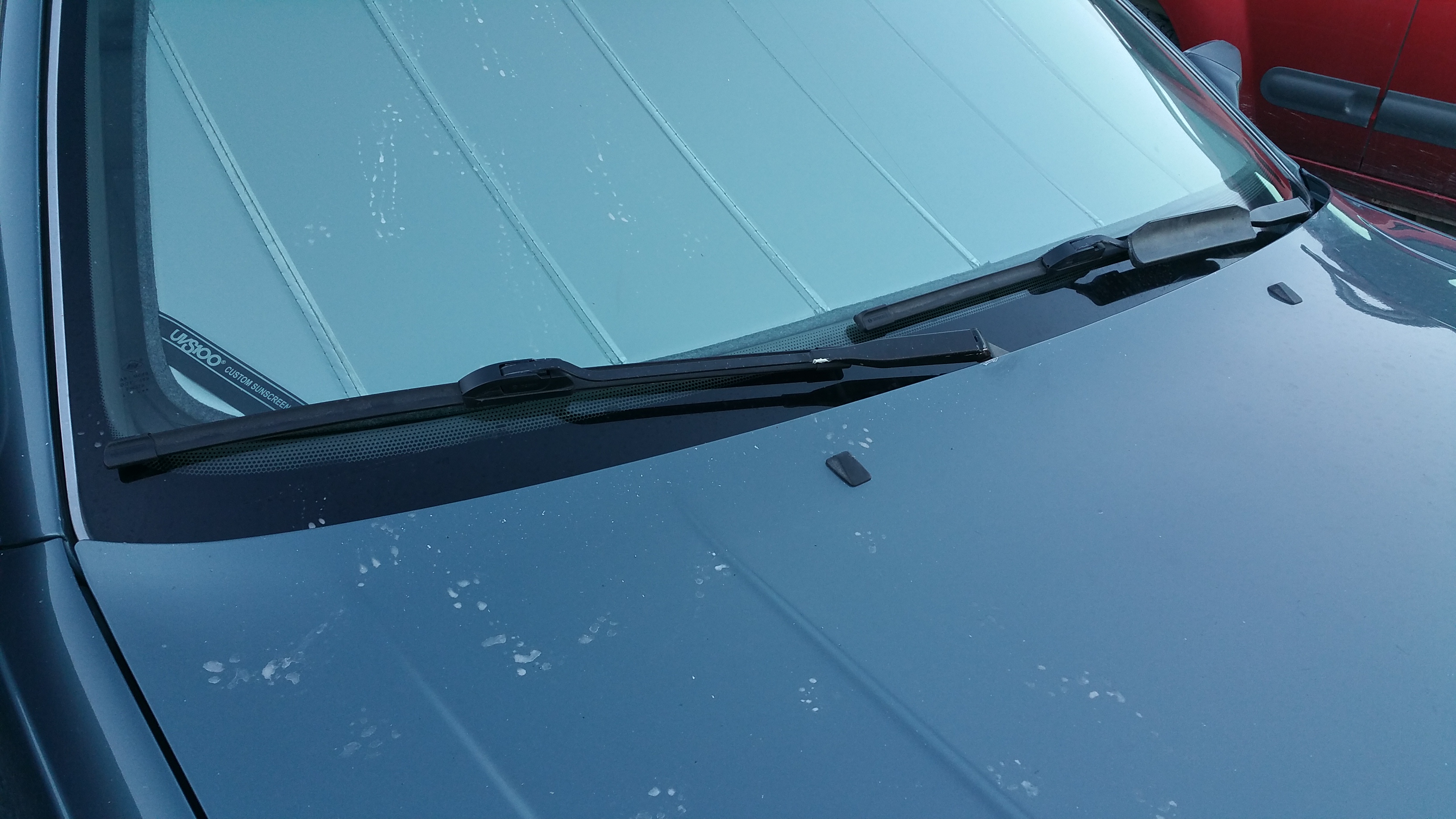

Ha, I just had to adjust mine because of the hood thing too. The Bentley shows how far they should be from the black part of the windshield. Is yours aftermarket? It looks a little different than my windshield. Anyway, I will post a picture of where mine are. (Damn the animal that got my hood dirty out at the rig!)
Here
