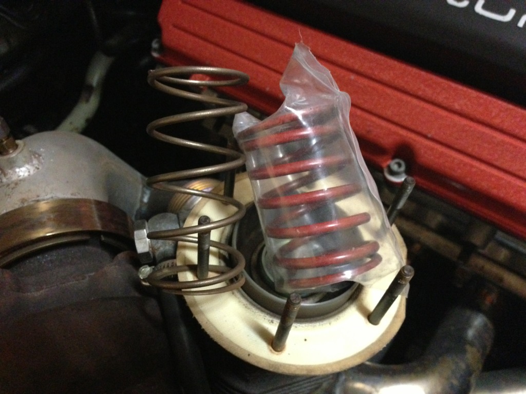

Here we go... Imma Git you Carlisle!
Time to wake up from your winter slumber
This should help me find more boost
