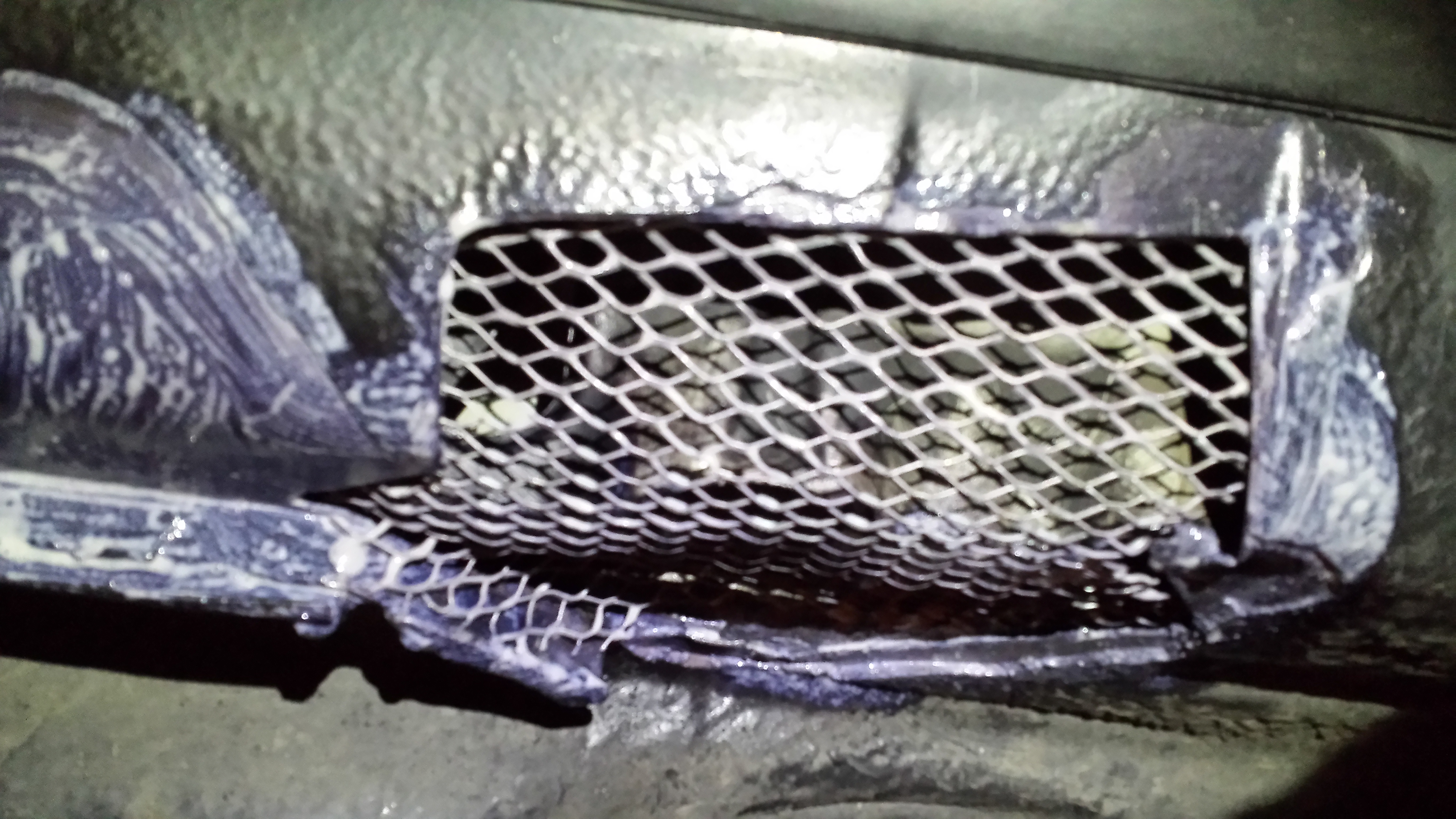

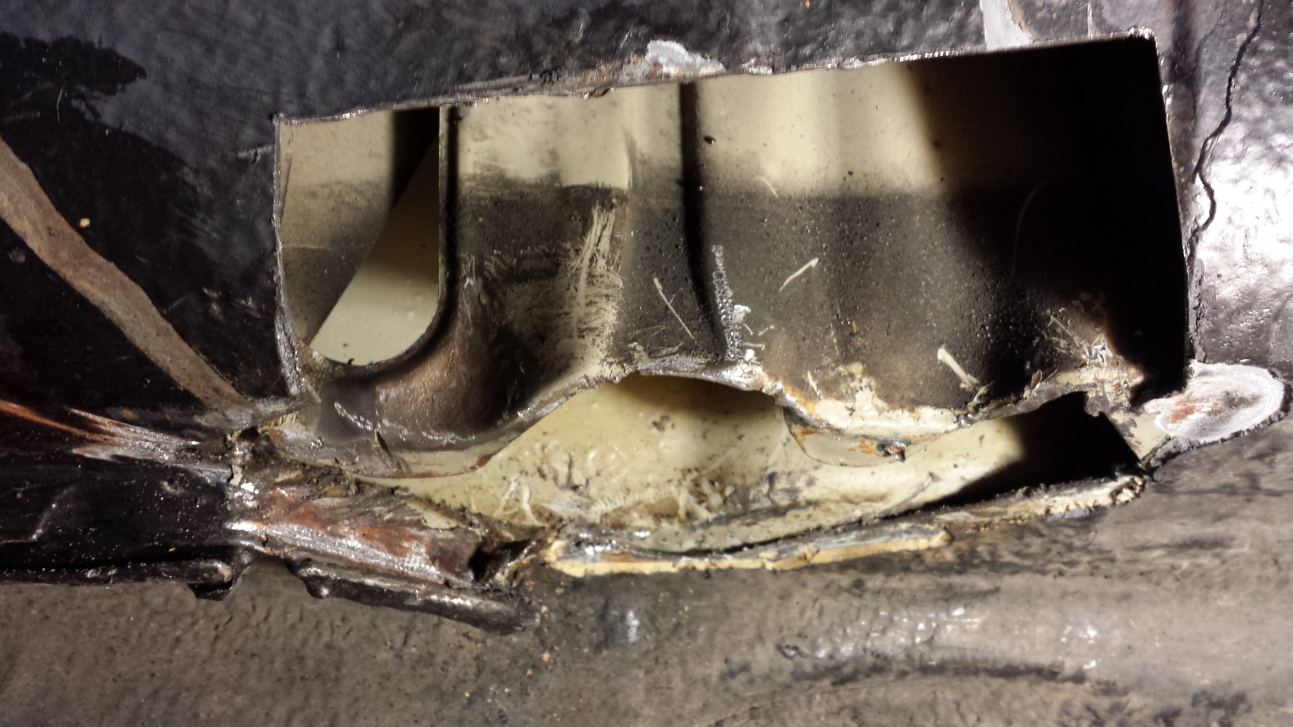

Pretty extensive body work was needed under the driver's door. Had to cut out about 1ft^2 and treat all edges with loctite rust converter. Stuff is great! Then I put chicken wire in to support expanding foam sprayed over it. Dried over night and I trimmed that to put 2 layers of fiberglass over it. Now the garage can quit complaining! Hopefully they don't notice I only changed the outside rear brake pads on Tuesday for inspection. When the proper calipers arrive from Shokan I'll put the full set of pads in
- 20151016_200618.jpg (2.58 MiB) Viewed 27511 times
- 20151016_182228.jpg (3.17 MiB) Viewed 27511 times
Lol damn man, why not just weld new metal in?
I already had ALL the materials I used from doing some ody work for somebody 2 yrs ago. I lack the right kind of HF welder right now. I only have a shitty flux wire welder and I hate that thing

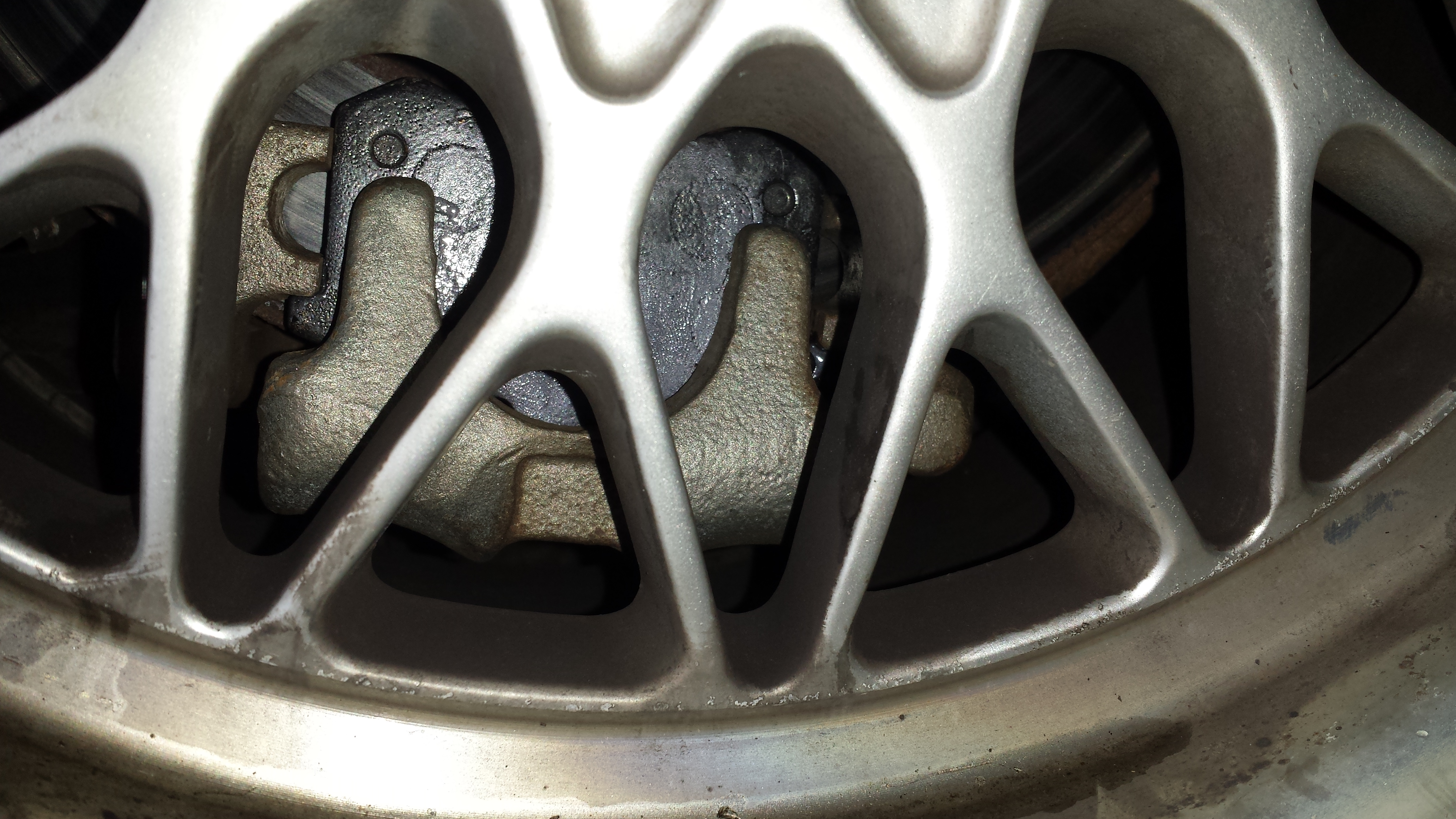

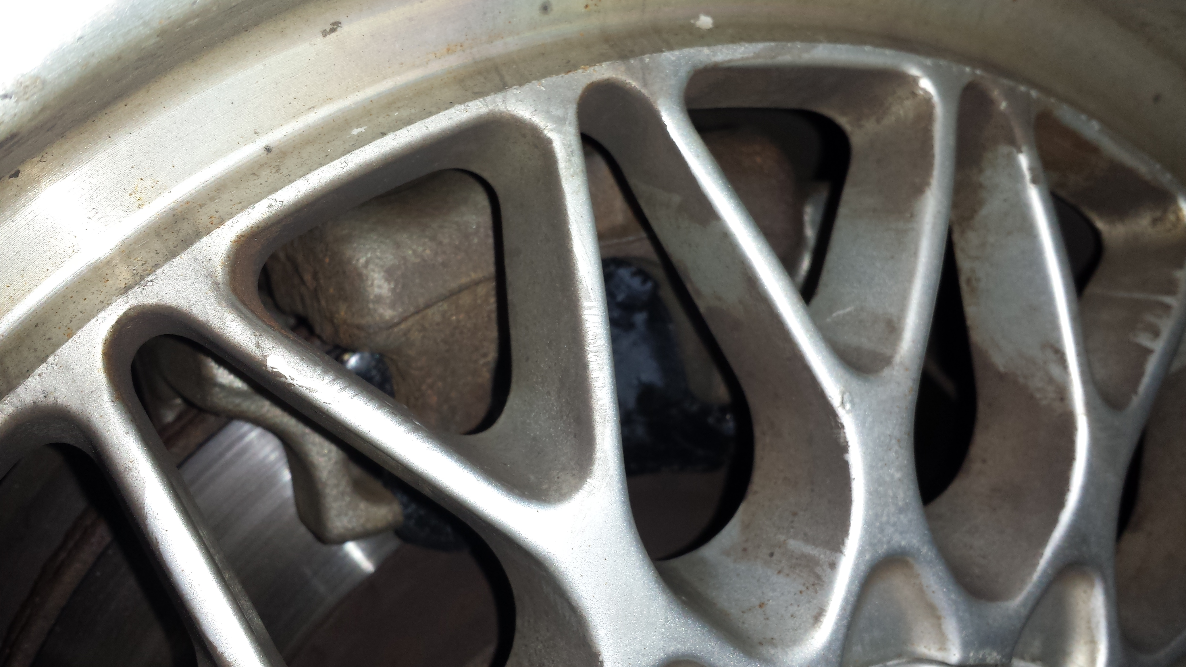

While I haven't measured the caliper jaws just yet, they do look really nice for being used. Very free movement of pins and pistons. I'm impressed with their scavenging abilities and prep work
These are in great shape. I have never had such good brakes until now. When I bought the car it had seized rears and the wrong ones soon after that. Work great now
Now I have ceramic pads all around too. With the wrong calipers, I was using one used up organic pad and one ceramic. Aweful braking like that!
