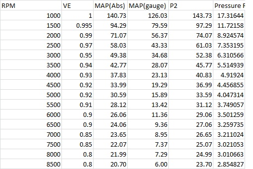

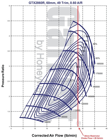

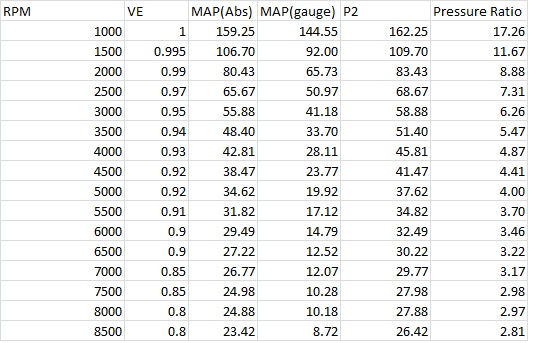

Here's what I've got so far on the Turbo with restrictor:
@32mm choke, reaching M1 we have a theoretical max Mass Air Flow of 25.6 lb/min = ~max 250 hp
Given that I've come up with the following table:
Keep in mind the Volumetric Efficiency (Ve) is a total guess and could be improved if anyone has the numbers.
What this shows is 2 things:
1) As expected Boost decreases as RPM's climb linearly
2) I'd like to be making 43 PSI of boost at 2500 RPM
Some WRC numbers:
With a 34mm restrictor the Ford Cosworth 2.0 litre version produced as much as 4.3 bar (47.87 psi) absolute at 2800rpm = 680 Nm (500 ft-lb) at 3000 rpm.
They achieved this using the Garrett TR30R (many dollaruni's to get in bed with one of these - like $15k) - here are some spec's:
Compressor housing:
.60 A/R
60mm inlet
50mm outlet
Compressor wheel:
45.5mm Inducer
69.4mm Exducer
Turbine housing:
.57 A/R
50mm V-band inlet
60mm V-band outlet
Turbine wheel:
59.3mm
52.2mm

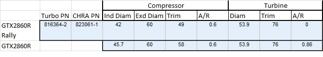

Garrett also has a GTX2860R (Rally) about $5k each with these spec's (2nd spec is the non-rally GTX2860R):
Interesting here is the A/R on the turbine is zero for the rally version, and the inducer on the compressor side is almost 4mm smaller (this is probably to accept a restrictor without forcing a really sharp diffuser angle or a nasty step, causing a low pressure zone on the outer edge of the impeller blades) with the same size exducer diameter.
Borg Warner doesn't seem to have a small enough turbo to fit my needs - too bad in that I like the EFR line...
I may need to call Aerocharger to see what they're all about - and check rally rules to ensure variable vane is legal.
As you can see from the map of the rally turbo - the pressure ratio would be way off the reservation to achieve the boost I'd like at 2500 RPM:
So, the next step is to find a turbo with the closest numbers to what I'm looking for...

1. New Calcs based on 34mm restrictor
Max Air Flow @ Mach 1: 28.97 lb/min = max ~290hp
Max inlet pressure: 9.4 psi
MAP table:
Pressure ratio's remain very similar - but boost requires grows - of course because we can flow more air and we're maxing out at 290hp
The turbine problem compounds, need moah soonah

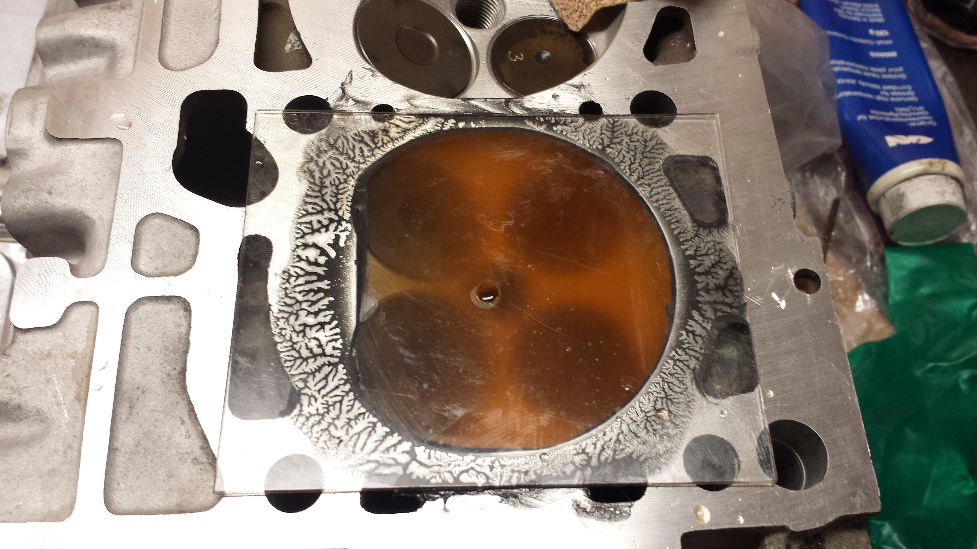

Here's my CR assuming I use the 20v metal head gasket - which is pretty darned thick at 1.6mm compressed.
CC'ing the head:
2014-06-03 22.40.36.jpg (3.07 MiB) Viewed 51329 times
Enter Bore/Stroke Designation Type  2
1 = Inches 2 = Millimeters
Enter Cylinder Bore Size   81.5
Enter Piston Stroke Length   86.4
Enter Head Gasket Bore Diameter 83.0
Enter Compressed Head Gasket Thickness 1.6
Enter Combustion Chamber Volume In CCs 43.4
Enter Piston Dome Volume In CCs Negative For Dished Pistons (Use '-') 0
Enter Piston Deck Clearance Negative If ABOVE Deck (Use '-') : 0.2
Calculated Engine Compression Ratio 9.48 :1
Total Displacement Volume 53.1 cc
Pasted from <http://www.csgnetwork.com/compcalc.html>
If I drop the head gasket thickness by 0.5 mm I get to 9.94 : 1 CR
Any ideas on how I might get 0.5 mm thinner gasket? Does that even make sense or am I just looking for a reliability problem?
I have a paper 20vt gasket (not sure if all the ports align, but I suspect they do)...
Thoughts?

Drill out thw rivets in the hg and pull the metal spacer out. Pretty common in the vw world search around google and vortex.

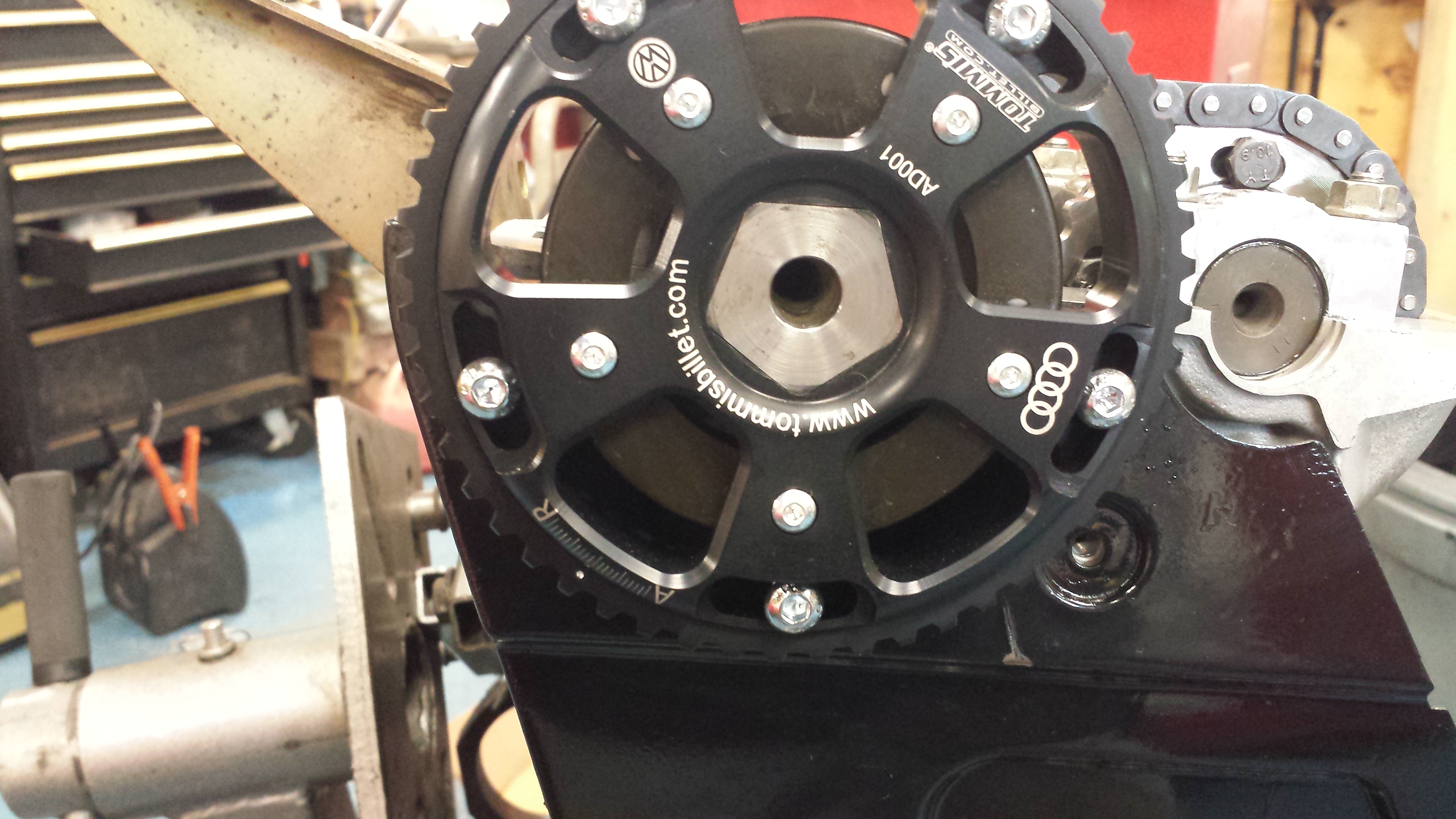

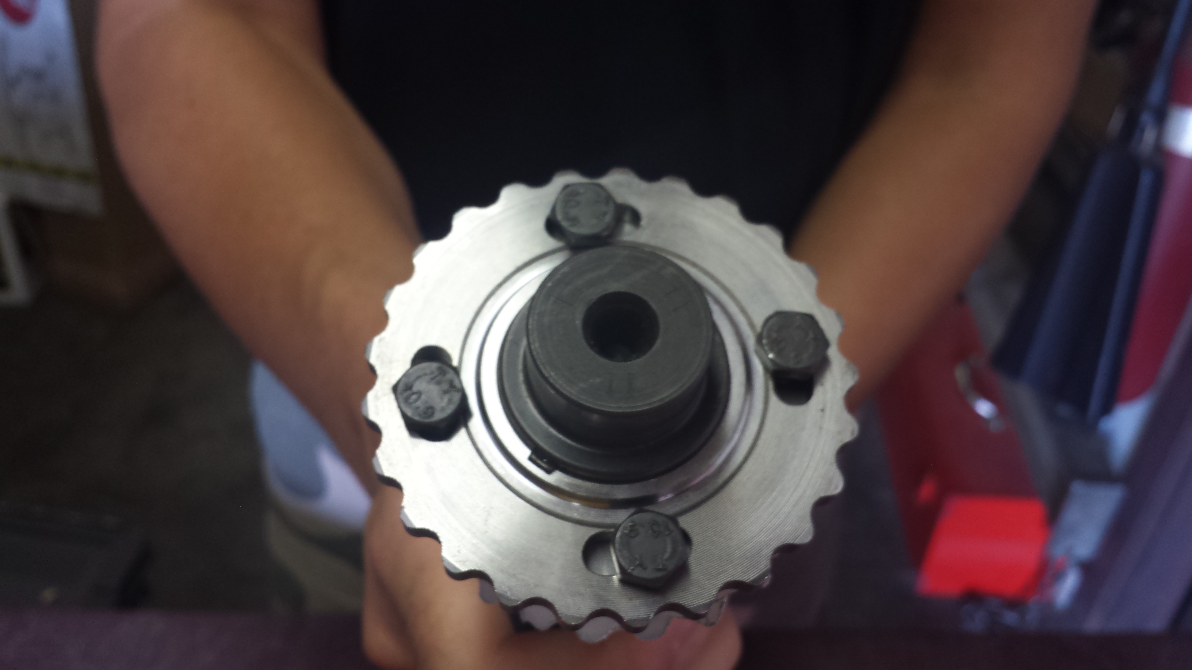

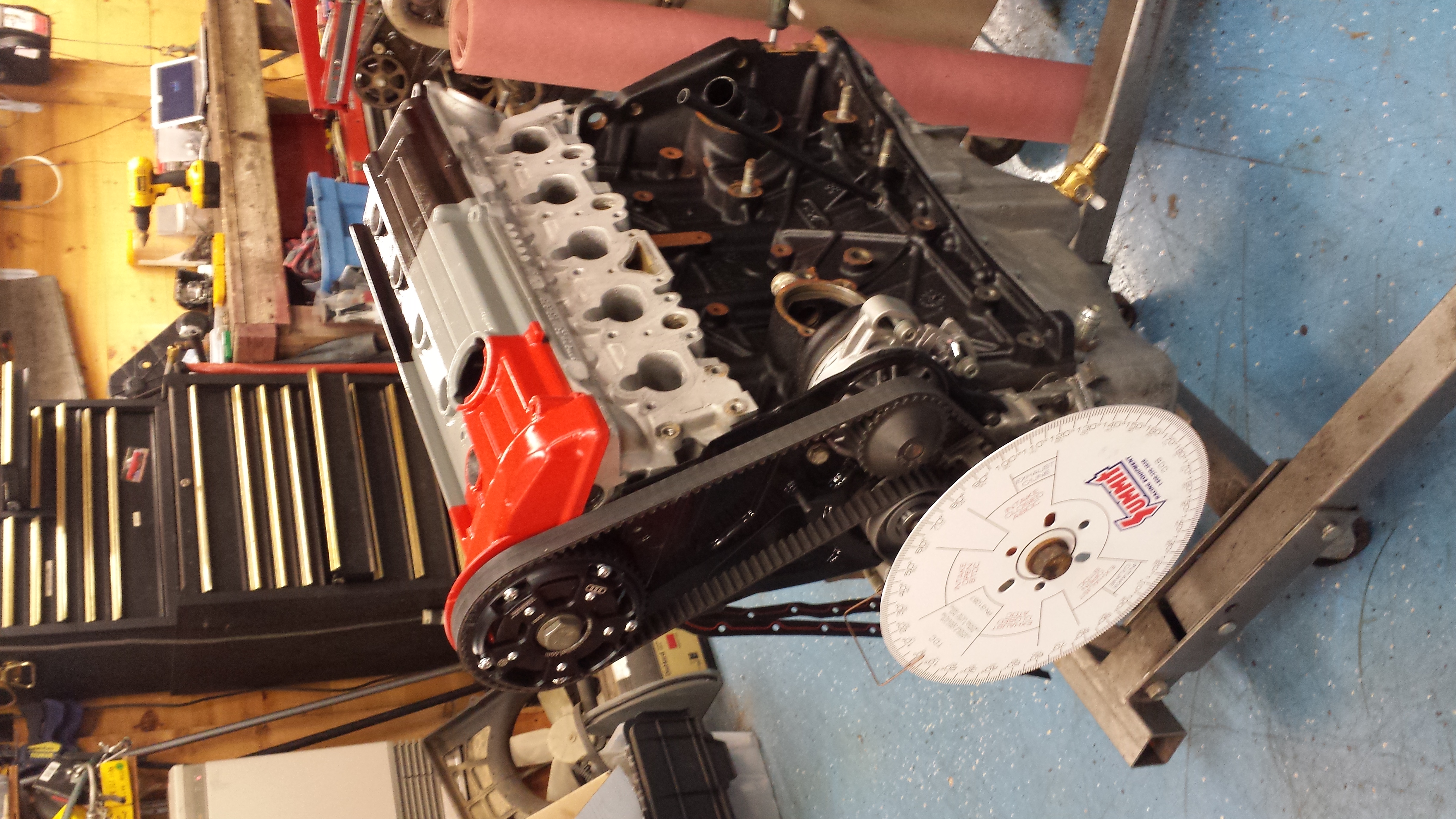

Ok - been away for awhile - I've actually been learning about indexing cams on the 20vt. Long story short, there have been many discussions about what cams to run on 20vt - I don't want to re-hash those as my particular configuration is not geared towards biggest baddest power curve - but earliest spool, with a restrictor capping possible horsepower - so here's where I'm at in terms of cams - going to start with a 7a exhaust cam and a 3B intake. The idea being that we leave the 3b intake timing stock, but advance only the exhaust timing - how to do that? With adjustable gears on both cams:
The attachment 2014-07-14 09.08.55.jpg is no longer available
Intake adjustable gear
2014-07-14 09.08.55.jpg (1.72 MiB) Viewed 50901 times
Adjustable Exhaust (adjust this one changes both)
2014-08-09 11.46.20.jpg (3.02 MiB) Viewed 50908 times

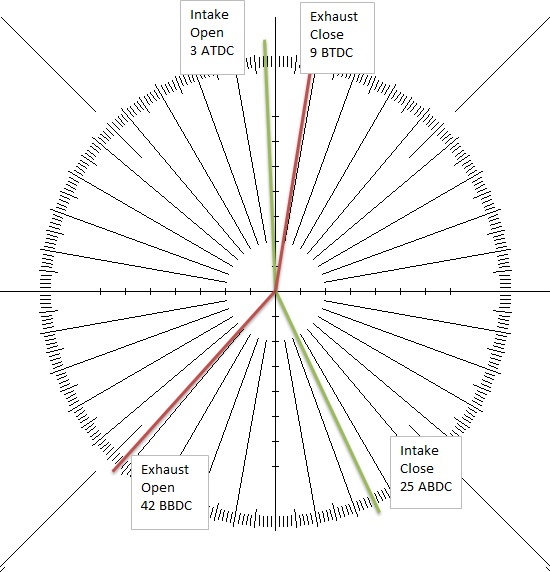

    Timing Values @ 1mm
    7a Exhaust
    Open 42 deg
    Close 9 deg BTDC
    Duration 213 deg
    Lift 10.3mm
    3B Intake
    Open 3 deg ATDC
    Close 25 deg ABDC
    Duration 208 deg
    Lift 8.6mm

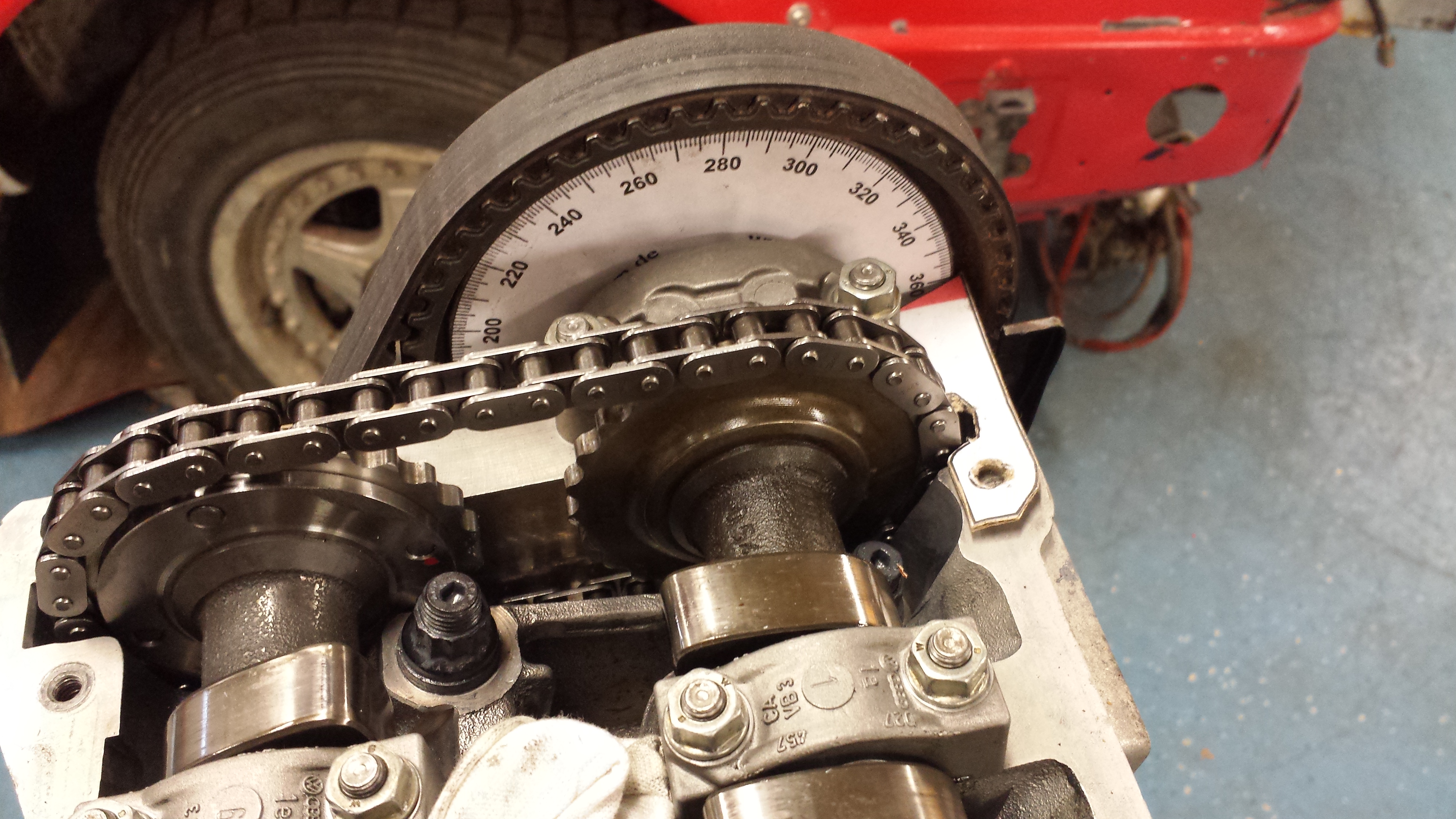

The adjustable intake timing gear did not have a TDC mark, so I needed to get both to a known point so we know what we're doing once we get to the dyno. What I've read so far is that spool can be tuned to come on earlier but you give up power on the top end. Since we have to run a restrictor, the top end is capped anyway and I figure this is a win...
Issues to get to a good measurement:

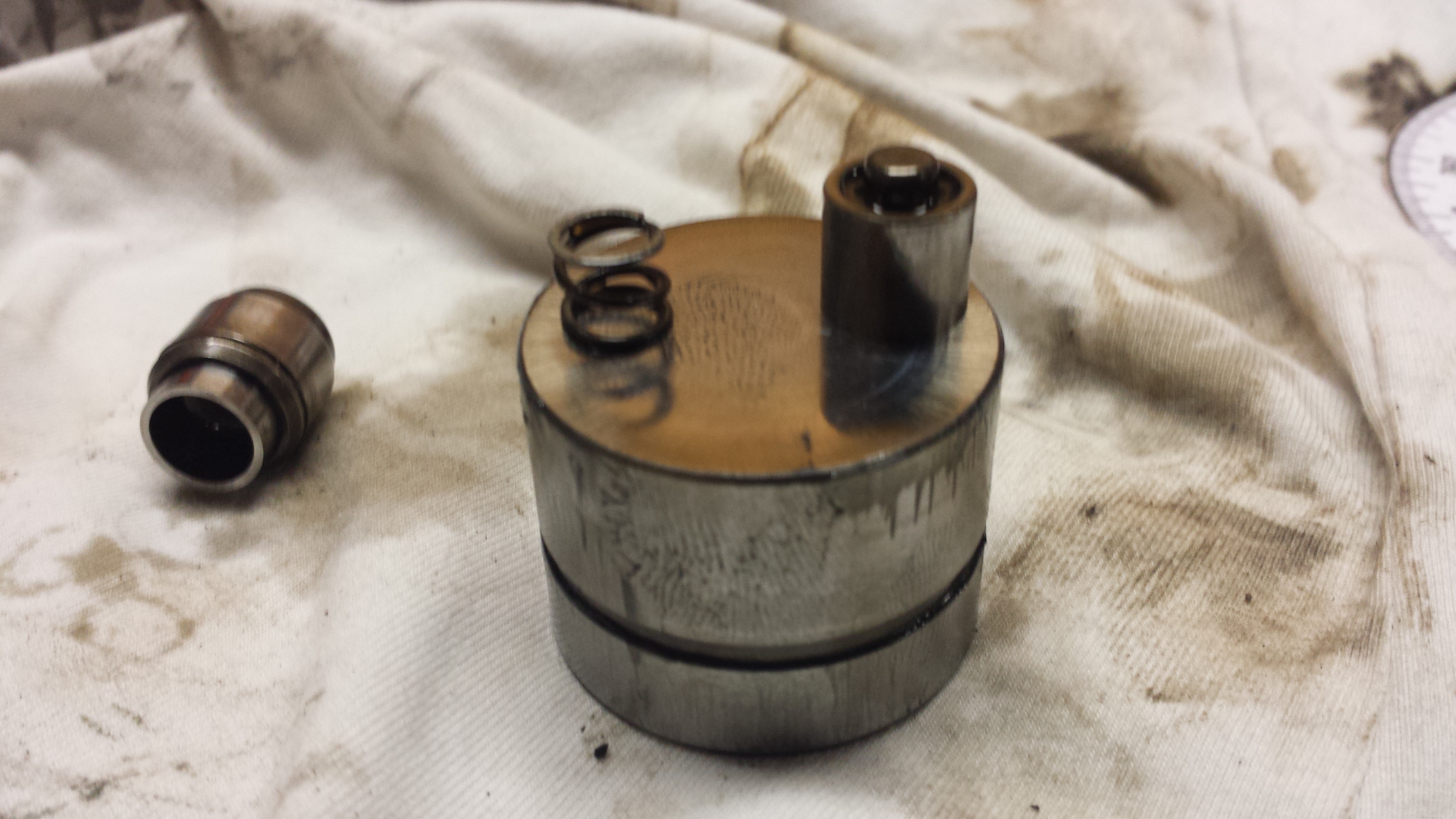

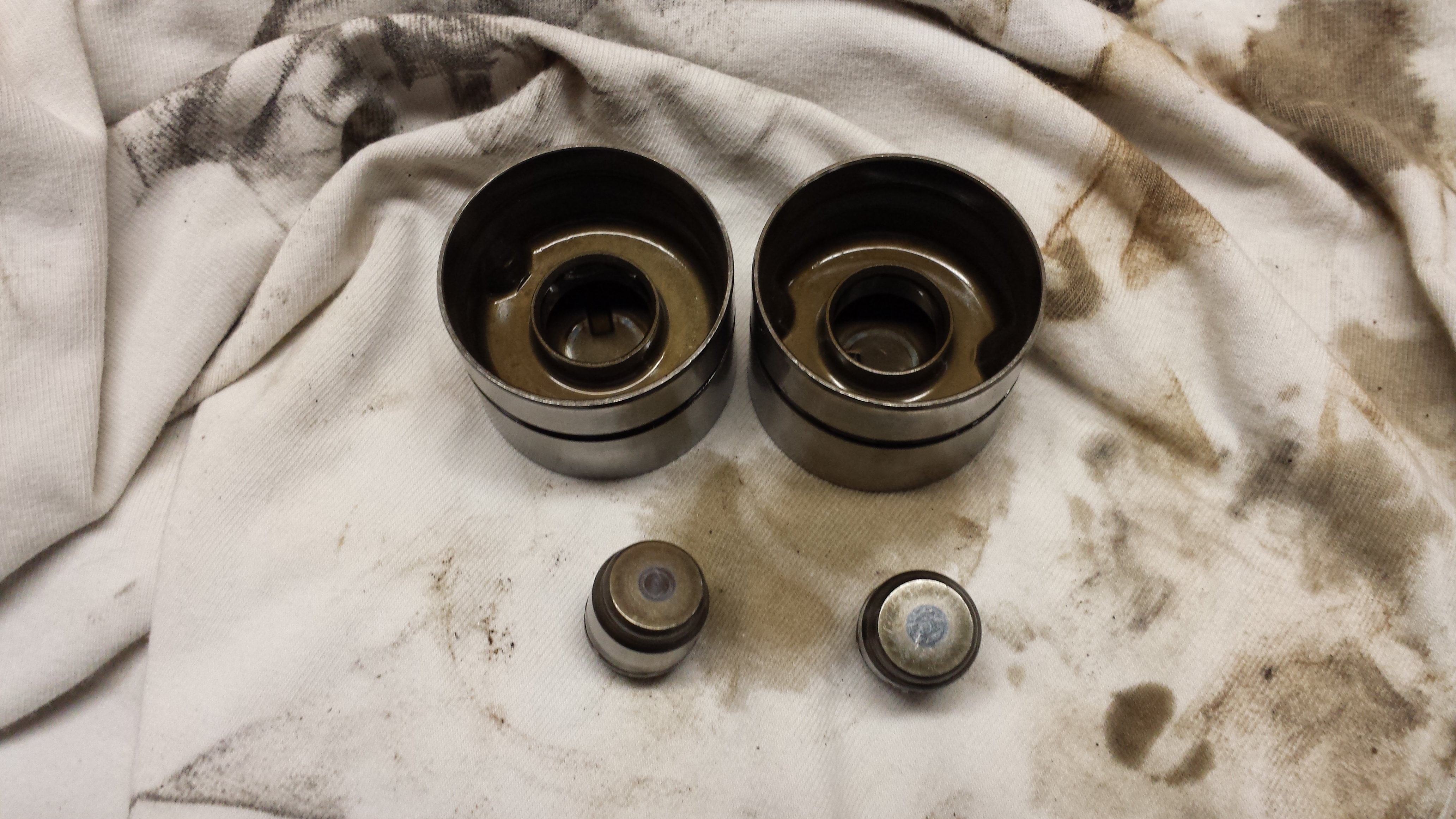

1. Finding an attachment for the dial gauge that is long and then. There's a very small area where you can get between the cam and the lifter surface to measure.
2. Getting a good zero measurement:
- Hydraulic lifters tend to squish if they don't have oil pressure keeping them pumped up, squish introduces random error in your measurements
- Solid lifters typically require machining and/or spacers to take up the lash - I believe the measurement is 14.7mm - my solution was to take the lifters apart as pictured and pour some oil in, then reassemble. This worked pretty well - I'm within 0.5 deg of factory spec on both intake and exhaust.
lifter parts
lifter parts
2014-10-26 16.11.57.jpg (2.66 MiB) Viewed 50901 times
Lifter Plunger apart
2014-10-26 15.45.02.jpg (3.22 MiB) Viewed 50901 times
In order to get the plunger out - I whacked it on my wooden bench until the plunger came out - then the spring and internal cylinder come right apart. Put it back together and good to measure (I did buy a set of new lifters to complete the build). Poured some oil in it and put it back together - as long as there isn't a ton of pressure on it - the oil will stay in and provide a consistent measure.
3. It was exceedingly difficult to get the correct specs on the 7a exhaust cam - mostly because the Bentley is wrong and maybe there are multiple versions of the 7a exh cam - so there are multiple specs out there - one has a 219 degree duration and the other a 213 duration. The above specs are what my 7a cam shaft measured out to be - the key is that it has a 10.3mm lift (compared to the 3B 8.6mm lift).
Once I had these issues taken care of, indexing to spec was pretty straight forward. Looks like we can advance the exhaust 5 degrees and still have no overlap.
Next question was how to mark the intake adjustable cam so that we could make changes fairly easily on dyno day without the degree wheel. Solution was this cam degree wheel and pointer I found on the net @ http://www.20v-sauger-tuning.de/ - be aware that this sight also suggested indexing cams by removing the plunger altogether - this may be a translation problem - but clearly that doesn't work as it reduces the lift and changes all the measurements. Anyway by printing out the cam degree wheel and gluing it to some cardboard (still want to plastify each side of each piece), I can use the stock cam gear when at the dyno (will have to swap it in and out :thumbsdown: ) and move either cam, or both by a measured amount. Each degree on the Cam wheel=2 degrees on the crank.
Cam Index
Cam Index
