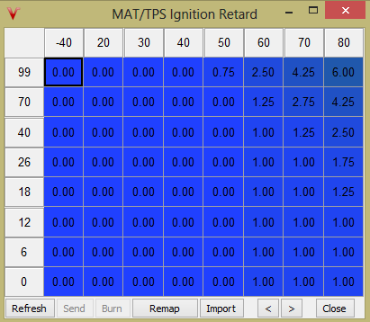

At least with VEMS, this table is very simply laid out:
This is how I used to have my 30r setup. I was very weary of intake temps and have a feeling it contributed to my last engine's detonation problems. Since upgrading my intercooler and intake setup, I've reduced my IATs and have subsequently adjusted the amount of timing the ECU will pull from the base timing map.

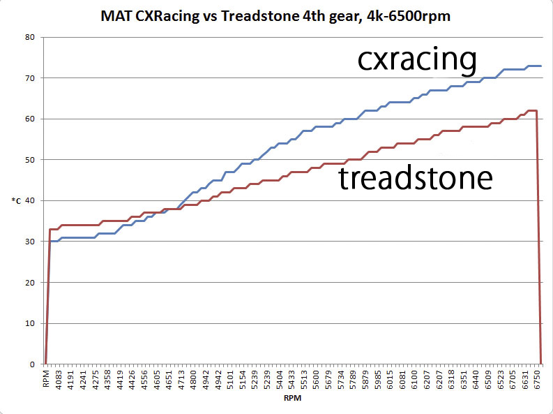

New Treadstone vs old CXRacing intercooler:

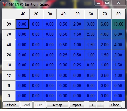

For example, based on that IAT timing retard table I posted above that I used to use on my 30R, my VEMS was pulling 6 degrees out of my timing table on a regular basis. My base timing table was only ~12-15 degrees in the upper RPM range. 6 degrees of timing is NOT a lot, one could say effectively *too little* timing to even be worth it. BUT, that was my old intercooler and I felt it was worth it to save the motor. Sure, "turn down the boost yadda yadda" but I wanted to be able to push the car and let it figure out when/how to pull timing.
This is my current IAT retard table. As you can see, it is much less conservative:

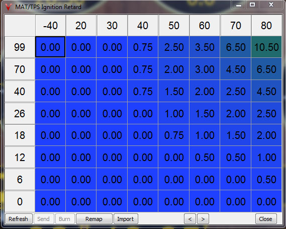

For what it's worth, the number Sam quoted is what I remember mine being. Let's pull it up to see how good my memory is...
Here we go. This is the table I used for MANY a hot (90-95F) day at about 25psi in FL with 56mm turbo. I can't take credit for making this. I just left it as is because it was working well. Also used in conjunction with a base timing map from Marc (no dyno time).

That looks about right, 6 degrees of adjustment across the board is close to what I am running.

loxxrider wrote:For what it's worth, the number Sam quoted is what I remember mine being. Let's pull it up to see how good my memory is...

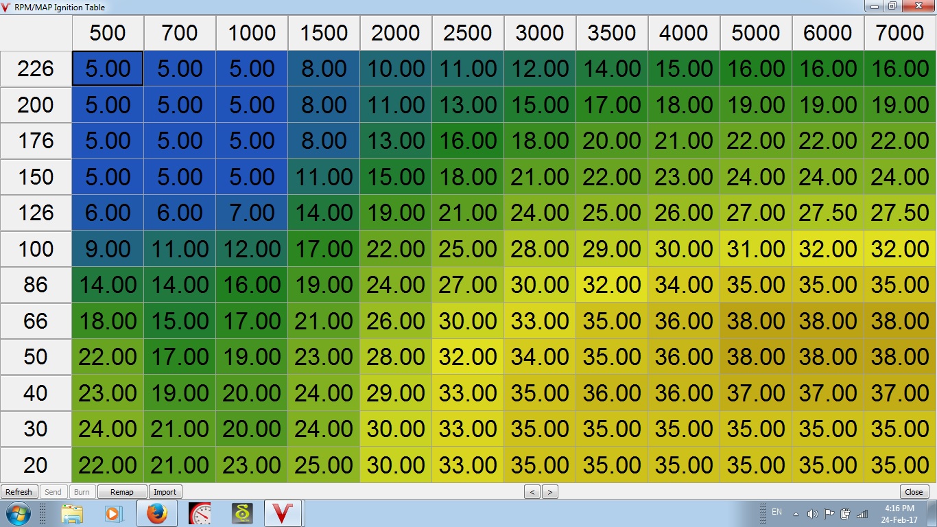

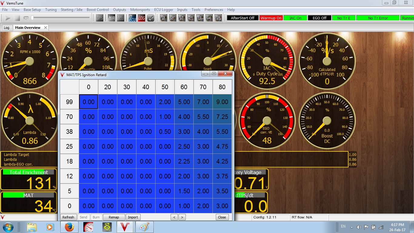

These are my ign timing and retard tables.
- MAT TPS IGN RET.jpg (422.13 KiB) Viewed 73498 times
- igntiming e85.jpg (451.36 KiB) Viewed 73498 times

That seems like a lot of iat retard and not a lot of timing in general. I was running more timing and less iat retard on pump which... Won't make much power for you on e85. 0 signs of det when the engine failed due to oil starvation.
Edit, see my revised table and the table that Chris posted. I can also post my timing table, I have it somewhere.
