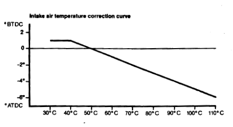

Just curious if anyone knows off-hand what the IAT vs timing pull is on these ECUs. Nobody seems to really have an answer, despite the code being cracked and well known for quite a few years.

Maybe this will help?
From the factory service training manual for the urquattro.

That's exactly what I was looking for.
thank you kind sir.
