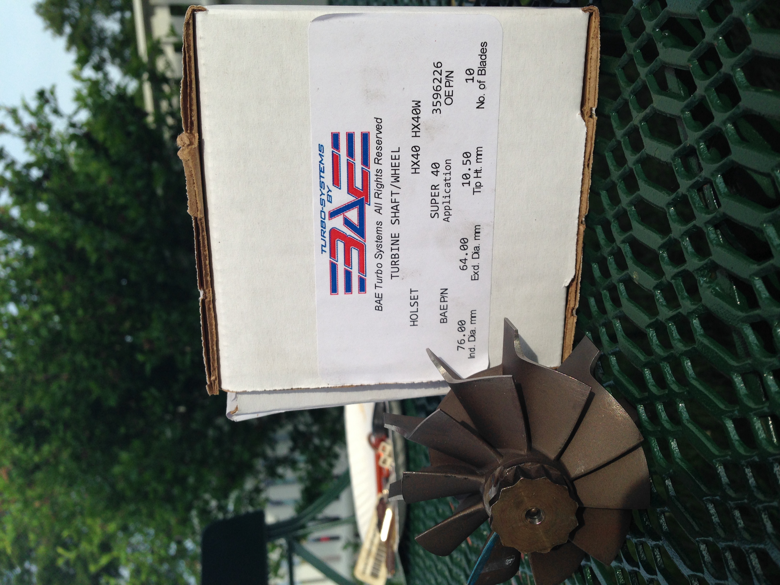

The new Super40 10 blade turbine
photo 2-1.JPG (1.59 MiB) Viewed 50935 times
new Super40 Turbine

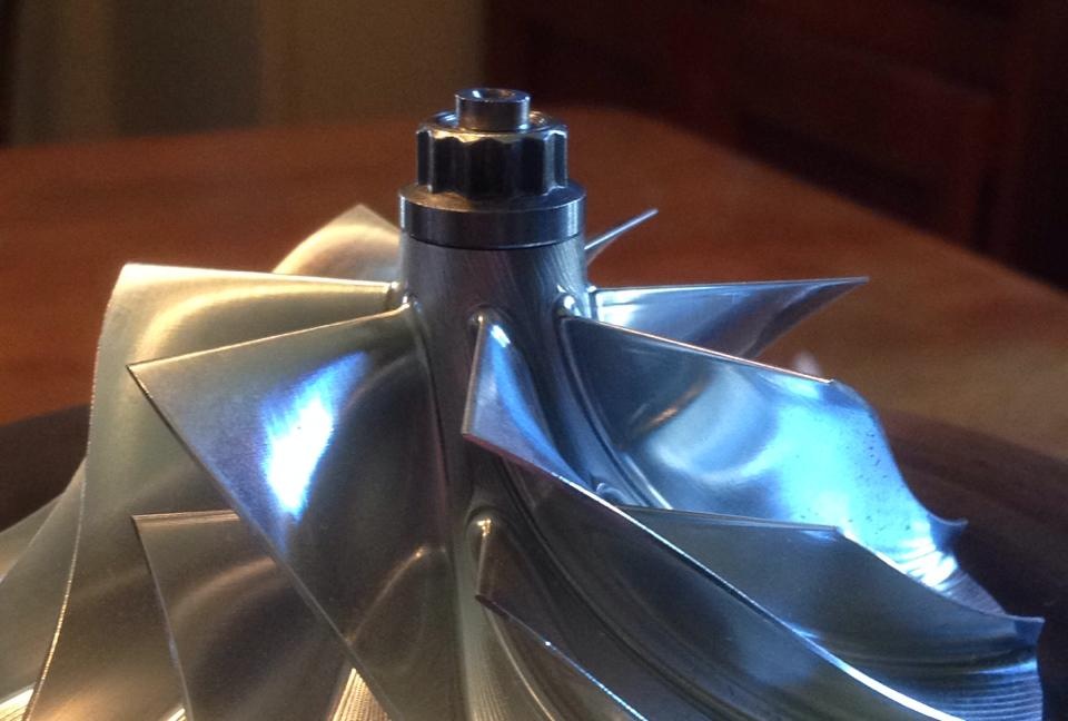

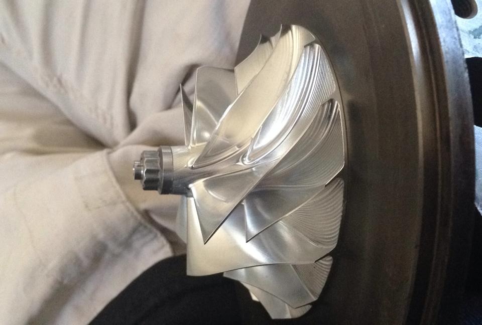

Billet 60x86mm work of art
needs a little machining
photo 4.JPG (115.65 KiB) Viewed 50935 times
The backing plate needs a little bit of machining before she'll fit the former HX35 donor

Quick update, the more eagle-eyed of you may have noticed the huge overlap of the billet wheel on the backing plate of the HX35, and ive been beating my head against a wall calling around looking for a machine shop willing to bore out the backing plate to fit the new 86mm HX40 compressor. Nobody wanted to touch it, so I took some time after work to play with the 60 year old lathe in the shop I work at. I hadn't ever done anything this precise before, ever... and I taught myself how to align the CHRA even though its a bizzarre shape. (I'm more used to working on black iron pipe...) An hour's worth of sweating and telling myself I ruined everything ensued... Here's how it turned out. (no pun intended)
At this point I was very much thinking "what have I gotten myself into????"
Though I am not disappointed with the finished product.

Re: LucidMatt's billet HX40 Super URS4: The planning phase
Awesome! I have always wondered what would go into that machining operation. Did you use a 4 jaw chuck? I should do this.
lucidmatt
Posts: 186
Post by lucidmatt »
3 jaw chuck, navy surplus lathe, no idea what brand or builder it is, but it has to be at least 2 tons of machinery. its really a beautiful machine.
Those are the best lathes (WWII era). How exactly did you chuck it?
lucidmatt
Posts: 186
Post by lucidmatt »
hand tightened the chuck, disengaged the electric motor clutch, very delicately pressed the cutting tool against the backing plate while hand turning it until the face of the backing plate made even contact with the cutting head over a full rotation. Pulled cutting head away, tightened the chuck down all the way and engaged clutch, ran it to look for any play or wobble, reset it and repeated until it was perfectly level, then commenced to use the cutting tool to widen the dish. Im sure its not the "textbook" method, but it worked flawlessly.
