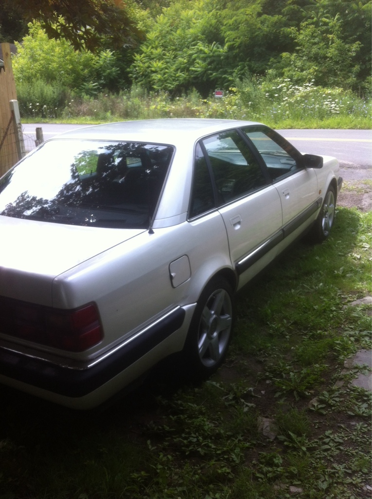

Just picked this up, going to start spending $ on it.
I'm looking for better front seats, sport or urs...heat power memory, if anyone has anything kicking around let me know. Needs valve cover gaskets bad, doing that and rear wheel bearing this week. Radio is stuck in safe mode, but I can't enter the code, it's a Bose I've tried holding fm1 and am and it's not responding. Any ideas on that?

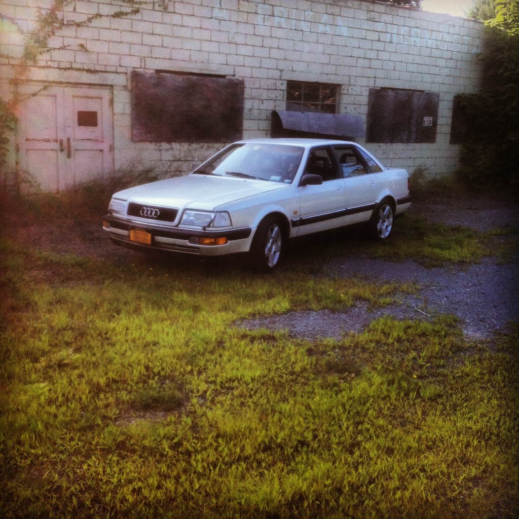

Damn that looks CLEAN, but those wheels have got to go!
scubagli
Posts: 604
Location: leeds ny
New V8
Post by scubagli »
Which there are two sets pictured, 5 spoke Allroad 17's and old 15" milli's.
And the paint is pretty haggard, over all it's in good shape.

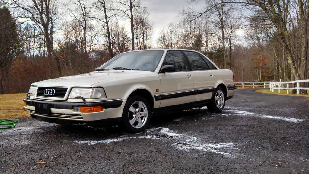

Flushed the coolant a couple more times still brown, 5 times total now, I'll get all this nasty shit out eventually. Washed her and hand waxed, paint is so bad on this car.
But she looks nice in pictures.
