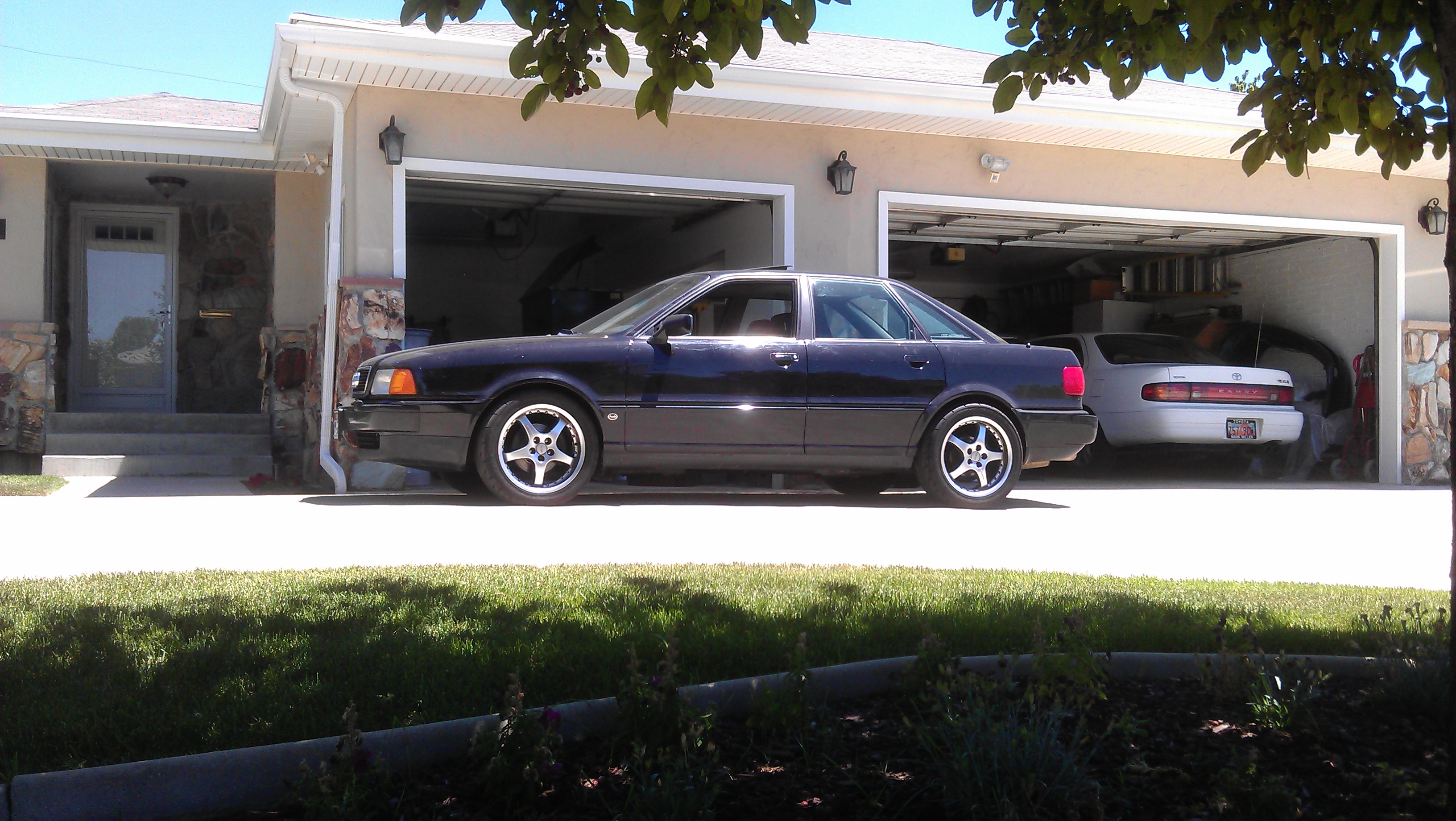

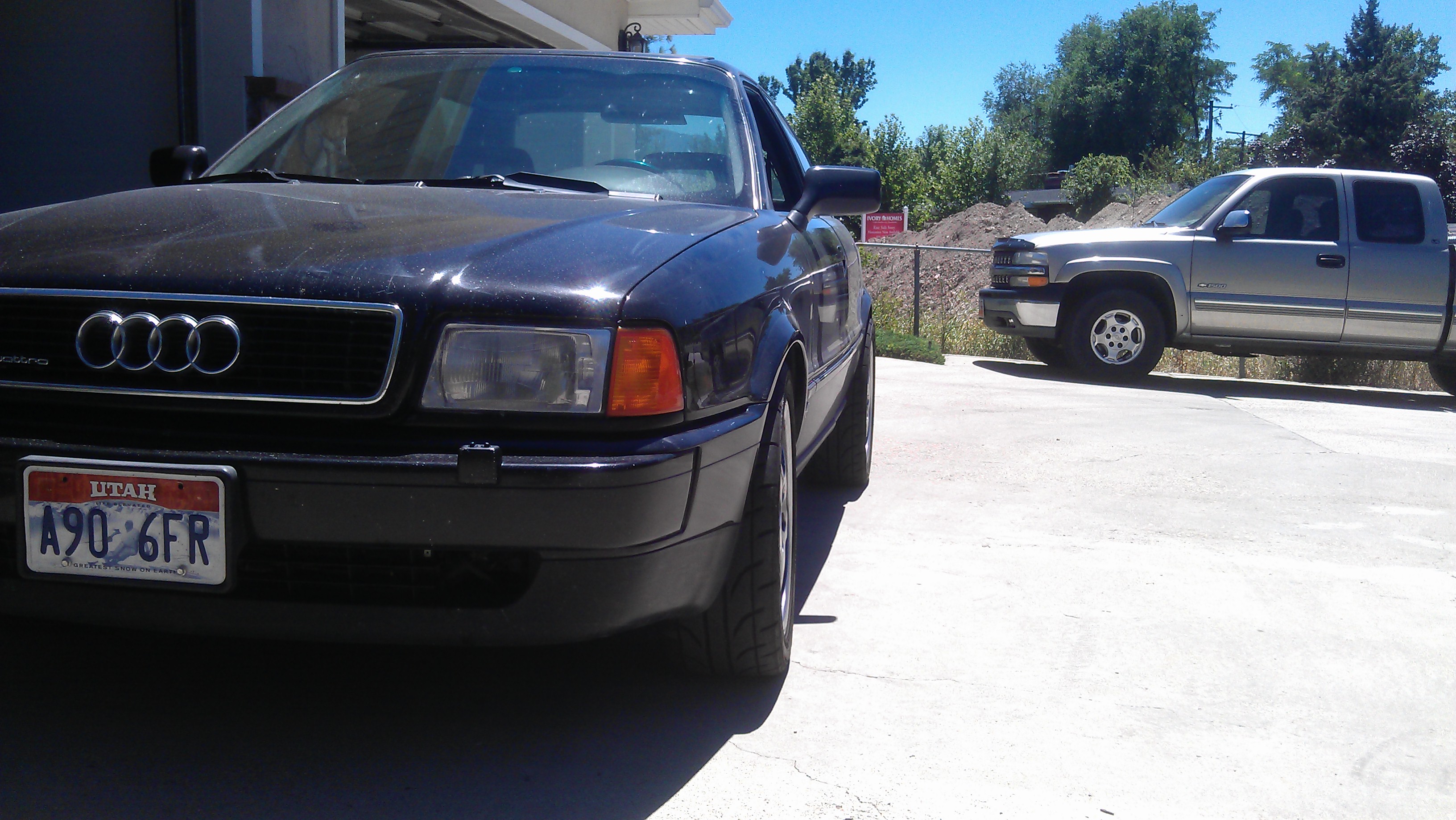

This is a car I bought a few years back because it was already set up to do well as an HS class car in autocross. It just so happened that this car happened to win first in nationals a while back. I met the owner at a pro solo in Wendover and watched him drive the shit out of this car. A few years later, I picked it up off the guy who bought it from him, so I knew the car well and what it was capable of doing. That year I took First in HS in my region. I would like to say I have the same skills as the original guy, but Im not far off the mark. The car is a great platform, but it can only get you so far. I definitely pushed the car to its limits in its class, but it just doesnt have the power to get to the next level. plus I have been having problems with the way it has been running anyway. seems to have a management issue that has exhausted my patience without any results. The engine is still good but I have had enough with trying to find the problem. Besides, the prospect sounds way better anyway.
So here is what I have
1995.5 90 Quattro Sport
Attachment:[/quote]
[/quote]Attachment:[/quote]
[/quote]
This car was already modified by me once before because of a bad 2nd gear syncro. Pulled the trans out and backwards engineered an 016 back in. I diddnt like the gearing in the 01A and this one feels much better on the top end. I have since decided not to transplant the 40V into the car and have decided to build a supercharger to upgrade the current motor. I have picked up another VEMS and have scrapped an extra ECU to scavenge the connector in order to build an adapter to pair the stock harness to the VEMS. I will pair the engine up with the vems first to be ready for the supercharger and its differences as well as take advantage of tuning the engine to its maximum potential.

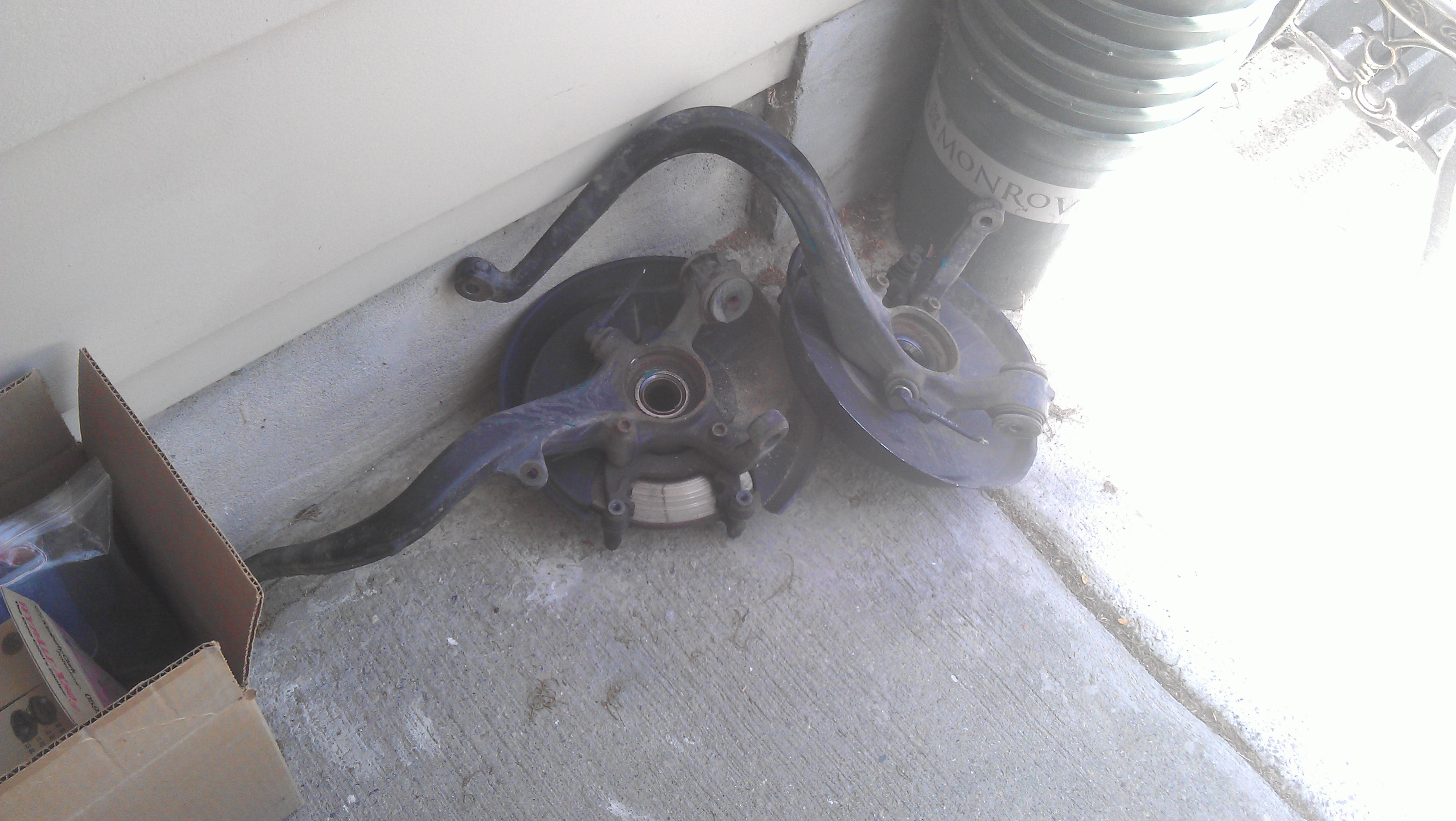

So I went to the junkyard today since it was half off Wednesday. picked up the rear knuckles off an A4q to get me started. I still need urs front hubs to finish off the conversion, so if anybody has some they want to part with, I may be game.

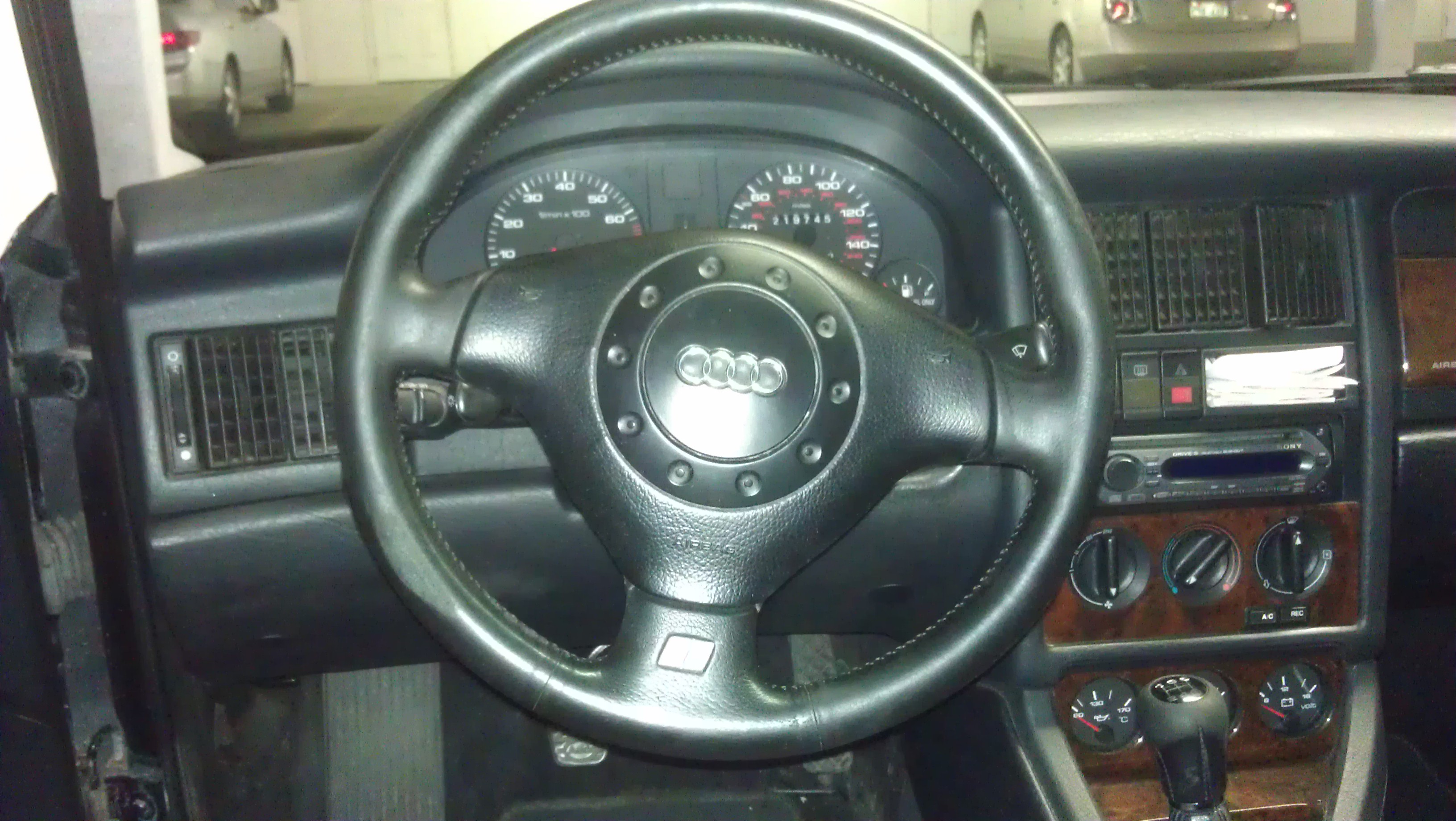

Dropped by Pull n Save for another half price Wednesday. I got a 3 spoke steering wheel and the lower shifter box. I put it on today, and I'm waiting for Chris (wheeljack) to pull and machine the front hubs for me so I can do the 5 lug swap asap.

Posted: Tue Jul 22, 2014 1:57 am
by scubadave
So sunday I finally got the front machined hubs from Bryden. I spent from 2:00 till 9:30 doing the swap, and as I got home, I was thoroughly exhausted and quite dirty. Even though I dont miss fixing cars for a living, I need to find a house with a workshop that will accommodate a lift, and buy it. Im soo far out of shape to do repair its a joke. I like my current position as an electronics tester, but its killing me slowly sitting in an office chair for hours on end. Not even close to the physical demand I was used to before.
Anyway, I fought the bearings tooth and nail, and won eventually. I could never have done it without my hub tamer. What a great tool, and was worth every penny at the time. It really does pay for itself in no time. I shimmed the hubs out to take up the slack and did not have to shim the caliper. I would not have been able to bolt up my wheels otherwise and would have been rubbing on the tie rod end. The rear knuckles I got from that A4q bolted in with only the antilock brake sensors giving me trouble.
All in all, its done and I am very happy with the results. I did not get pictures yet. Soon.

by scubadave
may have pulled a rookie move. when I installed them, I pulled them in on the inner race with the hub tool. hammering on that with my half inch air gun may have damaged the bearings as I am hearing the fronts hum. if I gotta replace em again, I guess ill have to. spending double on bearings wasn't what I wanted in the end. it is what it is, I guess.
