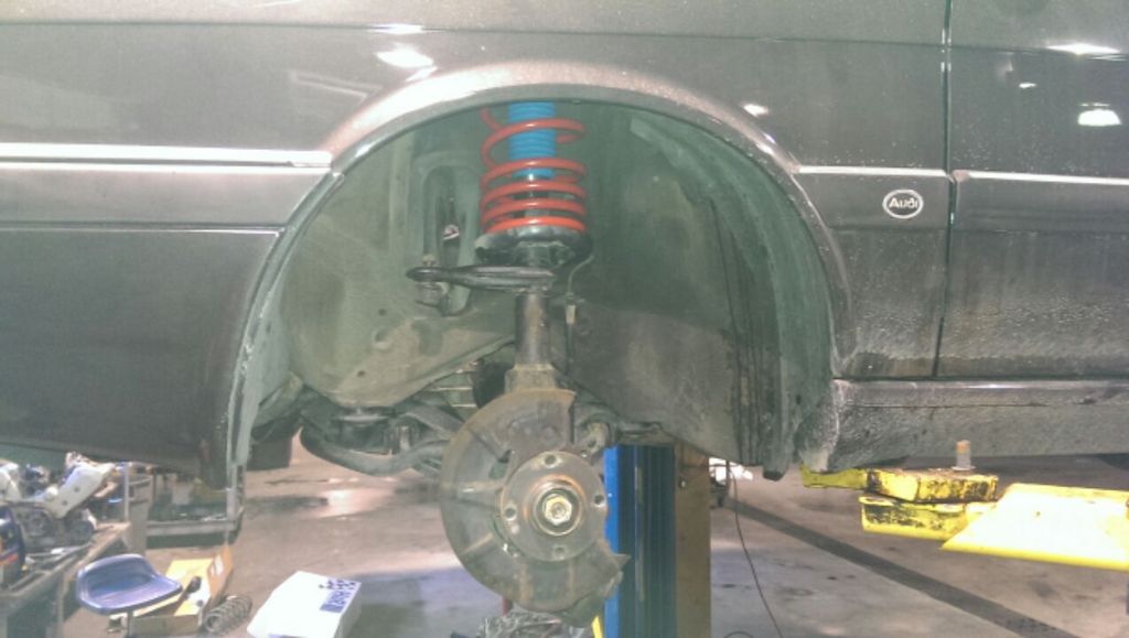

Suspension needed replaced ASAP. I hit one of these Alaskan frost heaves and destroyed one of the front strut. Probably original from 86. I have been reading about MC1 swaps all the way back from 2000. I started talking to a buddy and we decided on the AAN or 3B. I also got rid of the hideous black BBS wheels at the same time. (Those came from the dealer, they are on the original sales receipt.)

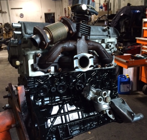

So I found an AAN in California with 100K. Bought it and shipped it.
AAN 1.jpg (88.83 KiB) Viewed 54139 times
AAN 2.jpg (66.37 KiB) Viewed 54139 times
AAN 3.jpg (75 KiB) Viewed 54139 times
Once the motor got here I had to do a ton of research on what all I needed parts wise. So I ended up going 034 and went with the 11c ECU. I did have a major hick-up on the parts order. I was sent the wrong harness and coil setup among other things. 034 was really good about it and fixed me up.

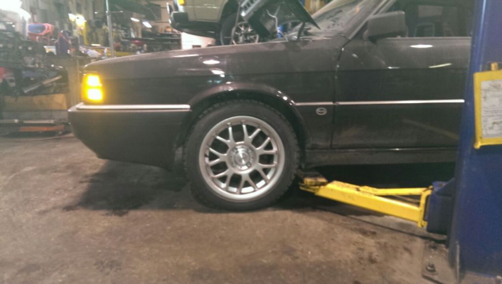

SO the car with the new wheels and suspension. Still JT'd
4k full shot 2.JPG (3.3 MiB) Viewed 54135 times
4k full shot.JPG (1.65 MiB) Viewed 54135 times
So then we did an inspection on the AAN and changed all the gaskets ect.
AAN Bearing.jpg (59.72 KiB) Viewed 54135 times

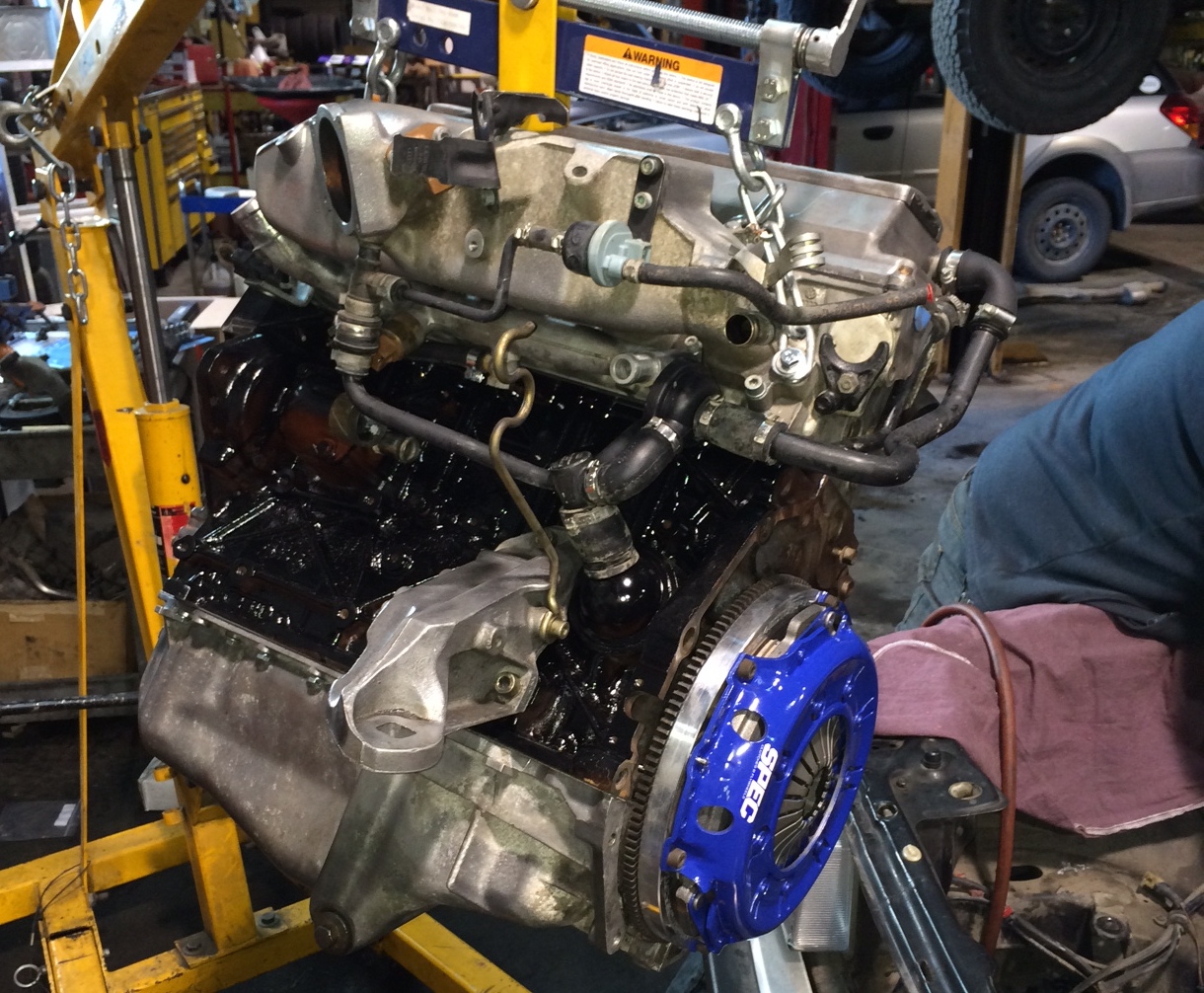

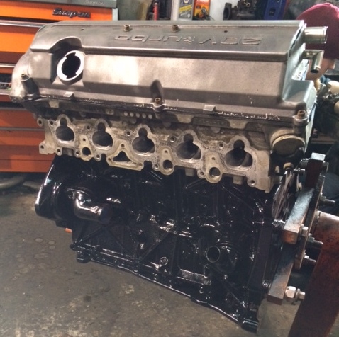

Then we got the motor put together; Clutch & Flywheel, Intake manifold, Exhaust manifold and Turbo ect...
That is a 016 Aluminum flywheel with a stage 3+ SPEC 016 clutch

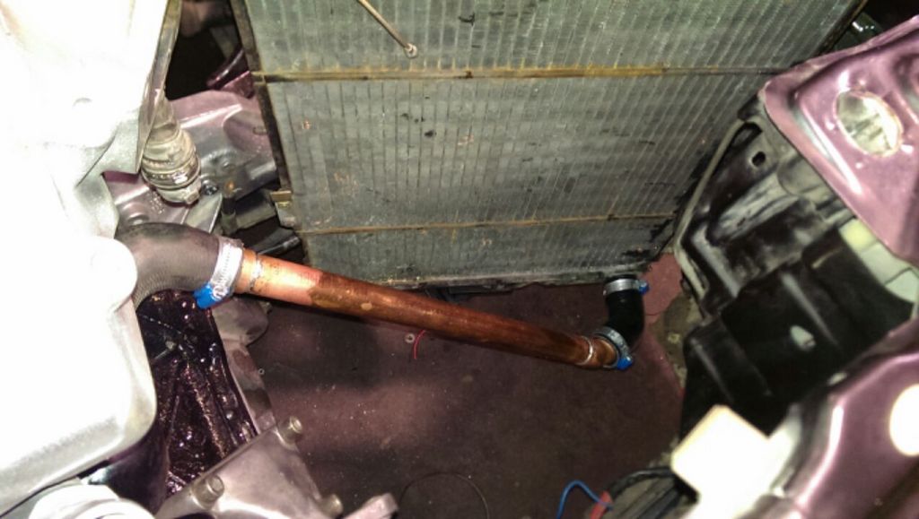

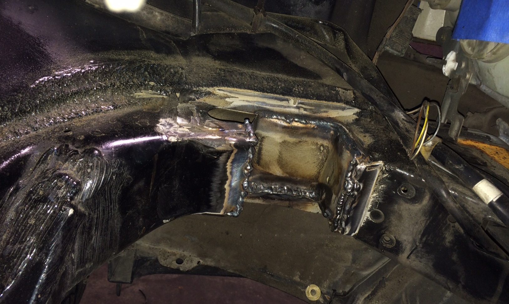

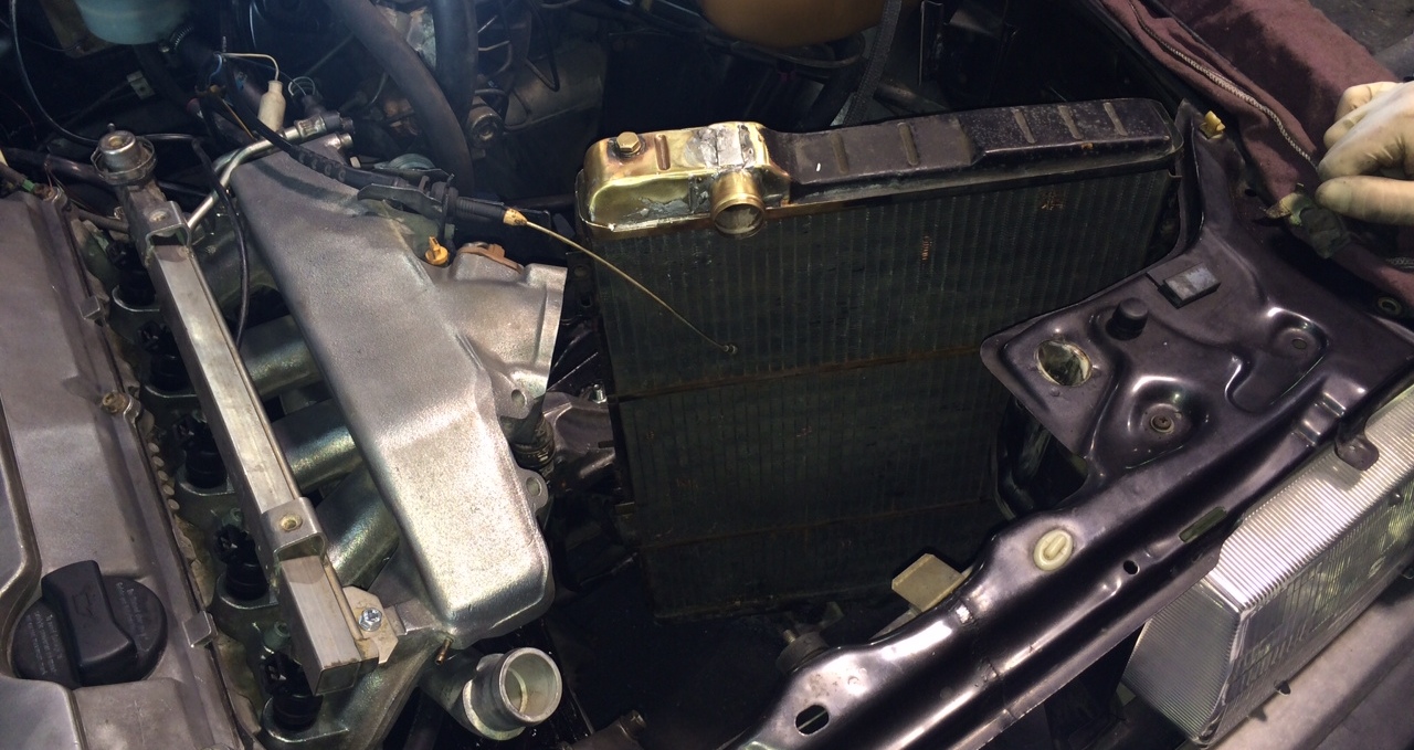

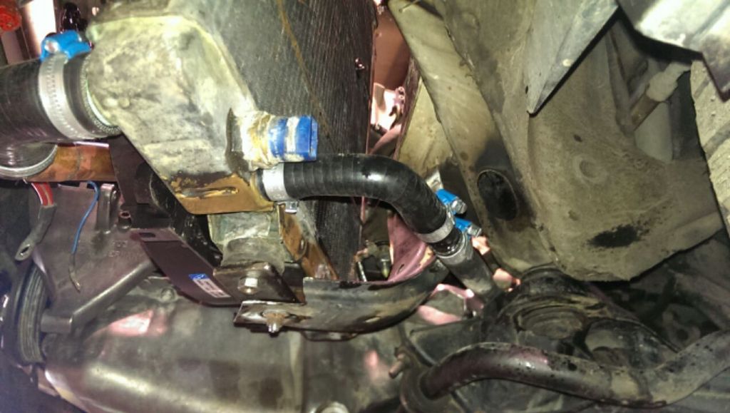

The radiator situation was kind of a conundrum. No big deal. We first cut out a portion of the Uni-body support frame to allow the radiator to articulate about 45 deg from the normal setup. We simply inverted the square "C" we cut out and re welded it in place.
RAD FAB 3.JPG (685.09 KiB) Viewed 54134 times
This cleared the throttle body. Next we cut the inlet and outlet of the radiator and re soldiered to more convenient locations. We used flat stock to cover up the old holes.
Rad Fab 2.JPG (330.96 KiB) Viewed 54134 times
Rad Fab 6.JPG (99.88 KiB) Viewed 54134 times
Some copper tubing which I later painted black. Of course
Rad Fab 4.JPG (89.62 KiB) Viewed 54134 times

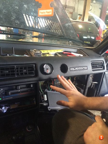

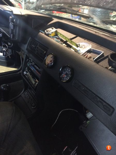

The most nerve wrenching part. Penetrating my perfect dash with a hole saw. Got lucky. I actually pulled a dash from a 4000 in a junk yard and practiced a couple hole prior to going for it. I screwed up 2 out of the 3 holes. Come to find they like it slow and steady as opposed to aggressive barraging. Those are boost and AFR gauges by the way.

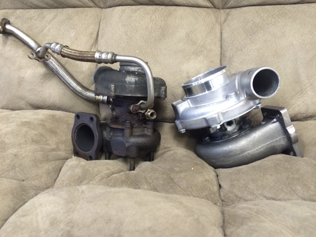

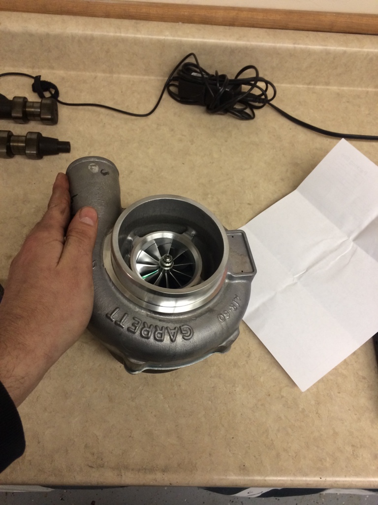

GTX 3071 w/ 4" inlet

I'm curious, why did you go with a KKK flange for the hotside instead of v-banding everything when you had the chance? Since you're getting the manifold and downpipe combo...
Re: Audi S4000 - Alaska
Posted: Thu Nov 06, 2014 7:40 am
by Namreg Rac
Because I had already bought the turbo thinking I was going to a Wagner RS2 EVO manifold. They were discontinued. Would have been better for sure though. I didn't feel like buying another hot side and doing the whole get rid of the other thing.
