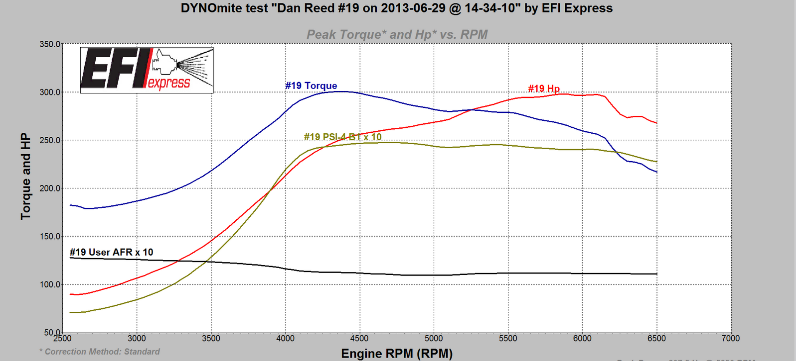

Finally got a tune on Sat up at EFI Express on Sat with all the E85 boyz.
As has been discussed there is a limit on the -6 hot side of these turbos. I was able to top out with an uber safe tune at 300awhp/300awtq @ ~25psi. Marc created a really smooooooth tune. Still waiting on the graph which I will post. My old ECU was an Uncle Bob version and pinged like crazy. No pinging here despite the ~100 degrees temps in the shop.. and damn near 100% humidity. While I expected more, I am very happy with the power delivery and the smoothness.
One of the E85 boyz had the same setup (Except for a port/polish'd head) and hit 405awtq on the corn, so I guess if I ever want to go that route I know approx what I would get.

aforementioned dyno graph

Hank wrote:Nice. 100% humidity and temps is not too friendly to any turbo, especially one that is on pump gas. If you are really feeling down on the power output, as Marc to overlap a 3071r at 25psi in similar conditions with your billet rs2, an you will start to feel better. On pump gas, the rs2 is not giving much, if any up to a 3071r.
It's not that I am feeling down per-say, just been a long road to feel like I got back to where I started from. the results are pretty much around others with RS2 and MRC/Pastore and other RS2 tunes, albeit the power in my case is delivered quicker, which is nice, and the tune is safe and obtaining the power at a lower PSI.
That said, this tune is much much smoother that my ECU was before... doesn't feel as powerful because it doesn't have the crazy "shot out of a cannon" feel of my previous but the power is smooth and pulls longer.
