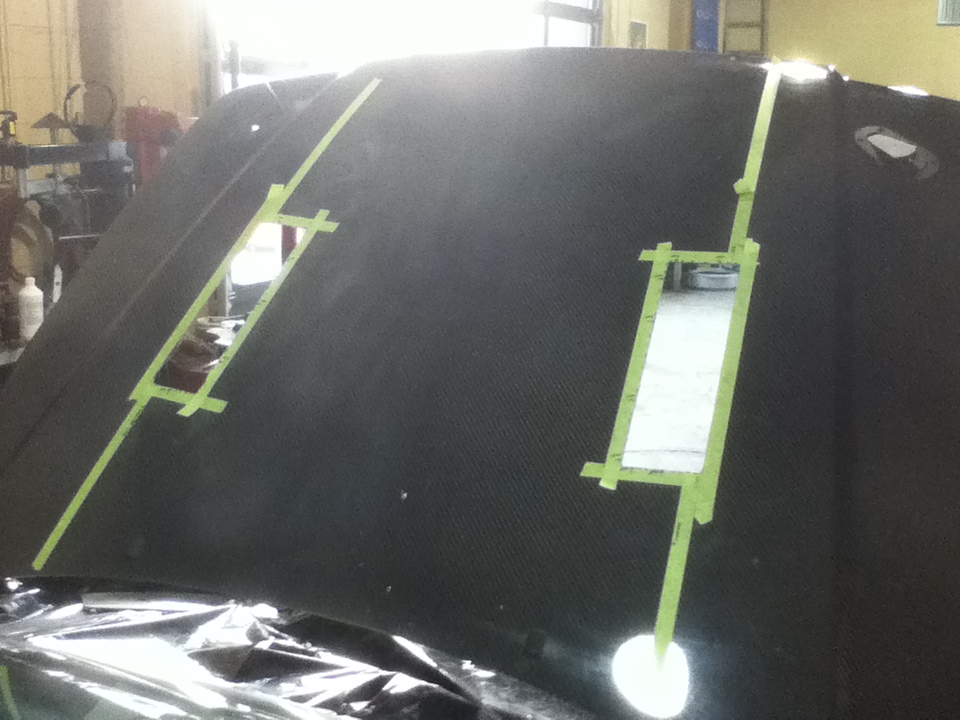

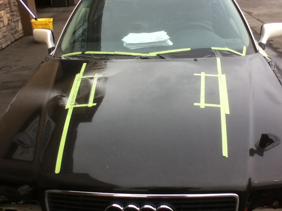

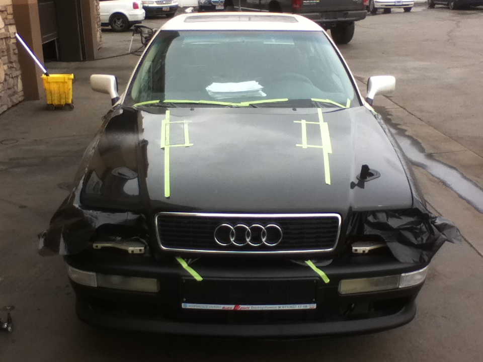

After looking at the car and knowing what kind of HP I will be running I decided that some louvers were in order to vacate heat from both the turbo charger and the radiator to take car of not only heat soak but also the hight heat under the bonnett. It took me about 4 hours to get everything lined up but I finally started the cutting
Starting the hood louvers

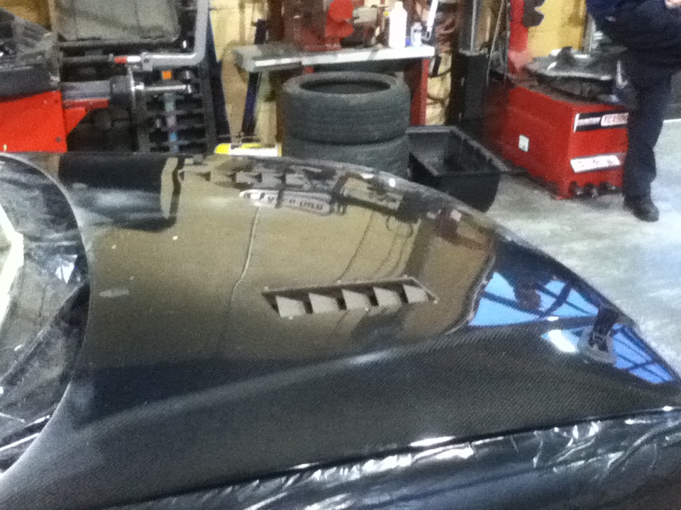

More pics of the cut outs

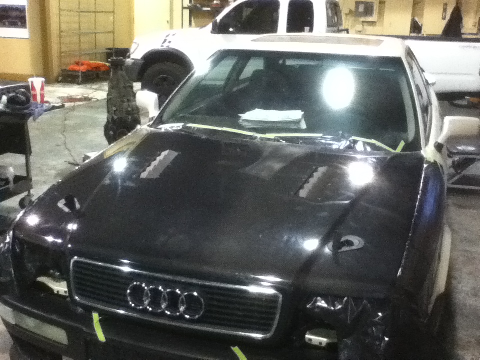

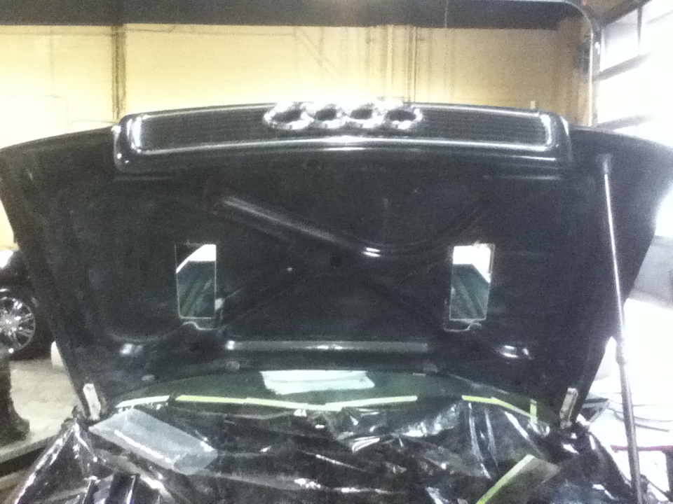

Wow huge holes , got to get it right the first time kind of scary

Had to make sure to take my time only get one shot at this :hide:

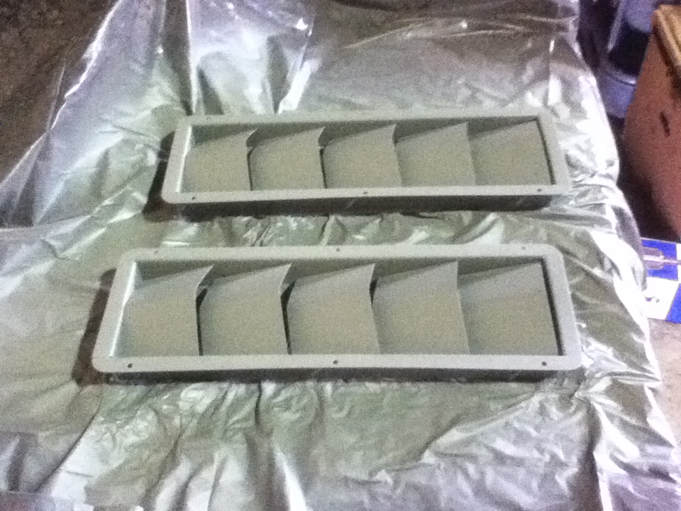

Here are the louvers primer etched just before the final coat of paint

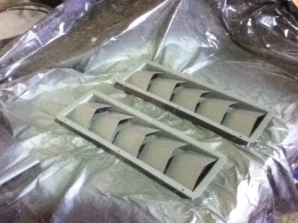

one more pic

Painted and installed in the hood, forgot to take a pic of the final painted piece before install but you get the idea, Painted flat earth brown.

Did a test drive today and when the fan went on it was blowing right out of the vent very very functional, I know some might not like it but I have to say for heat evacuation it hits the spot. Also the one over the turbo is brilliant.
