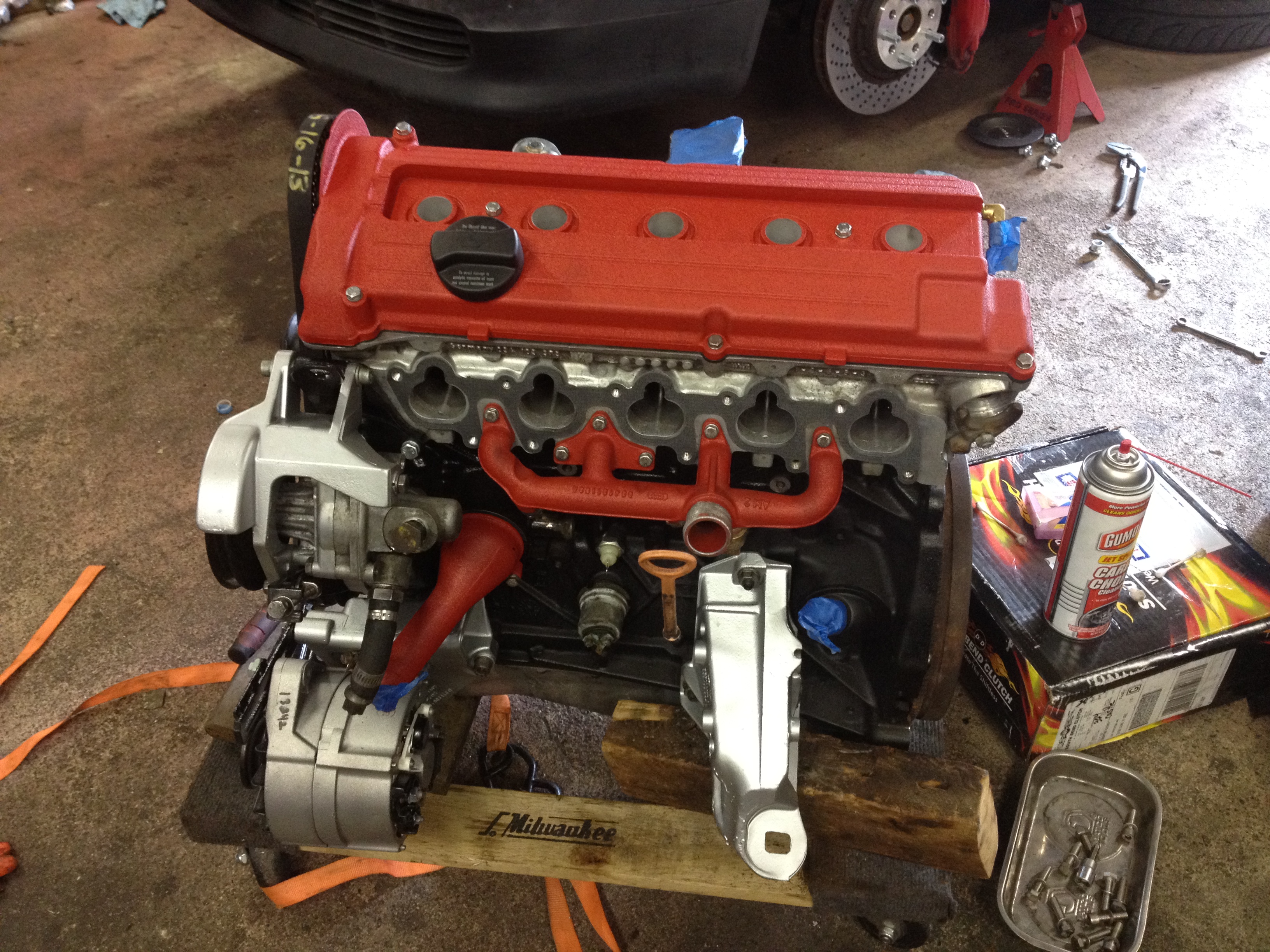

Let me introduce my project i have been working on for the past 2 years or so.
Beforehand I would like to Thank to all the people/friends who were part of this project for their support.
I took some photos along the progress and will start with the current photos and description and work backwards
Here are some details and i will try to upload photos of the build in the same order.
Body
- 1991 Audi Coupe Quattro
- B4 hood and rs2 head lights - HID's low / high beam and fog lights
- Audi S2 front and rear bumpers
- Welded and braced front and rear strut towers
- Fully restored under chassis
- Aerocatch hood fasteners
Engine menagement
- Vems + EFI Express custom wire harness + tune by Marc
- Battery relocation kit
- Flex fuel e85 sensor + gauge
- anti lag

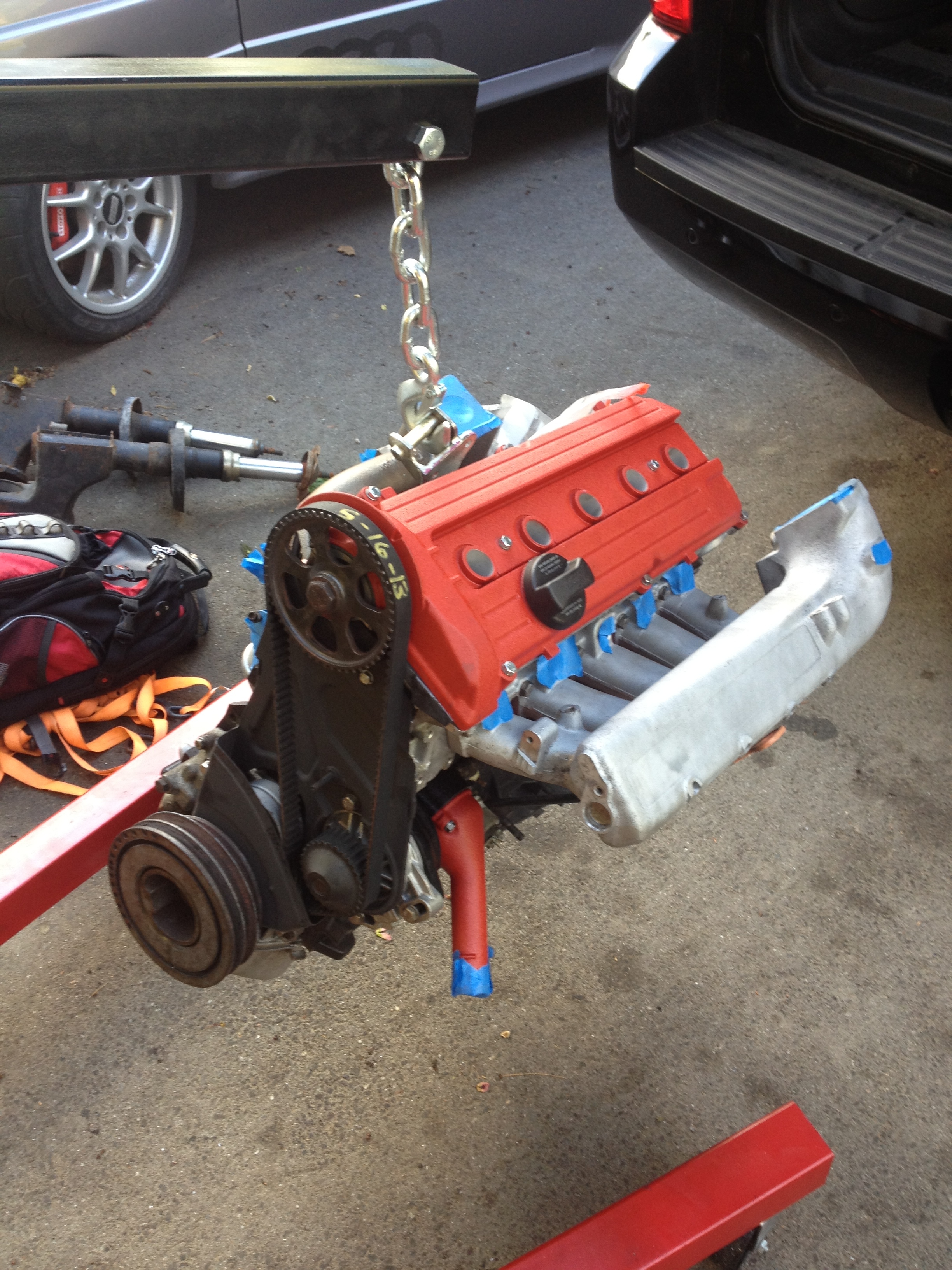

Engine
- 3b motor
- Stock pistons
- Scat rods,
- Coated bearings
- Brass distributor gear upgrade
- Phenolic spacer
- GT 3071r turbo anti-surge inlet, 3" V-Band outlet
- Fully rebuild head
- Individual coils conversion
- Replaced all coolant hoses
- Fully rebuild head with new valves (Intake / exhaust), new guides, lifters
- ARP Studs
- No AC
- all gaskets, seals replaced
- hardened timing belt cog gear
- timing belt kit , tensioner, water pump

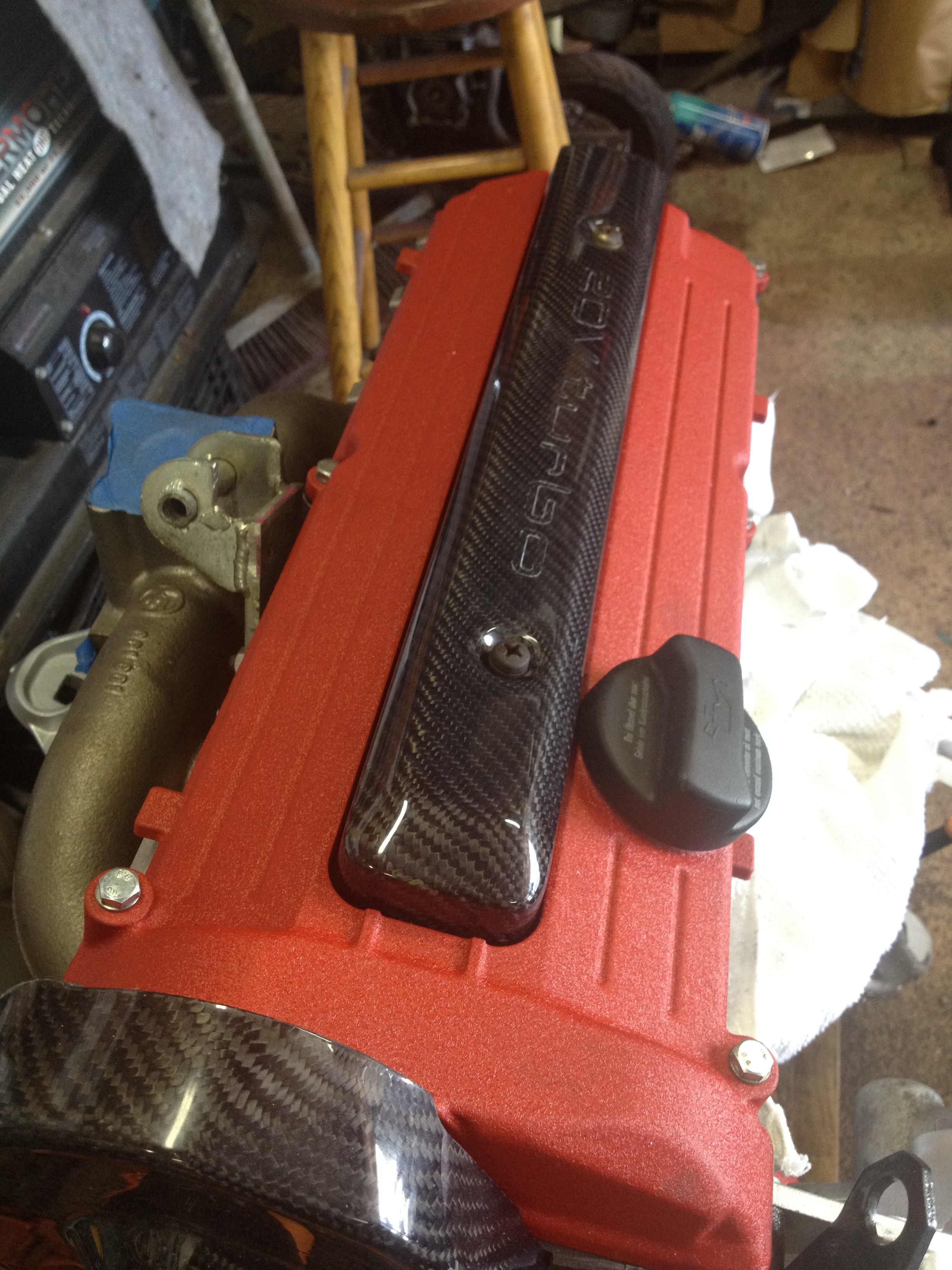

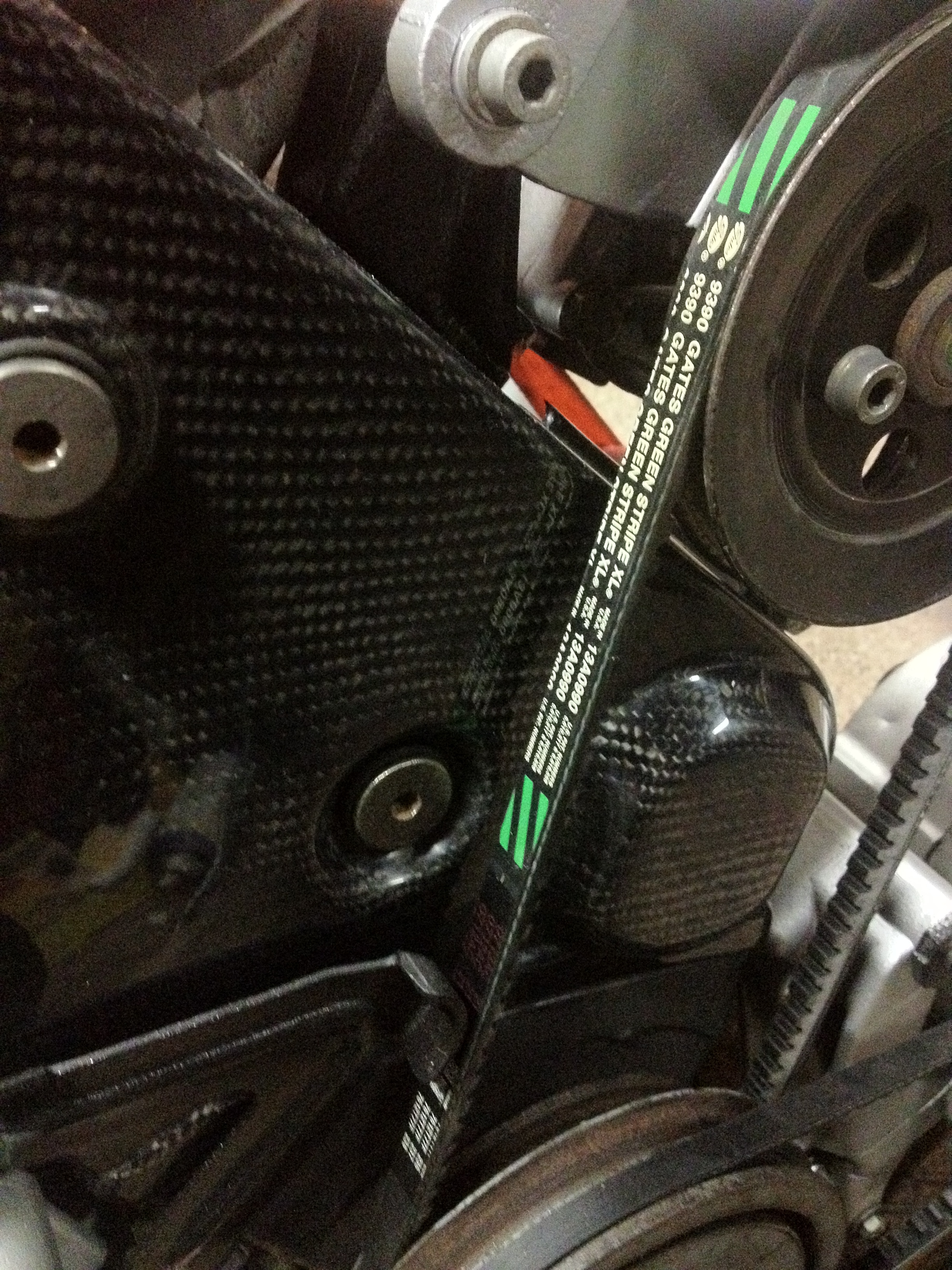

- some carbon fiber dressing along with red wrinkle powder coated valve cover, thermostat housing and water manifold.
Fuel delivery
- EFI Express fuel rail -6an
- 1200cc injectors
- Aeromotive fuel pressure regulator
- ss braided fuel lines

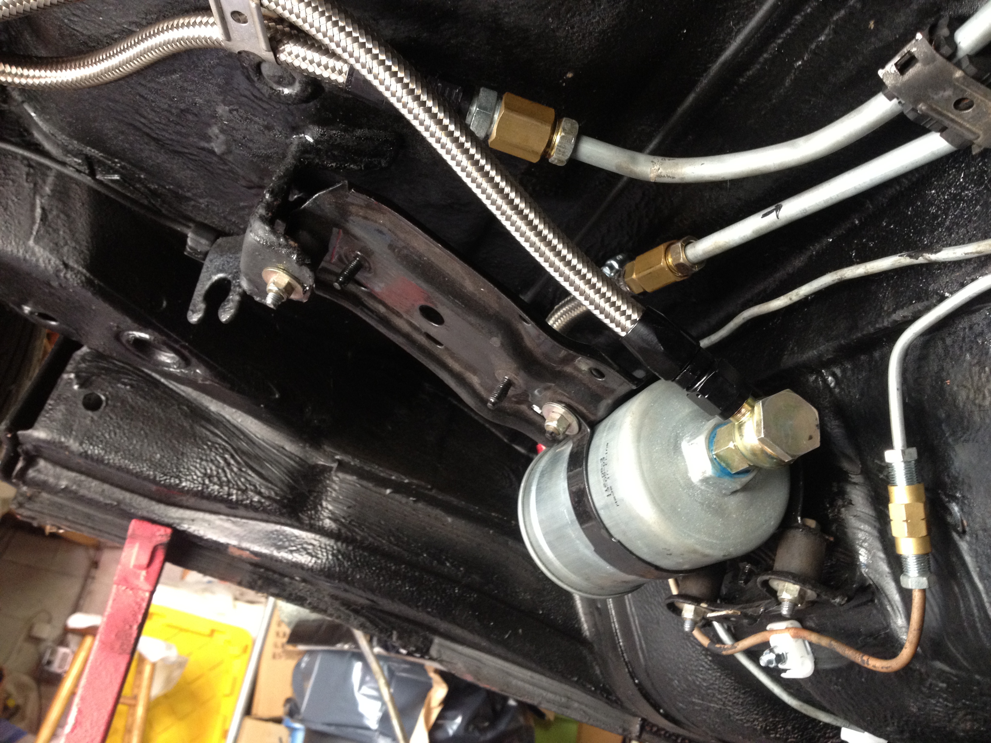

- Steel hard lines front to back under chassis

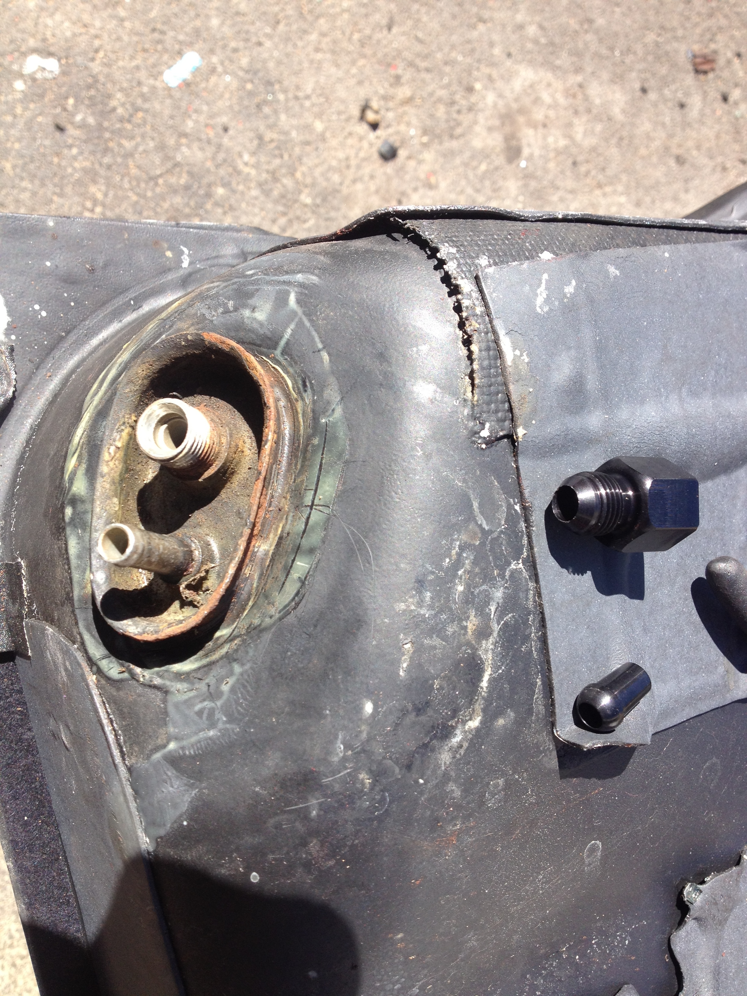

- Refreshed fuel tank
- 93oct /e85
- Fuel tank plastic hose delete

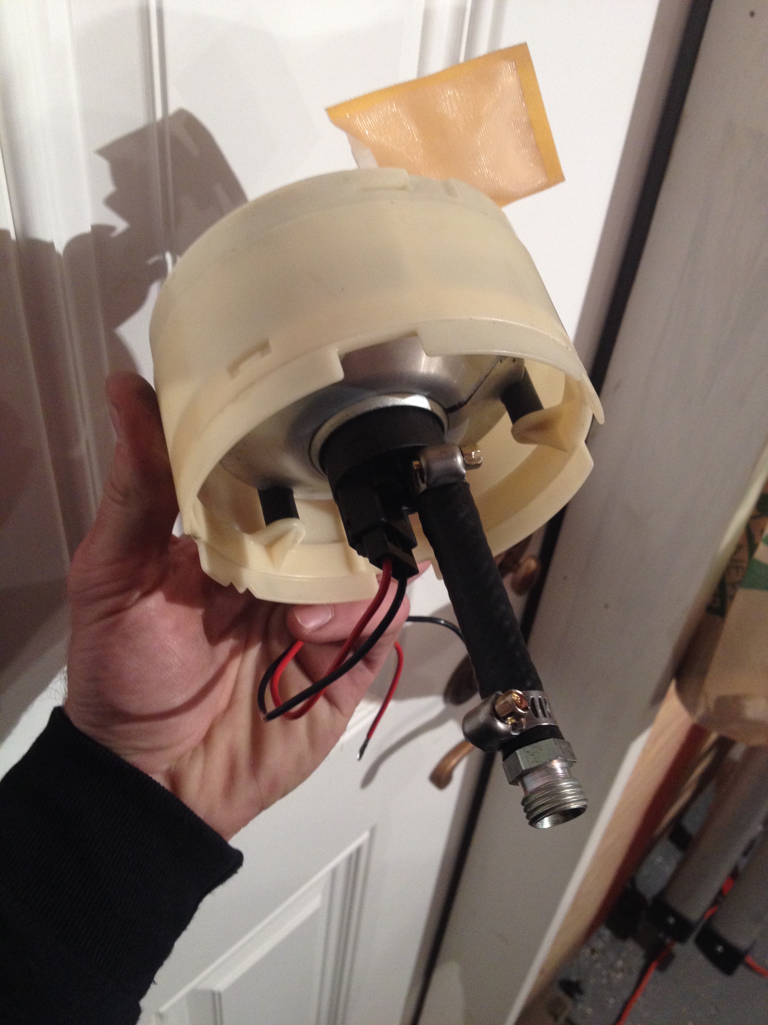

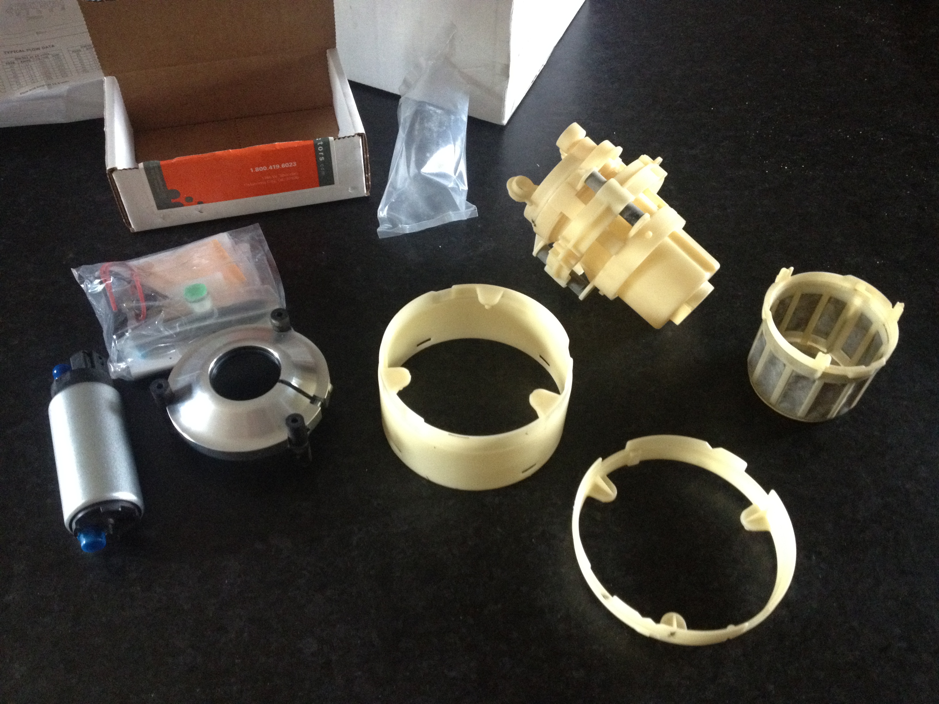

- upgraded fuel pump
- Intake
- s2 intake manifold
- Tial 50 BO
- s2 IC
- Silicone hoses
Exhaust
- Wagner Sport exhaust manifold
- Hanks downpipe 3 inch
- 3b wastegate
- 3" all the way with 3" rear magna flow muffler
- V-band connections
Interior

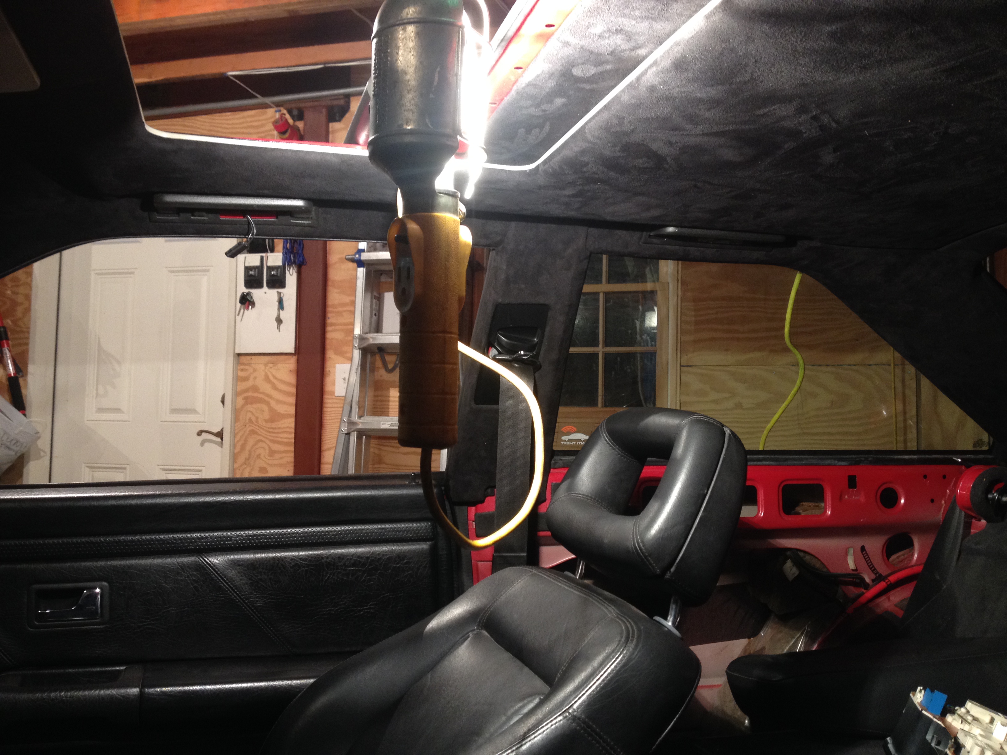

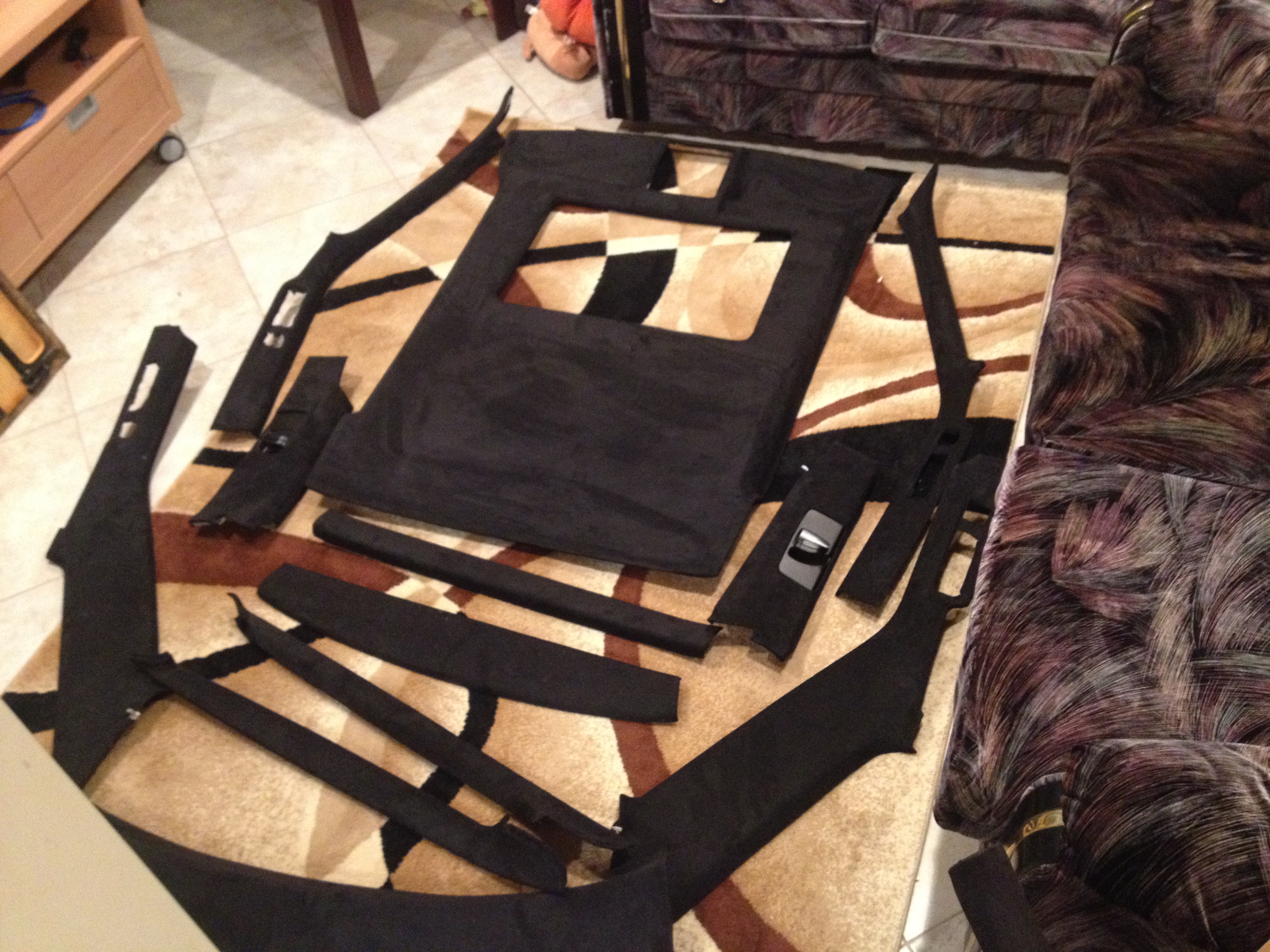

- All upper trim A B C pilars and head liner in black suede
- s2 black leather trim

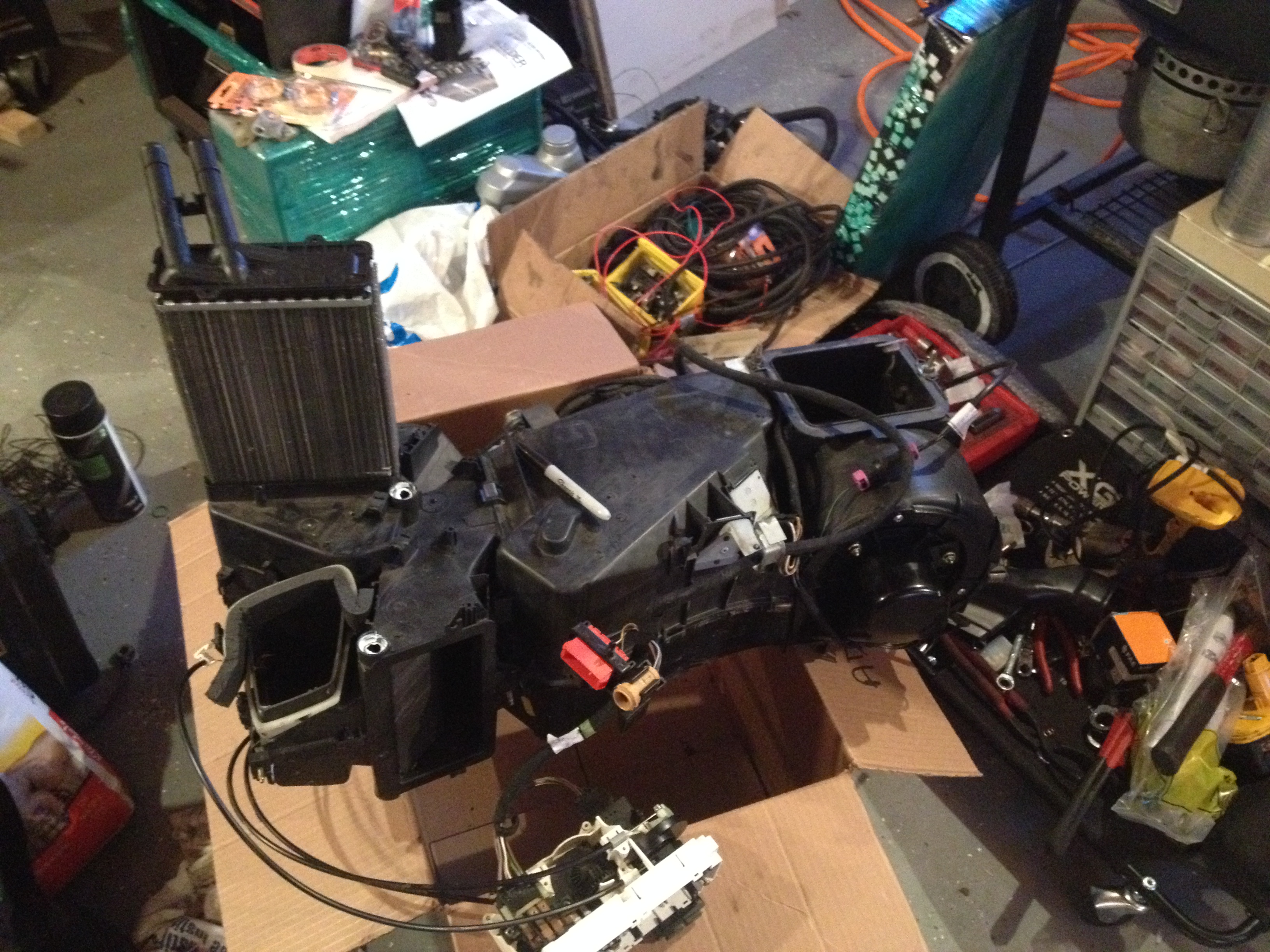

- b4 manual heating unit also blacked out trim
- led lights
- s2 steering wheel
- s4 b5 shifter knob

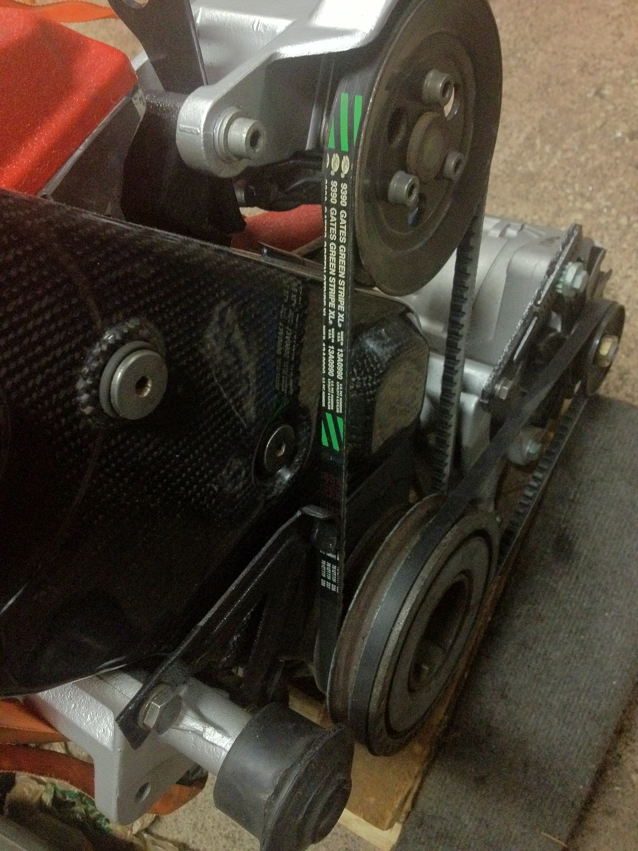

Power steering
- Stock Audi b4 90 power steering pump
- Custom pressure hoses
- rebuild rack and pinion

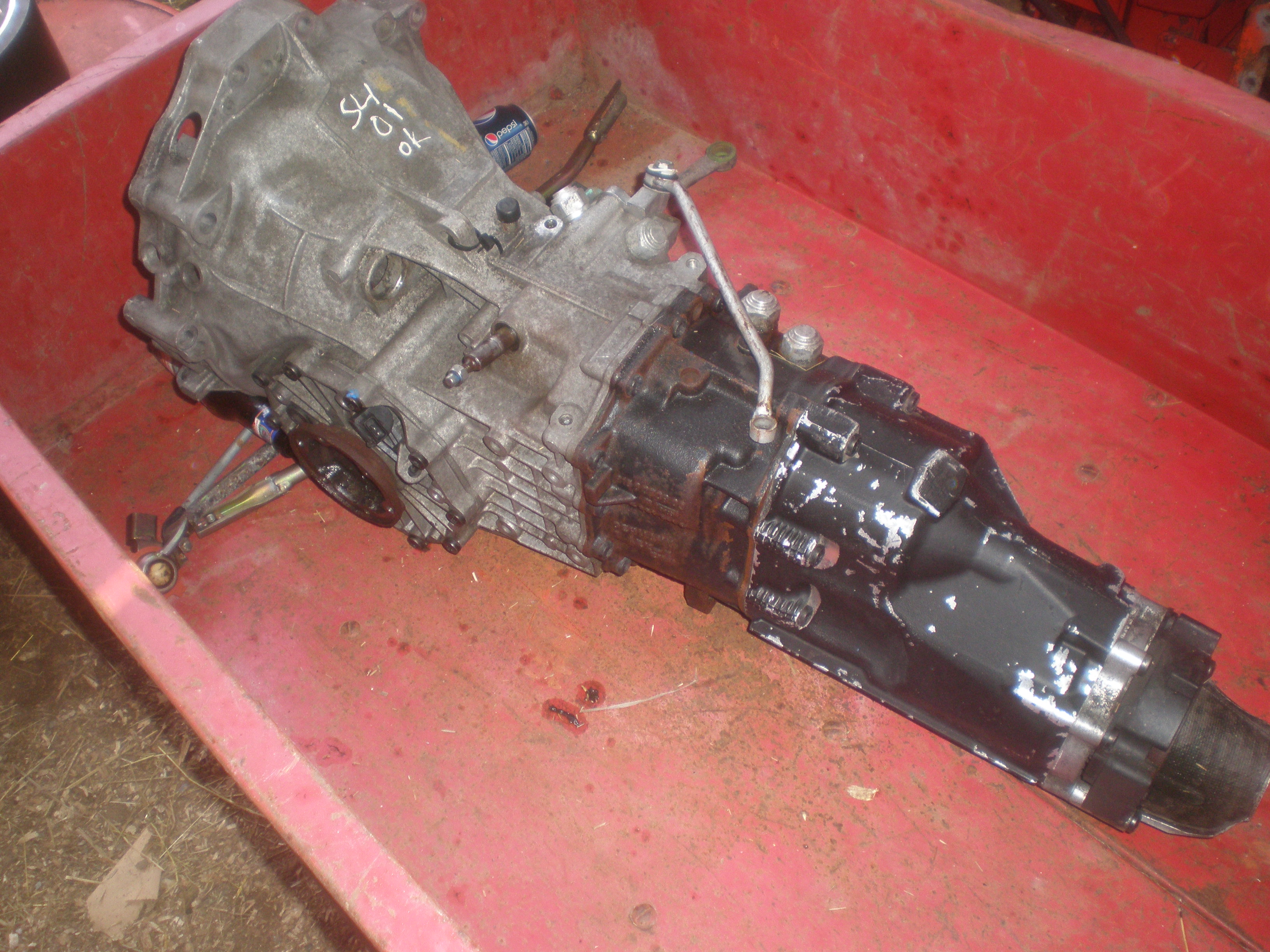

Transmission
- 01e 6 speed
- Stage 4 + clutch 6 puck
- Audi s4 b5 modified shifter linkage
- Rebuild rear diff
- Rebuild Audi 4k prop shaft
- Rebuild axles
- EFI Express tranny brackets
Suspension
- Solid aluminium subframe bushings
- Bilsteins HD shocks
- H&R springs
- Solid spherical bearing strut mounts
- Restored full suspension
- 5 lug swap
- Wheel studs
- Seem welded rear control arms and repainted
Brakes
- Vacuum assisted servo B4
- Full ABS unit deleted
- replaced hard brake lines
Front

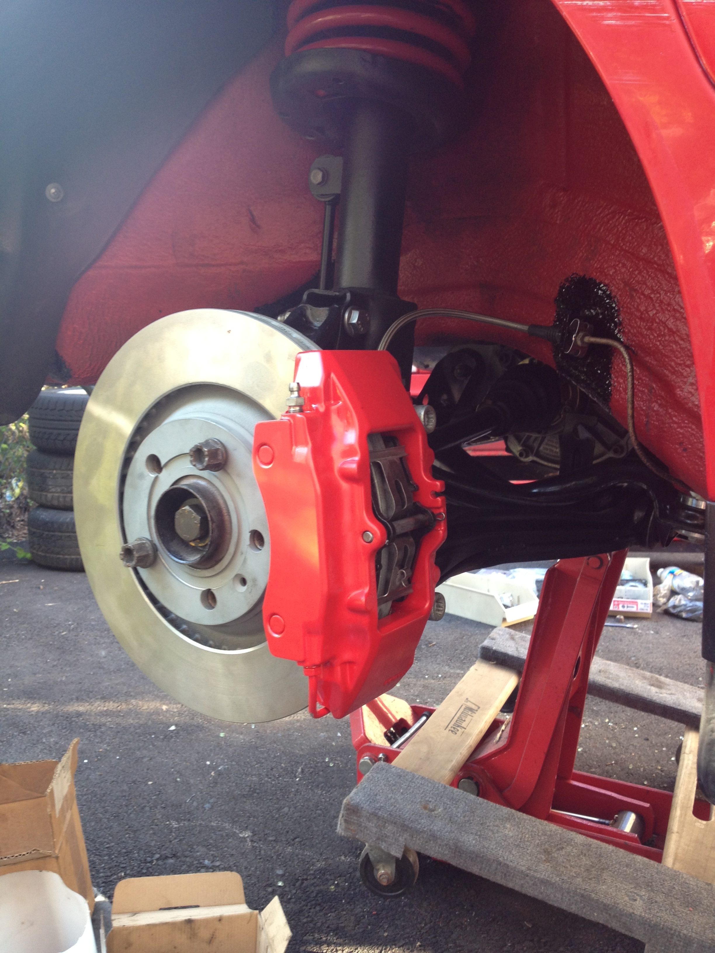

- Porsche Boxter S calipers 4 piston
- Audi a8 323mm x 30 rotors
- Custom brackets
- ss braided lines
Rear
- Porsche Boxter S rear Calipers 4 piston
- Audi s4 b7 rotors 300mm x 22
- Custom brackets
- ss braided lines
- Hydraulic e-brake conversion - modified stock handle to accommodate the hydraulic cylinder under stock center console
Wheels
- 17 inch wheels wrapped with 235/45/17 BF Goodrich comp 2

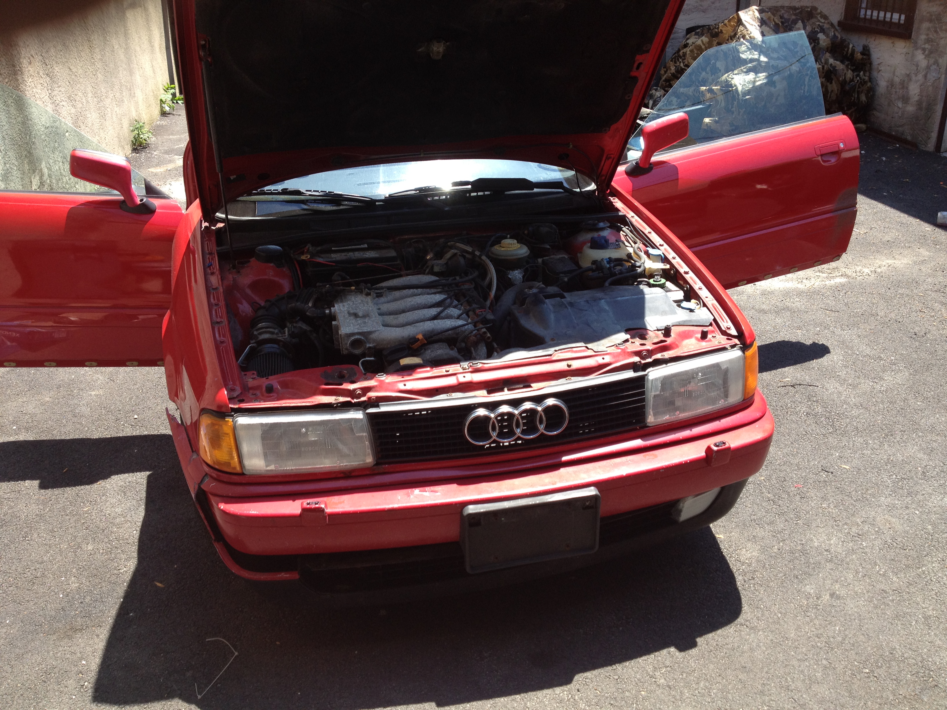

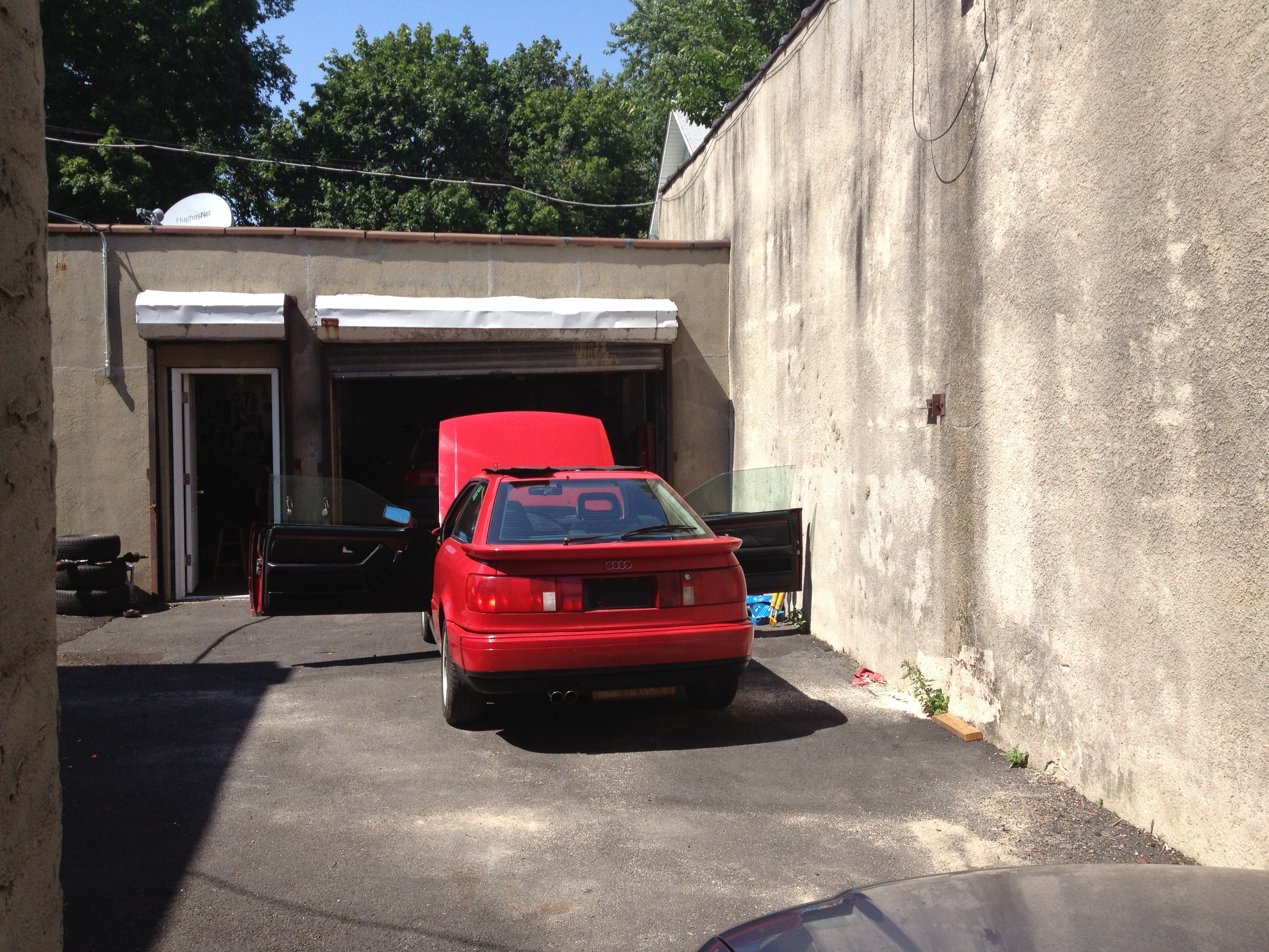

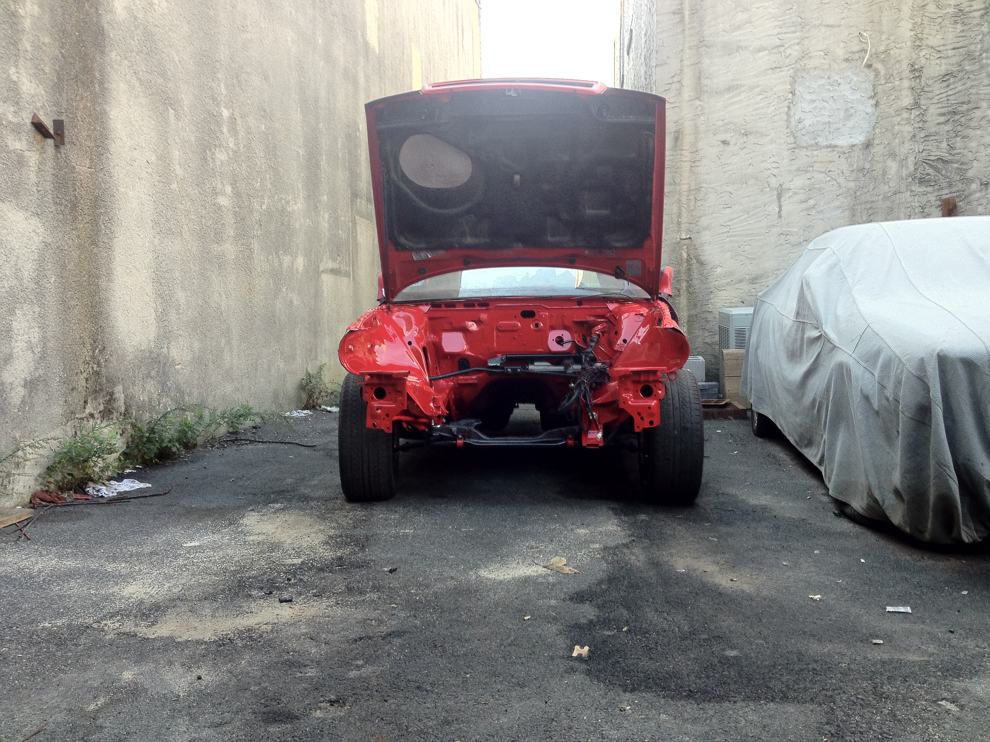

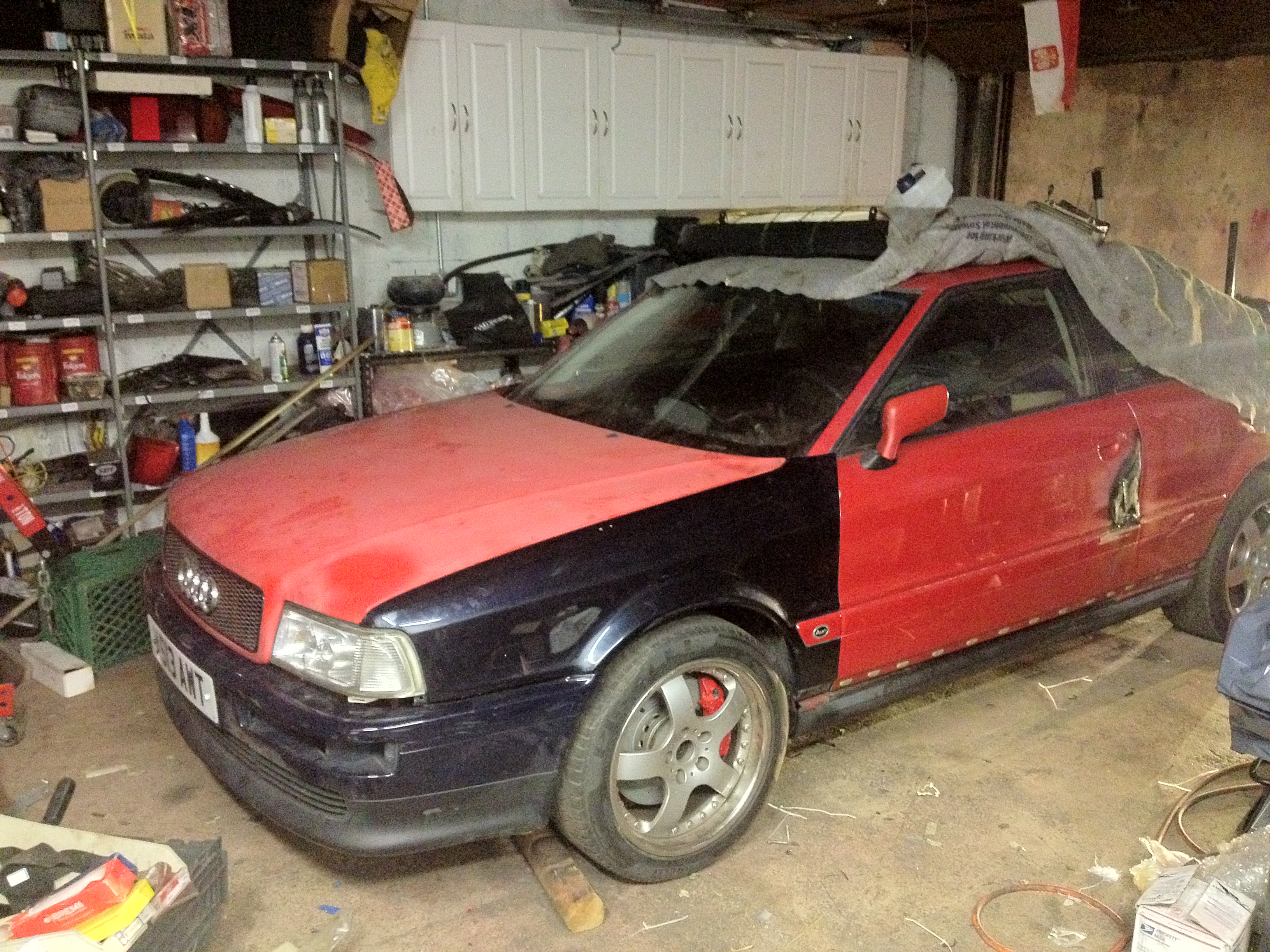

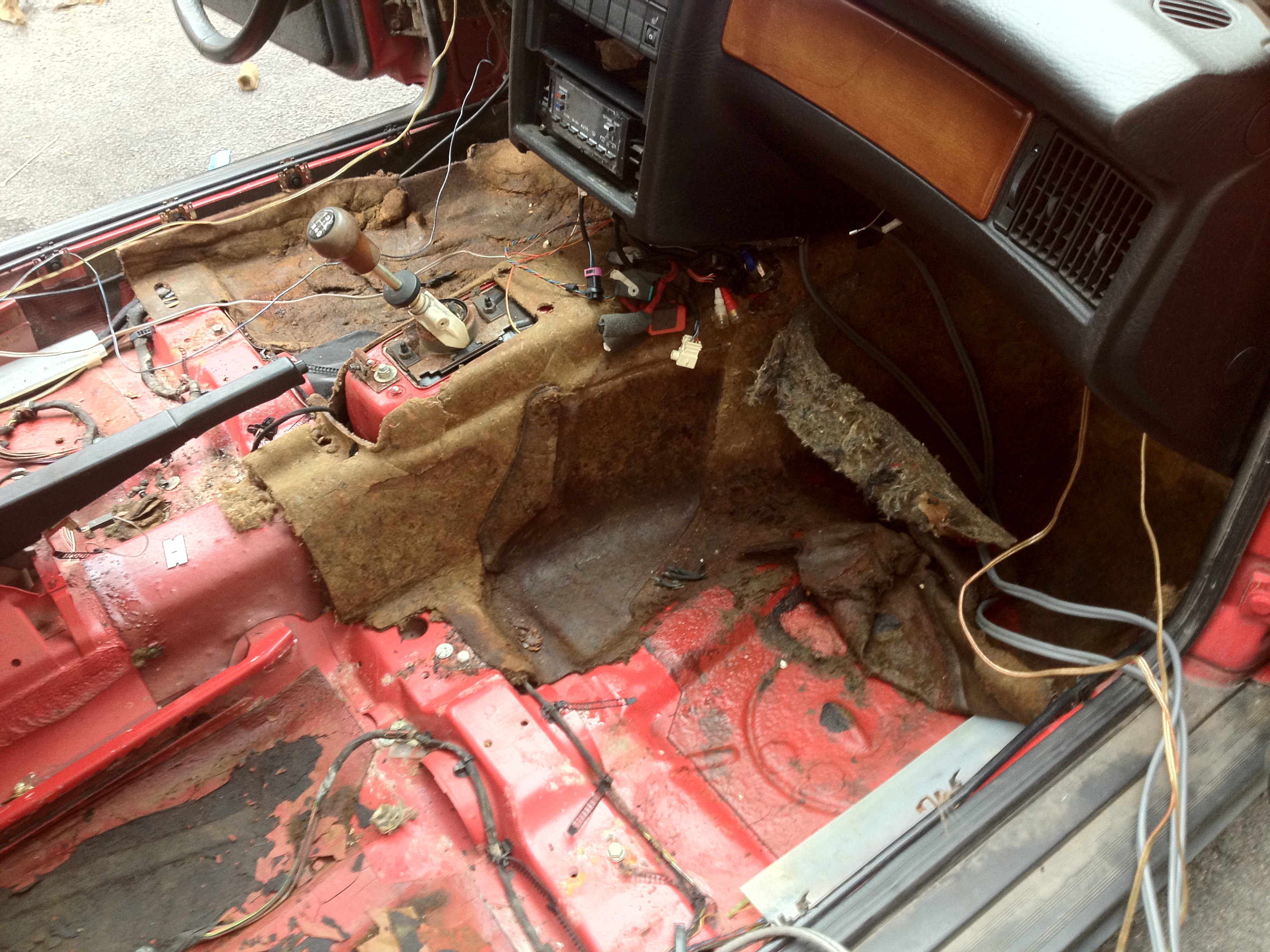

- Sebastian's CQ91' winter .jpg (2.99 MiB) Viewed 41821 times
- Sebastian's CQ91' road trip 4.JPG (2.54 MiB) Viewed 41821 times

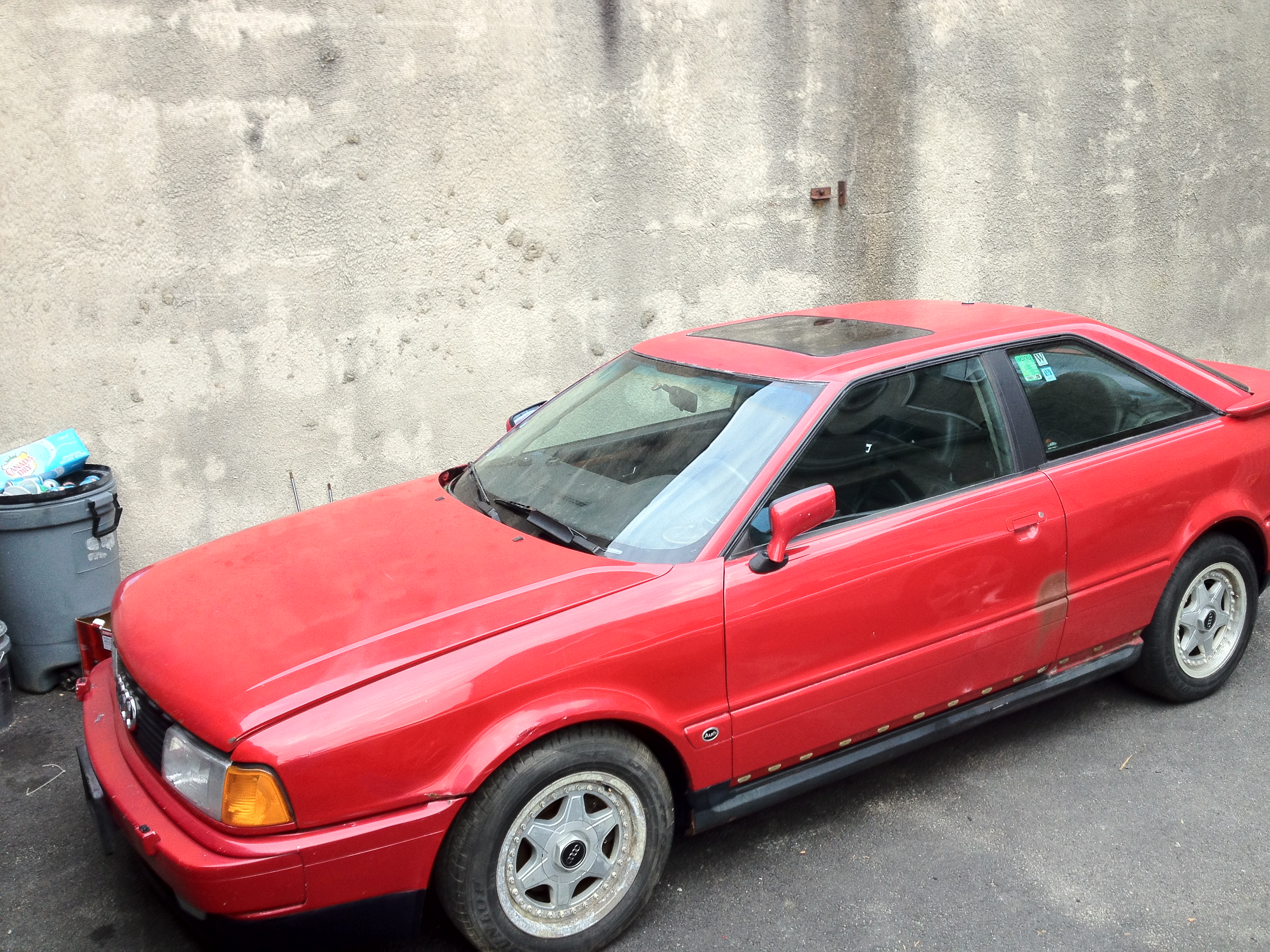

- Sebastian's CQ91' initial inspection .JPG (2.97 MiB) Viewed 41821 times
- Sebastian's CQ91' project 1.JPG (3.58 MiB) Viewed 41821 times
- Sebastian's CQ91' initial inspection 3.jpg (3.97 MiB) Viewed 41821 times

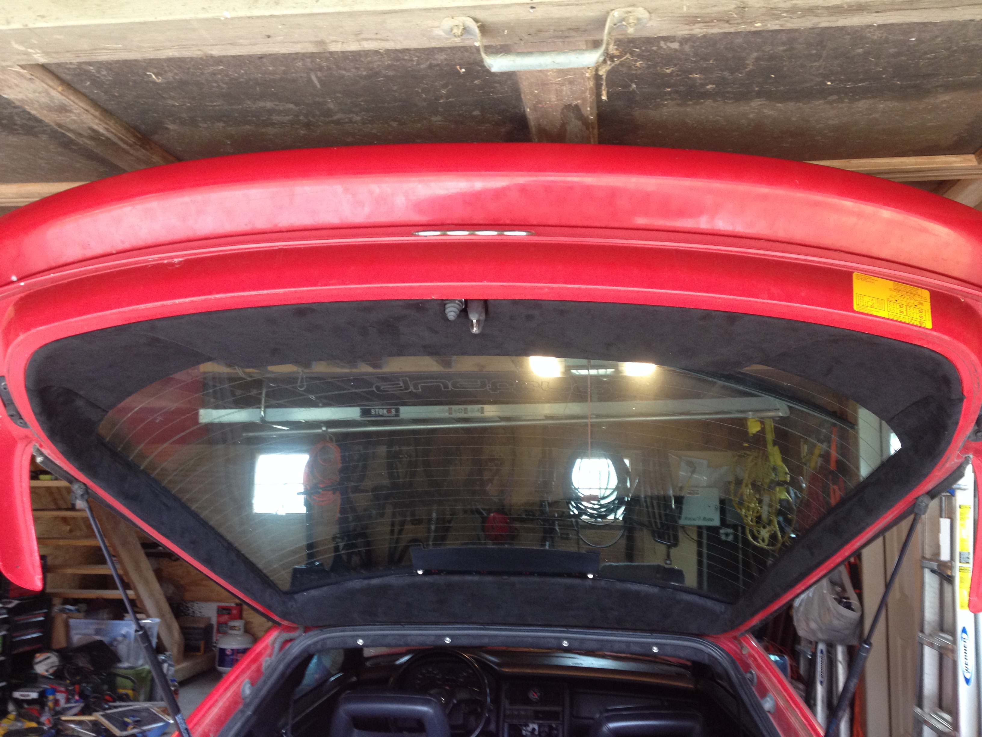

bit more of the b4 look
- Sebastian's CQ91' old garrage storage 1.JPG (3.36 MiB) Viewed 41816 times
- Sebastian's CQ91' body panels.jpg (2.04 MiB) Viewed 41816 times

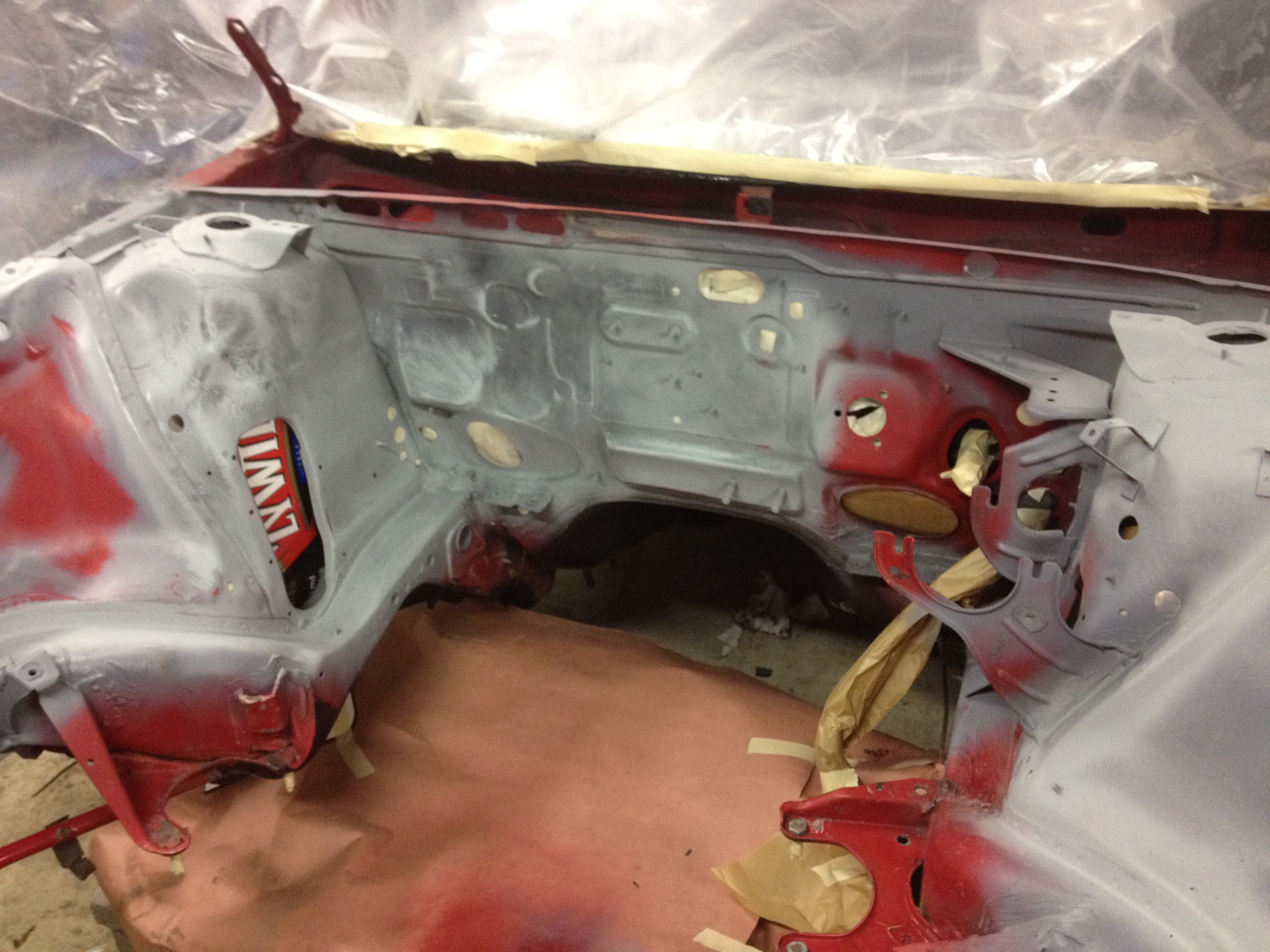

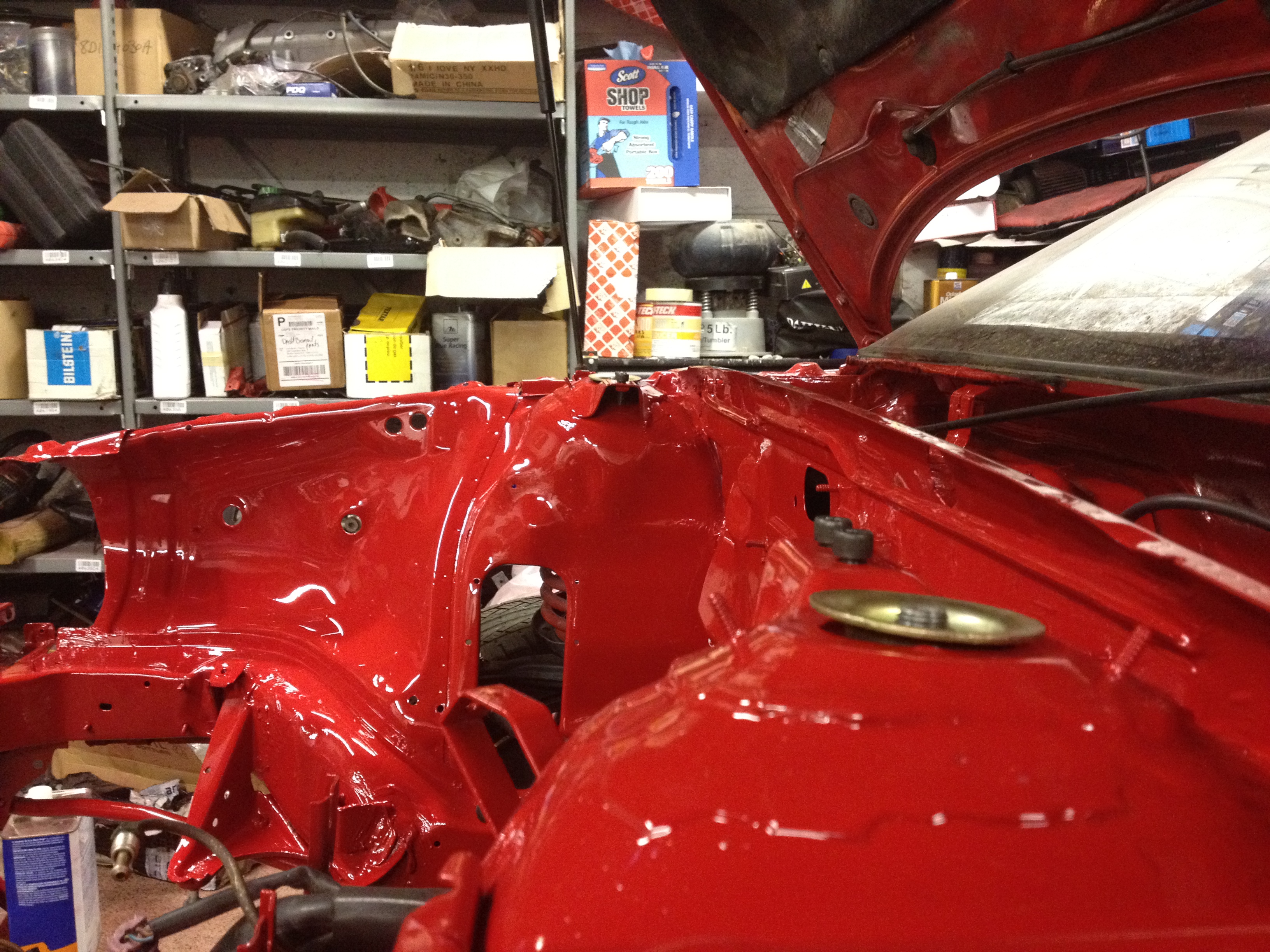

Re: Sebastian's 91 Coupe Quattro - 3b swap - Vems - e85

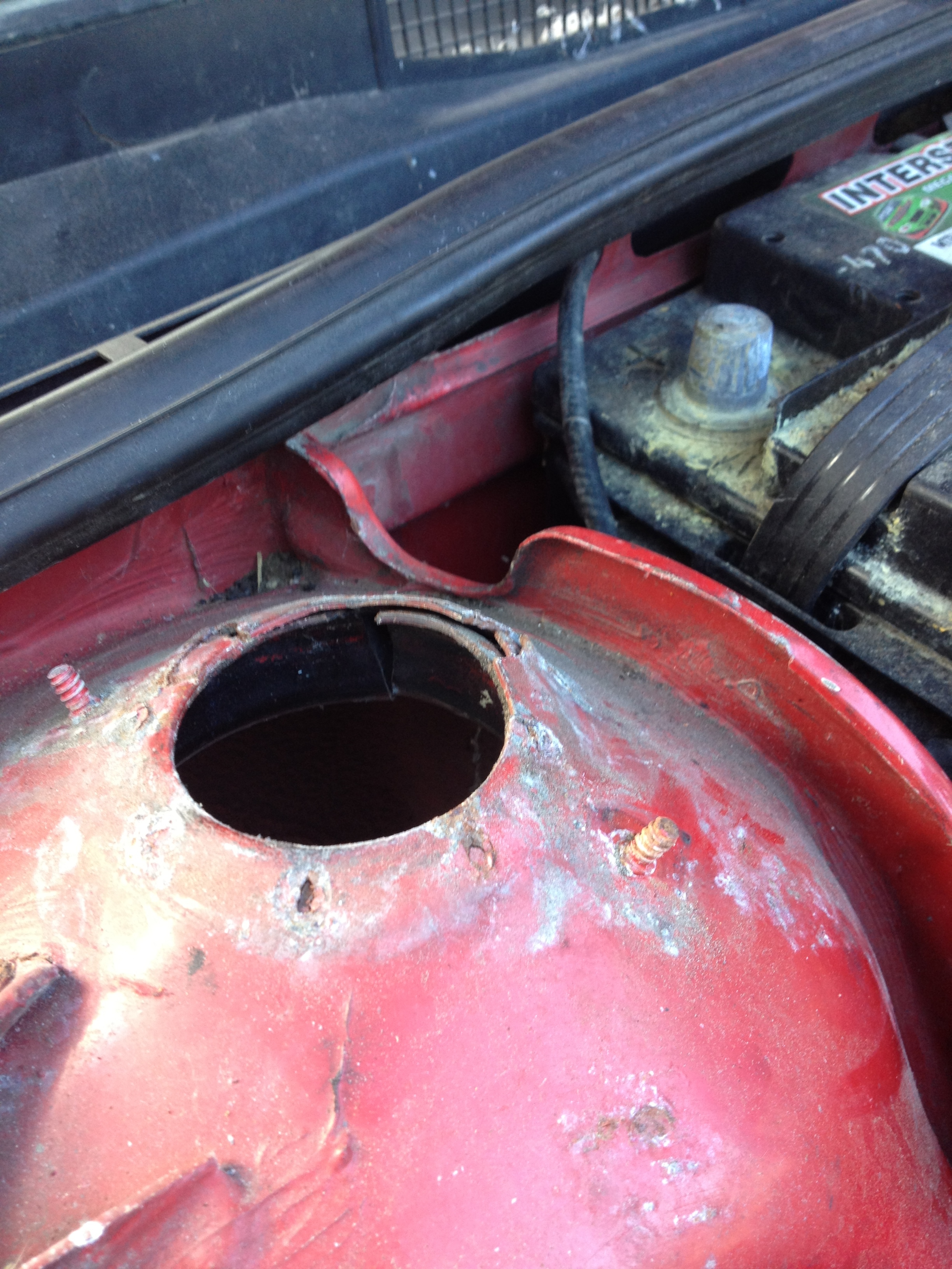

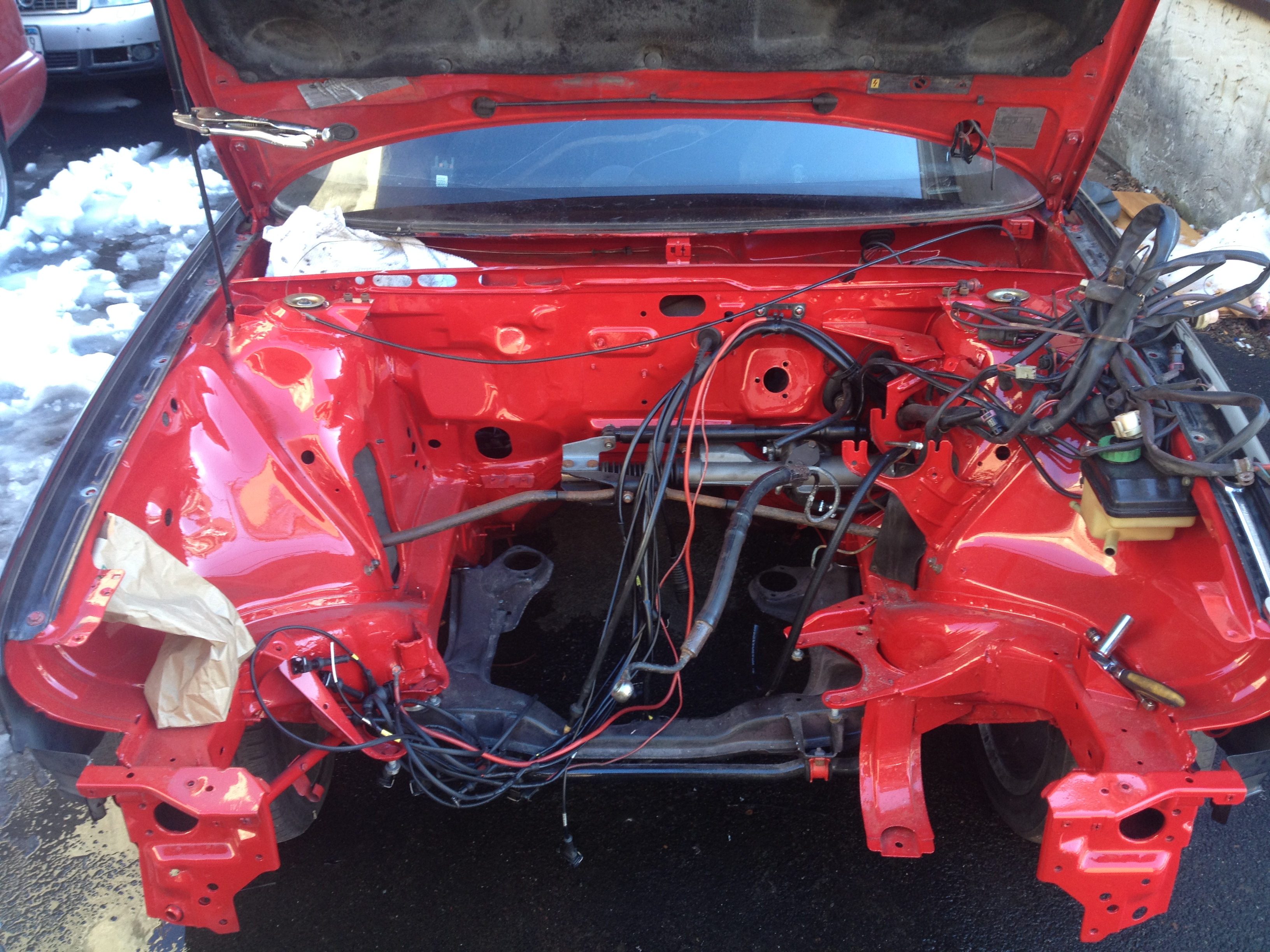

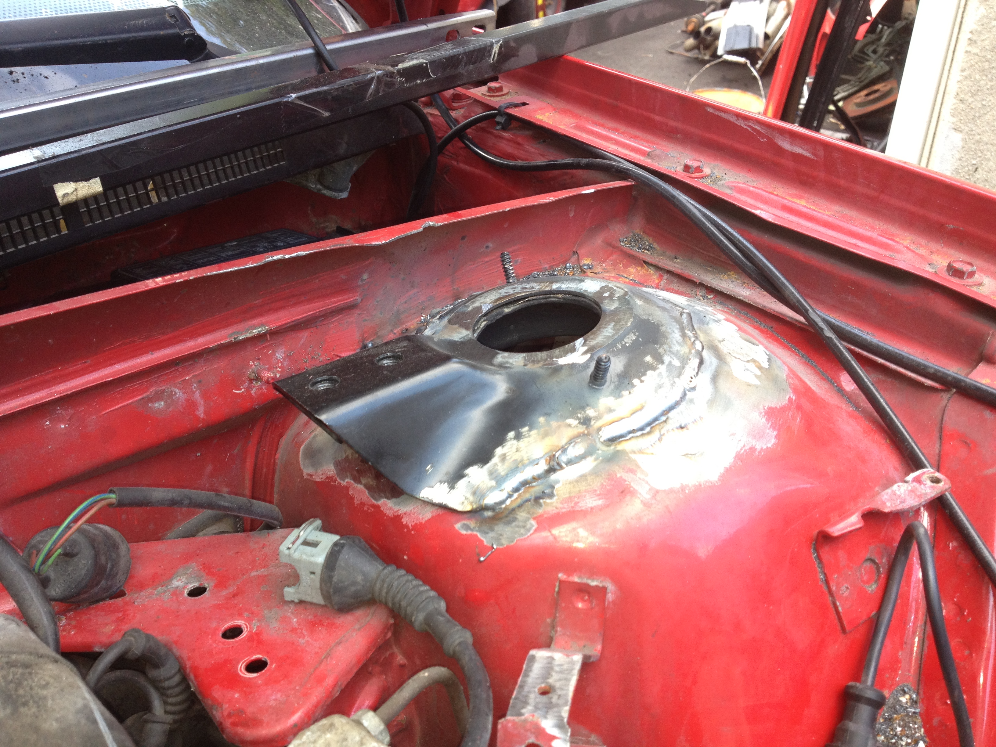

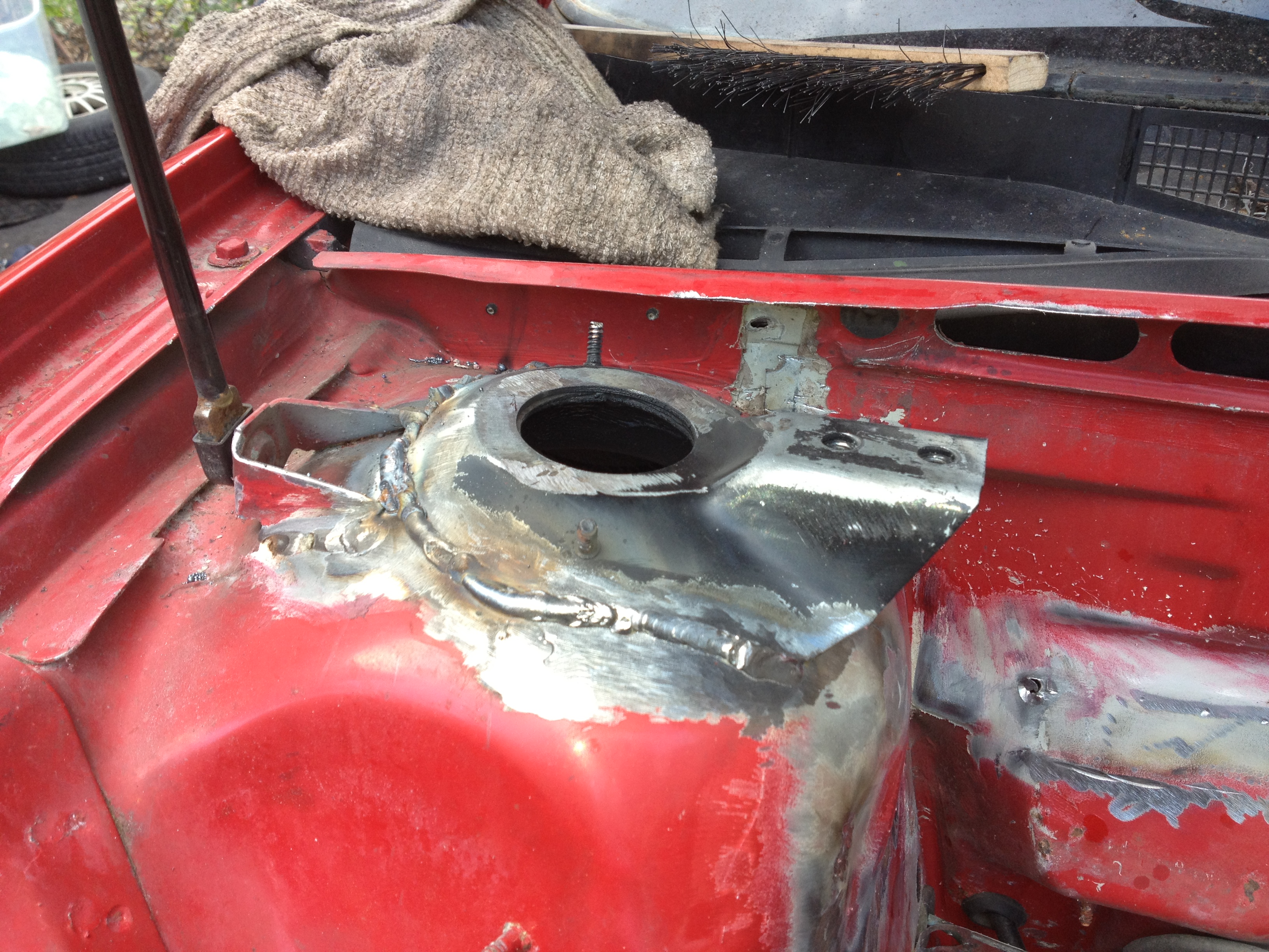

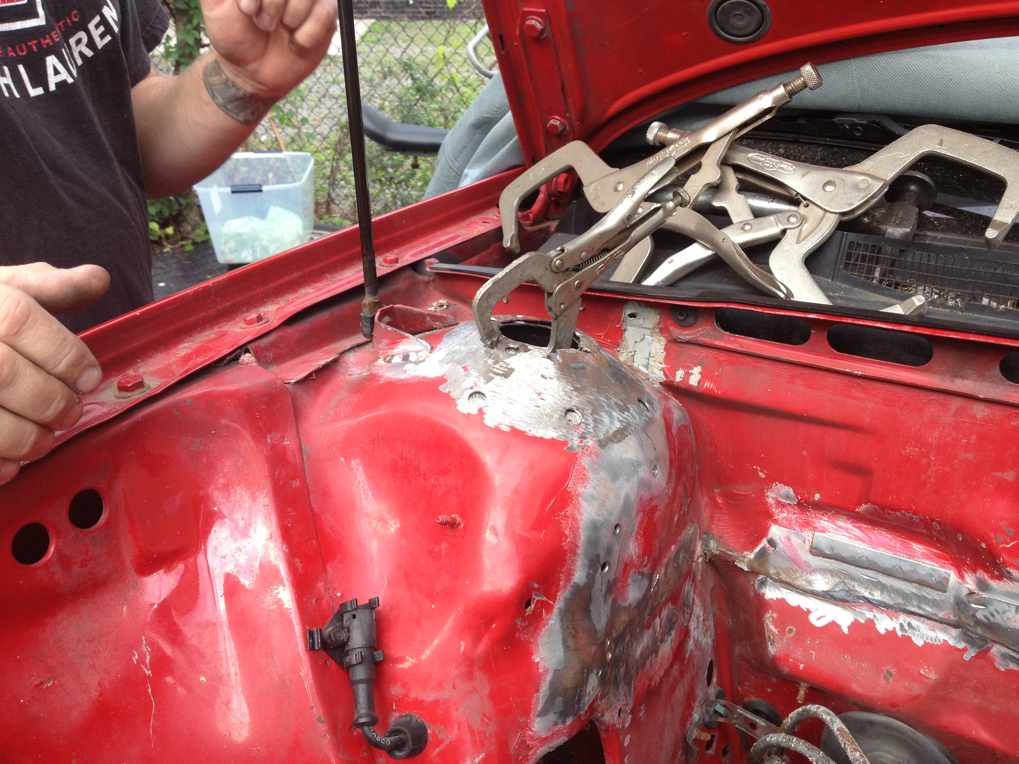

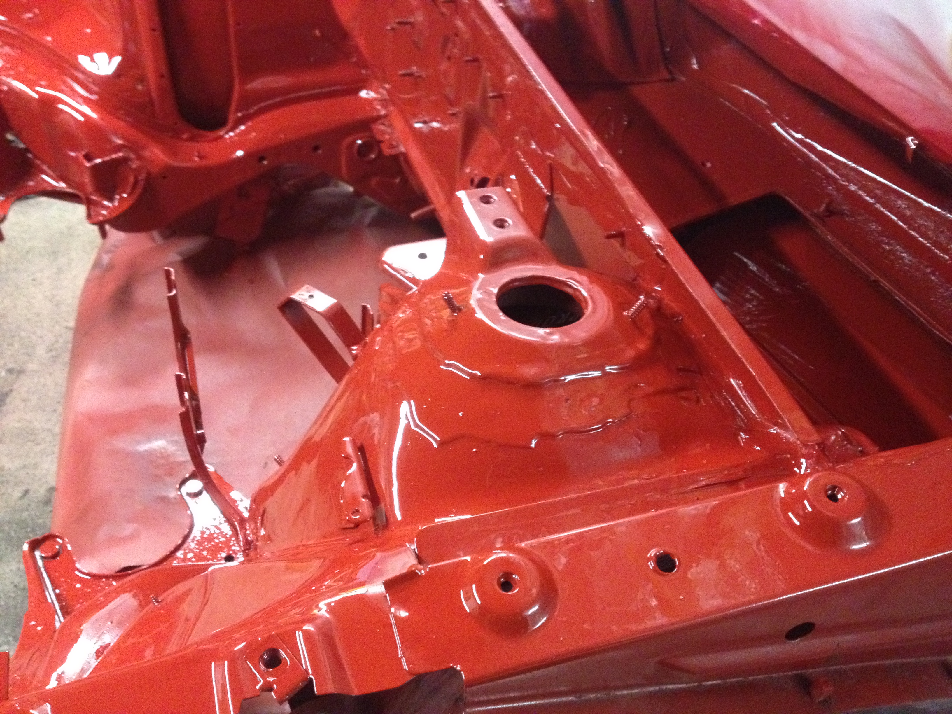

some engine bay prep work and strut tower fix and brace, battery relocation
- Sebastian's CQ91' shot towers.jpg (2.57 MiB) Viewed 41815 times
- Sebastian's CQ91' front tower fix 2.JPG (2.91 MiB) Viewed 41815 times
- Sebastian's CQ91' front tower fix and strut bar mount.JPG (2.86 MiB) Viewed 41815 times
- front tower strut brace mount.JPG (2.7 MiB) Viewed 41815 times
- Sebastian's CQ91' engine paint prep.JPG (2.44 MiB) Viewed 41815 times

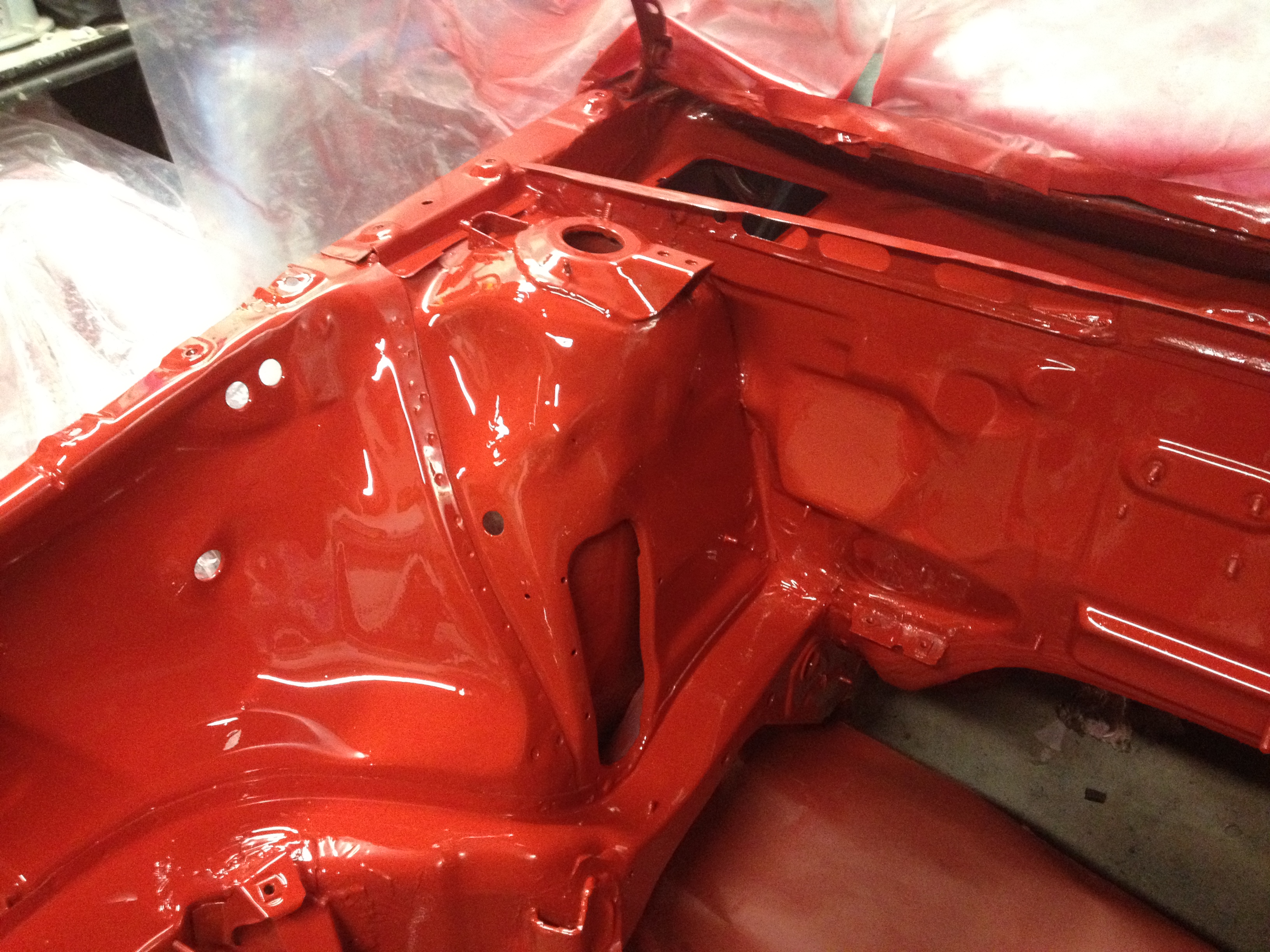

some color and steering
- Sebastian's CQ91' engine bay paint 4.JPG (2.55 MiB) Viewed 41815 times
- Sebastian's CQ91' engine bay paint .JPG (2.82 MiB) Viewed 41815 times
- Sebastian's CQ91'engine bay finished paint .JPG (2.61 MiB) Viewed 41815 times
- Sebastian's CQ91' power steering job.JPG (599.15 KiB) Viewed 41815 times
- Sebastian's CQ91' engine paint finished.JPG (3.8 MiB) Viewed 41815 times

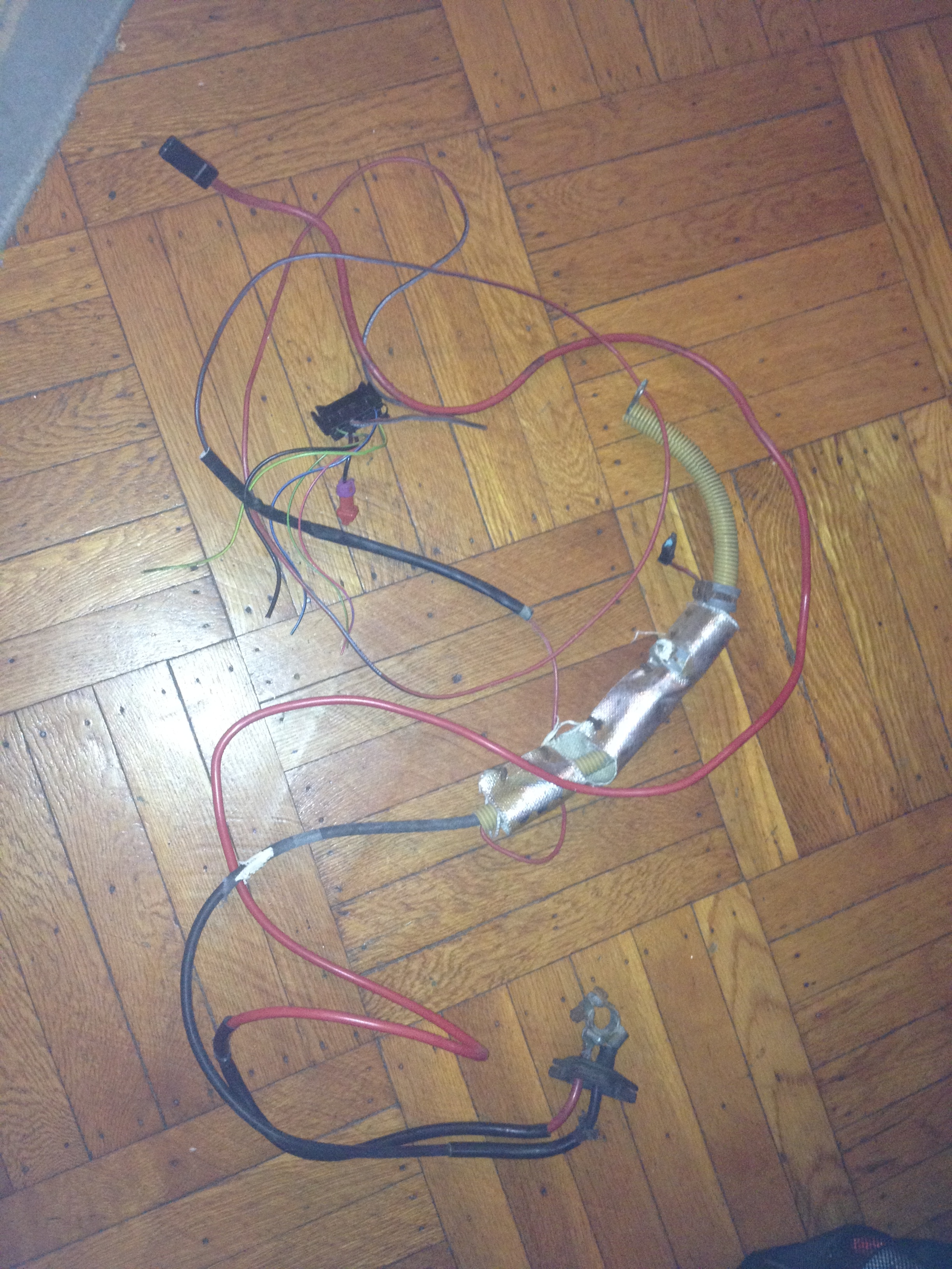

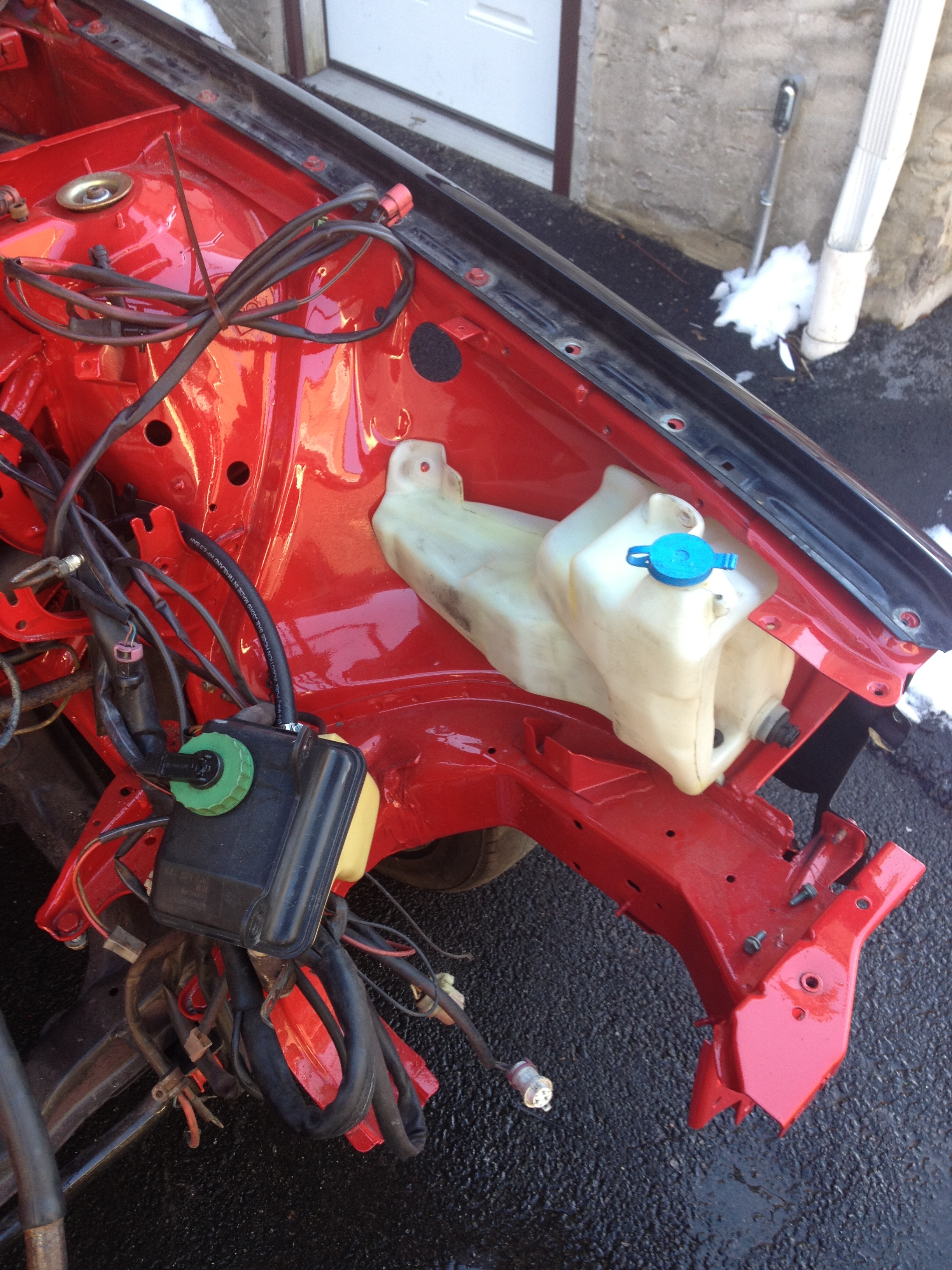

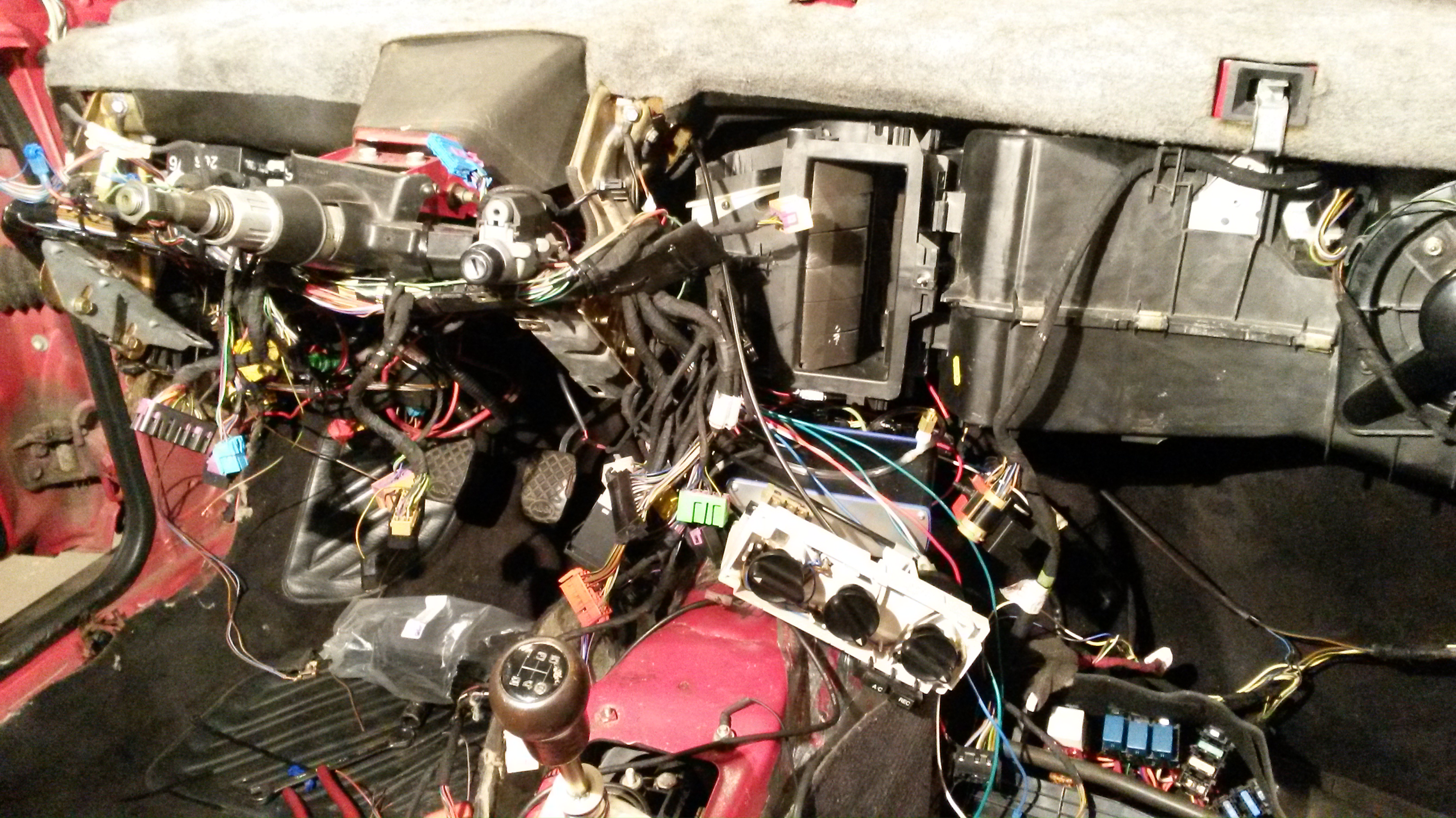

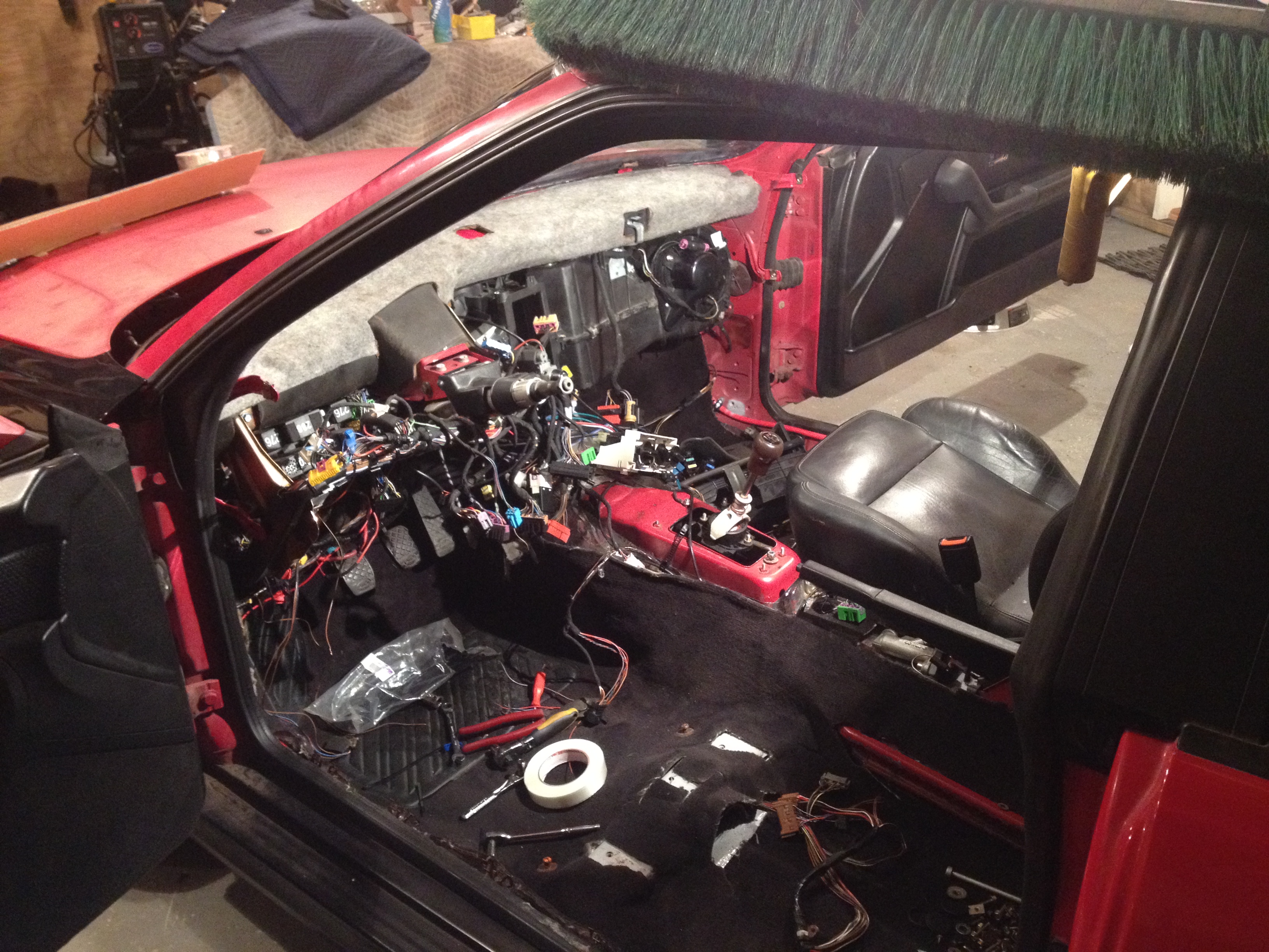

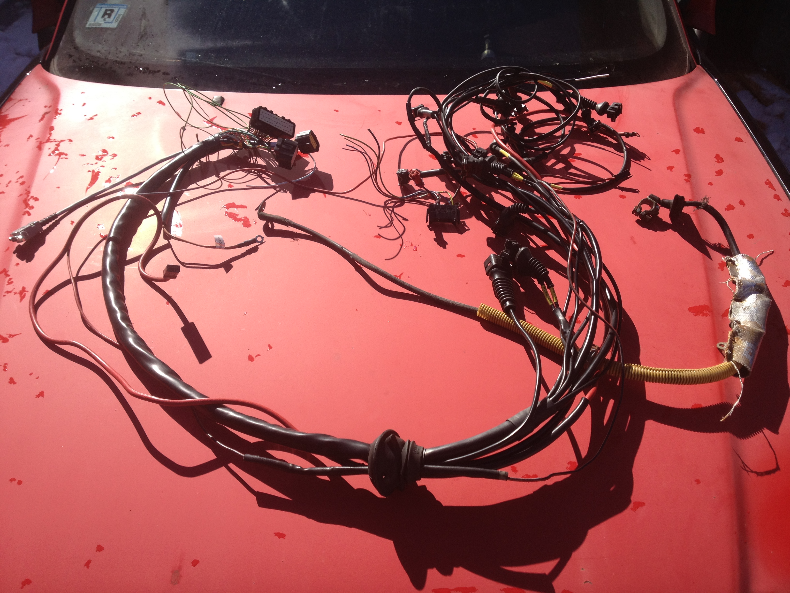

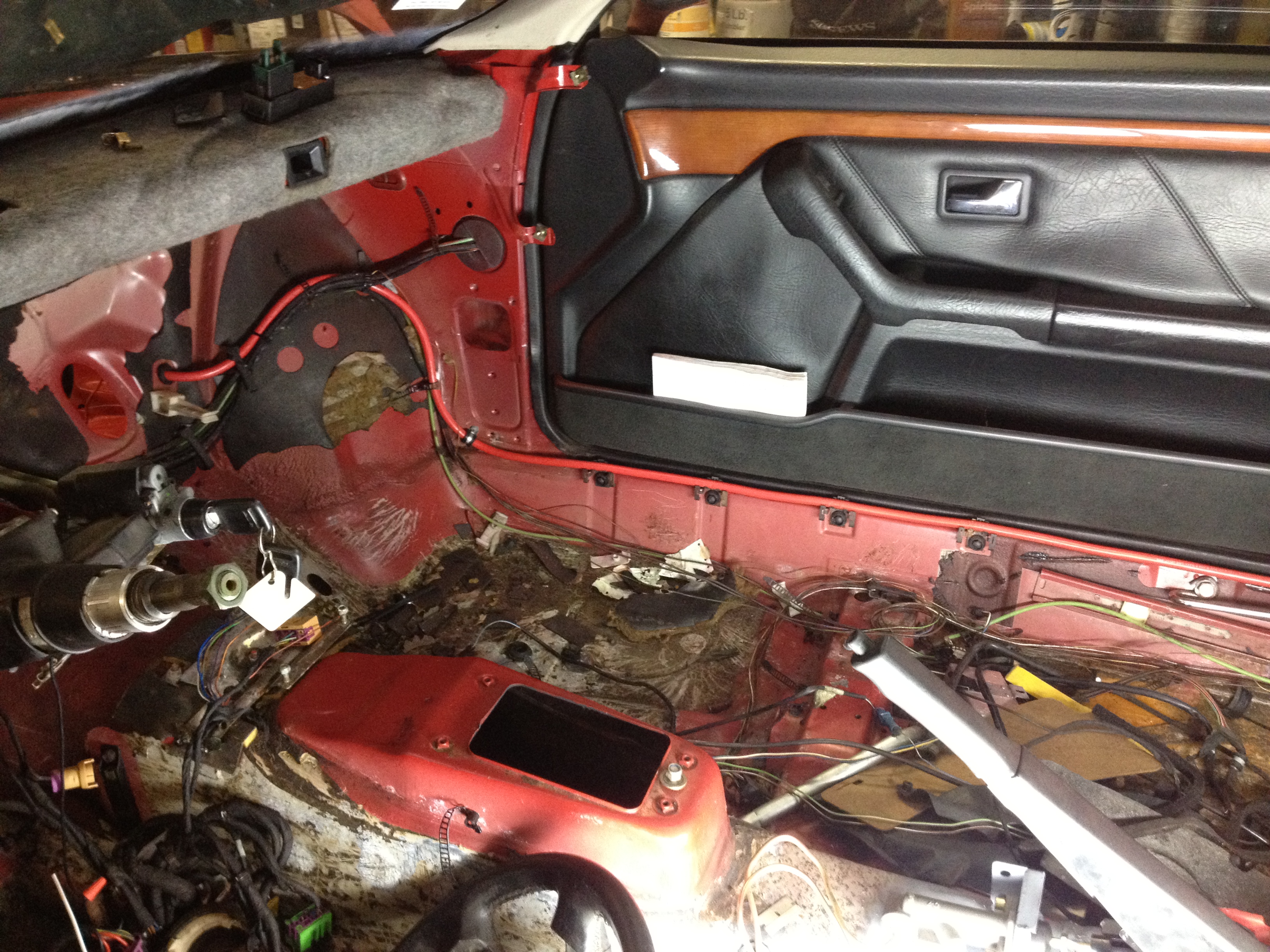

steering rack and fluid tanks installed with Vems harness and very slimmed down stock harness
- Sebastian's CQ91' stock harness slimmed down.jpg (3.04 MiB) Viewed 41814 times
- Sebastian's CQ91' vems harness EFI Express.JPG (2.25 MiB) Viewed 41814 times
- Sebastian's CQ91' engine bay random shoot 2.JPG (2.58 MiB) Viewed 41814 times
- Sebastian's CQ91' engine bay random shoot 1.jpg (2.85 MiB) Viewed 41814 times

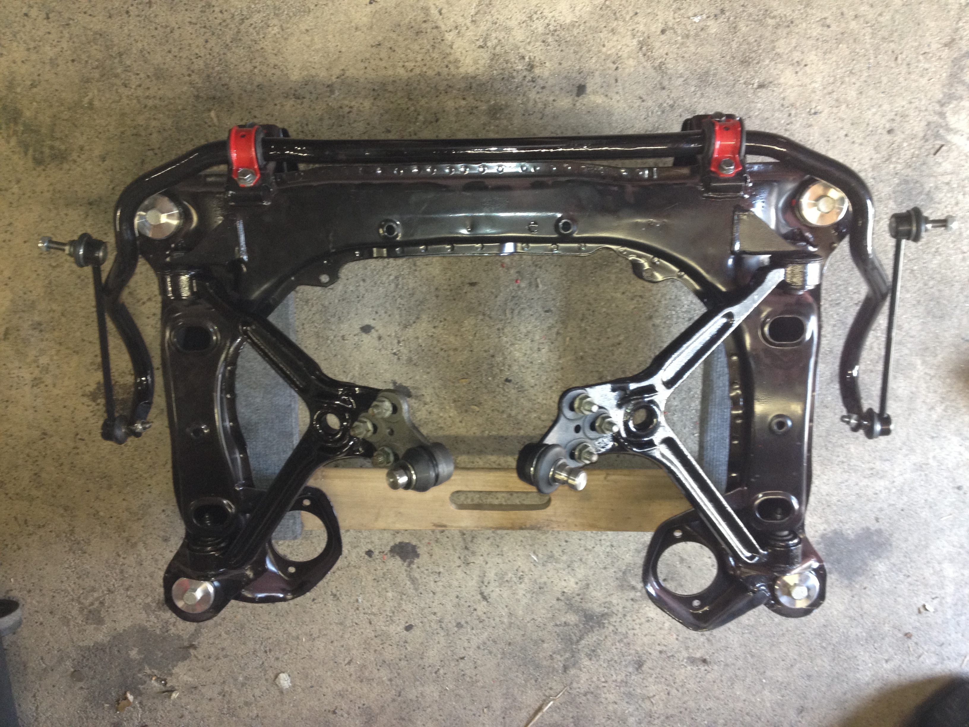

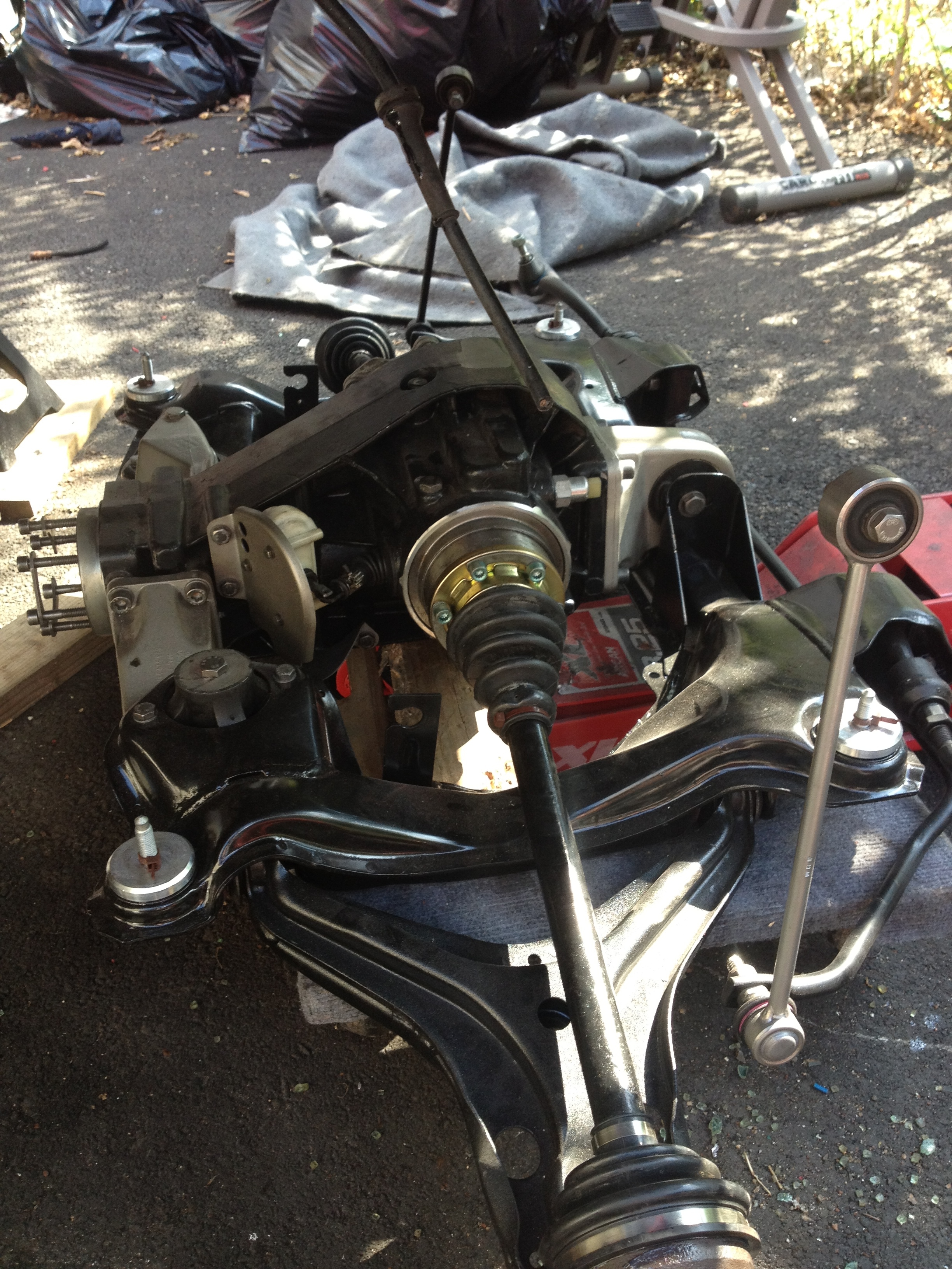

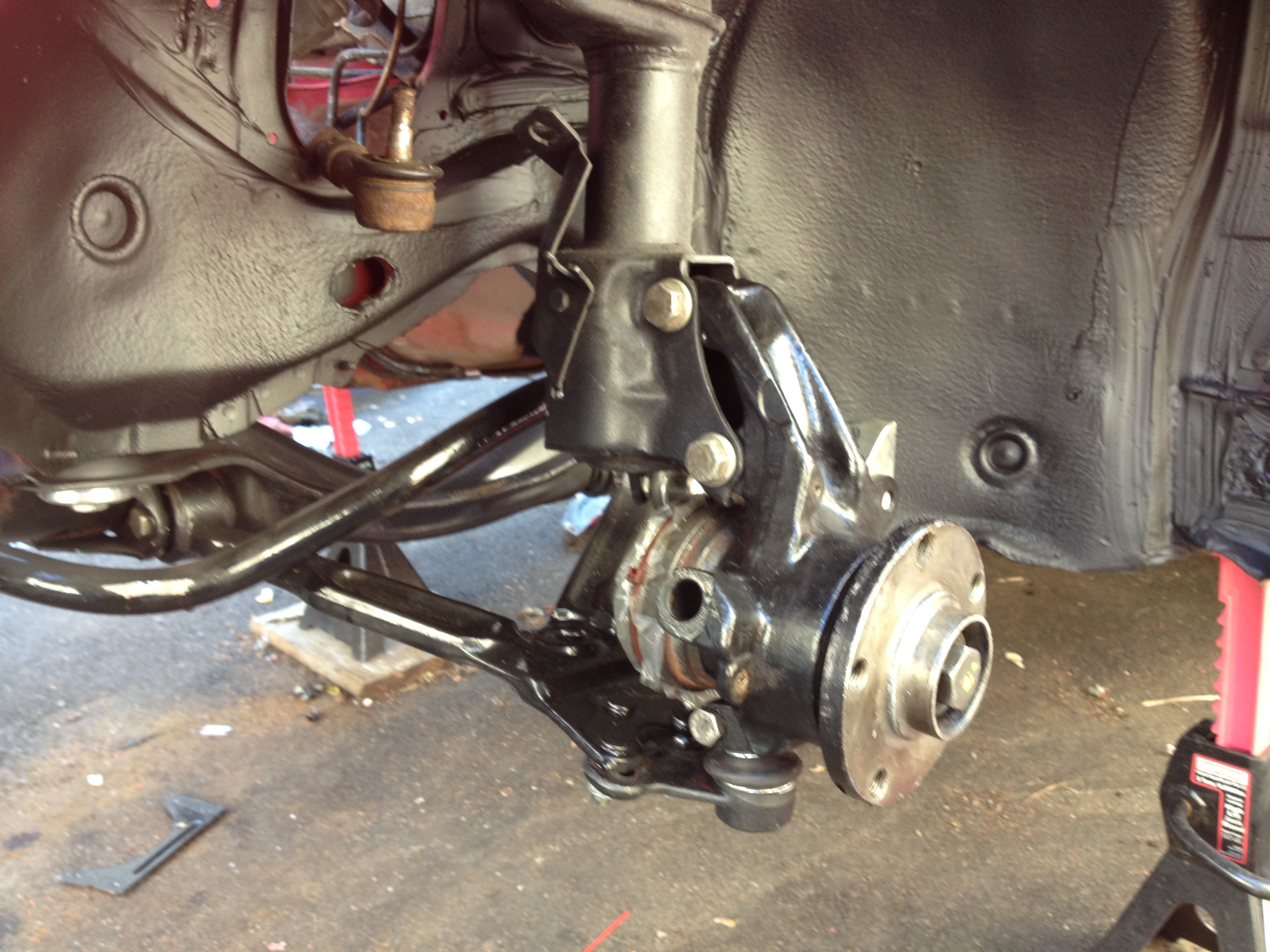

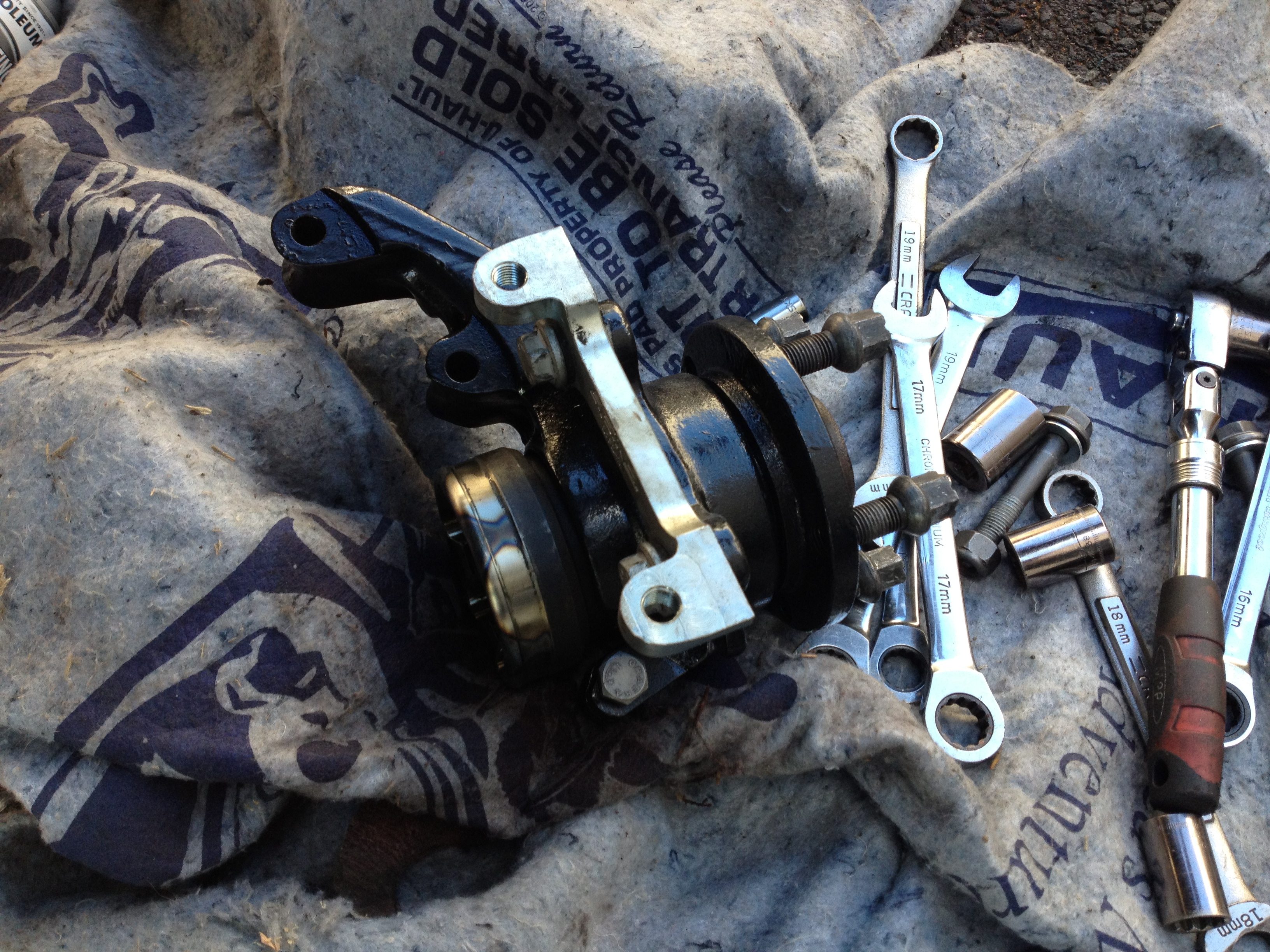

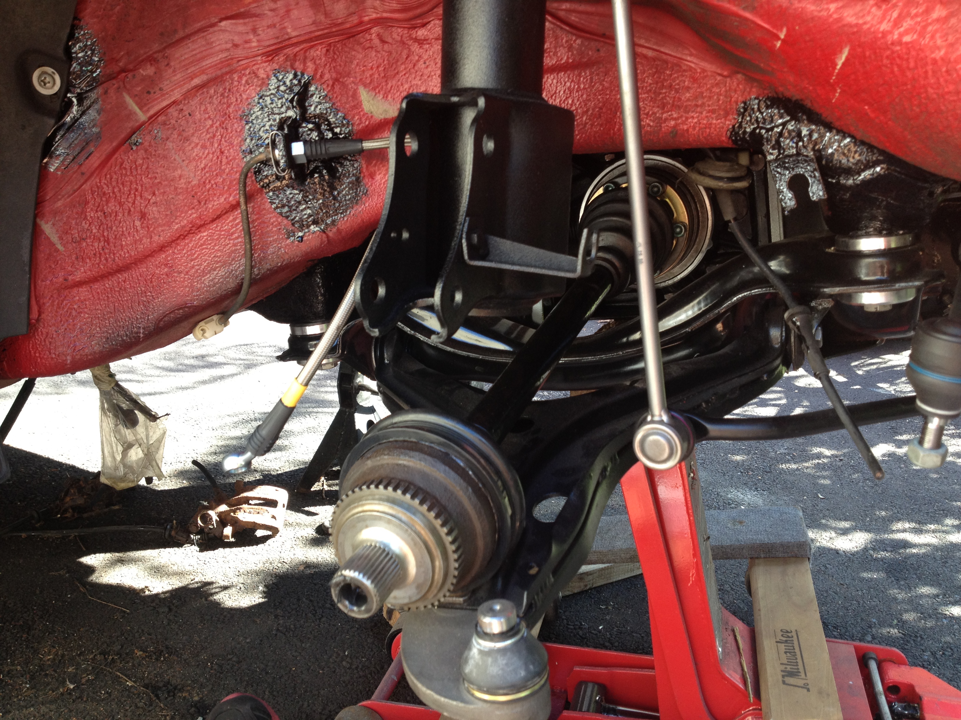

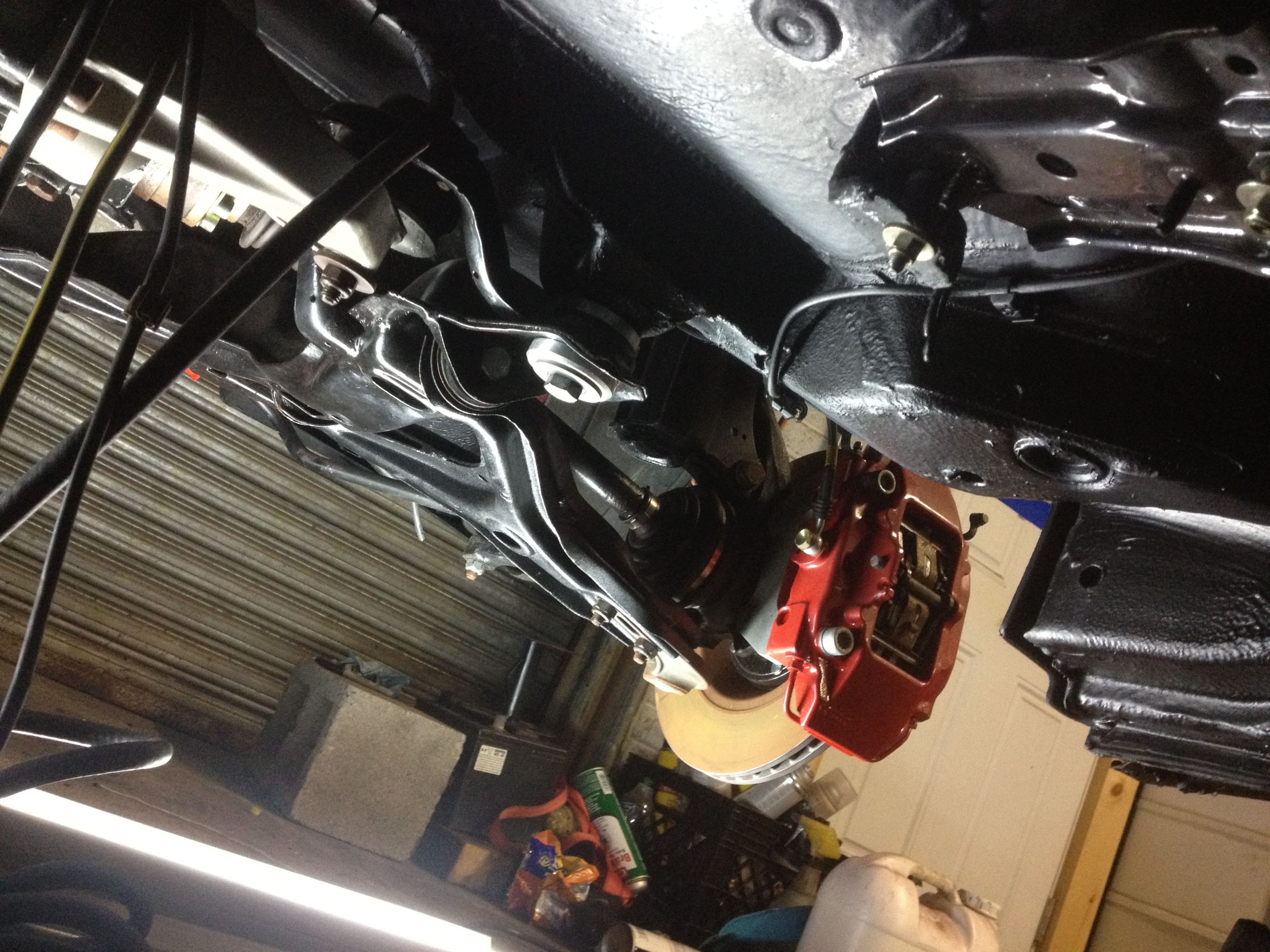

here is a bit of the under chassis and suspension work.
- Sebastian's CQ91' front suspension assembly .jpg (2.84 MiB) Viewed 41778 times
- IMG_2210.JPG (2.05 MiB) Viewed 41778 times
- Sebastian's CQ91' front suspension .JPG (2.12 MiB) Viewed 41778 times
- Sebastian's CQ91' rear suspension assembly 1.jpg (3.06 MiB) Viewed 41778 times
- Sebastian's CQ91' rear suspenssion shot.JPG (2.81 MiB) Viewed 41778 times

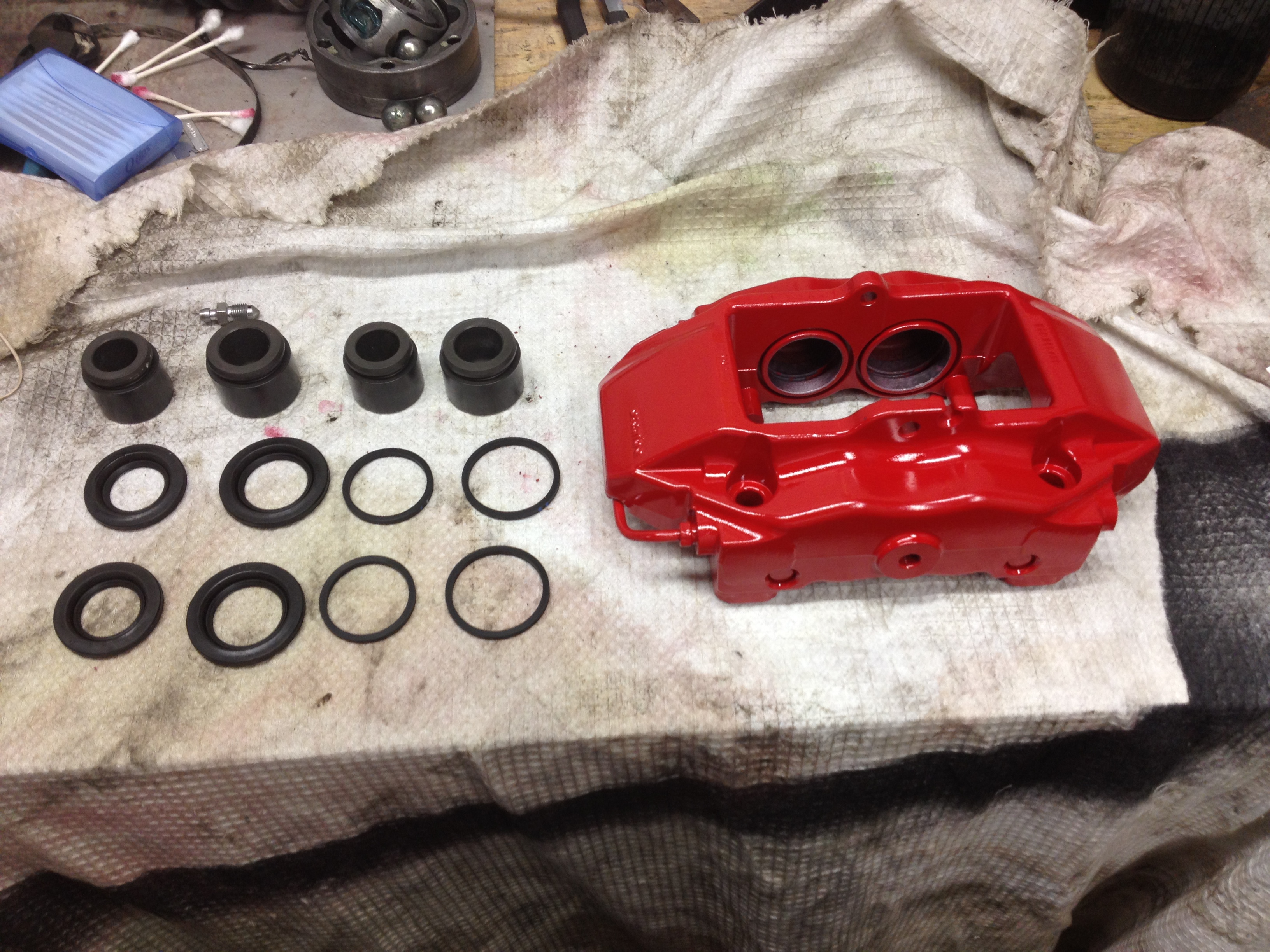

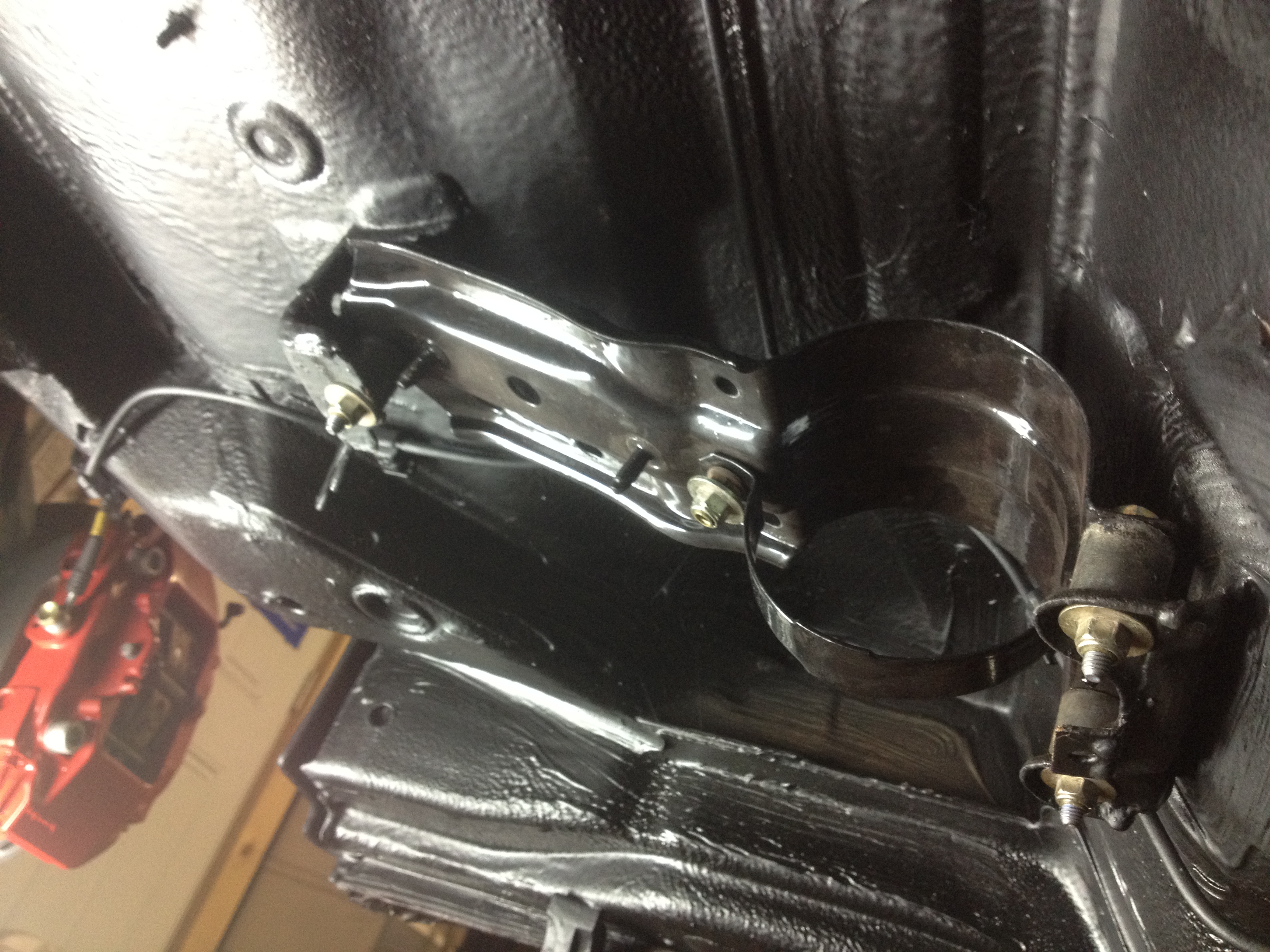

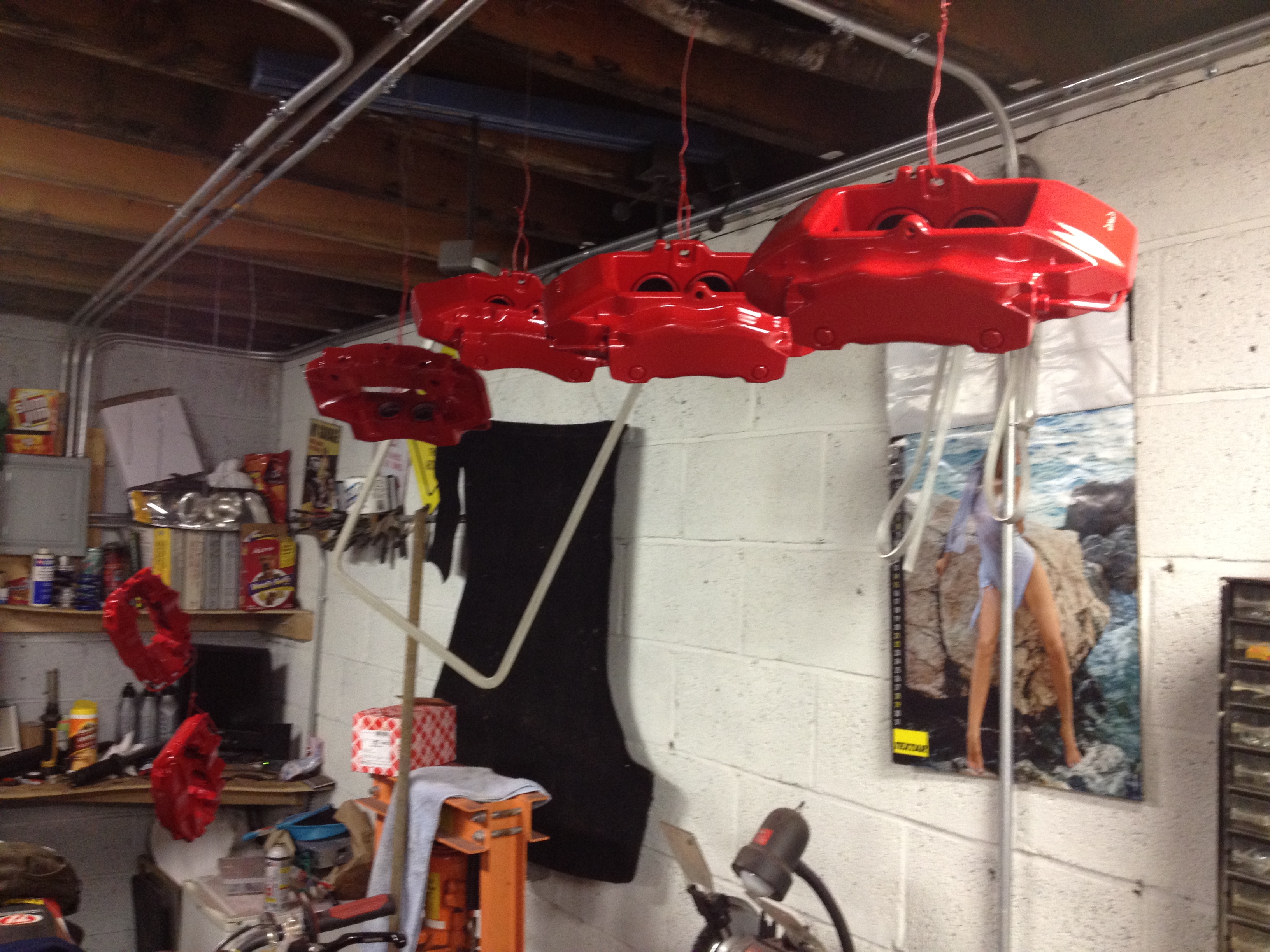

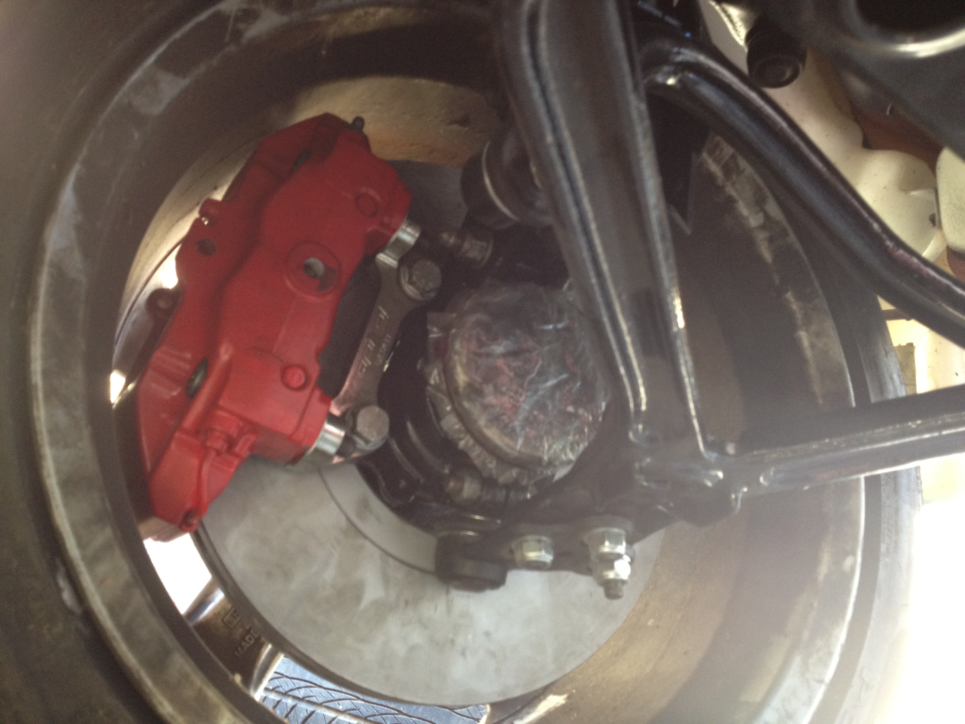

rear brakes
- Sebastian's CQ91' caliper paint.JPG (2.35 MiB) Viewed 41767 times
- Sebastian's CQ91' rebuild calipers.JPG (2.44 MiB) Viewed 41767 times
- Sebastian's CQ91' rear brakes done 1.jpg (2 MiB) Viewed 41767 times
- Sebastian's CQ91' rear brakes done.jpg (2.36 MiB) Viewed 41767 times
- Sebastian's CQ91' rear brakes done 2.jpg (2.45 MiB) Viewed 41767 times

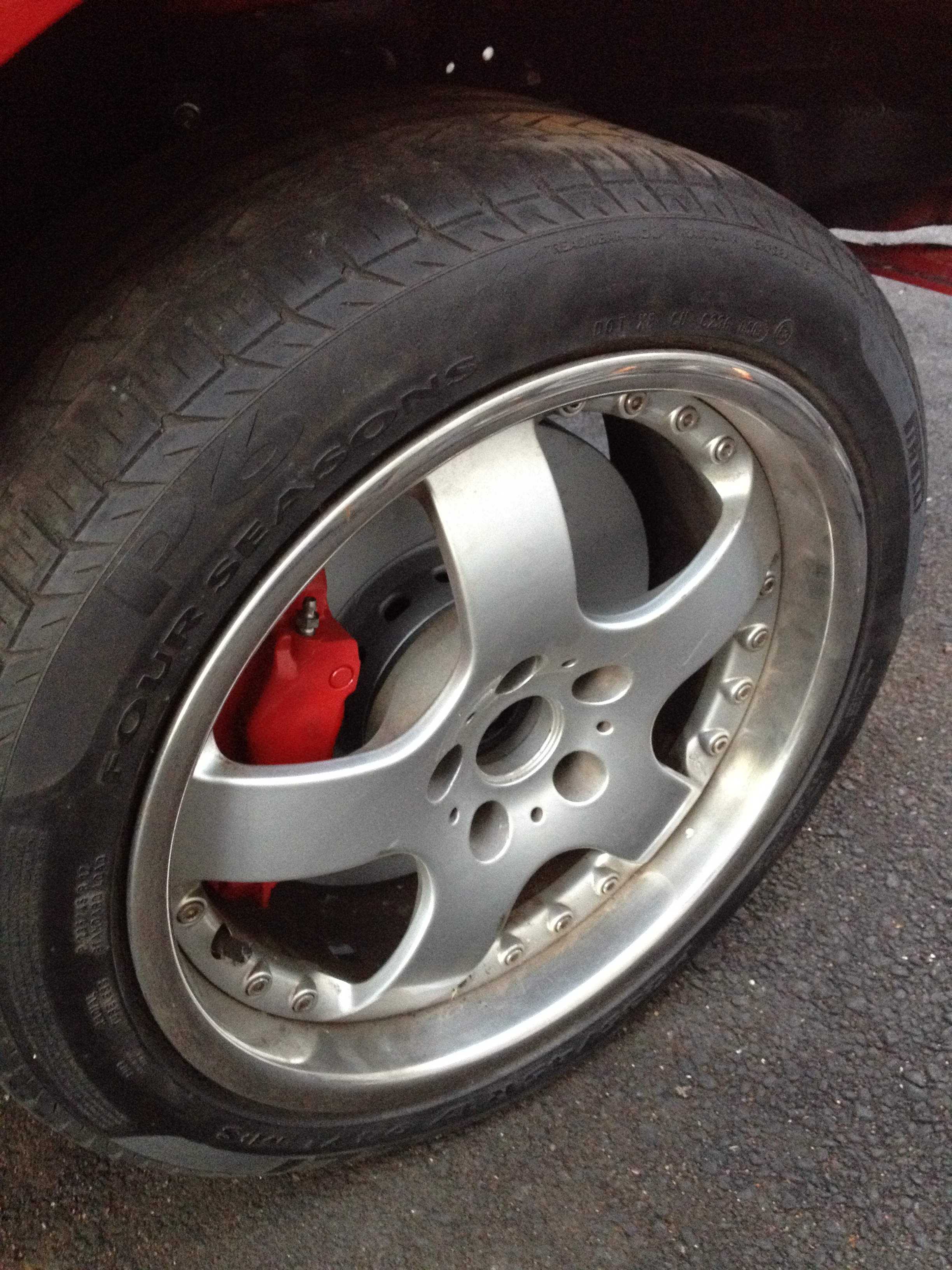

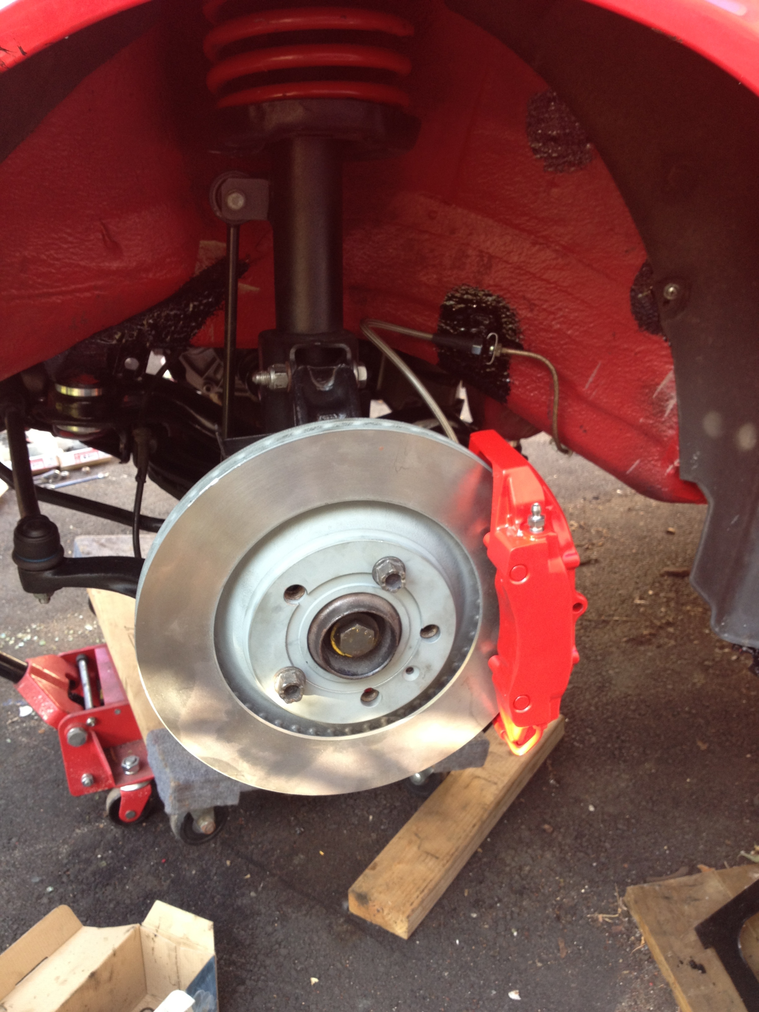

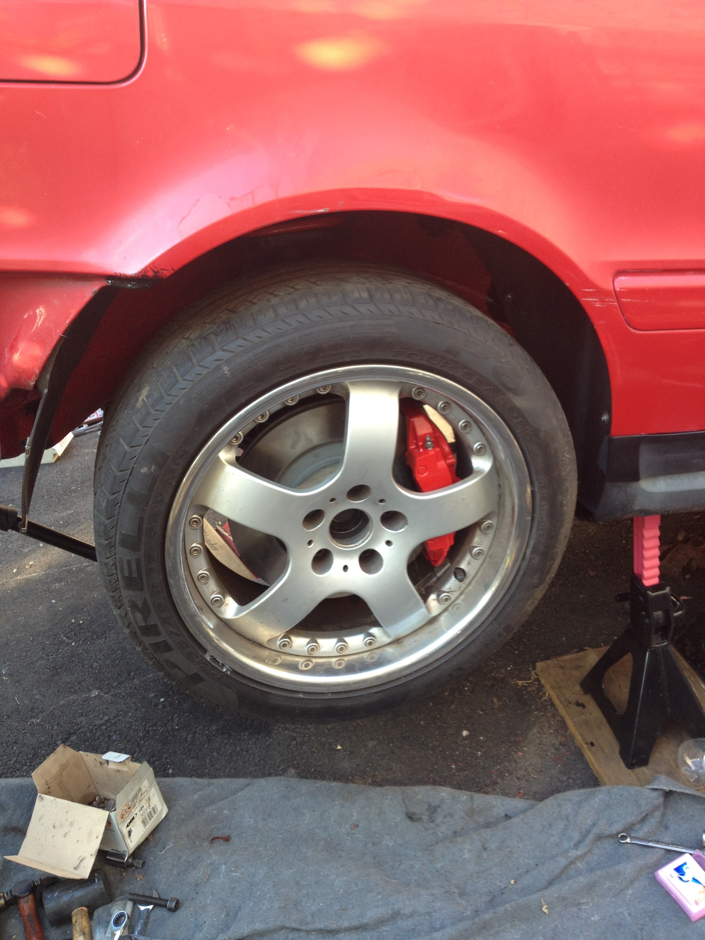

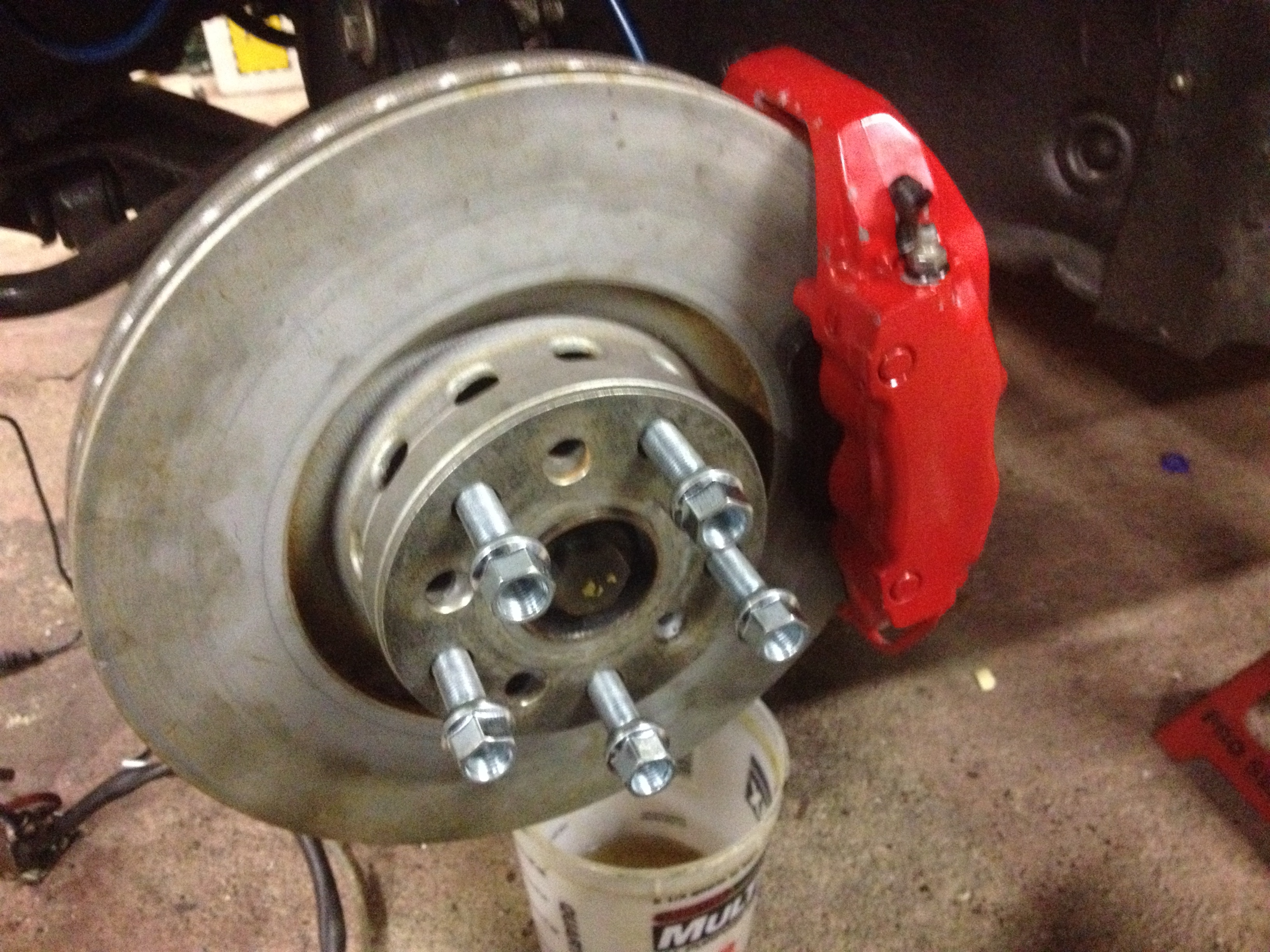

front brakes
- Sebastian's CQ91' front brakes bracket .JPG (3.05 MiB) Viewed 41767 times
- Sebastian's CQ91' brakes done.jpg (2.85 MiB) Viewed 41767 times
- Sebastian's CQ91' front brakes .JPG (1.93 MiB) Viewed 41767 times
- Sebastian's CQ91' wheels 17%22.jpg (2.98 MiB) Viewed 41767 times
some random photos
- Sebastian's CQ91' rebuild calipers.JPG (2.44 MiB) Viewed 41757 times

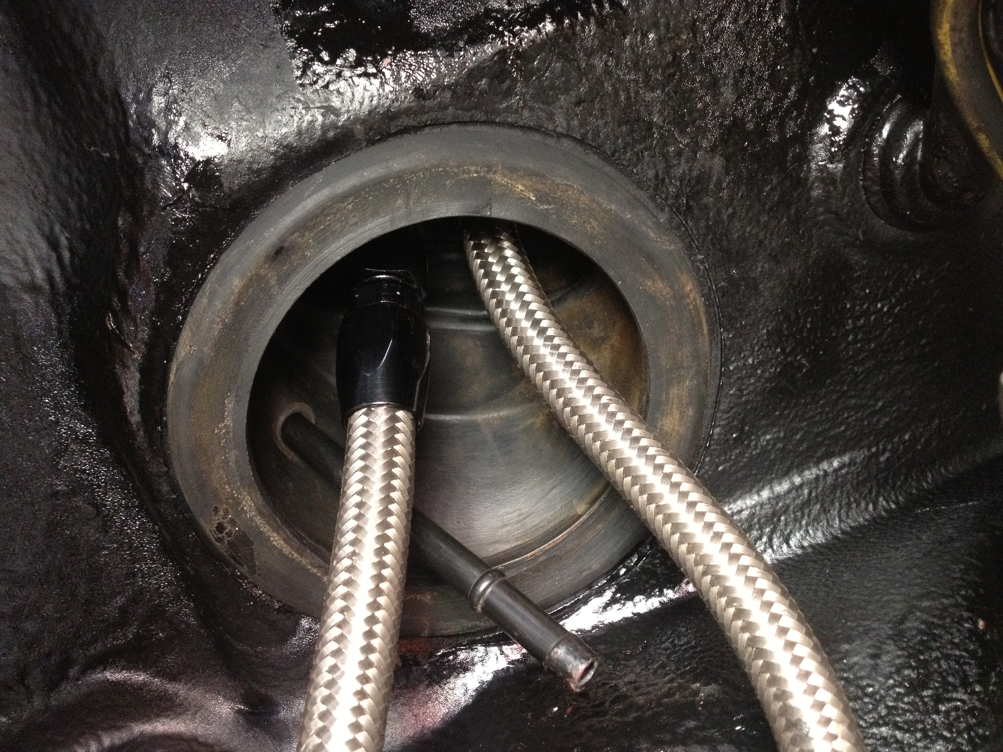

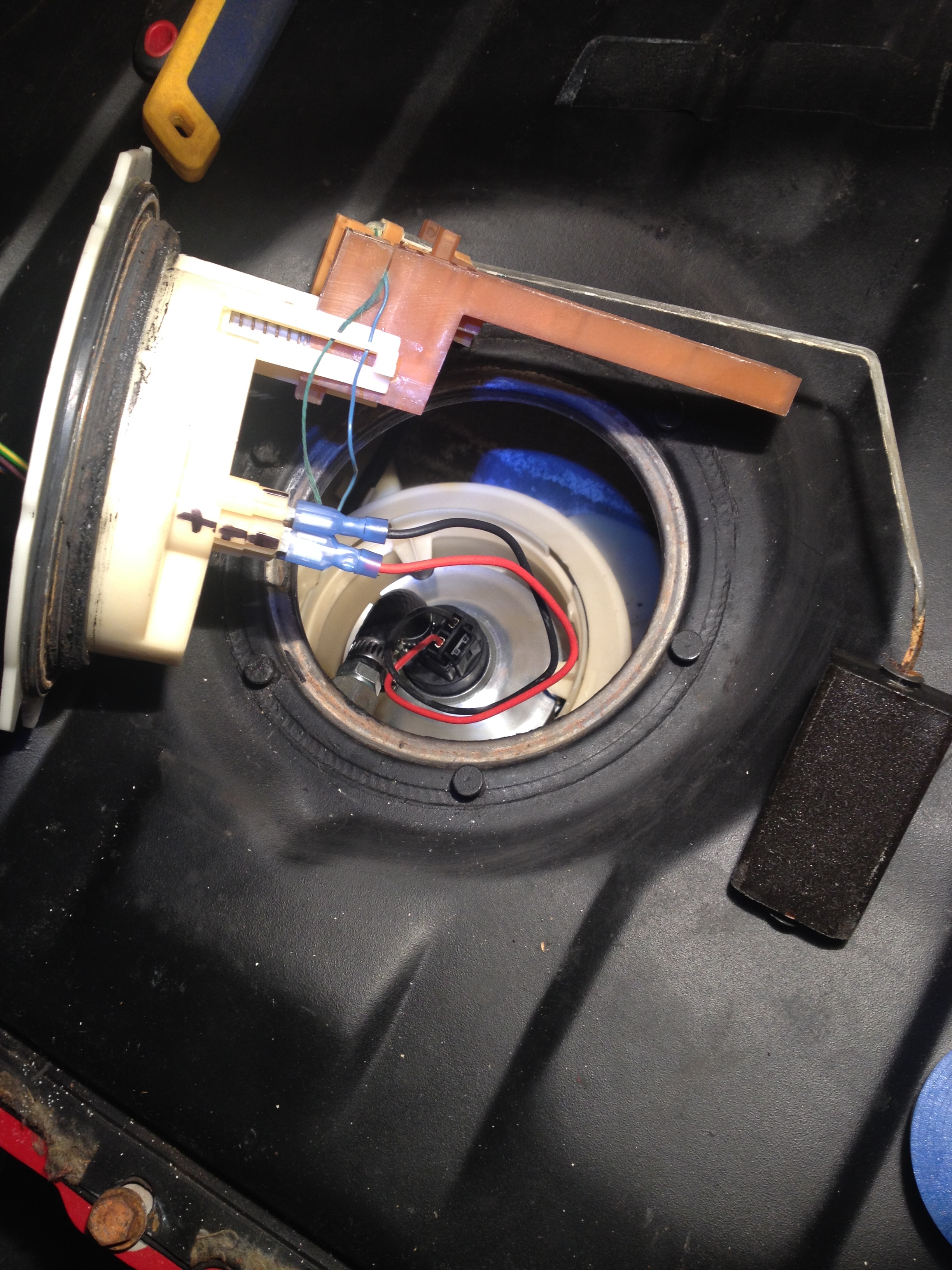

- Sebastian's CQ91' fuel filter housieng restored.JPG (2.31 MiB) Viewed 41757 times

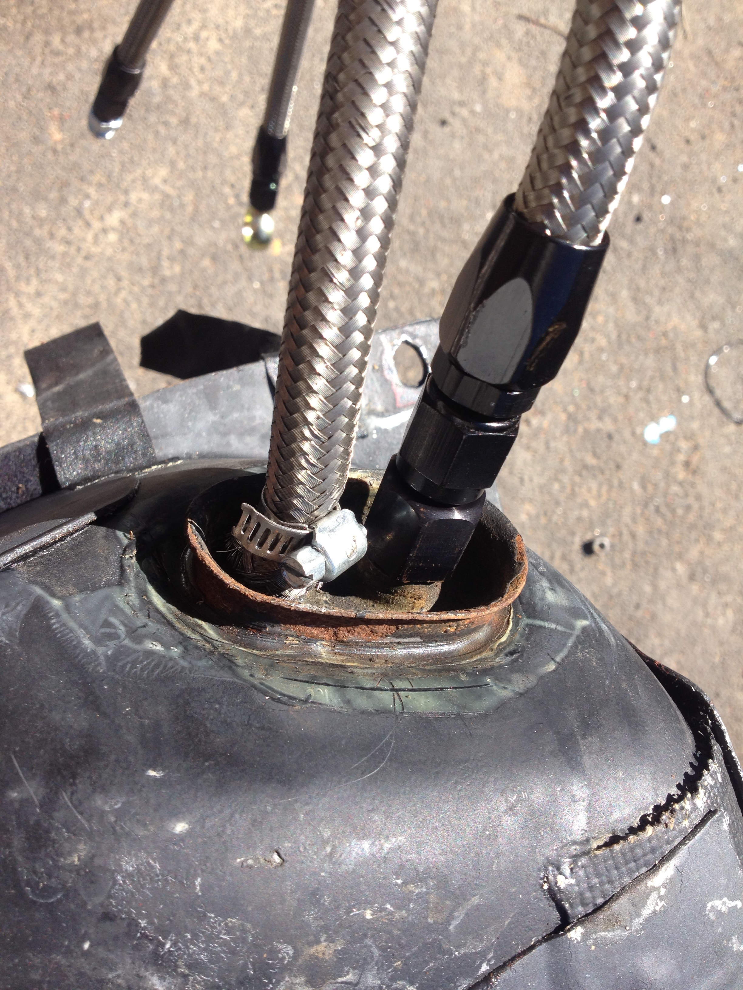

fuel lines, fuel tank connection with -6an fitting
- IMG_4209.jpg (2.15 MiB) Viewed 41748 times
- IMG_6083.jpg (3.69 MiB) Viewed 41748 times
- Sebastian's CQ91' fuel tank plastic hose fix.jpg (3.21 MiB) Viewed 41748 times
- Sebastian's CQ91' fuel tank lines.JPG (2.94 MiB) Viewed 41748 times
- Sebastian's CQ91' fuel filter new lines.JPG (2.31 MiB) Viewed 41748 times

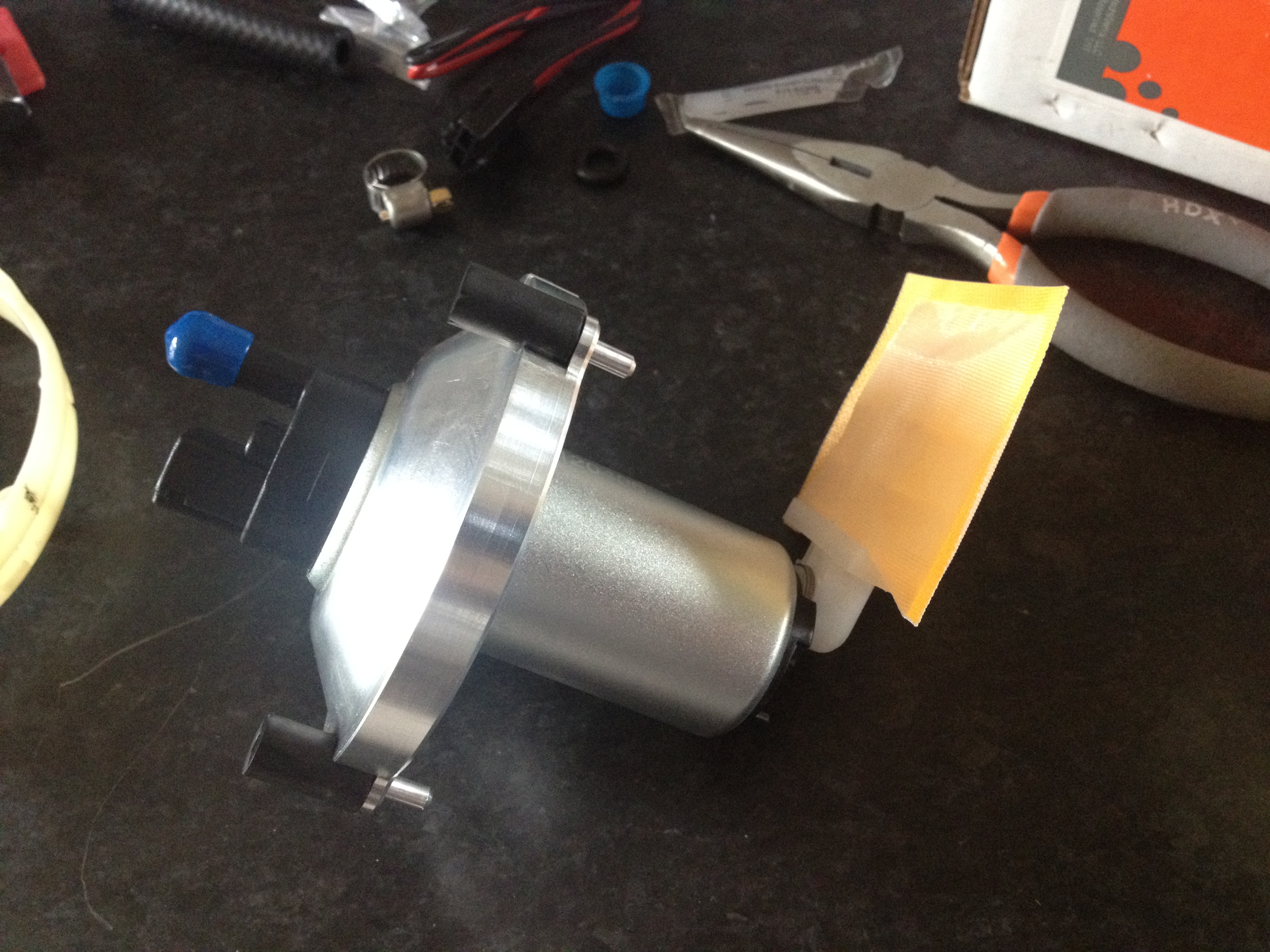

fuel pump and some wiring
- Sebastian's CQ91' fuel pump setup.JPG (2.3 MiB) Viewed 41747 times
- Sebastian's CQ91' fuel pump setup 3.JPG (2.39 MiB) Viewed 41747 times
- Sebastian's CQ91' fuel pump setup 2.jpg (2.3 MiB) Viewed 41747 times
- IMG_6877.jpg (2.39 MiB) Viewed 41747 times
- Sebastian -

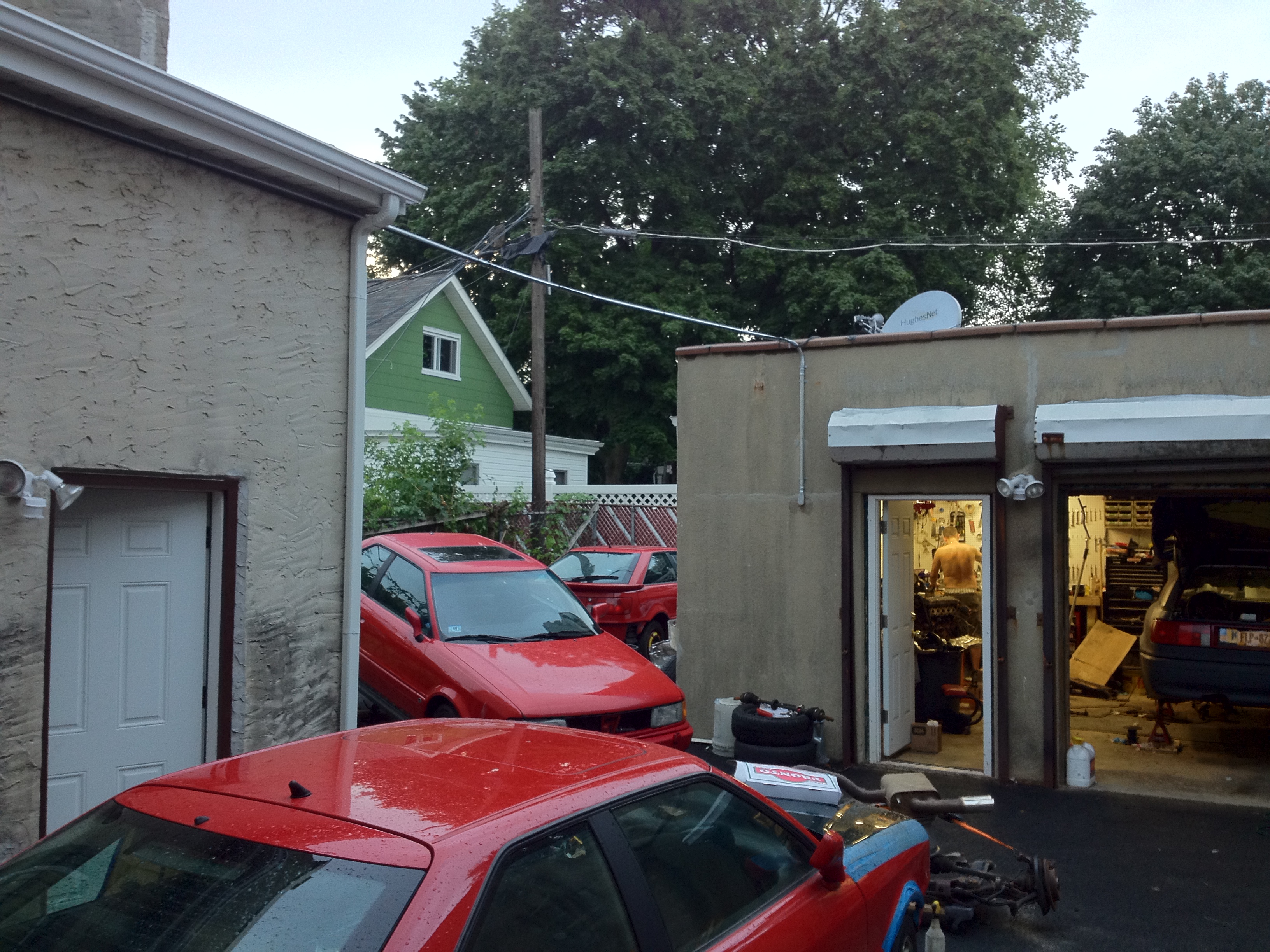

Our old shop (Mine and Adams) with two of my coupes far left, Danny's coupe with the blue tape and black primed Adam's full S2 built coupe inside.
- Sebastian's CQ91' old shop with coupes 2.JPG (2.62 MiB) Viewed 41746 times
- Sebastian -

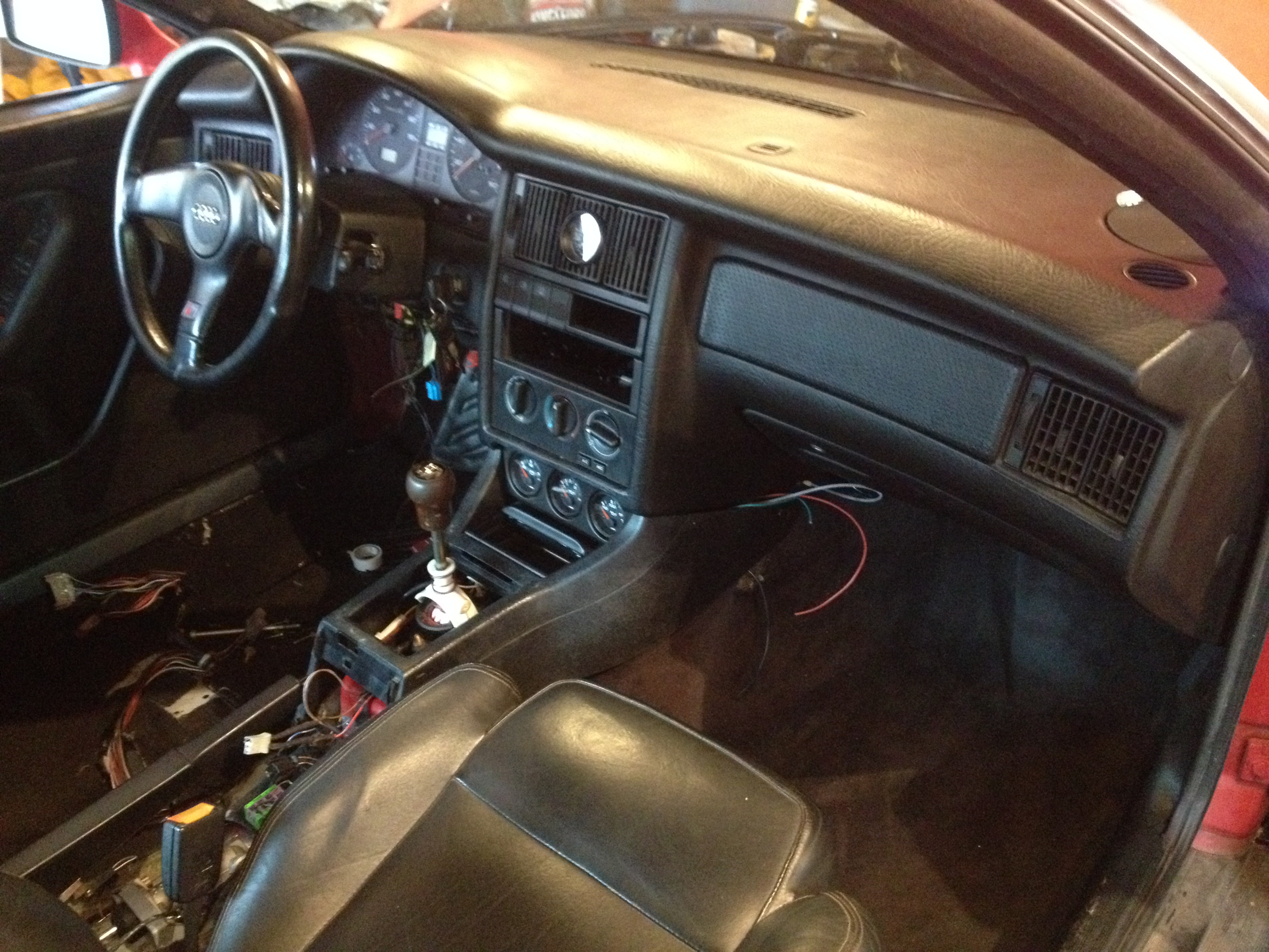

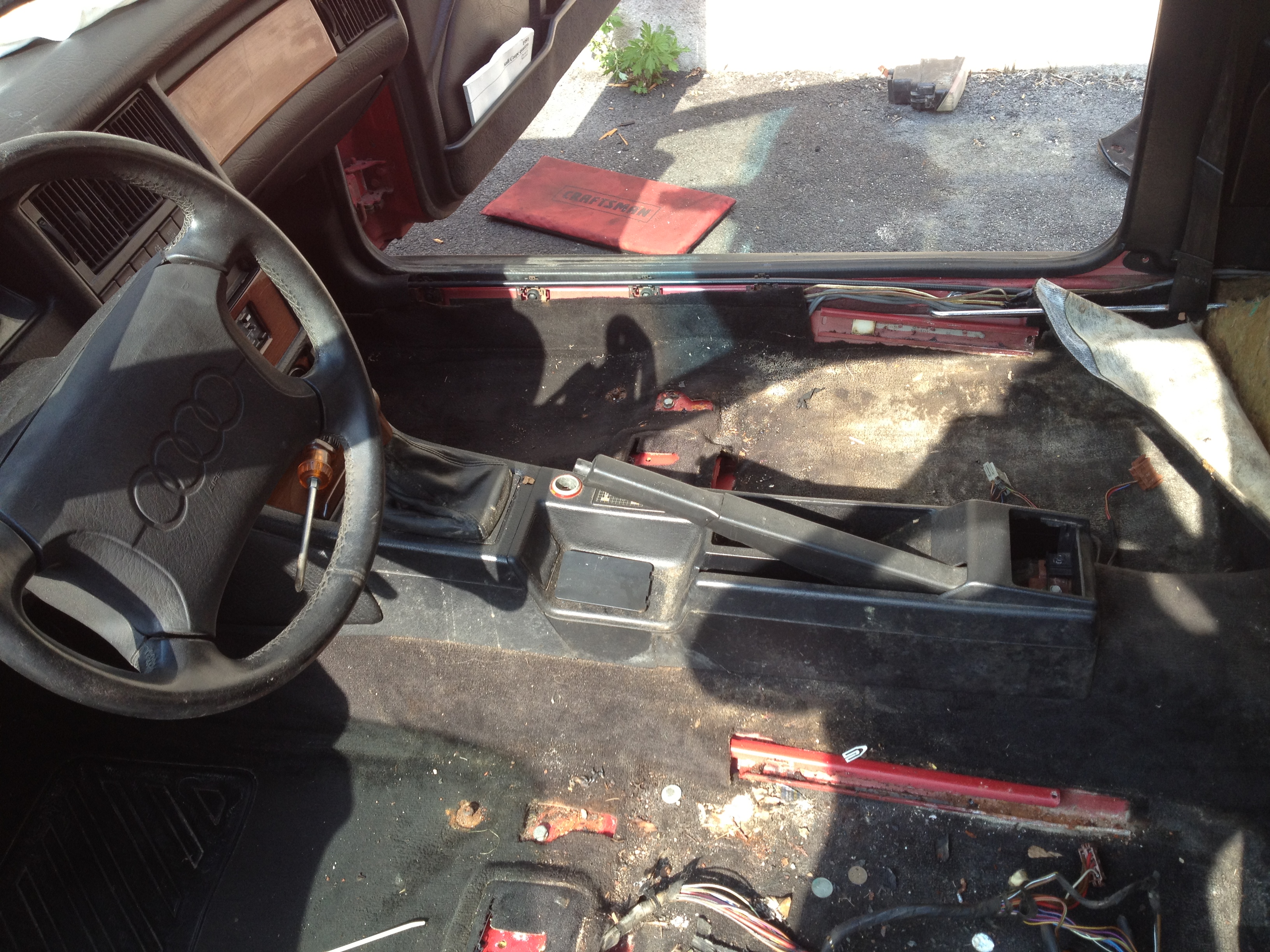

the whole interior got stripped of old heavy sound proofing and carpet under mat.
- Sebastian's CQ91' interior strip down 3.JPG (2.83 MiB) Viewed 41746 times
- Sebastian's CQ91' interior prep 1.JPG (2.86 MiB) Viewed 41746 times
- Sebastian's CQ91' interior strip 2.JPG (2.83 MiB) Viewed 41746 times

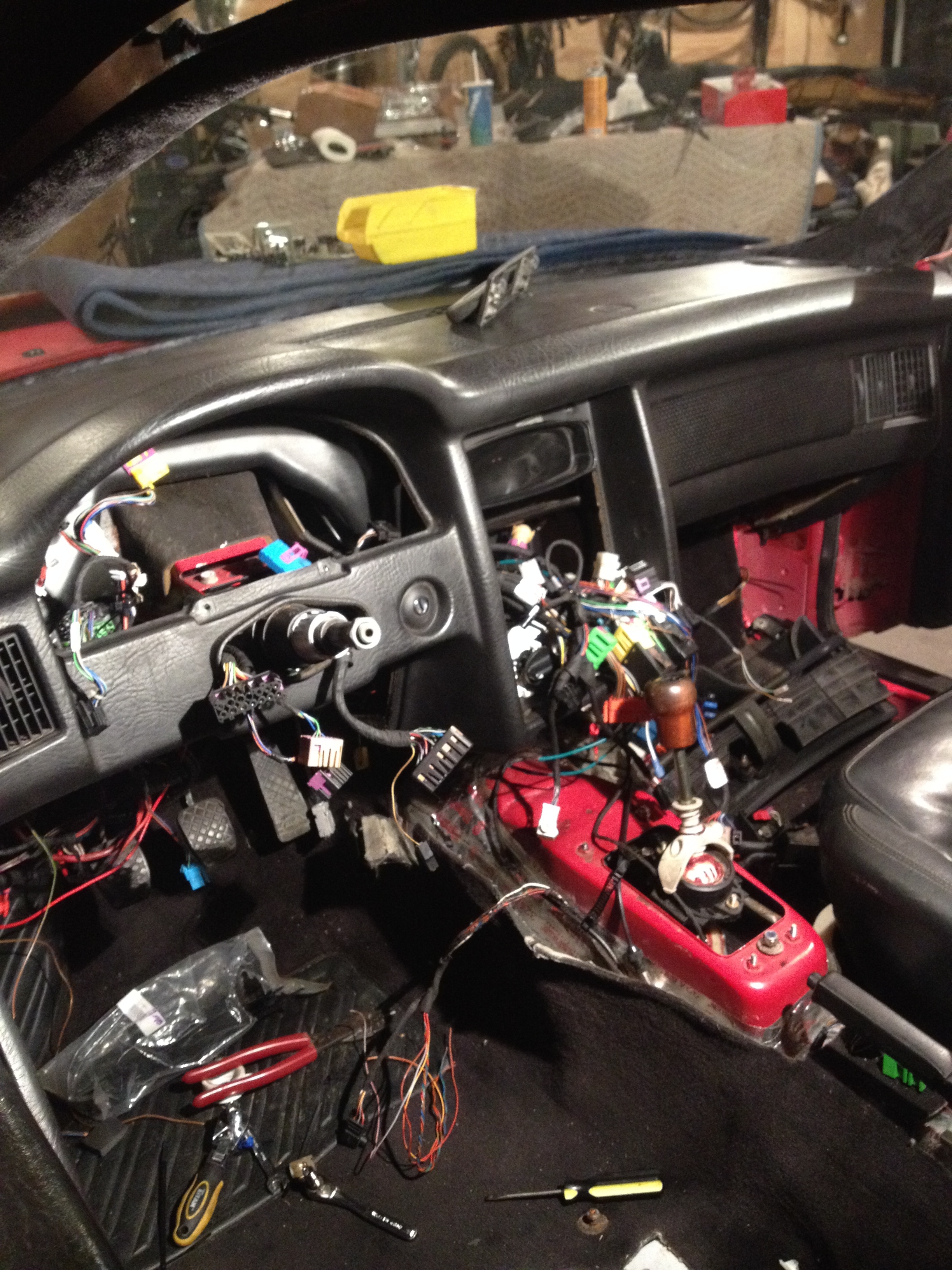

b4 manual climate control rebuild with new flapers and all black dash black leather trim also all old unused stock harness was cut out.
here is the upper trim of the interior that i have done in black suede it took two days to wrap it, my fiancee took snapped a picture of the material being applied
- Sebastian's CQ91' suede hard labor.jpg (2.62 MiB) Viewed 41742 times
- Sebastian's CQ91' suede complete uppper trim.JPG (2.65 MiB) Viewed 41742 times
- Sebastian's CQ91' suede interior 2.JPG (1.95 MiB) Viewed 41742 times
- Sebastian's CQ91' suede trunk.JPG (2.26 MiB) Viewed 41742 times
- Sebastian's CQ91' suede headliner 1.JPG (2.62 MiB) Viewed 41742 times

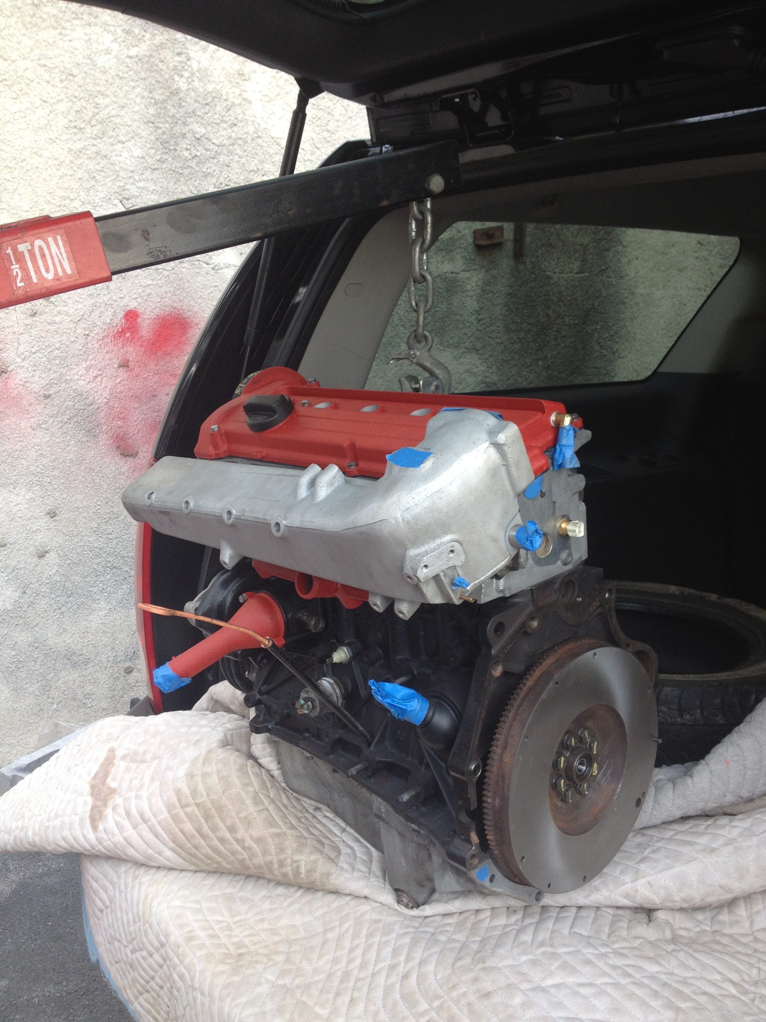

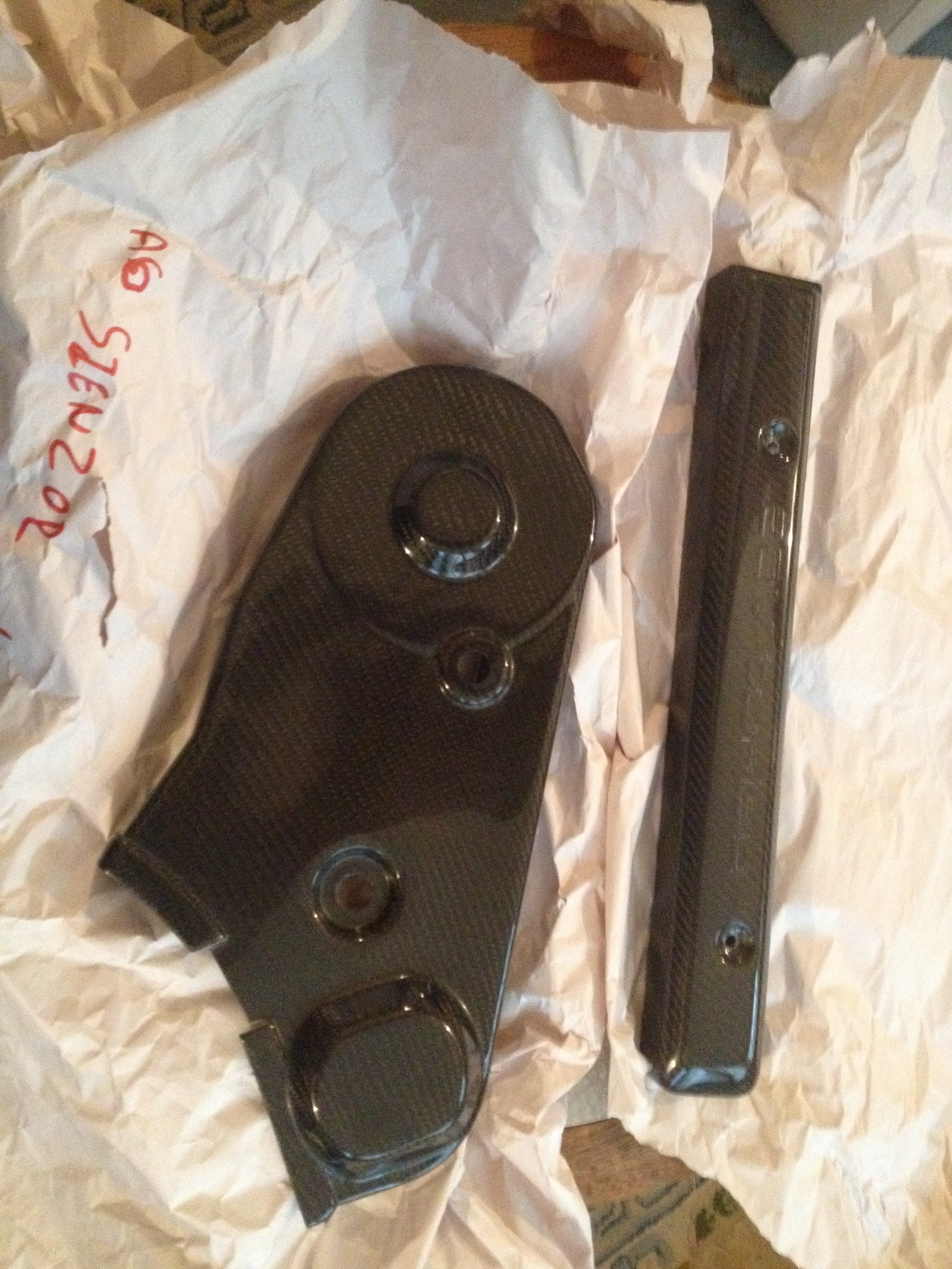

visiting Marc at EFI Express to pick up the motor
- Sebastian's CQ91' some carbon.jpg (3.09 MiB) Viewed 41651 times
- Sebastian's CQ91' Engine pick up 1.jpg (2.74 MiB) Viewed 41651 times
- Sebastian's CQ91' engine pick up 2.jpg (2.79 MiB) Viewed 41651 times

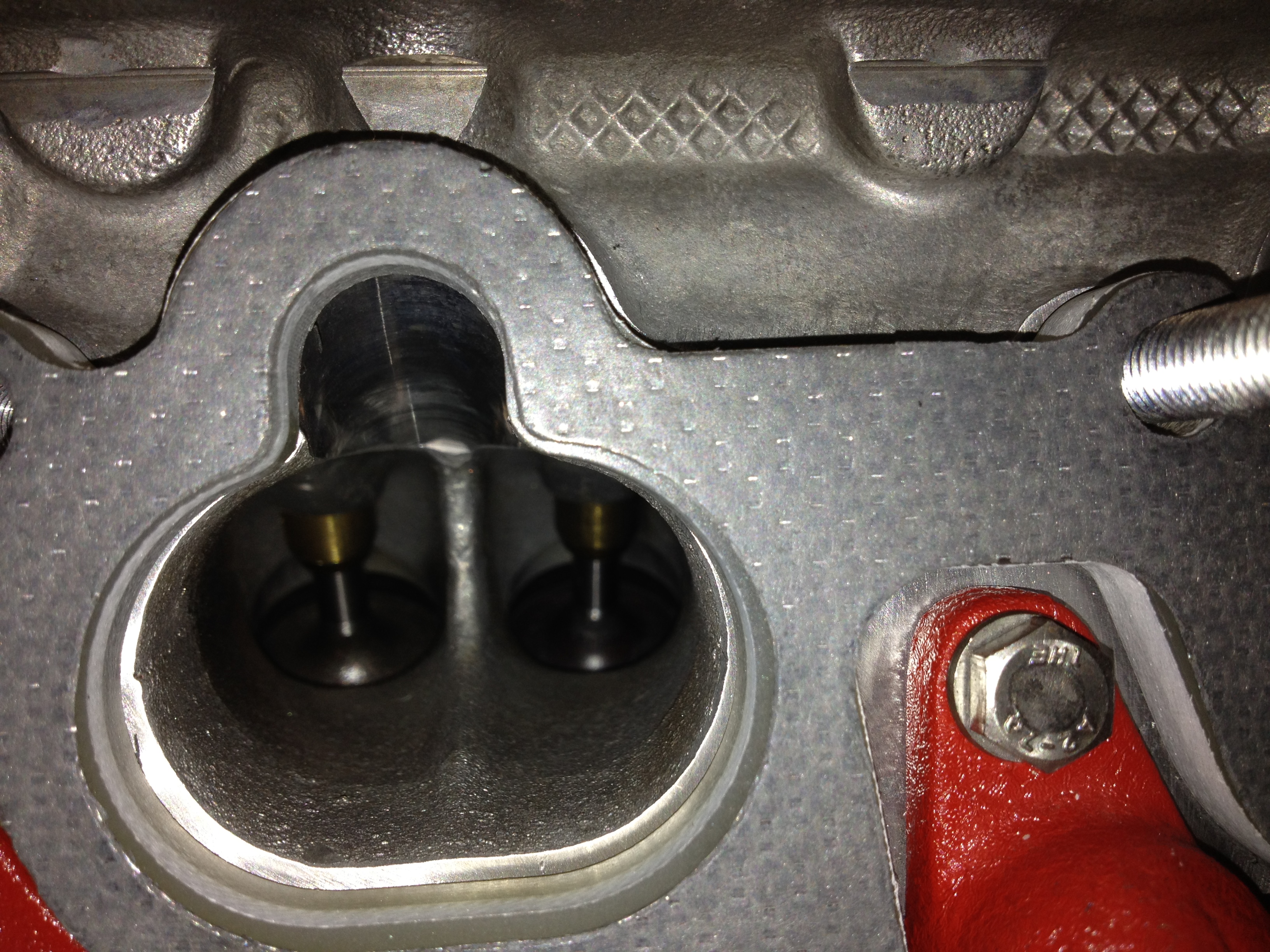

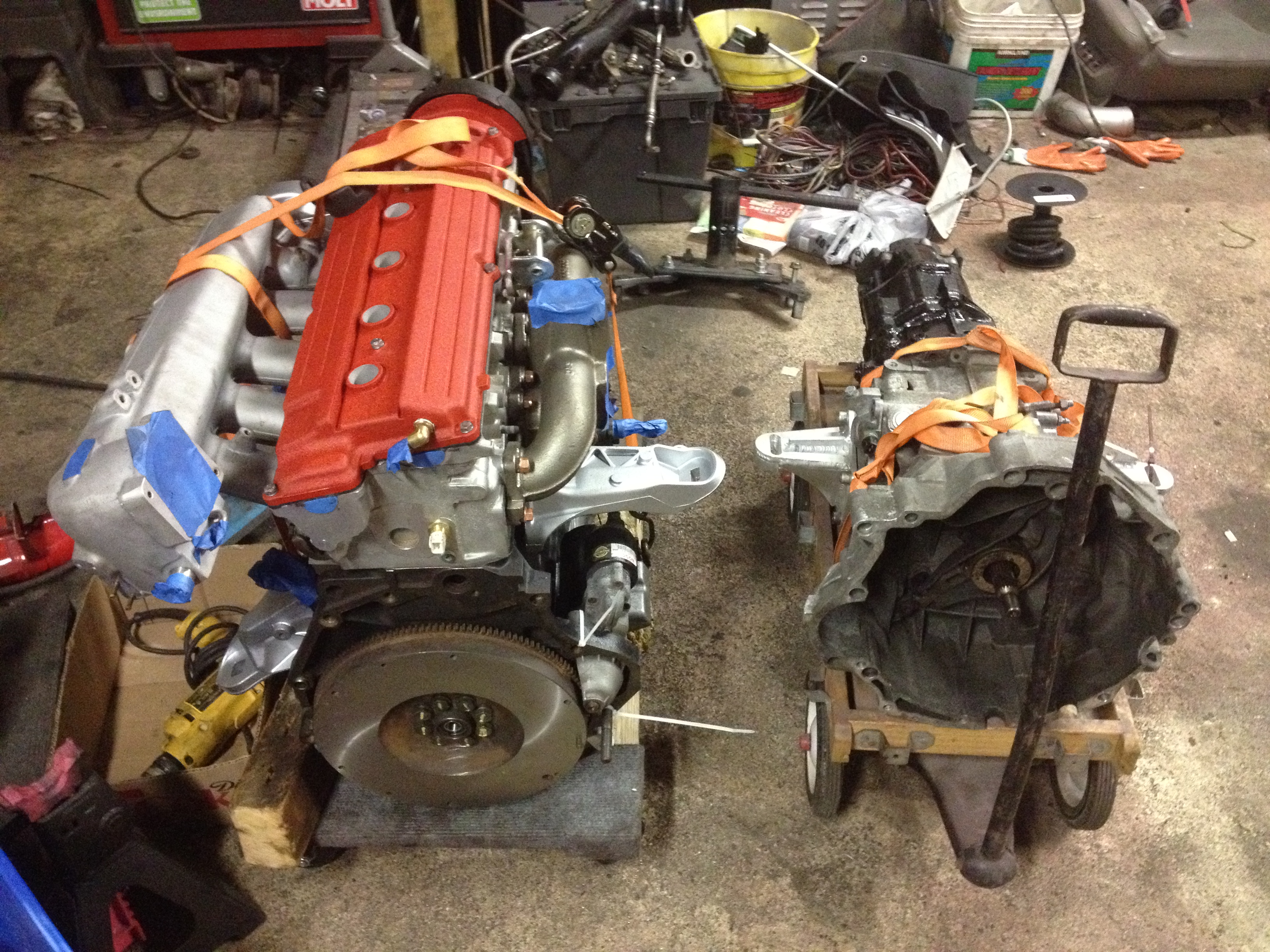

motor back at the garage and ready for further assembly along with 01e 6 speed from Dana here are some random shoots
the motor here is still with the rs2 exhaust manifold which was later upgraded to the Wagner Sport exhaust manifold.
some red wrinkle powder coat with some carbon fiber trim
