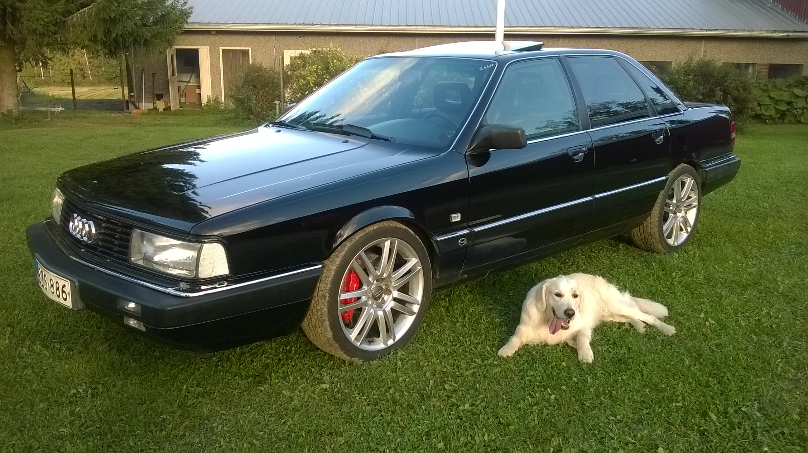

Currently I don't have many good pictures of the car, but I managet to find some from my phone..
These are all from last summer and the car is currently in winter storage.
(Crazy to keep quattro in winter storage, I know, but maybe next winter after some fixes..)

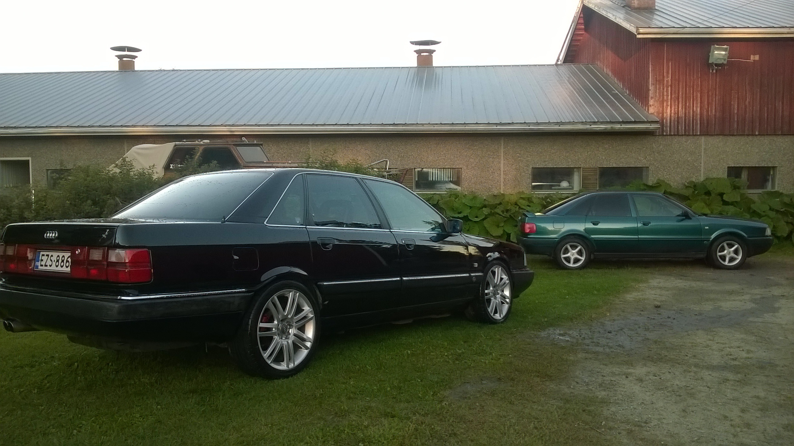

This one has the "USA front bumpers" which are kinda rare over here.
Missing a trim piece from front left corner below side reflector.
And Custom Auto Craft red rear lights of course. ;)

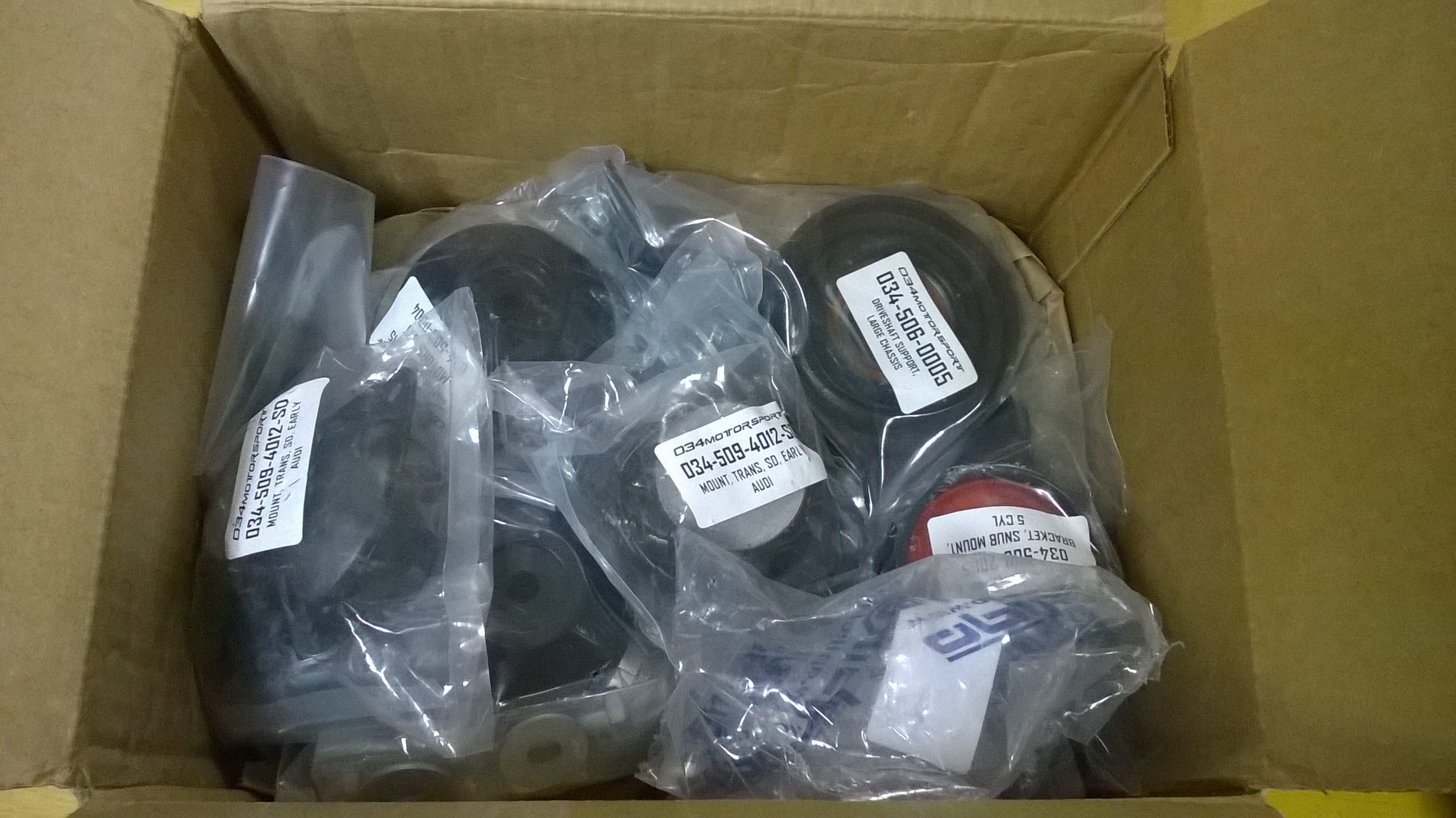

The car needs some suspension and drivetrain fixes, I can hear loud bang when going from on throttle <-> off throttle.
Bangs and clunks will be dealt with once the snow is gone and I get the car on lift, I already bought some aid from 034.
034 first aid
034 first aid

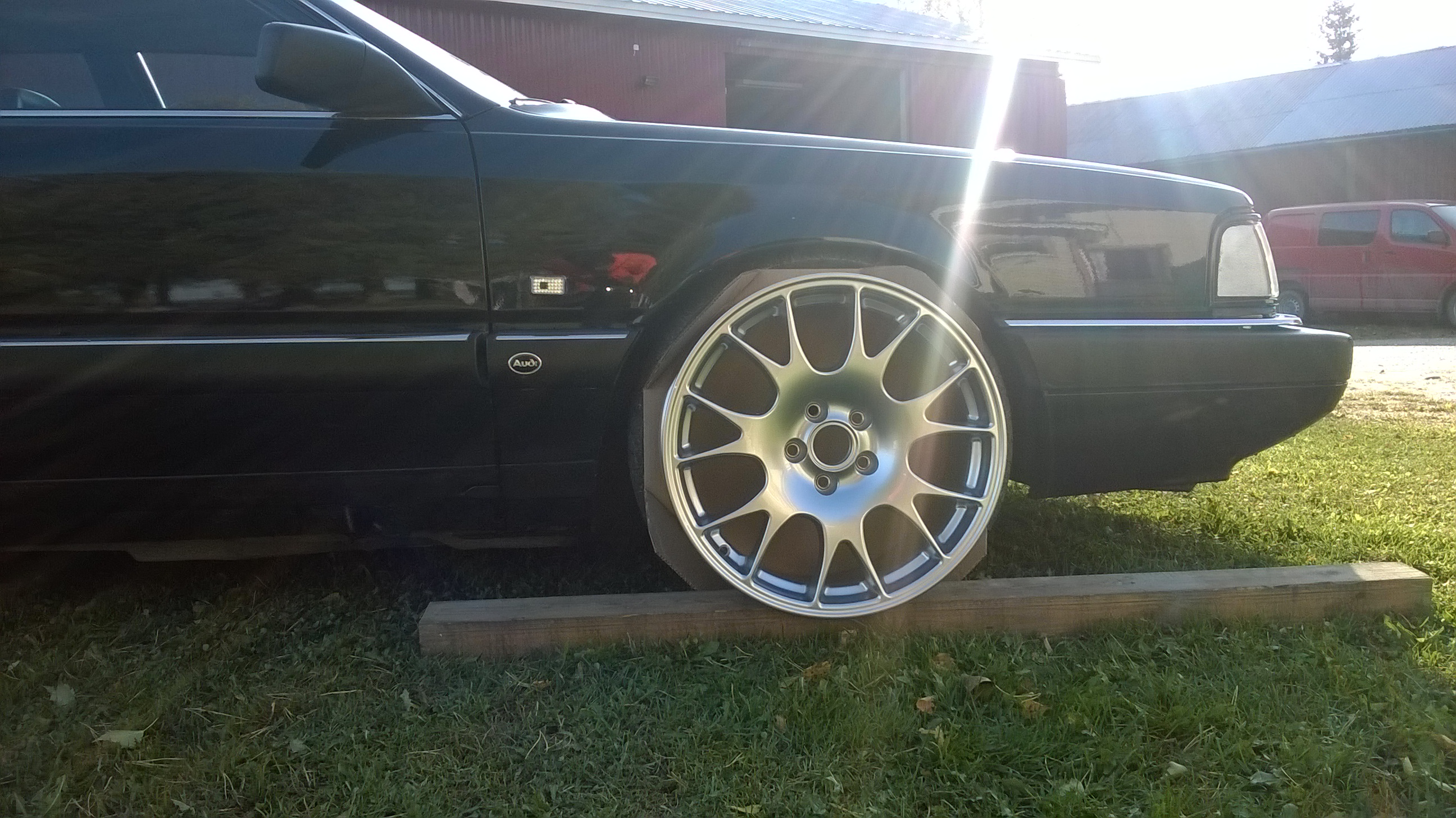

Accidentaly bought new rims for this one as well from Audi Tradition. Audi OEM BBS CH028.
I might try these or sell these, not a 100% sure yet.

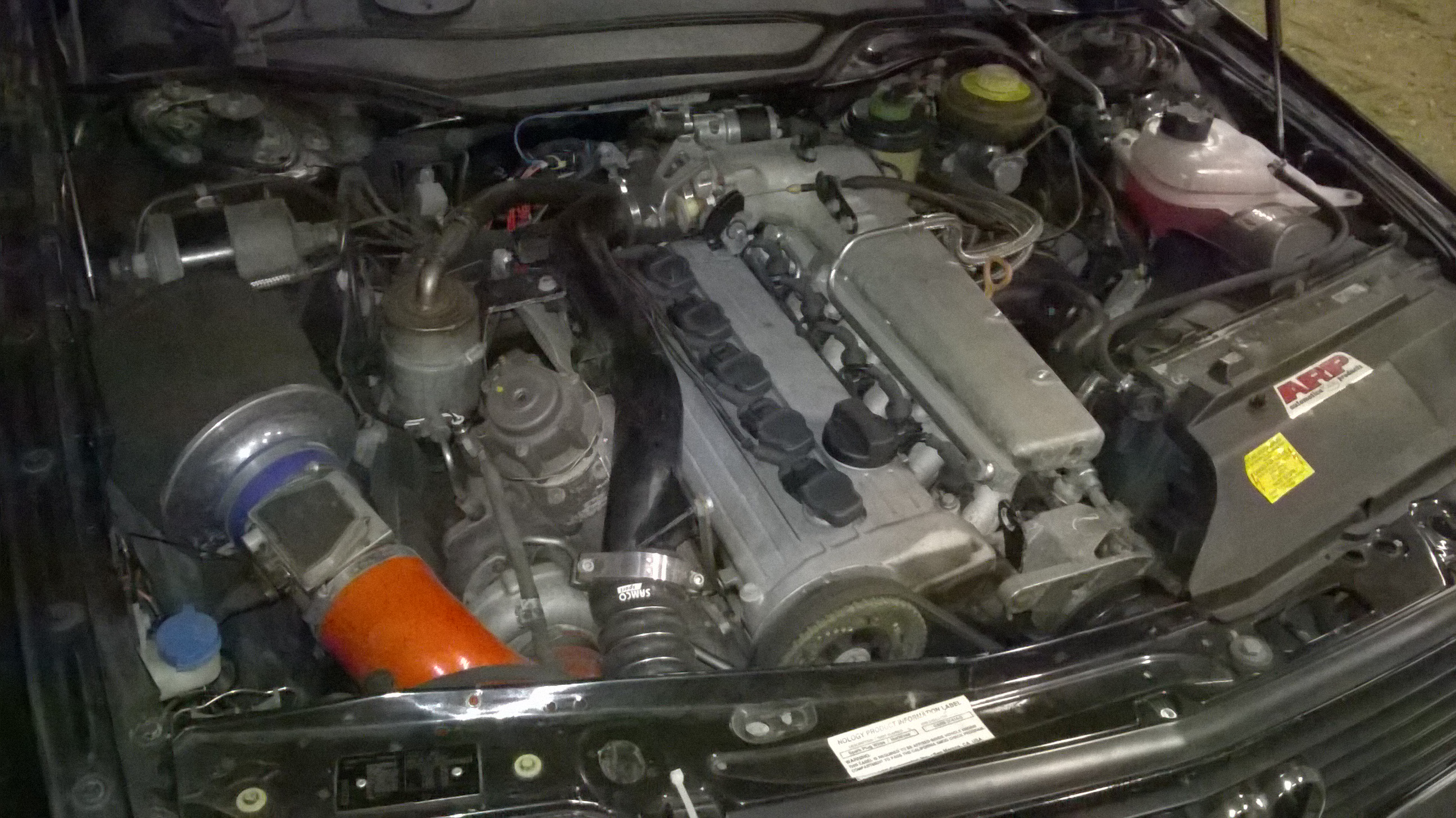

Heres one bad pic from engine bay.. Needs a clean up + something more. ;)
Can't wait to get this one back on the road. :drive: :D

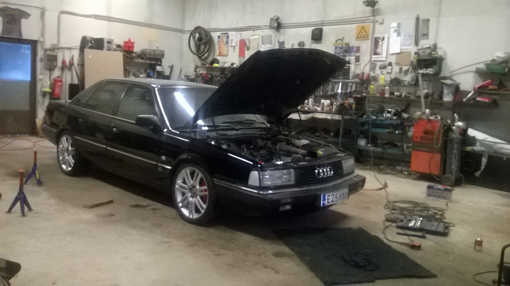

Got this one out of winter storage and back to garage at last.
Some problems had arisen though, the spark had gotten lost over winter. :we:
So after checking timing marks, the pin on flywheel and all ground wires that I could find, the engine finally started. :thumbsup:
I might need to redo the wiring for the coils..
If all goes according to plan, I'll check the compression tomorrow..

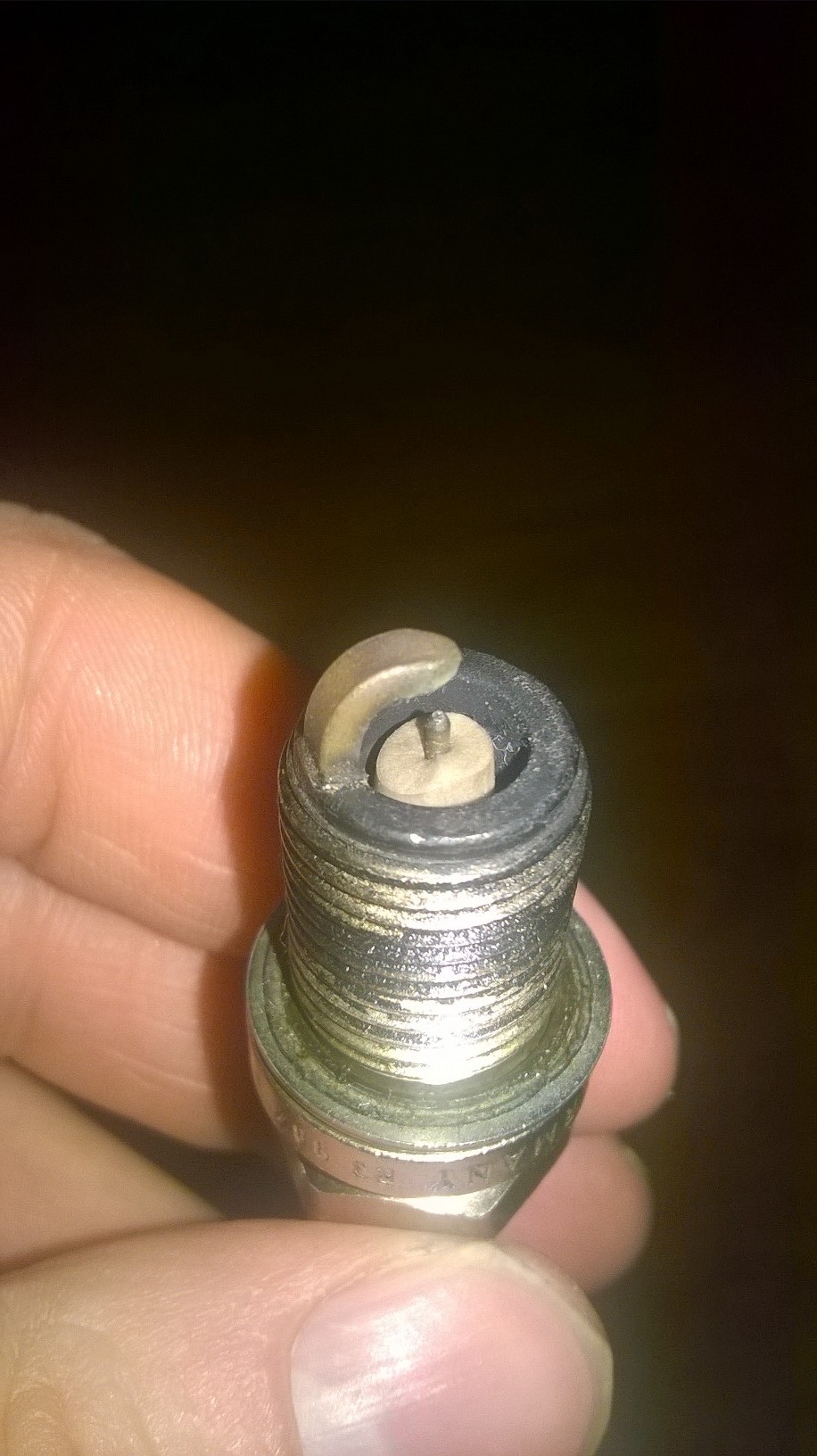

This happened last fall, the reason for compression testing:
Bosch FR5DP. :shame:
But, because I need to do the same mistakes over and over again before I learn something, I got new Bosch plugs. :foff:

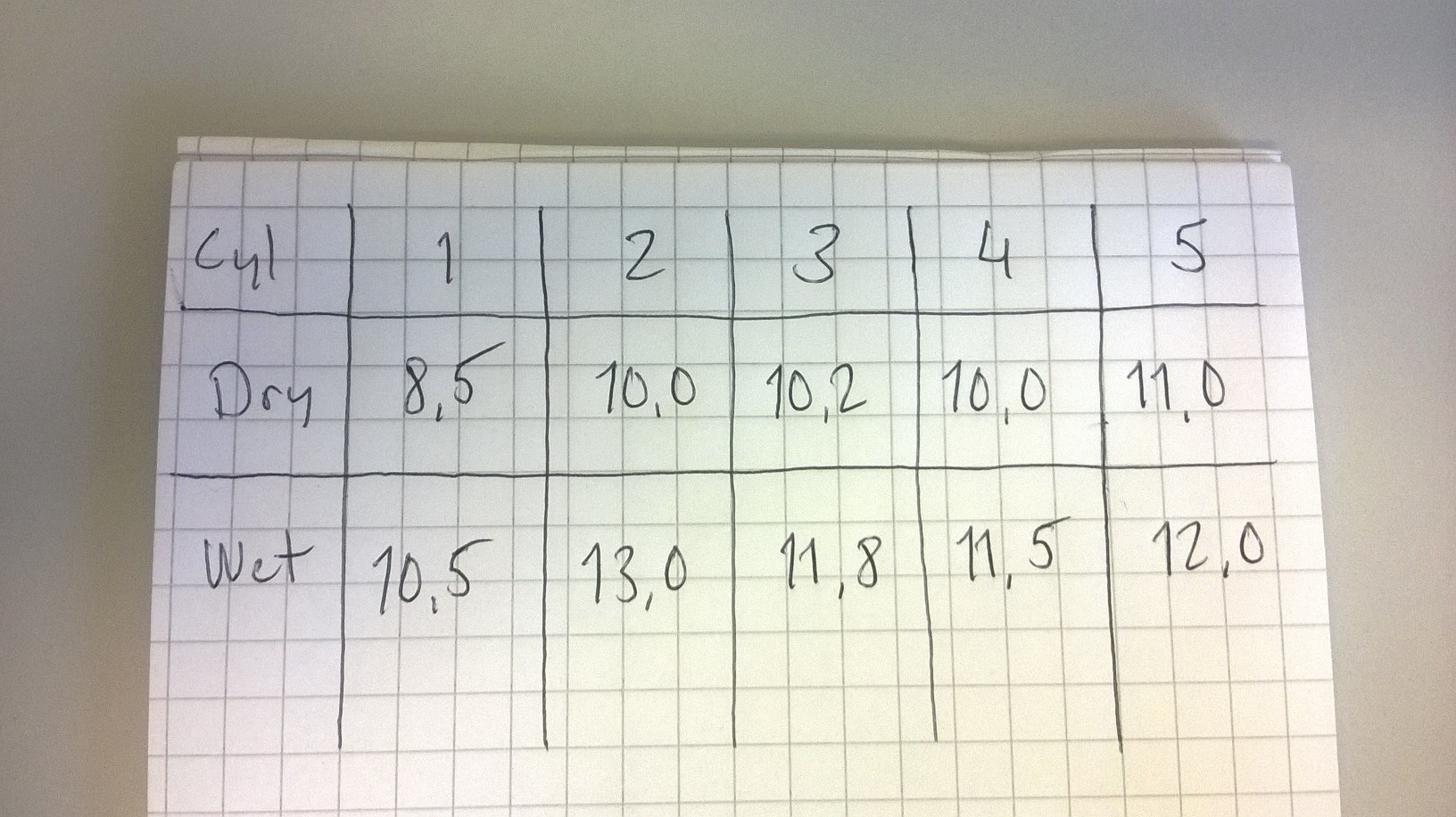

Okay, so got the compression tested.
So first cylinder from the timing belt is the poorest on both measurements. Oh, and the measures are in BAR.
Cyl 1 also has run on lean according to the plug, I need to get the injectors cleaned..
This might be a good excuse to get bigger injectors and more powa maybe...? :D
How far can I get with the 550cc dekas and E85?
Could the poor compression be due to the cylinder running lean for a while?
Or could I just have some clogged valves on 1 cylinder for some reason? Or..?
Leak down test might be in place here..
The destroyed Bosch plug was on cyl 4 last summer, so no clear indicators IMO from damages that the plug could have caused..
Missed a bullet there. :P

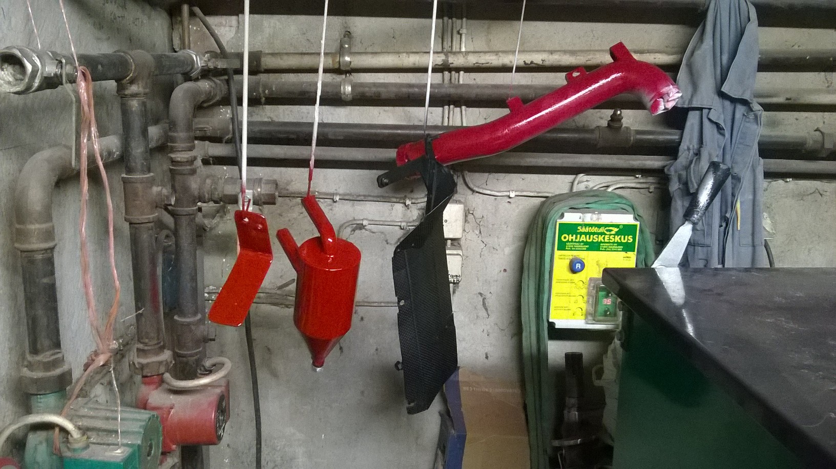

Painted some bits and bobs, but failed miserably. :lol:
Turns out I need to keep the hood closed from now on.. :rofl:

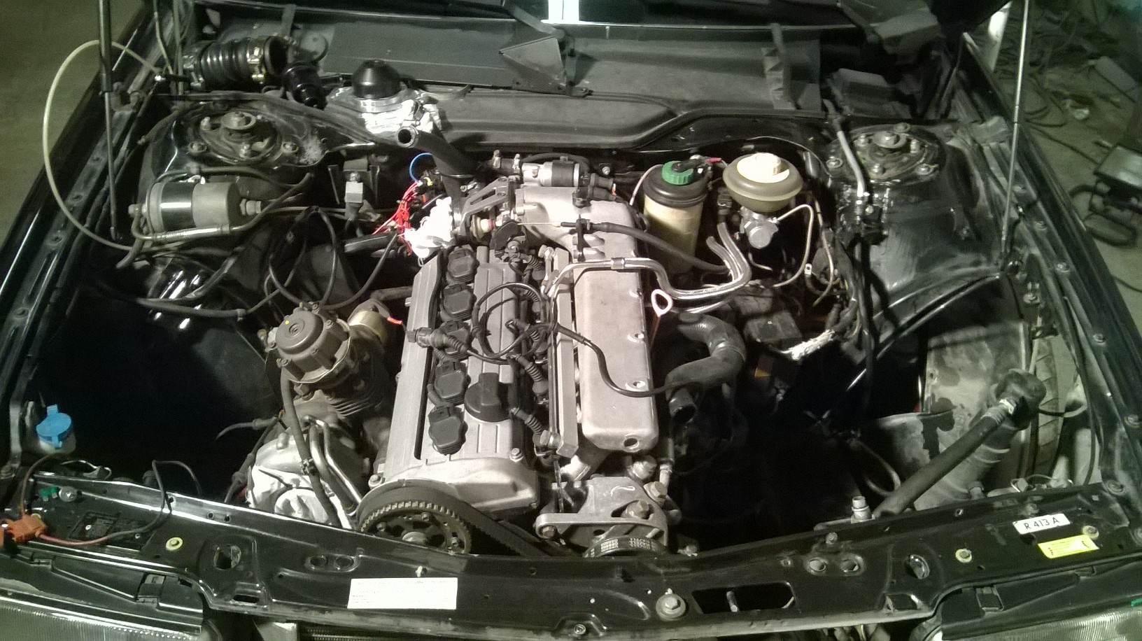

Found out that the radiator is busted and ordered full aluminium one from ebay.
There apparently is no alternative source for radiator/water hoses apart from 034 silicone set?
While taking radiator off I might have done some serious damage to the a/c cell in front of rad.. Now thinking to remove the whole a/c as it needs almost new everything to work properly.
Also need new washer fluid tank before taking this back to road.. The old one has turned into glass or some sort.

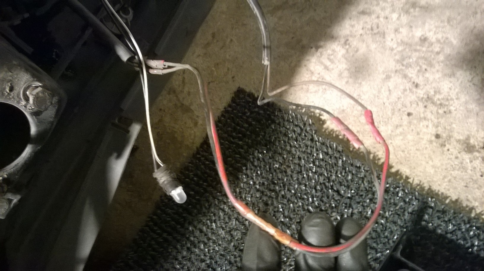

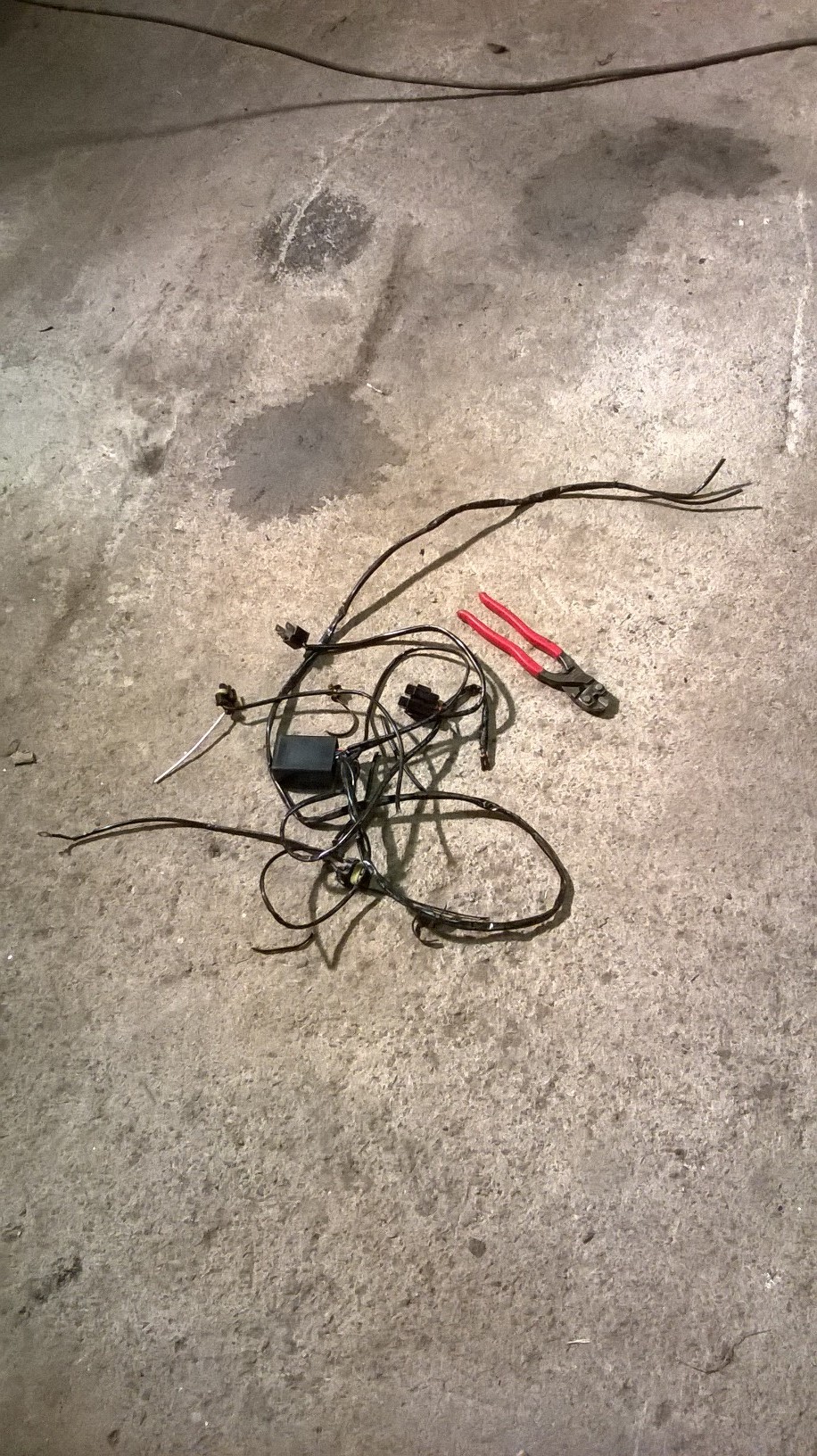

While taking everything apart I found out that this one is assembled mainly using drill screws and with electrical miracles as this:
:shame: :bs:
This one has also had xenons at some point..
But never again.

Ok, so the wires are mostly sorted now.
Got rid of all of those horrible connections and made somewhat a harness for lights in bumper.
Might still redo the coil wires at somepoint as they seem a bit odd...
