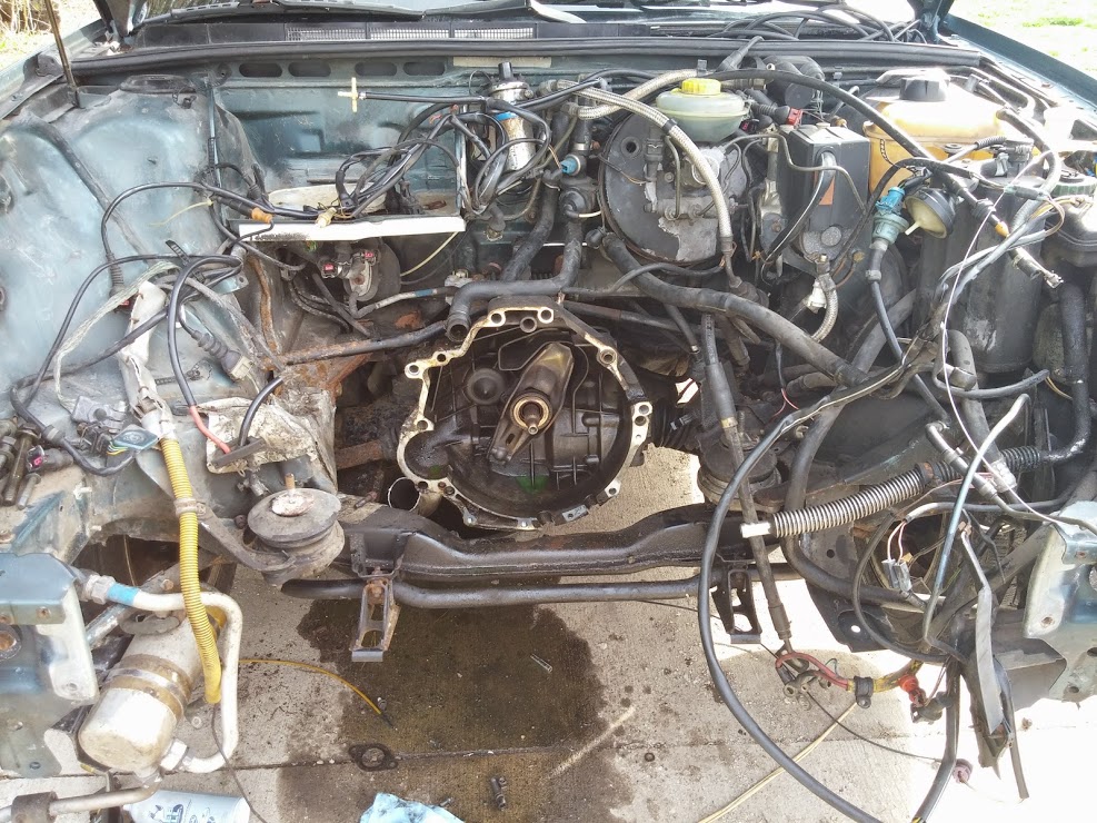

Finally had enough time to get the 7A yanked out.
Took a lot longer than I thought it would, I'm just used to working on vr6's and theres not 12 bolts holding the trans to the engine.
IMG_20150415_095742 (1).jpg (145.59 KiB) Viewed 15811 times
This weekend I'm going to work on getting the subframe removed and replacing all those degraded bushings.

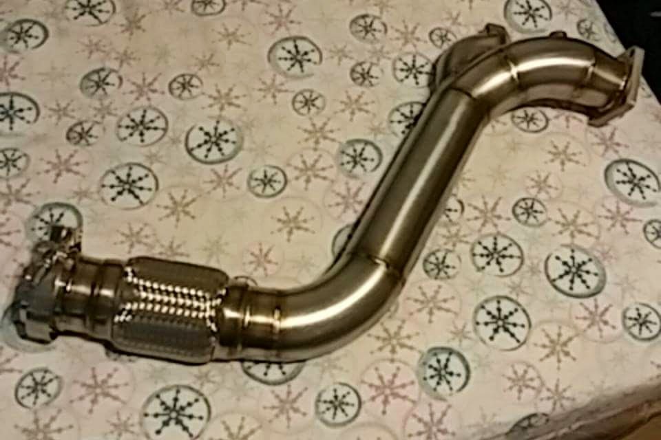

Also got my beautiful downpipe from hank this morning, which was delivered by a slightly shady fedex dodge caravan
Does anyone know what size/thread the fuel lines were that ran to the AAN fuel rail? They are slightly smaller than the 7A's.
