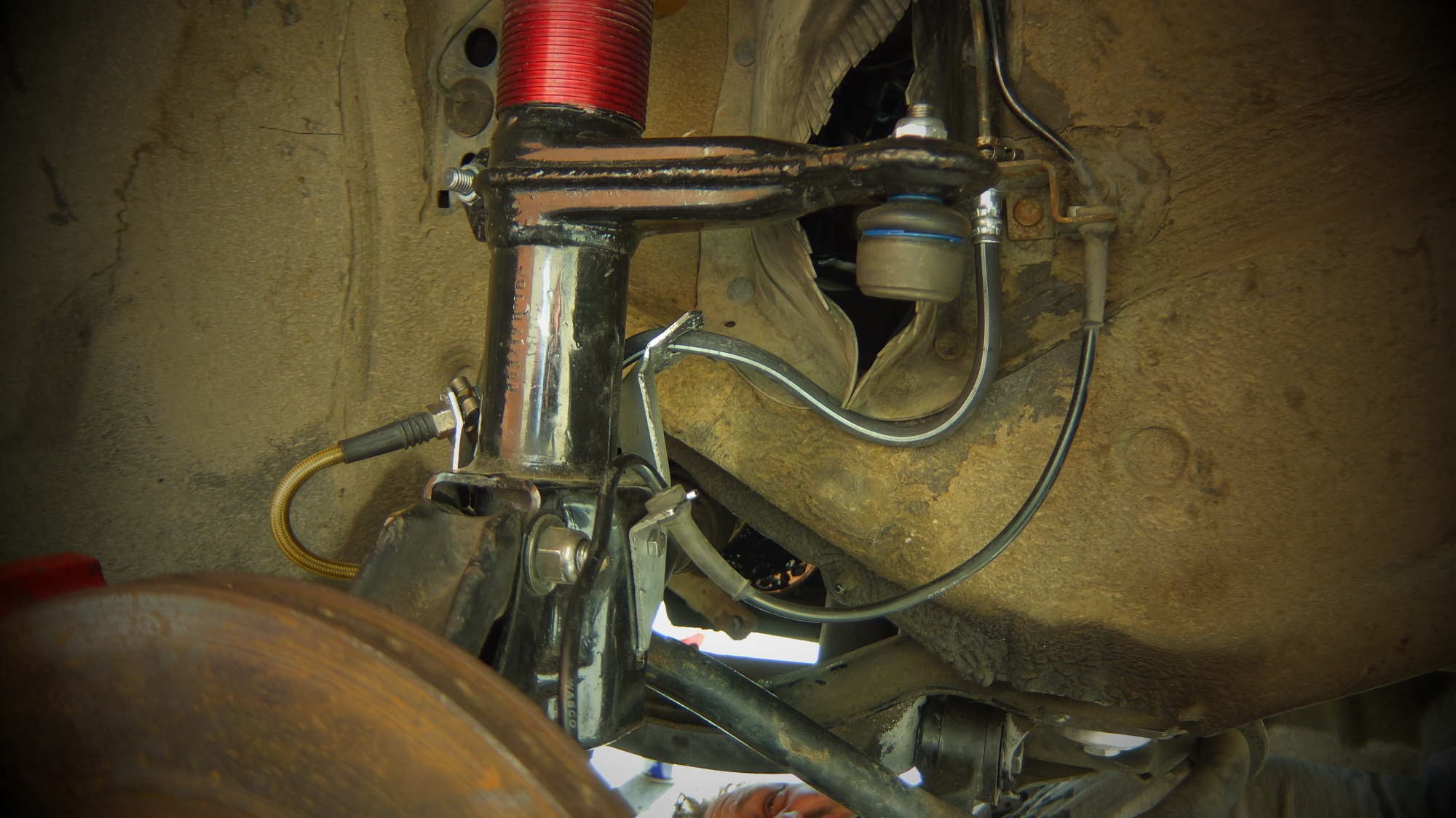

i did mine like this:
¯\_(ツ)_/¯

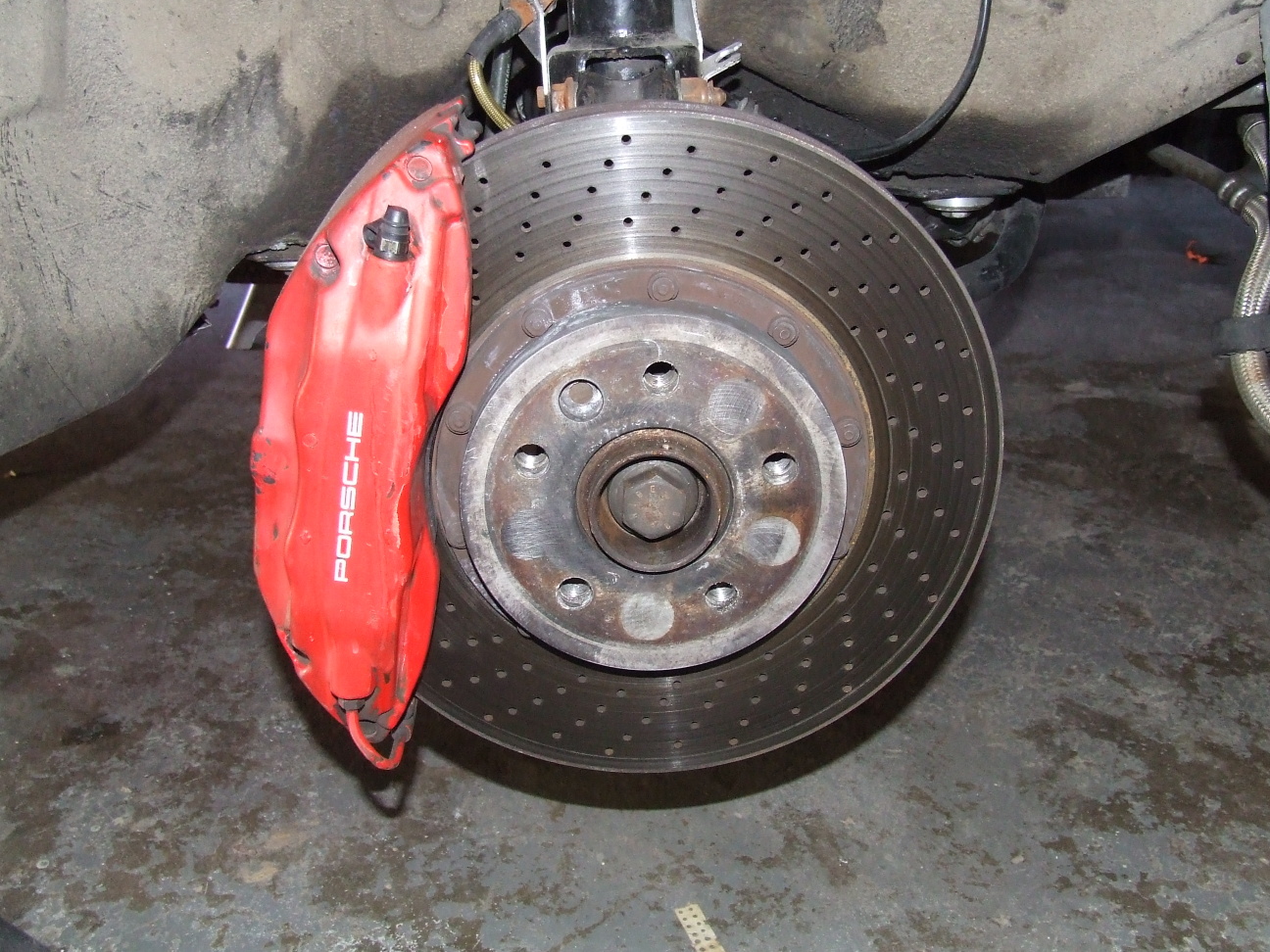

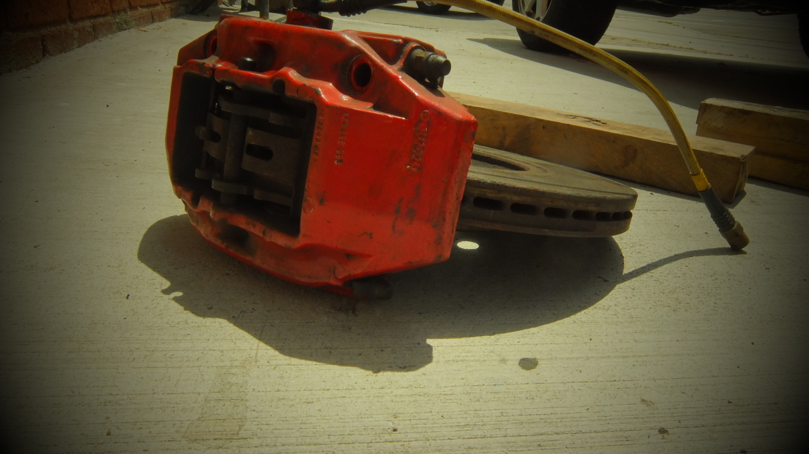

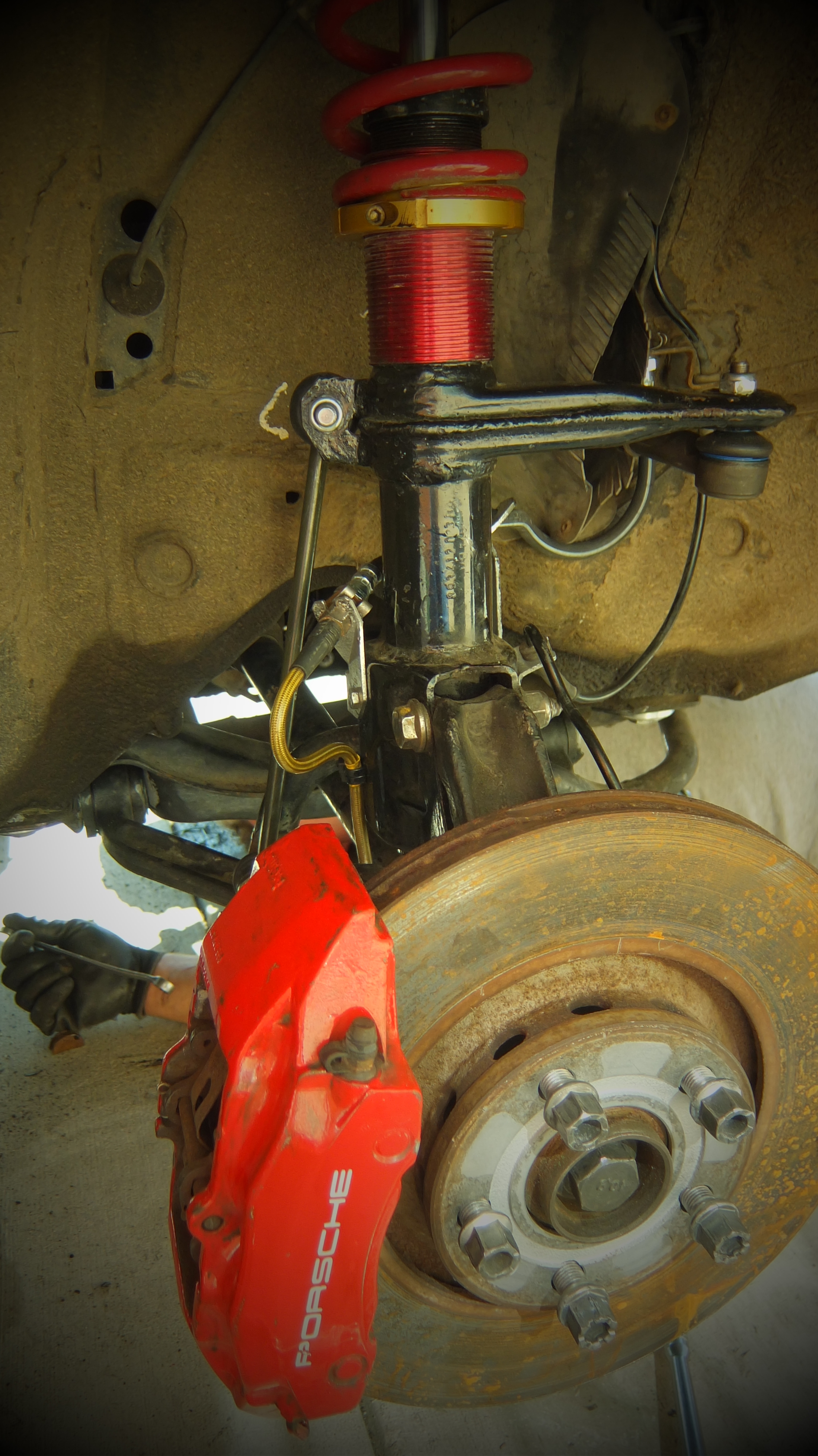

here are more pictures; first i had the boxter caliper, now a different one
