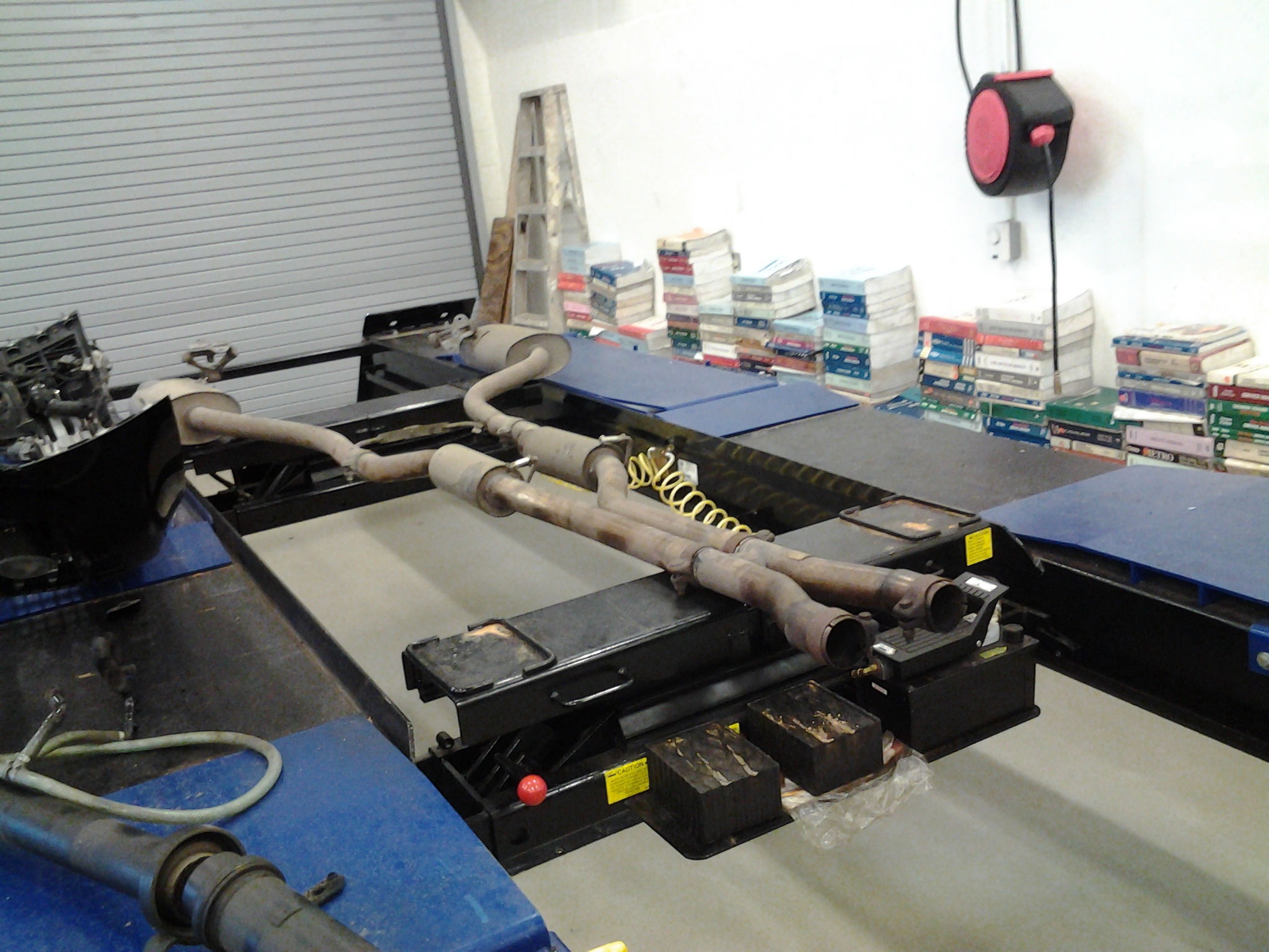

- Milltek catback
- 20150413_120305.jpg (918.18 KiB) Viewed 10530 times

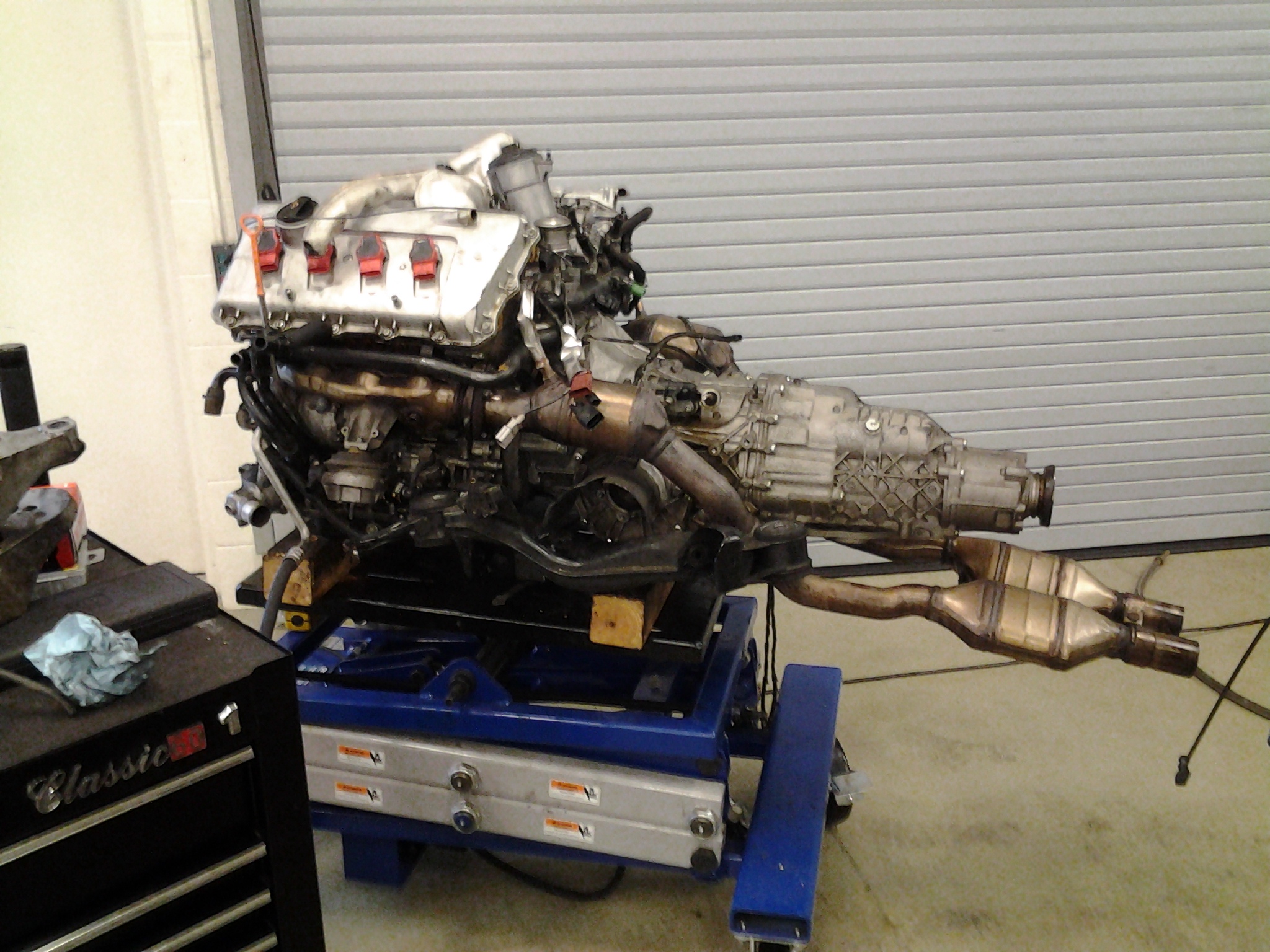

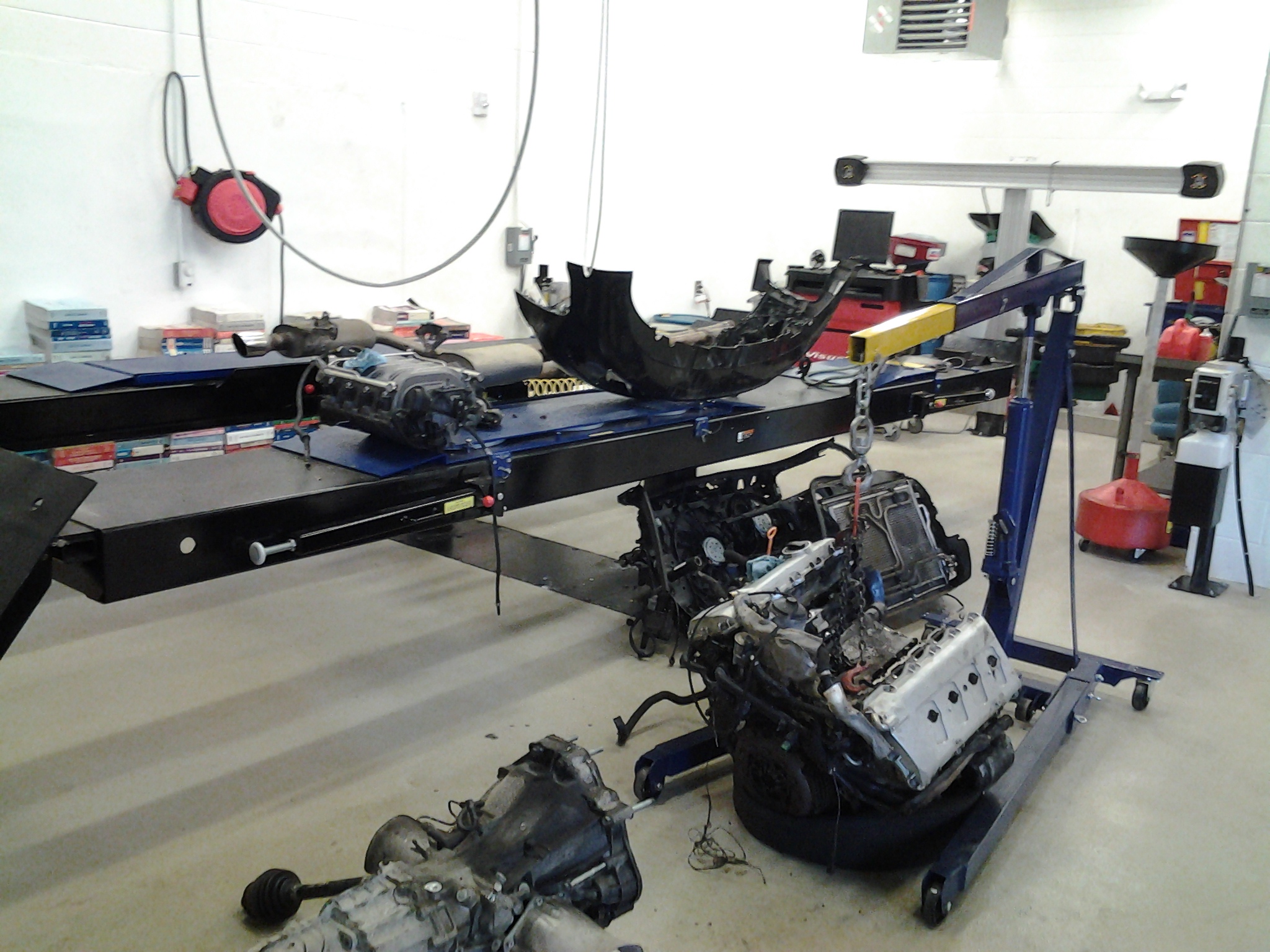

- Good motor waiting on flywheel and clutch
- 20150413_120243.jpg (891.75 KiB) Viewed 10530 times
- 20150413_185315.jpg (972.09 KiB) Viewed 10530 times

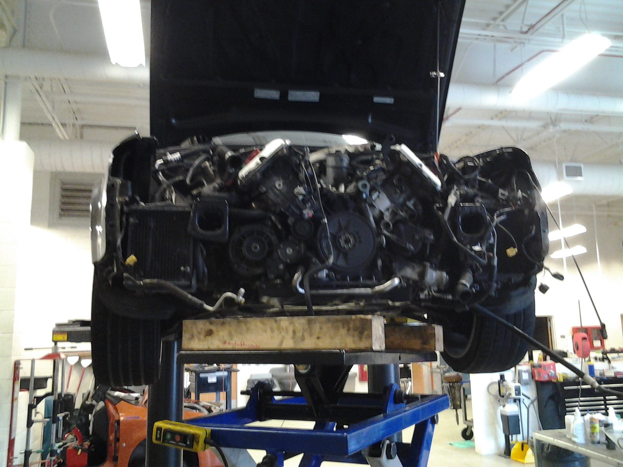

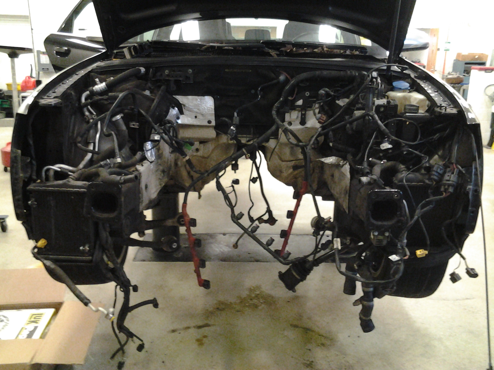

- And shes out!
- 20150413_185325.jpg (963.22 KiB) Viewed 10530 times
- About to pull the bad motor
- 20150413_120239.jpg (947.91 KiB) Viewed 10530 times

Are you doing any work on the timing chain system?

2nd on doing the chains guides and JHM mechanical tensioners while the engine is out. They all fail eventually.
Re: b6 s4 motor swap with some goodies
At minimum im replacing the cam adjusters, beyond that it just depends on how things look
Most of the guides are mostly plastic, pulling the rear cover and not doing them just isn't smart.
