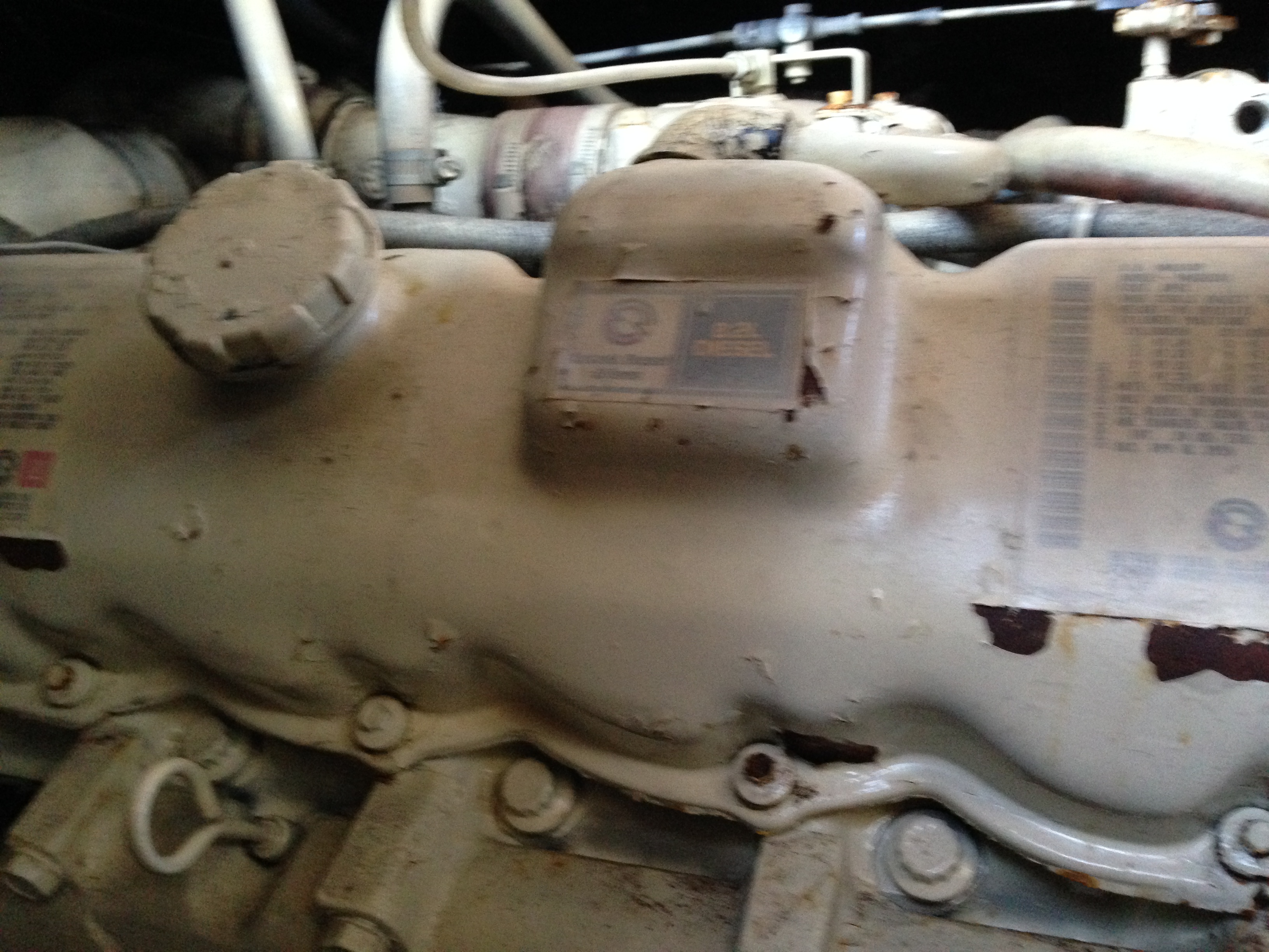

Let's see those engines.

I'll pull the engine covers today after work and post some up. I need to do some work there this evening. The bottom paint arrives today :P
Re: What has 16 cylinders, but floats better than a Veyron?
Seriously though... where are those pictures?

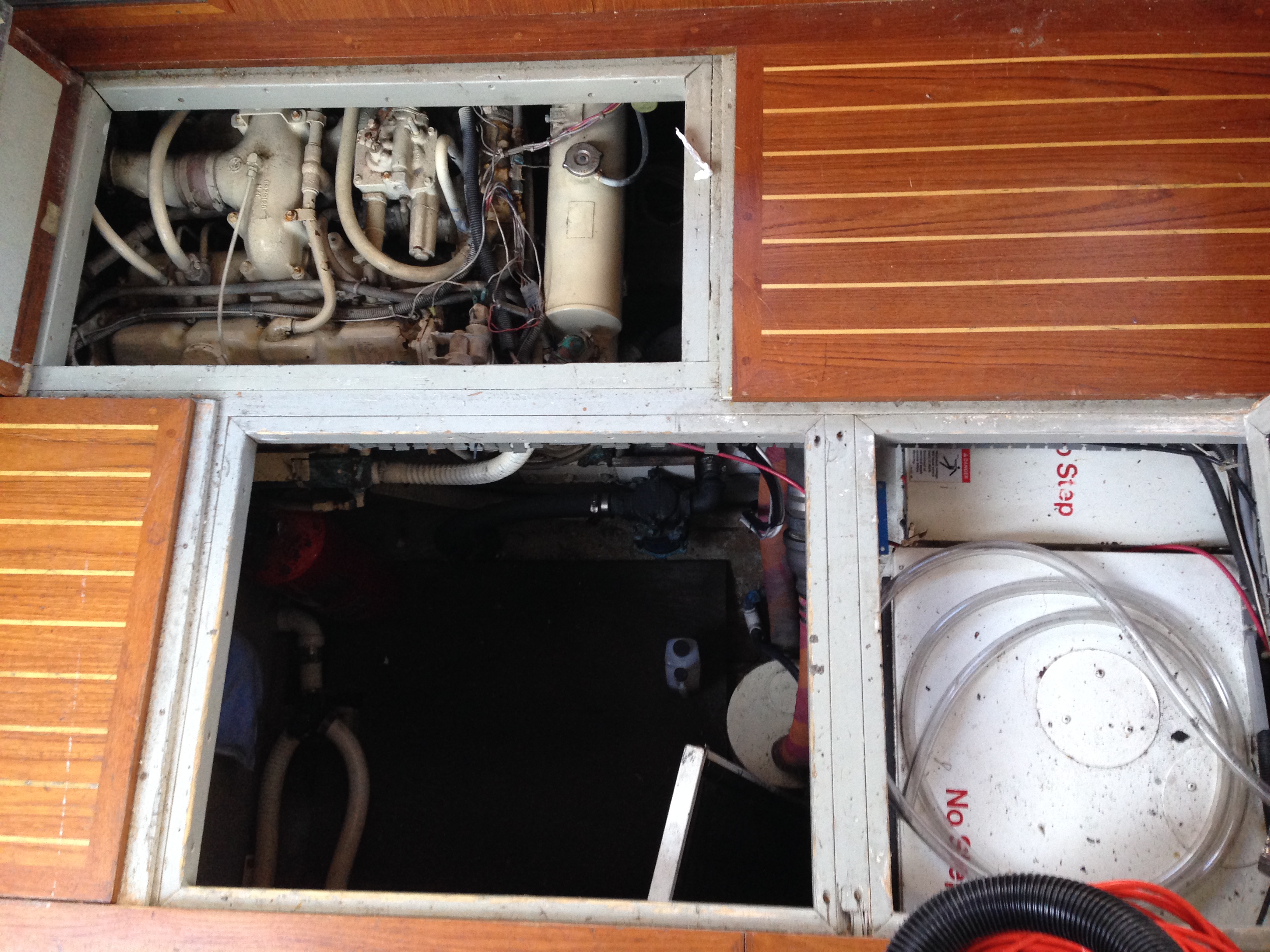

belated photo update! (FINALLY) I need a fisheye lens to take any type of good photos inside, its a bit cramped! As far as boats go this one is roomy though, I have had to literally cuddle an engine before, in order to fit in the compartment one time, to replace a failed transmission cooler. This is roomy as hell in comparison.

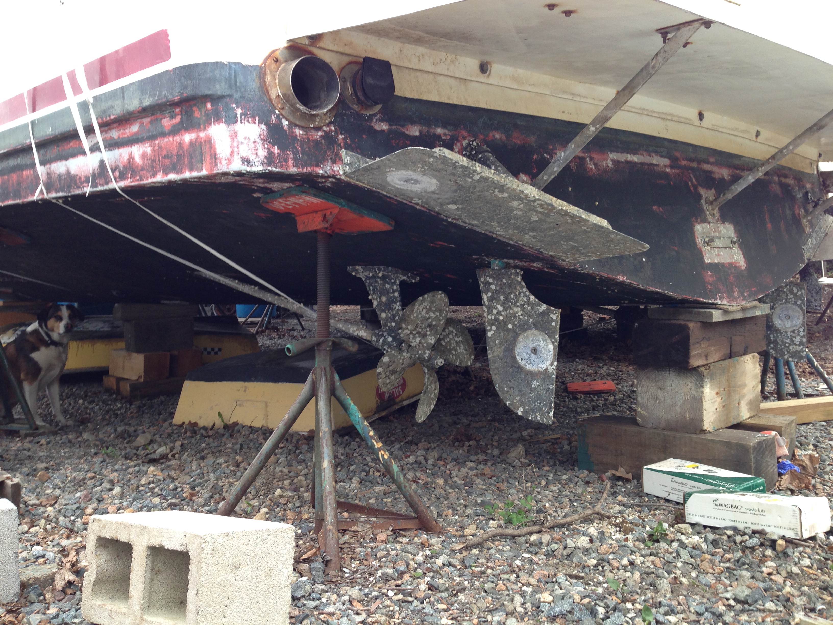

With the weather as gorgeous as it is, working on the boat on dry land has been killing me! I just want to see her floating! Bottom has begun to be sanded, which doesnt look any different than before its sanded :bangshead: and Ive begun allocating small parts for the engines (water pump impellers, filters, etc). most of the through hull fittings are in place and sealed. I've gone through the systems, and most seen to have been in better shape than I thought, for the most part. The bilge pumps are rusted out, somehow... (irony, i believe that's called) and the interior of the boat is completely torn apart to get to everything.
p.s... Spot the Boat Dag!

not much progress lately, but de-scaling every submerged piece of metal for barrier coating before bottom painting. Thinking of leaving the props and rudders as raw bronze, as they're pretty high wear, and it is naturally resistant to corrosion, and antifouling, to a degree. It'll look pretty badass polished up as well! Hoping to get some serious work done to her after Carlisle. next salvo of pics when shes ready to get wet and looking pretty! June is coming fast!

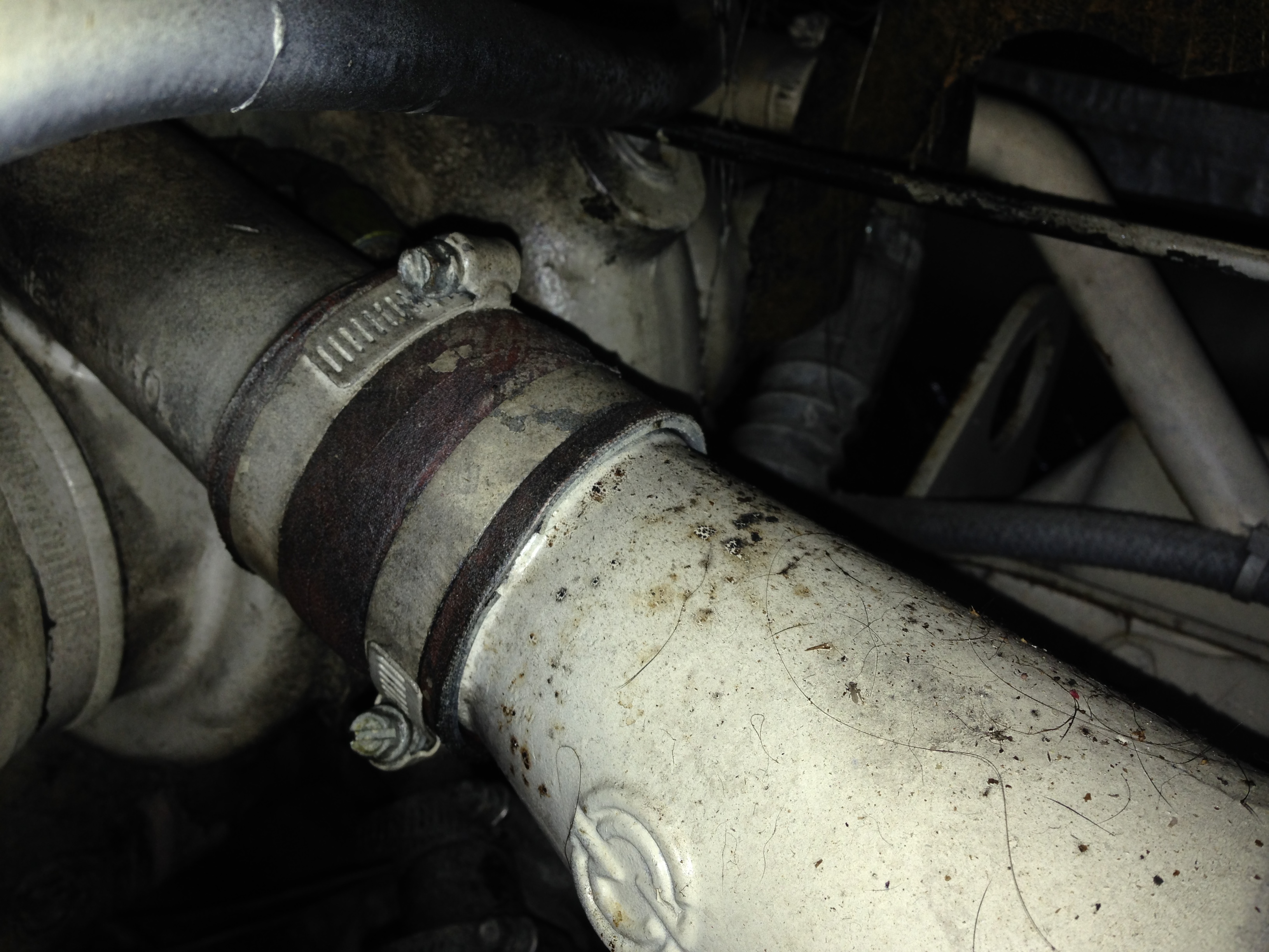

let me tell you, I saw the flexible rubber exhaust hose and thought "oh, I'm in heaven, this will be cake to replace, its flexible!" good lord was I wrong. But it fits now, tight enough that I could probably forego hose clamps as its practically self sealing! (but I will still use 4 t bolt clamps as to not do so is suicidal). Pics to follow. It will also show my battle with the boatyard's propensity to use my storage area as their lay down for whatever trash they dont need until next winter (gotta love the way a fully paying customer gets treated while restoring a formerly abandoned boat, you'd think they'd be a bit more accommodating to someone taking a massive headache off their hands.)
