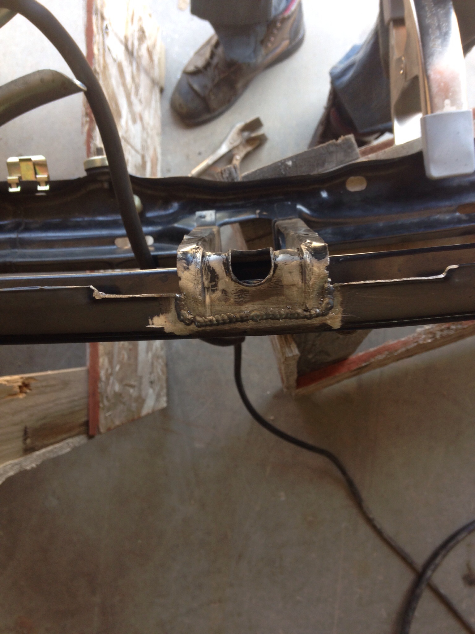

So, the house is in good order with the MIL in town aaaaaaaaaand I snuck back out to the shop for a few hours haha. It's insane how much clearer a guy can think when he's not constantly looking at the clock gauging when to pick the kids up from here or there lol. I've gotten like 3 weeks worth of stuff done in the past 2 days around the house! Time..... Beautiful time! I'd forgotten what it was like lol!
I started today vacuuming out the car a bit. 10 years in storage and the car hosted a couple critters. Mostly nesting material and mouse shit lol. Bye bye. Then moved on to the core support and mounting an intercooler. I just realized I have to run to softball so I'll just post pics of progress so far and I'll write up some more later. If I can walk straight.... :beer: :D
Before
Before
Mangled
Mangled
Drilled out rivets
Drilled out rivets
Had to trim... Eeeeeeek!
Mocked up
Mocked up

That's too bad someone fubar'd the removal. I used a spot weld drill bit on mine and got it off clean. Do what you gotta do. FYI, on my car it was strong enough to hold the biggest radiator with a fan on it that would fit in front of the V8 and never showed a hint of weakness. It will be plenty strong to hold any IC you can stuff up under there guaranteed.

40v4kq wrote:That's too bad someone fubar'd the removal. I used a spot weld drill bit on mine and got it off clean. Do what you gotta do. FYI, on my car it was strong enough to hold the biggest radiator with a fan on it that would fit in front of the V8 and never showed a hint of weakness. It will be plenty strong to hold any IC you can stuff up under there guaranteed.
Yeah, kind of sucks that it got buggered up, considering the condition of the rest of the car. Oh well, Audi was fucking stupid anyhow with that whole setup lol. Next chassis up and the core support is removable... Go figure! :bangshead:
Glad to hear there is some strength left in there. I'm thinking it'll be just fine too. The intercooler will more than likely be mounted to the frame rails, issue that I'm thinking or concerned about is the strength of the hood latch. Meh, deal with it tomorrow. It'll be just fine haha! Cheers! :beer:

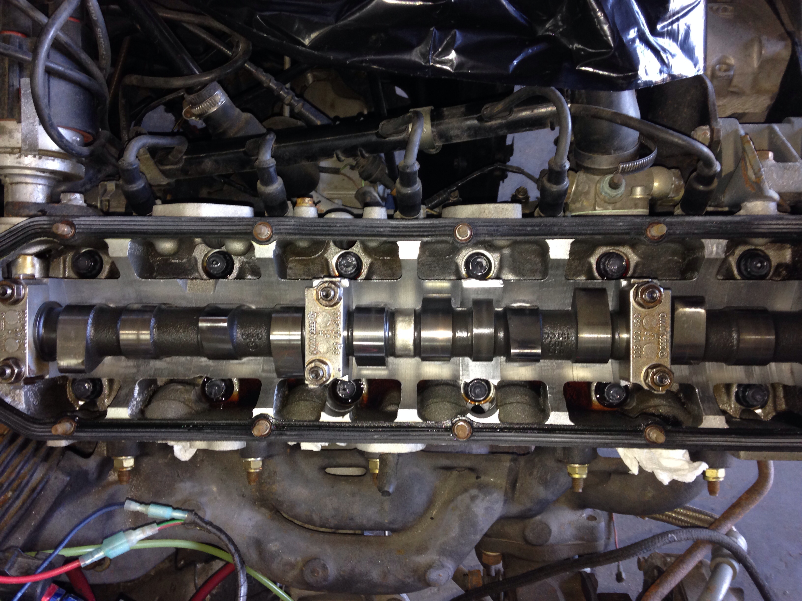

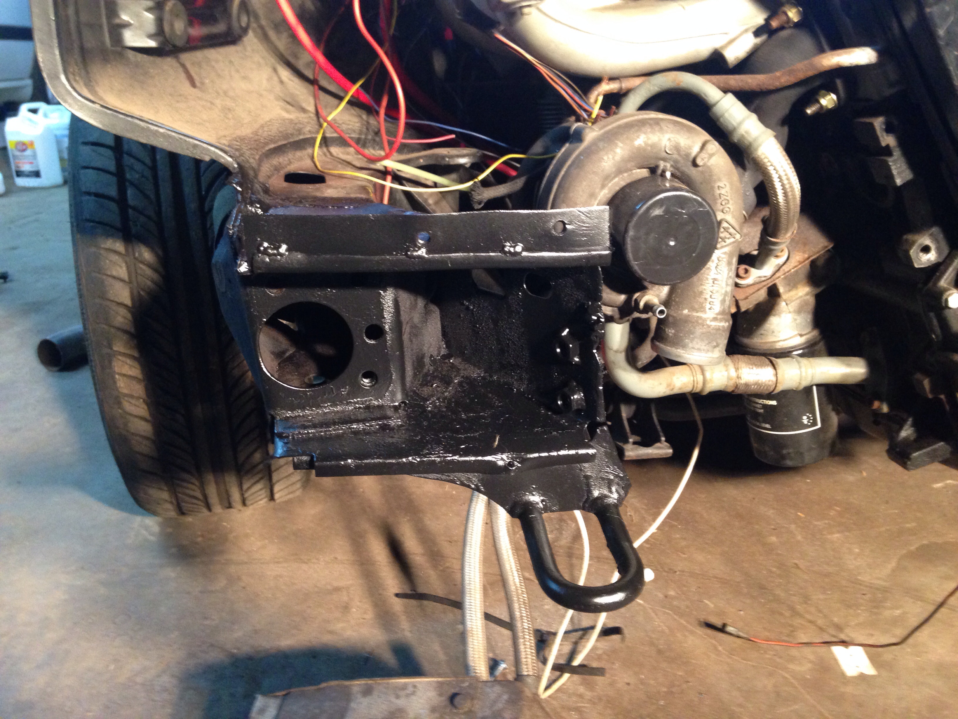

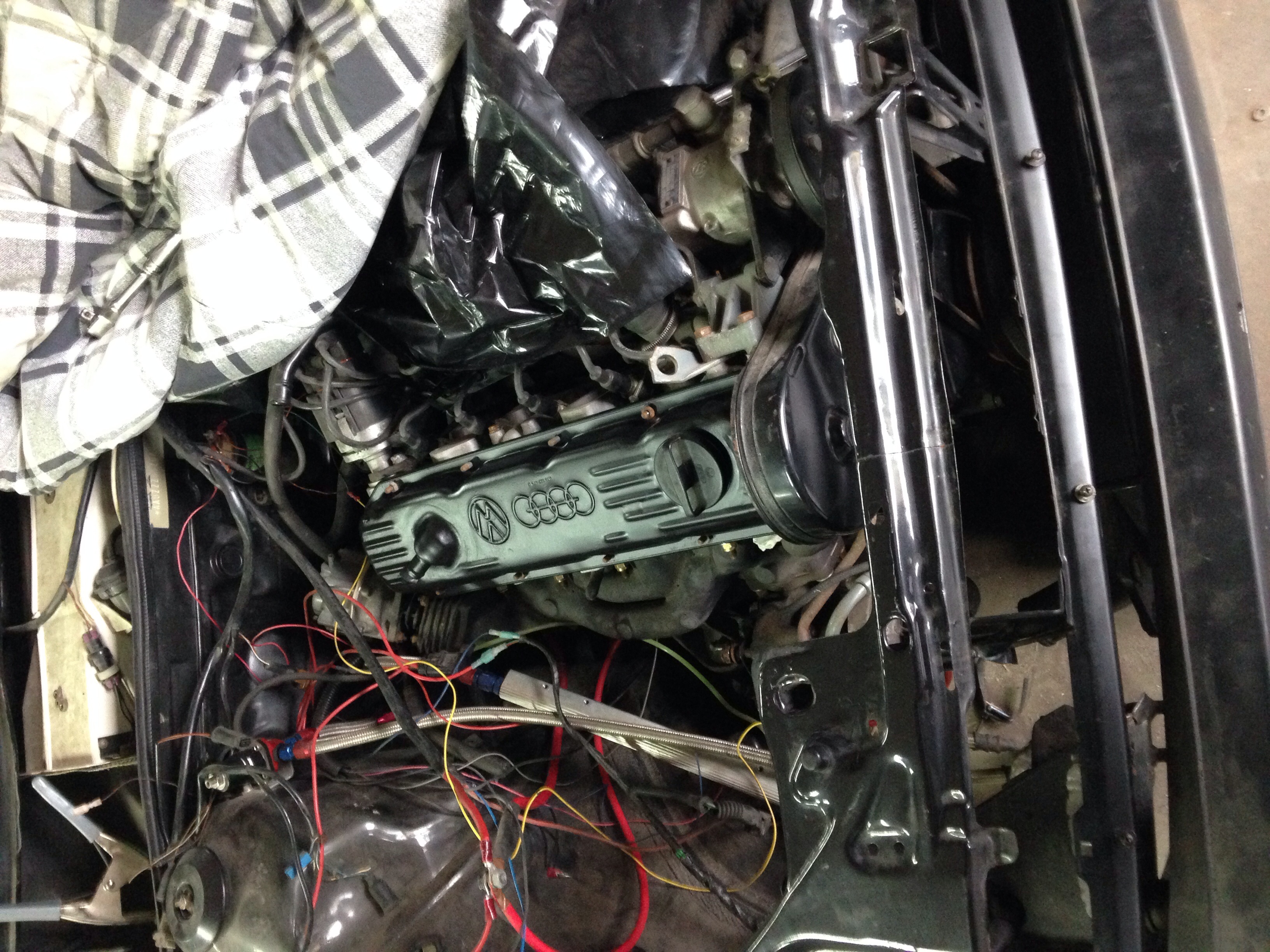

Got all that I wanted done in the last two days! Ran all my errands, family got taken care of and I got the car to a great stopping point. Only bugger was I was planning riding today to shake my bike down but it's been pouring the past 36hours. Muds no fun to set a bike up in:(.
Oh well ! Got another day of working on this thing. Yesterday I finished up the core support, trimmed the bumper a little bit, cleaned up the frame rail mess and built "quick and dirty " Mounts for the intercooler. No access to a bandsaw at the moment so they didn't get trimmed and finished. Solid as hell though! Should be sweet, 2 silicone connectors and 1 straight piece of tubing will be the plumbing. Waiting on connectors and a Michelin man hose along with my intake spacer and some gaskets.
Today I painted everything and did final assembly. Also pulled the valve cover for some paint and holy shit cleeeeean!!!! Noticed ARP headstuds too, still with lube on em ha! I noticed the motor mounts were a little sloppy so in between coats of paint, I threw in a pair of 034 track density mounts that I had from the race car when I switched to Mustang Mounts. The grill and headlights were just for mockup. Looks gooooooooooood!!
Pictures!
Rolled the center support.  Added a little rigidity.
Core support brackets
Finished core support brackets
Cleeeeean!
Cleeeeean!
Painted valve cover
Painted valve cover
