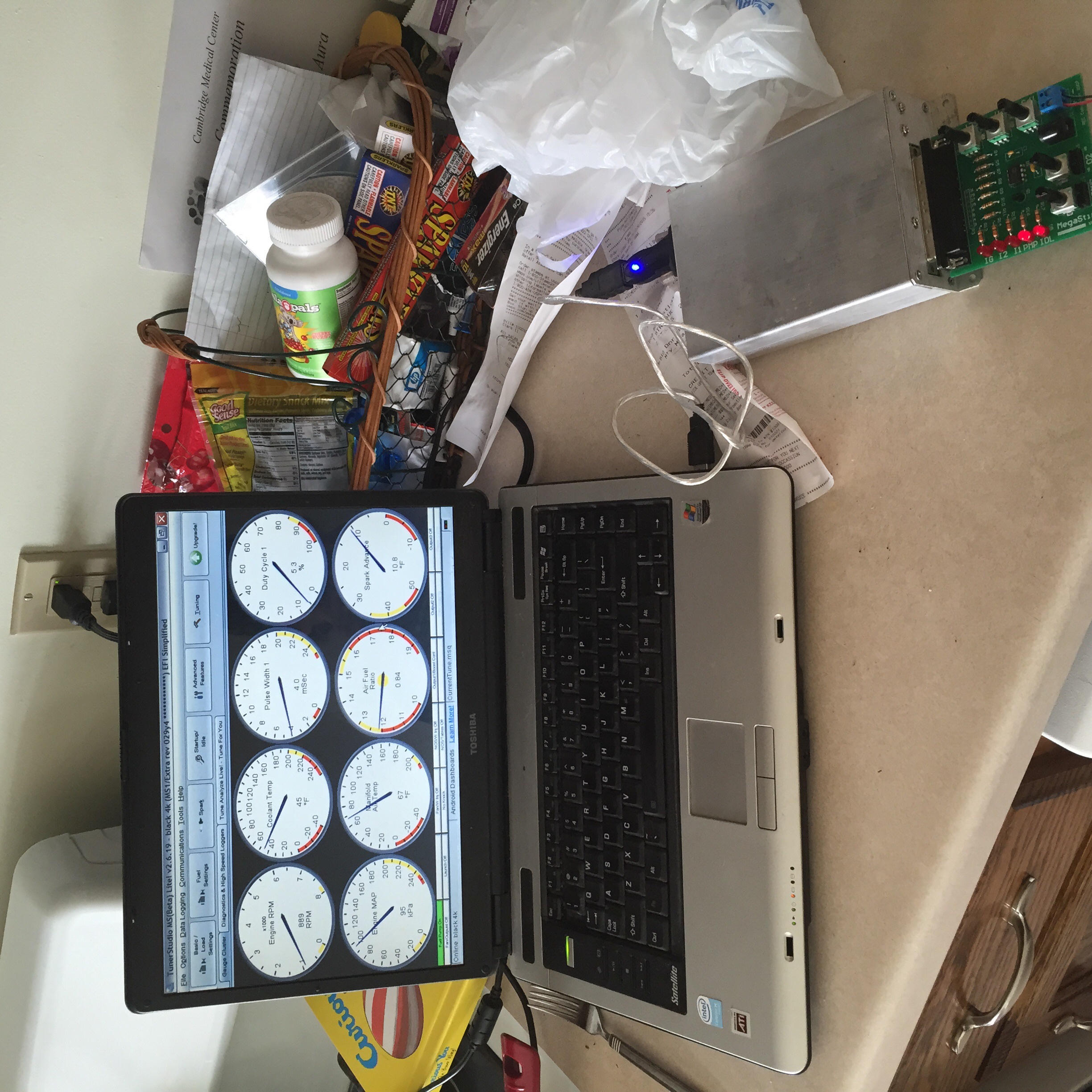

As always Eric, chiming in with great insight! The way I am seeing it, for my own personal situation is either run off the dizzy or go full blown sequential with COP. There's really no middle ground being the upgrade in ecu and work involved to change triggers lol.
Westco4k- I completely agree, again! Lol. I'm completely fine with a low powered and inconsistent 20vt 4000 for now. Like I mentioned earlier, this car fell in my lap a few months ago and I'm putting together pieces that someone started literally 10 years ago. There are tons of things that need attending to on this car and for now, the EFI is going to have to be a finicky and simple bitch lol. I've got this car and my rally car that need to be in a "driveable" state come spring so I can at least drive them on to a trailer to move halfway across the country lol. Spending a grand to completely upgrade management is absolutely out of the question, especially since I'm already not far away from being convinced to swap in the AAN from my rally car ha!
On a different note, Elaw is awesome and my ECU showed up today, which is looking faaaaaaaantastic! Thanks Elaw!!

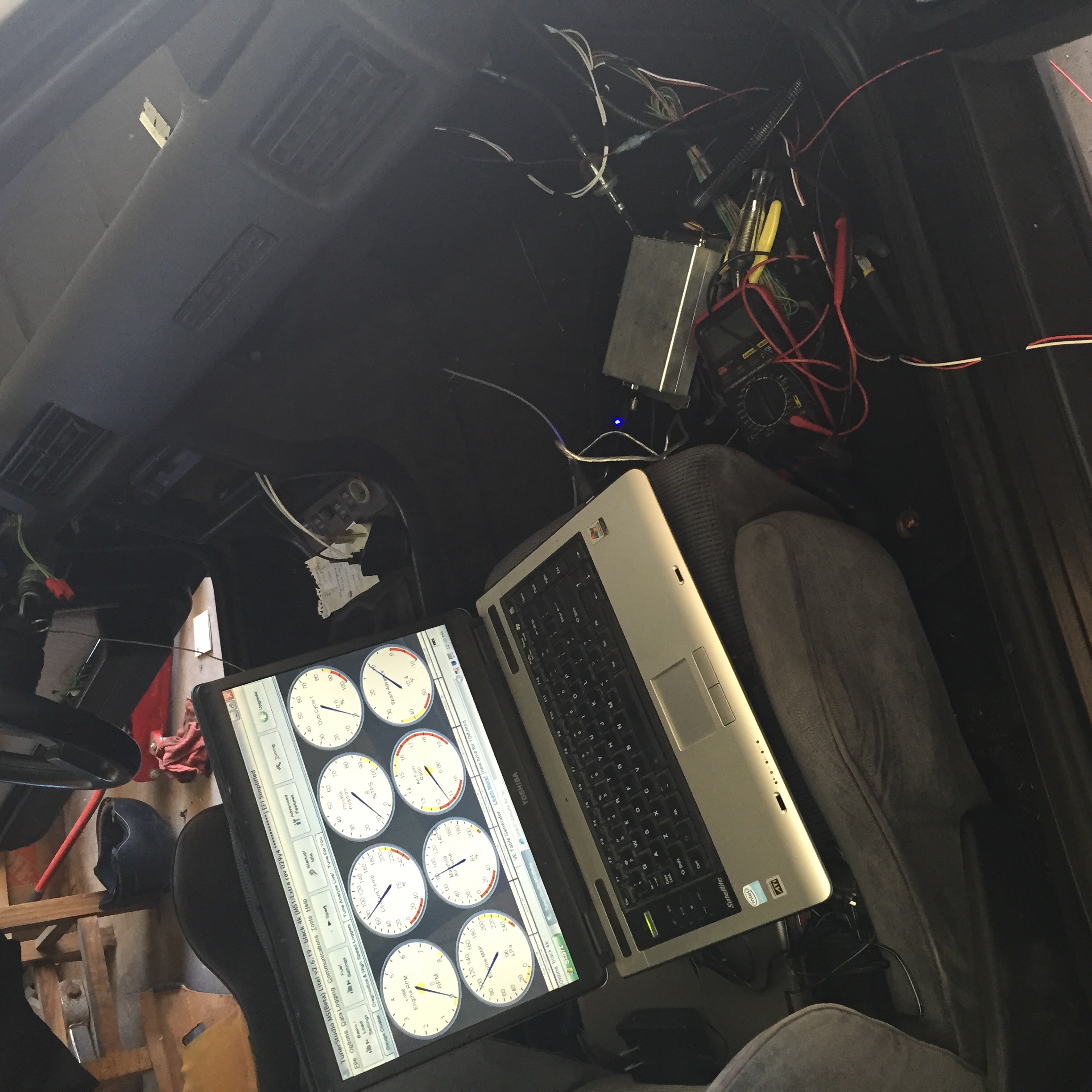

Sooooo.... This happened today!
She's online! The power connections inside the car are just roughly attached and I'll go back through and finish up after I get it started and idling. Everything seems to be working just fine. Went through and tested everything that gets power and they're good. Pretty sure the fuel tank is BONE dry haha. I'm hoping the pumps not gummed from sitting for a decade. I had to chase around a little bit with the fuel pump relay but got the pump to kick on like it should. I still need to wire in the wideband, change the oil, put fuel in and add coolant, BUT I'm going to try and start it on Thursday! Woohoo!
I tend to have the "while I'm there" mentality to bigger upgrades westco4k lol. With my math for a new ms3x, harness and associated supplies(pins, terminals, connectors, etc), LS coils, and 60-2, me myself would def have a grand into it. Plus a bigger turbo but that's neither here nor there lol. I'm sure I could do it for less especially after selling this old setup off but I like to start completely fresh with wiring. For me it's actually a time saver vs picking through all my old shit. Aannyhow, how's your car coming along? I still need to read through your whole thread. I read through part of it the other day at work but didn't get to finish it. Cheers!

deaner wrote:Pretty sure the fuel tank is BONE dry haha. I'm hoping the pumps not gummed from sitting for a decade. I had to chase around a little bit with the fuel pump relay but got the pump to kick on like it should.
Pumps drying out is definitely a thing... can you actually hear it running when you turn on the ignition? If so, you lucked out!
Either way, I'd put some gas in it ASAP, even if you don't plan to start it for a couple of days.
Eric Law
Eric Law
Re: Any Megasquirt vets on here?
elaw wrote:deaner wrote:Pretty sure the fuel tank is BONE dry haha. I'm hoping the pumps not gummed from sitting for a decade. I had to chase around a little bit with the fuel pump relay but got the pump to kick on like it should.
Wwwwwwwell I can't really hear it run, I can feel it though lol. I couldn't remember how loud the stock pumps were. I plan on throwing some fuel in tonight when the wife relieves me from kid duty.
If the pumps bad, I've got a good one in the race car I can rob for the time being. That way I can at least pressurize the system and fix leaks tonight as well.
So it turns out the pump was bad. Yanked the one out of my rally car and it tested good so I threw it in. Keyed it up and fuel pressure went through the roof! Backed the FPR out darn near all the way and it still will climb to over 100lbs if I don't key it off. Uuggghhh....
Edit/update: looks like my return line is plugged off. Pumped it full of air and none made it into the tank. Pulled the rubber hose and pumped it up again. Notta. And here I thought I was gonna get lucky with a stuck regulator haha.
