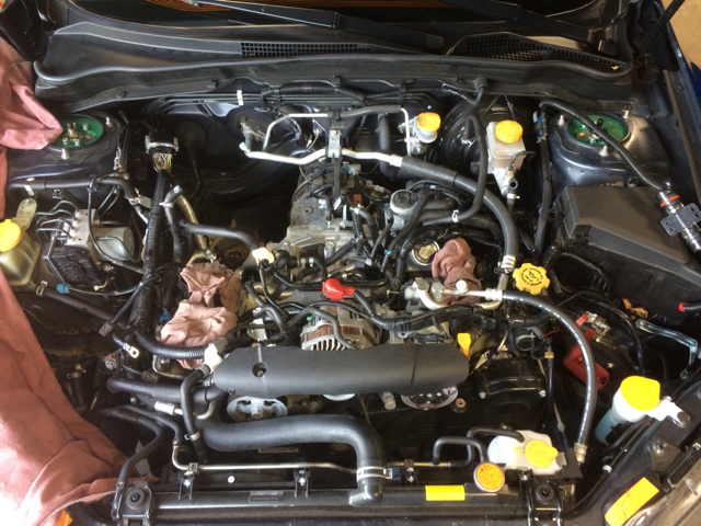

'12 STI getting turbo upgrade, fuel system, FMIC, and other goodies... Done pic to come.

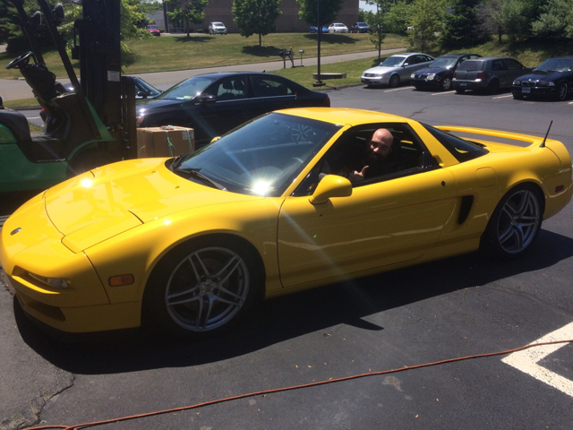

Not bad for a Honda.

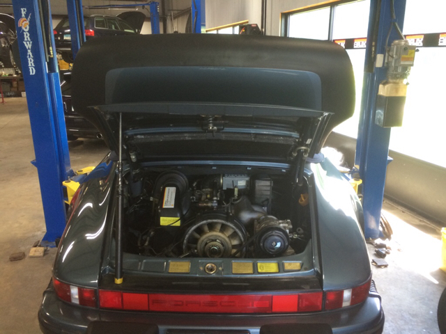

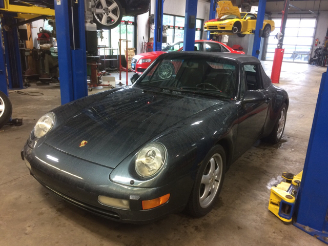

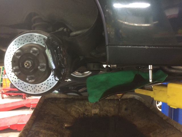

Some air cooled maintenance.

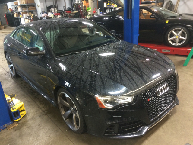

RS5

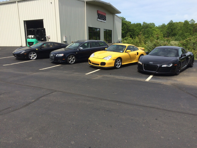

Quite the variety!
Just going by initial impressions, which car has struck you as the most "special" of the lot so far?

Heh, you have the same cherrypicker and trans jack that we do.
Also - you mean to tell me that those flexible drain funnel things are actually worth a crap?

Oh man that's tough. The RS7 is the most brutally fast, the Ferrari is the most "when you think exotic..." But I've always had a soft spot for air cooleds, I've kinda become "the guy" for them at work. Last one I inspected and did a compression test. 35k mile '87 with original plugs and air/fuel filters. As time goes by I will own an S7 and either an early 911 or 914 even.

Yeah those are relics. We have a sick new Bosch tranny jack on the way too. We also have a nice lift table for doing 4.2 S4 chains.
I've only ever used the flex funnel to keep fluids off subframes and such, for that it's great.

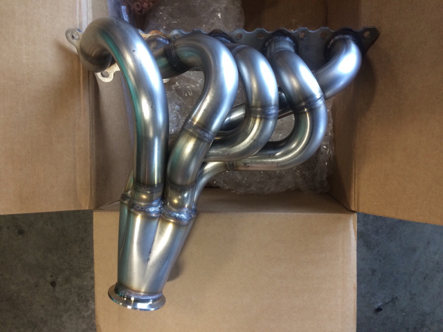

Put a Evolution header on a 2.5 Jetta that already has an IE intake setup. I already love how it sounds... Header and AWE exhaust will make it amazing. The header is ok quality but fitment wasn't great at the downpipe to exhaust or under the kombi valve hard pipe that goes to the head.
Speaking of, the sai system seems useless on this car, the air ports at below the exhaust ports but they are blocked by the gasket, weird.
Anyway, pic.

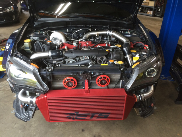

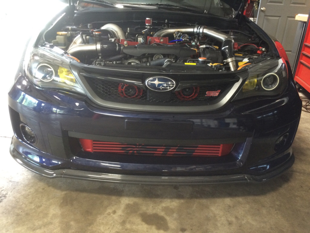

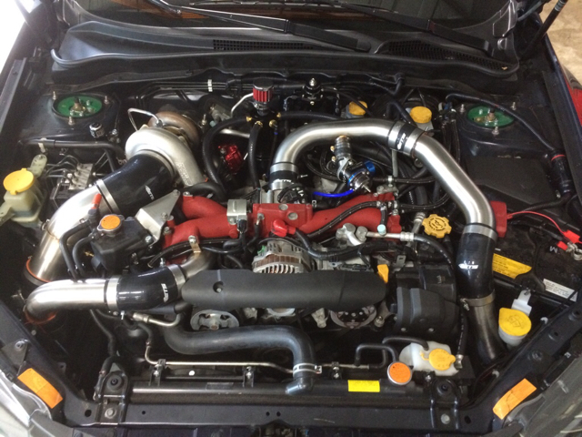

Finished this up yesterday, waiting on a base tune. It's probably going to blow up because it's a Subaru.

Done.
Gotta level the horns...

What exhaust manifold is that on the Subaru? I've never seen one with the turbo that high up before. And interesting plumbing routing, took me a moment to realize why there was still a pipe under the intake.
EVERYTHING blows up. It's just a matter of time. Ya do everything you can to ensure it won't blow up, of course, but every candle burns out sooner or later, and performance stuff is more like a firecracker than a candle :)

It's this kit: http://www.extremeturbosystems.com/ETS- ... o-Kit.html
I think it's a 6262 or 6266 I forget. Fairly standard "rotated turbo" setup.

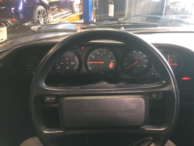

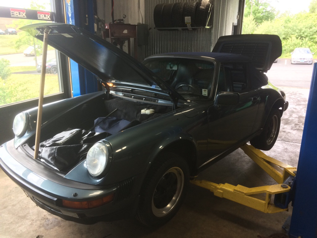

Had another air cooled in for a PPI and compression test. 34k miles... Original air filter and spark plugs! From 1987!

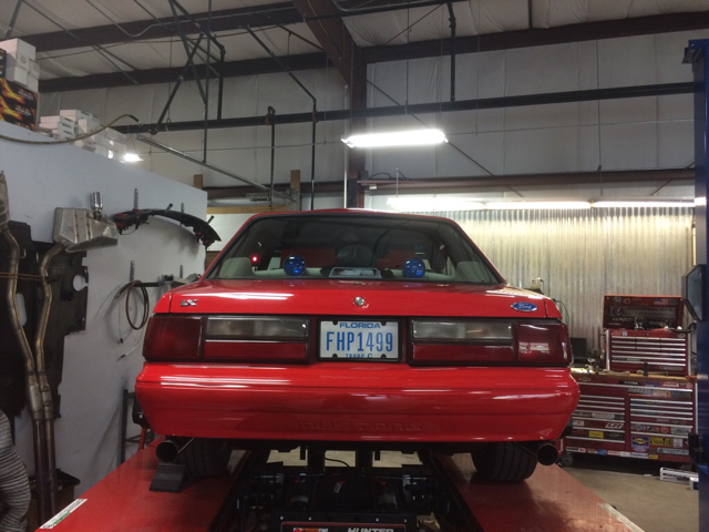

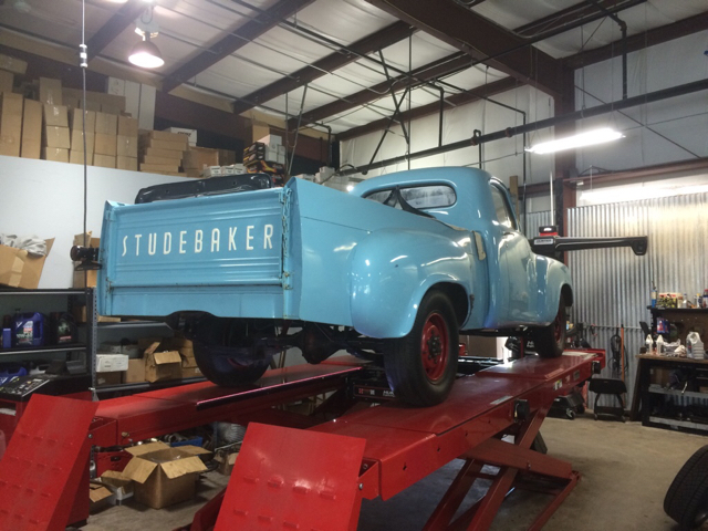

Got to align this gem too...

You have the same lifts we have, too. Or, at least, I can't make out the name, it doesn't look like Ben Pearson, but the design of the arms and everything is the same.
Bizarro-world :)

Ours are Forward lifts iirc.
