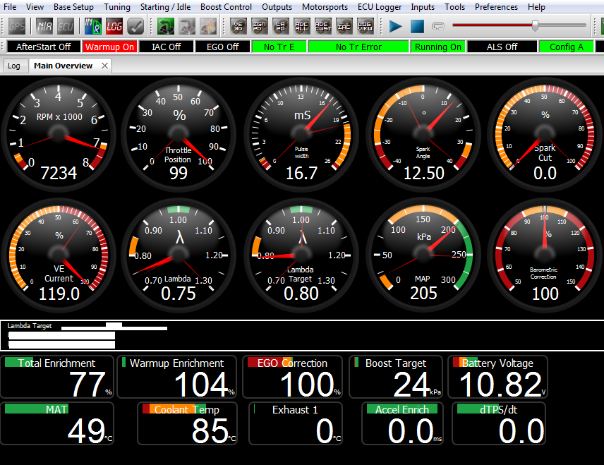

i posted my VEMS log in my other post by accident last night, whoops! it was late and i was tired. anyhow, here's the VEMS log from my very last pull on my test pad yestersday. this an easy first gear and than load it up in 2nd and pull to the rev limiter.

Voltage too low + Trigger errors.
vwnut8392
Posts: 340
Location: PA
Re: finally got to run my 4kQ at the drag strip
Post by vwnut8392 »
carl wrote:Voltage too low + Trigger errors.
i dont see where your seeing trigger errors in the log. i have no idea what is up with the voltage, it has a brand new alternator and battery in it now.

Yea , my bad opened up wrong file :hammer: lol (v3.3_u009465-2015.06.22-02.30.24) guess windows nudged the file at the end being a new file and having the folder open or something.
Checked out the new log, no trigger errors, seems ok, like you say voltage still weird.
If you have one, what do your standard car gauge say, same deal? Maybe strap is jumping off the pulley from a wobble or too loose or something.
Can't say much otherwise, spool up seems a tad slow depending on what turbo you're running, interesting use of the mat retard table.
