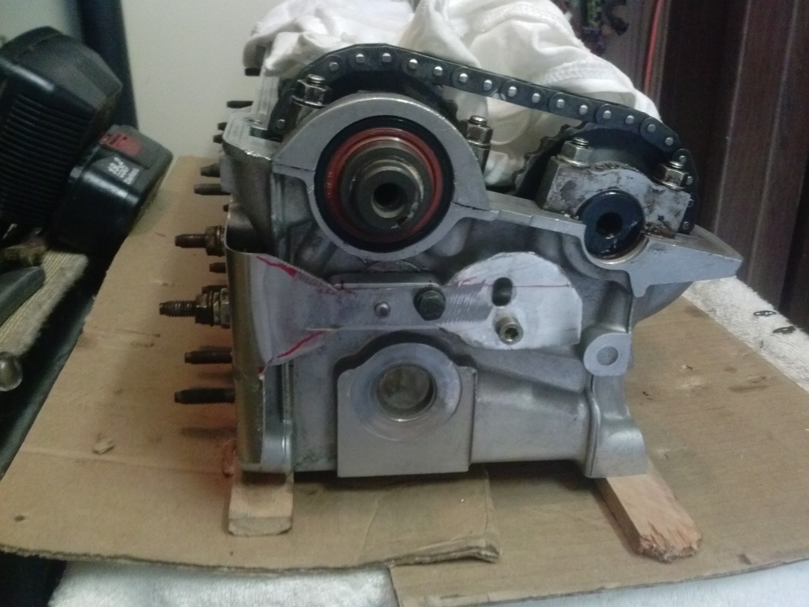

block: you want serpentine belt or v-belt?
3b water manifold is needed, either way.
head: pick by the condition, cps is easy, i made a template:
