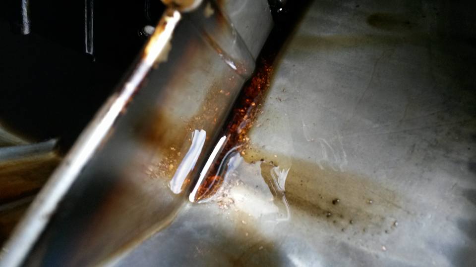

hank iroz seems to thing its me playing the launch control that killed it. when i got the bottom end from marc i pulled the pan and had a peek but i didnt pull any caps or anything because i figured if marc said it was good i'll take his word for it. i feel i can always trust what marc says and im not mad at all about it, shit happens and it was probably my fault. also i figured if its good as marc said there's no point in disturbing the factory torqued bolts and such so i'll just leave it alone. here's 2 pictures of my findings. cylinder 1 was the problematic cylinder. i caught it in enough time that it did not damage the crank. there is a little tiny bit of bearing material on the cylinder 1 journal but i think some emery cloth and gently sanding it off with some oil to kind of wet sand it will get it back in shape. that old trick worked for my pap years ago when fixing old farm tractors that spun bearings and i did it once before in my 4000 and it worked so i'll give it another go.
i managed to get a new bearing set from summit racing for 36.00. their clevite brand which is a sister company to mahle so i would assume their a good quality bearing. i got them from summit cuz their right across the border in ohio so regular ground shipping is like over night to me. thats a little bit of winning i guess.
- rod bearings.
- 10665762_10153022347086771_7192605113271668688_n.jpg (10.32 KiB) Viewed 32230 times
- bearing shavings in the pan.
- 11947516_10153022237016771_6876694926482730591_n.jpg (39.8 KiB) Viewed 32230 times
