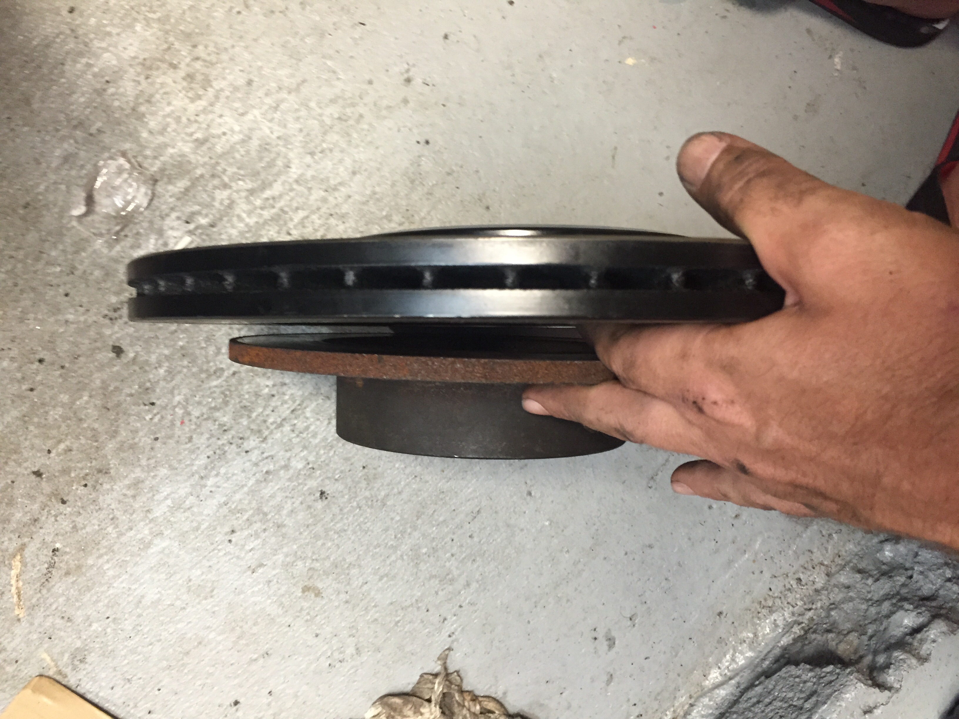

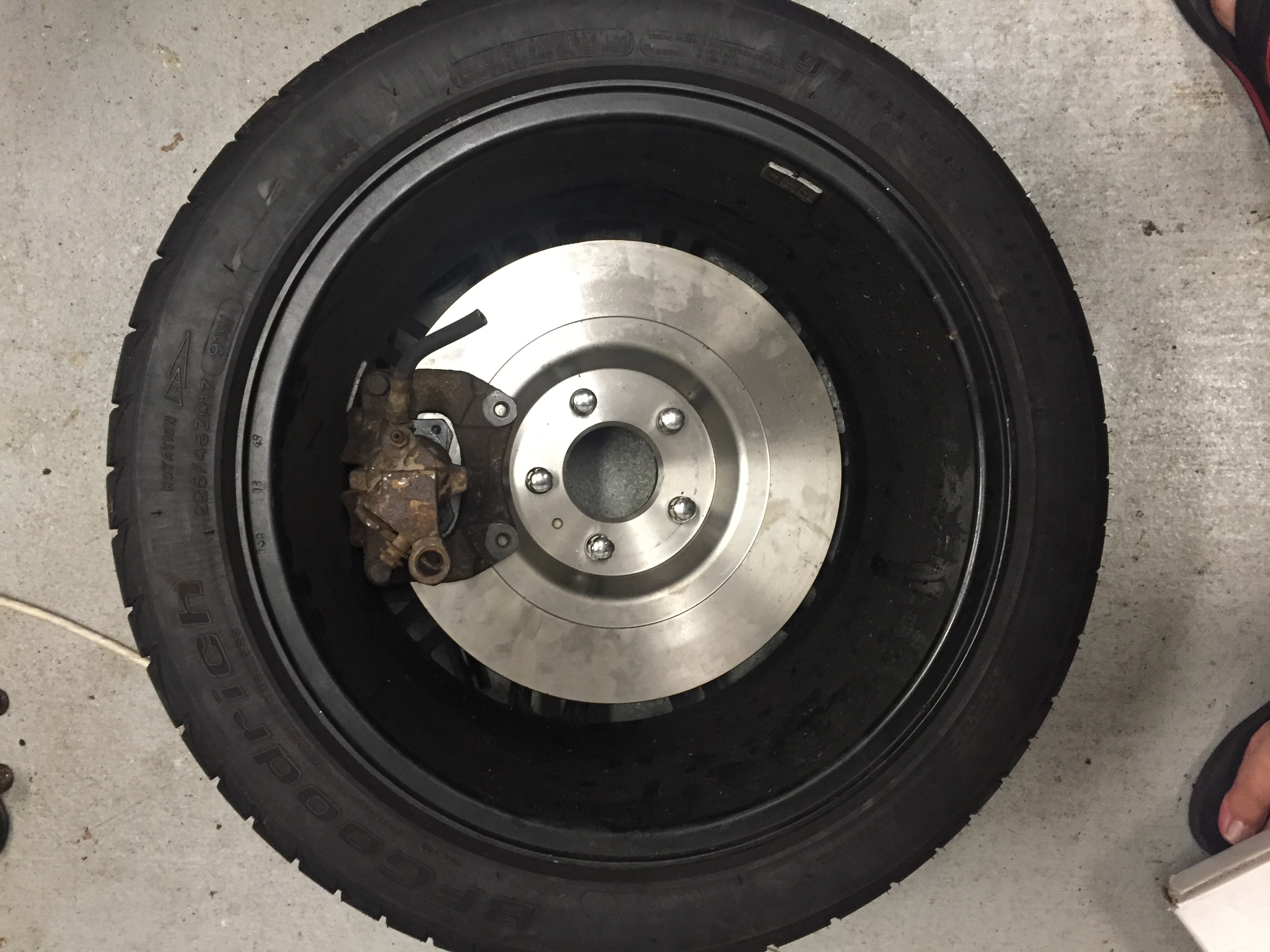

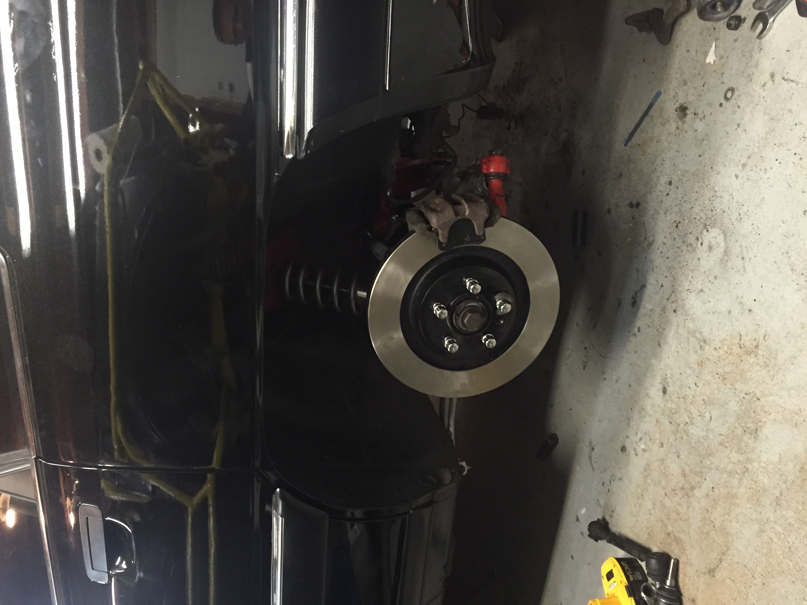

Here is what I did... 330x22mm rotors. Factory 200 20V/ V8 rear calipers and making the adapter plates.
Rotors are $42.00
Rotors are $42.00
- image.jpg (1.11 MiB) Viewed 66818 times
- image.jpg (1.22 MiB) Viewed 66818 times
- image.jpg (1.36 MiB) Viewed 66818 times

Are those rotors vented?
Re: Type 44 big brake ideas? (Rear)
I now realize that was a stupid question, but I wasn't sure if the stock caliper for the non vented rotor would work with a vented rotor, and from those angles they didn't look vented.
Wow that's a lot of rotor, well done! At that point I doubt it would matter vented or not, that's a lot of surface area to dissipate relatively not that much heat. I mean I'm sure there would be a difference technically but with a good set of pads I bet you would never notice. I've been following along, well done on all fronts

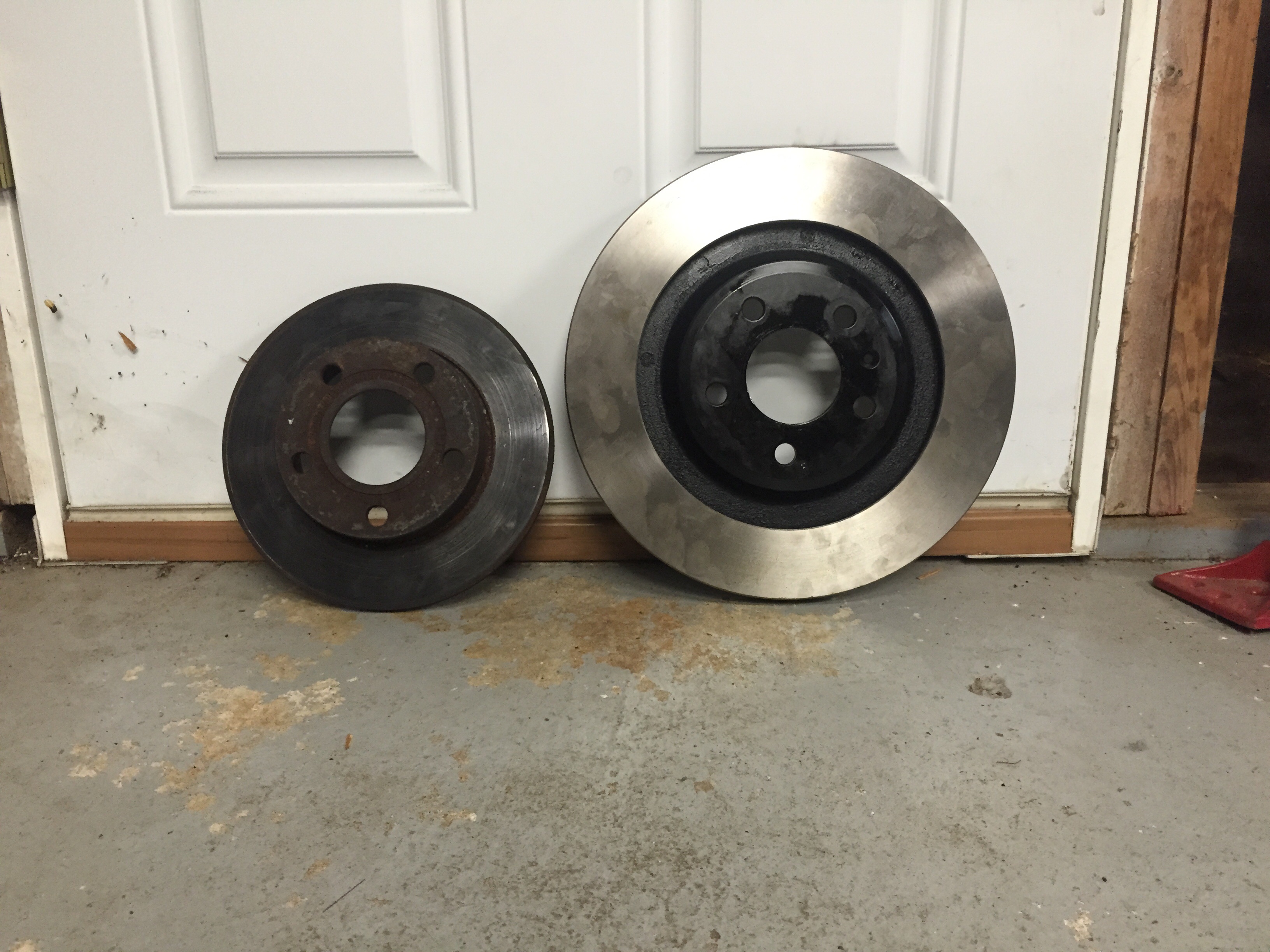

They are vented...
- image.jpg (1.52 MiB) Viewed 66782 times

I circled the rotor that worked best. I got them from Orielys. I tried several models of the 330mm but most were having the wrong offset and would only allow to make too thin of an adapter plate for the caliper The model works pretty good and allows the bracket to be just under 1/2" thick.
- image.jpg (2.21 MiB) Viewed 66756 times

I am in the process of getting several sets made. I will start off making 5 sets only unless more interest is generated. The machine shop doesn't want to mess with anything less. I have dropped off my template, knuckle/hub, rotor, caliper and carrier bracket for them to get started. 17" wheels or larger are required. 1mm on each side of a new 22mm thick rotor will need to be turned down to 20mm at local parts store or machine shop. The new required rotor is roughly $40 each. I paid $42 each. This set up/top hat offset allows for a decent size/thick plate for strength (roughly 7/16" thick. It is a flat, single piece, dog bone shape. The 330mm rotor kicks the caliper carrier bracket out far enough where the bolt has plenty of clearance to get a socket on it to tighten it already assembled. I should be able to sell these for $100/shipped for the pair, throw in $85 to buy your own rotors, and about $20 to turn your rotors 1mm on each side and you have got one bad ass HUGE rear brake upgrade utilizing your factory caliper and keeping the parking brake. You also don't have to worry about your brake master cylinder trying fill large volume calipers not matching the brake system. You are gainingthe leverage point and adding more rotor to soak up/dissipate heat. So roughly $205.00, you can get a massive upgrade on the cheap. You can buy better rotors stepping up to slotted/drilled/two piece/etc if you want to spend the extra money.
Here are the applications that I have verified so far... Basically, the S6/S4/V8/200 20v/Avant/5000 share the same rear caliper and carrier brackets. Feel free to add info... Reply if you want a set and help me get a couple of sets spoken for so I don't have to eat the cost of making 5 sets when I only need one.
