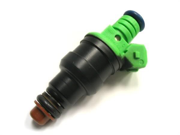

What you need is a set of low profile injectors from a Volvo like I have. They lower the rail considerably, and as an added bonus they are an extended tip injector, so it puts it closer to the CIS injector tip location.

DE80q wrote:What you need is a set of low profile injectors from a Volvo like I have. They lower the rail considerably, and as an added bonus they are an extended tip injector, so it puts it closer to the CIS injector tip location.
Can you post a pic? I'm fairly certain these are what I have in there now.

The newer ev14 injectors are great for that too. Nice and short and have the extended tip.
Re: Fix it or tune around?
Posted: Thu Nov 05, 2015 9:16 pm
Here is the pic of mine.
They are from a Volvo 1.9L turbo engine.

DE80q wrote:Here is the pic of mine.
What size are they?

Posted: Sun Nov 29, 2015 3:20 pm
They are 440cc @ 3bar
