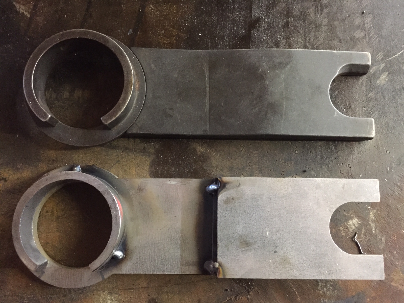

we have a replica coming out soon for the NLA 2084 tool. you need to use a 7a style snub bracket (which bolts up easy on the AAN) but it works great. pricing around $100. they are off at powdercoat. this pic is just tack welded:

Very nice Marc!
