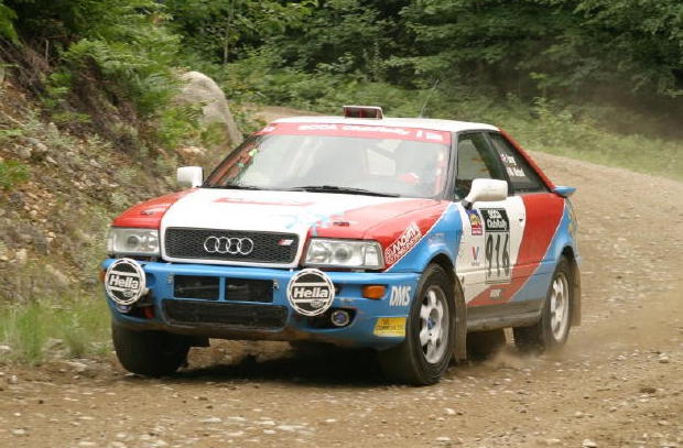

Hey everyone,
Here is my 1990 Audi Coupe Quattro (pretty much an S2!). It has a lot of history. Was built in 1998/1999 by George Plsek and campaigned by him until 2001 when Leon Styles took it over. Felix Tang and another owned it since I purchased it. All owners have been responsive and nice to deal with, especially George. In the early days Alex Gelsomino co-drove it for George. Pretty awesome. No expense was spared with the construction of this car. I’ve been told it was acid dipped several times. I am very fortunate to have picked up this car and am excited about the future with it. My good friend drove the car at Sandblast this year and it did well. I hope to do BRS in NY this October.

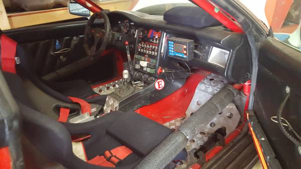

Good pictures. what's the brake set up like? looks like no booster?

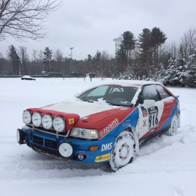

New livery!

dalspaugh wrote:Good pictures. what's the brake set up like? looks like no booster?
Correct. AP Racing 2 piece all around. Hydro ebrake. Need to rebuild the rear calipers before ESPR.

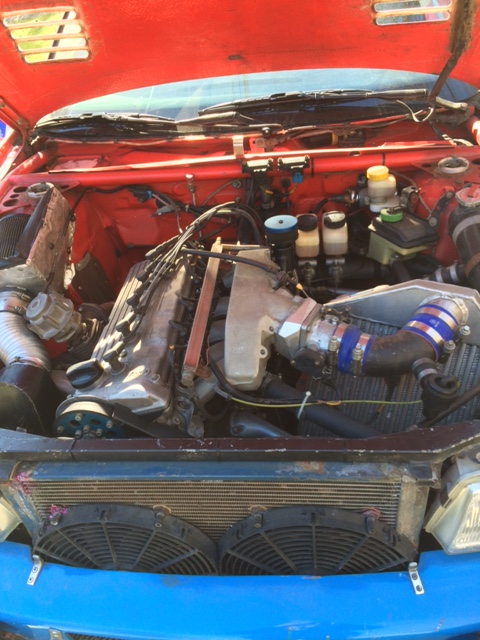

Afterthought wrote:Awesome pics.
You have any engine bay shots with the EFR in there?
Yep! See below. Random photo dump. Old school laptop tuning the Motec M48 for pump gas, new seats, blow shocks, rebuilt shocks, inlet restrictor 3D printed, sugary TIG welds,
