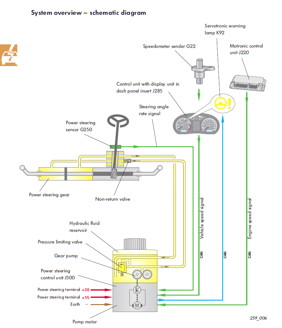

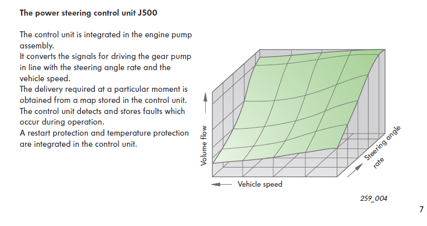

i had a little time so i did some research on this volvo pump/steering aka: EHPAS (Electro Hydraulic Power Assisted Steering)
luckily no extra control module needed, because its integrated on the unit itself, and it want to talk on the CAN bus system.....
it might work without the CAN bus but im sure its function will be limited
Increase assist - message for fast steering wheel movement from the steering wheel angle sensor
Decrease assist - high vehicle speed message from the BCM
also, Maximum assist pressure is 120 bar, a bit too mush for small chassis cars, around 100bar
do you have any other info? did you test yours yet?
Thank you!

The pump operates without CAN signals, albeit at one speed where drawn amperage is dependent on steering load (5-60A). Other pumps have drawbacks similar to this, with the exception being the second generation MR2 pump that has a regular vehicle speed sensor input. The drawback there is that they're popular and therefore expensive.
Working on the brackets now. Yeah, the unit "works," but I've only powered it on without lines/fluid/load. Need more time and better fabricating skills.
Re: Samuel's 20vt 4000
Posted: Tue Apr 12, 2016 8:27 am
by varia
I understand it works as a basic pump, but we will miss a lot without the signals

varia wrote:I understand it works as a basic pump, but we will miss a lot without the signals
That's correct - we will be missing out on the noise reducing and energy saving features without CAN signals. The pump runs at 100% without these inputs.
There is a good post from the electric car forums:
Re: Volvo electro hydraulic power steering wrote:Hi I have completed all of the hydraulic modifications of the pump to fit my donor vehicle. Alfa 156. I am running the pump in "backup mode" and the steering feels great. No canbus integration. It starts up at full power, and then slowly rev's down to what might be about 70-80% power. With no load on the steering it draws only 6 amps, and when I turn the steering wheel, with the car stationery, it draws about 20-25 amps. Only when the steering gets to full lock and you keep pressure on the steering wheel, you can hear the motor revs drop as there is probably no circulation of fluid does the pump draw 70-75amps of current.
So for now I am quite happy with its performance. I haven't driven faster than 40km/h so I don't know what the steering will feel like at highway speed. I am busy building battery boxes, so will do a faster road test soon. If the steering feels good I will leave it with no can bus. The Alfa's original pump ran off a pulley so would have had no electronic control over how fast the steering wheel is being turned, or the vehicle speed. You could be driving slow at high revs, or fast at low revs.
