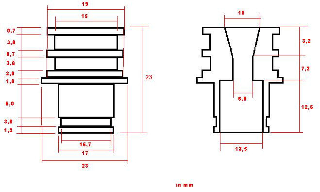

Posted: Mon Apr 25, 2016 9:08 pm
by dalspaugh
Re: Replacement O-rings for 034 Injectors?
Posted: Mon Apr 25, 2016 10:15 pm
by varia
Multipurpose O-Ring, Oil-Resistant Buna-N, 3mm Wide, 14mm ID
http://www.mcmaster.com/mv1460752213/#9262K271
Posted: Wed Apr 27, 2016 10:20 am
by varia
what i posted is for the 034 adapters.

by dalspaugh
0ooo, gotcha!
thanks for this little pseudo-drawing of the adapters! For the o-rings from the adapter to the fuel rail, I just ordered those straight from 034, fitment is nice and they were cheap (since I was ordering other stuff too...)
