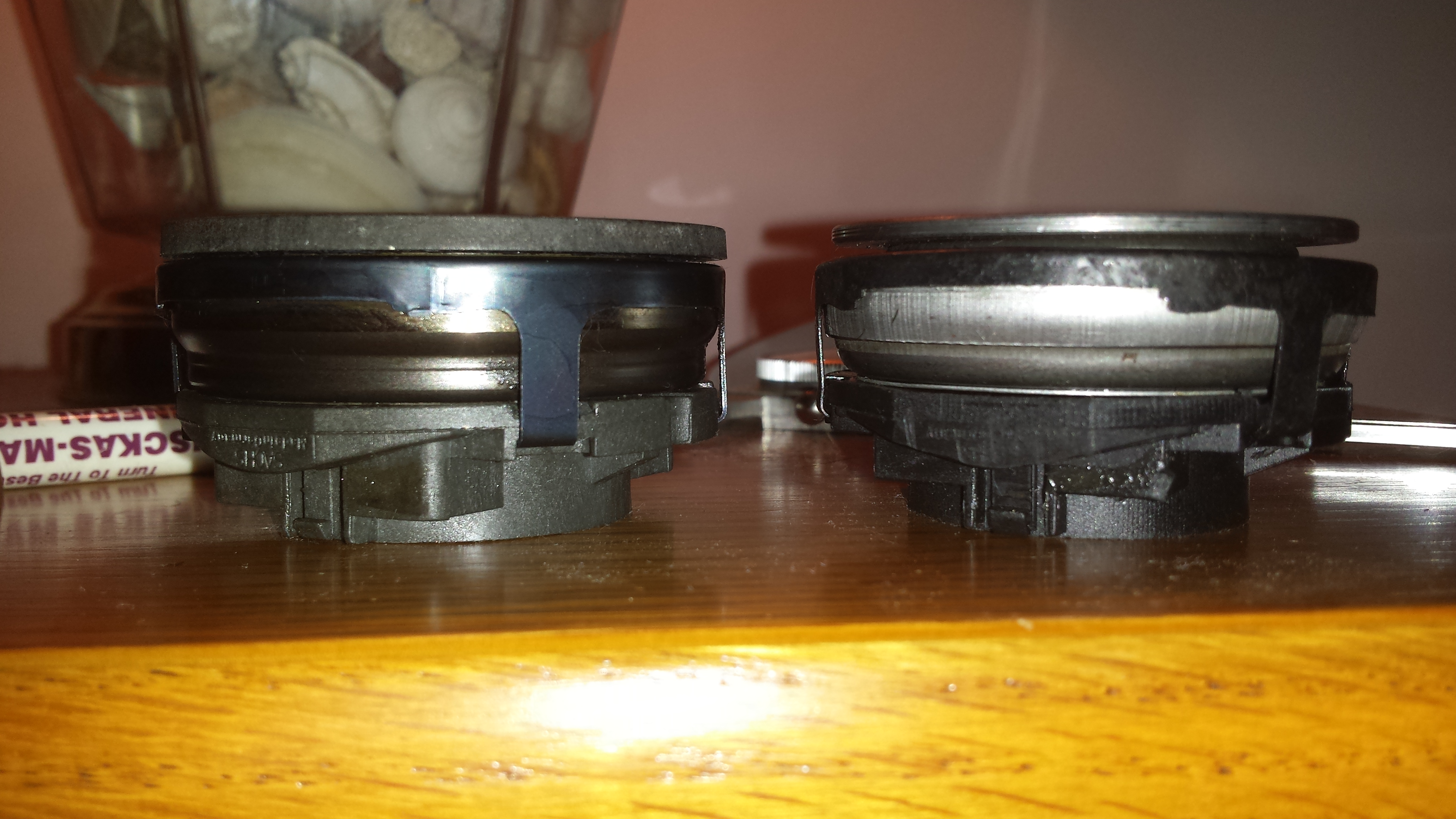

My plastic-faced TO bearing didn't fare too well even for only 20k miles of abuse. I got the 0B1 141 165 bearing from ECS for $15 and as I was installing it, one of the securing tabs broke off so they're sending another over. However, I just realized they could be drastically different by design. I thought I should post up the depth of the 01E bearing (1.329") vs the 016 bearing that 034 provided when I purchased my SB clutch from them for the 200 20v (1.302"). The 016 is obviously used but I measured at a point appearing to be unaffected by the wear pattern.
I don't have the 016 bearing's part number but I do have the 01E's which is Ss 01E 141 165 B. The p/n I have shown for both the mc and 3b motors for 1991 is 0B1 141 165 as per ETKA. I think its pretty up to date in terms of software??
The mc bearing is on the left and the 01E is on the right. The backing plate/sleeve is slightly different in depth also.

Watching this with interest... you wouldn't think 0.007" would make a difference but who knows?

Looks like you have two different manufacturers TOB's there. One is metal faced or just has the plastic dust cover removed? FWIW the 016(torsen) and 01E/01A all use the same TOB pn# 012141165E old pn# superseded to 01E141165B 01E141165 01E141165D 0B1141165

The metal faced one is made by hamburg-technic. The plastic one is sachs.

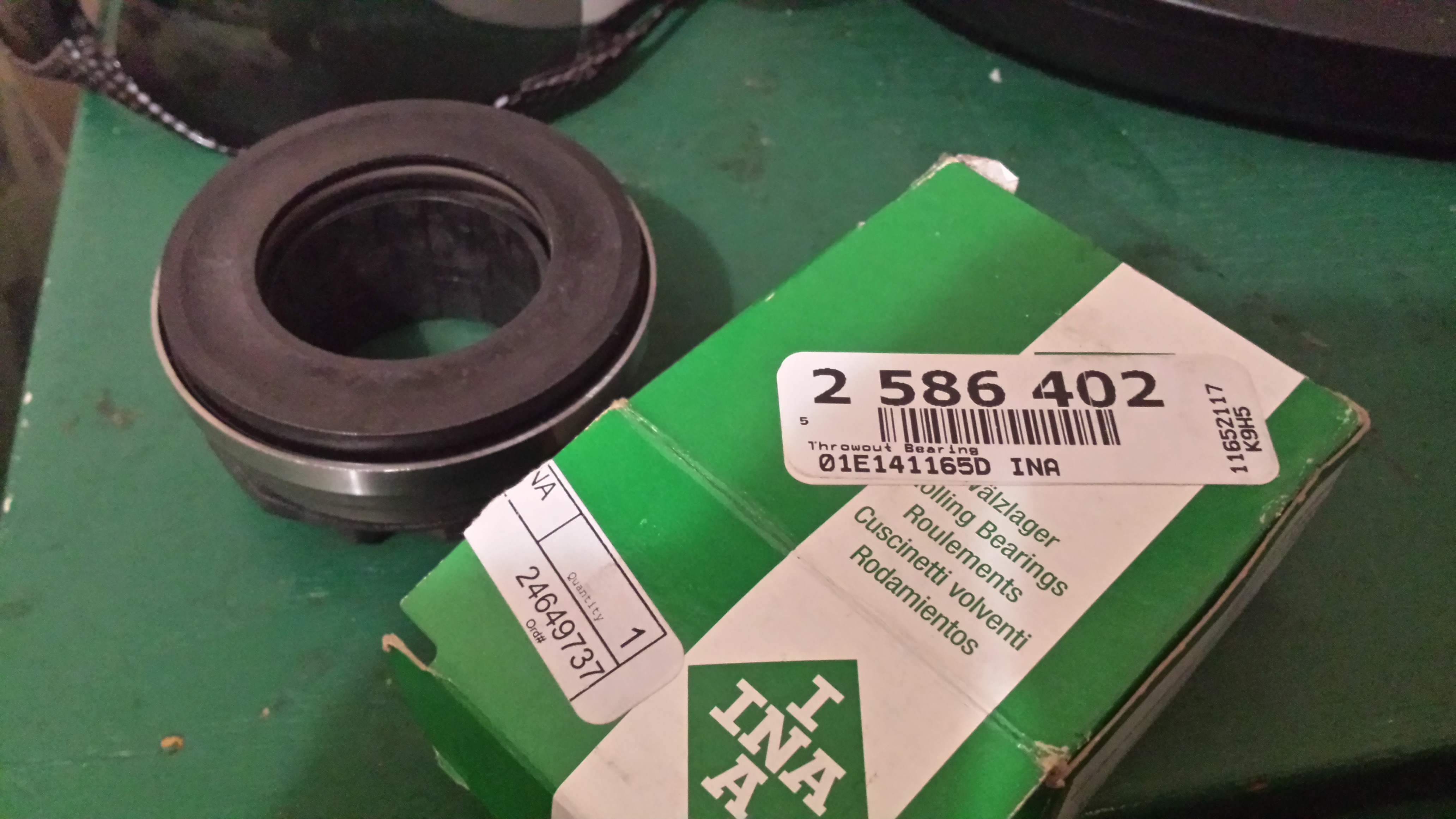

I called ecs and they're giving me the stock INA bearing at no charge since I'm waiting forever over here. I don't want to mess with this anymore I guess. Lots of other stuff to think about for the car. It's plastic faced on the INA but oh well.
Re: 01E throwout bearing in an 016?
Just got the new INA bearings and it's slightly deeper as a whole unit! I haven't measured yet but I'll see if the plastic face comes off at all first
INA:
Feels VERY heavy duty. Plastic face seems more dense than my original 034-provided sachs unit. I like :)
1.331" depth if you measure only to the inset face area for the PP fingers. Corrected depth from surface to fork retention surface is 1.015" as well.
"Fingers" crossed :D
