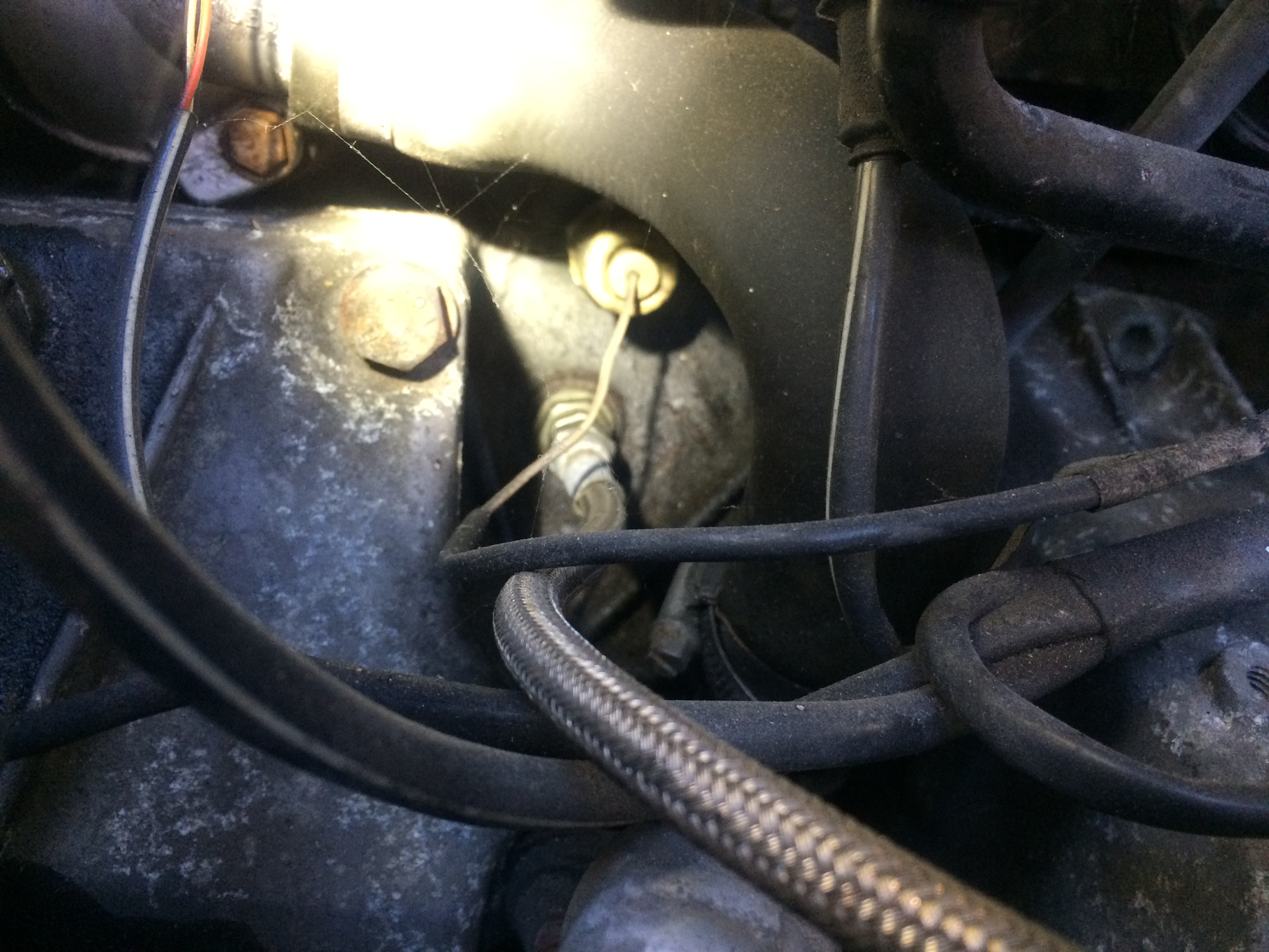

Euro block oil pressure switch....help
Post by Audilard »
As you can see in this picture of my 2.5 euro block the bottom oil pressure switch threaded hole is much bigger than the 7a or 3b or aan blocks. Any ideas, leads or suggestions for a larger switch or one I can order?

The check valve is as that is the same.
