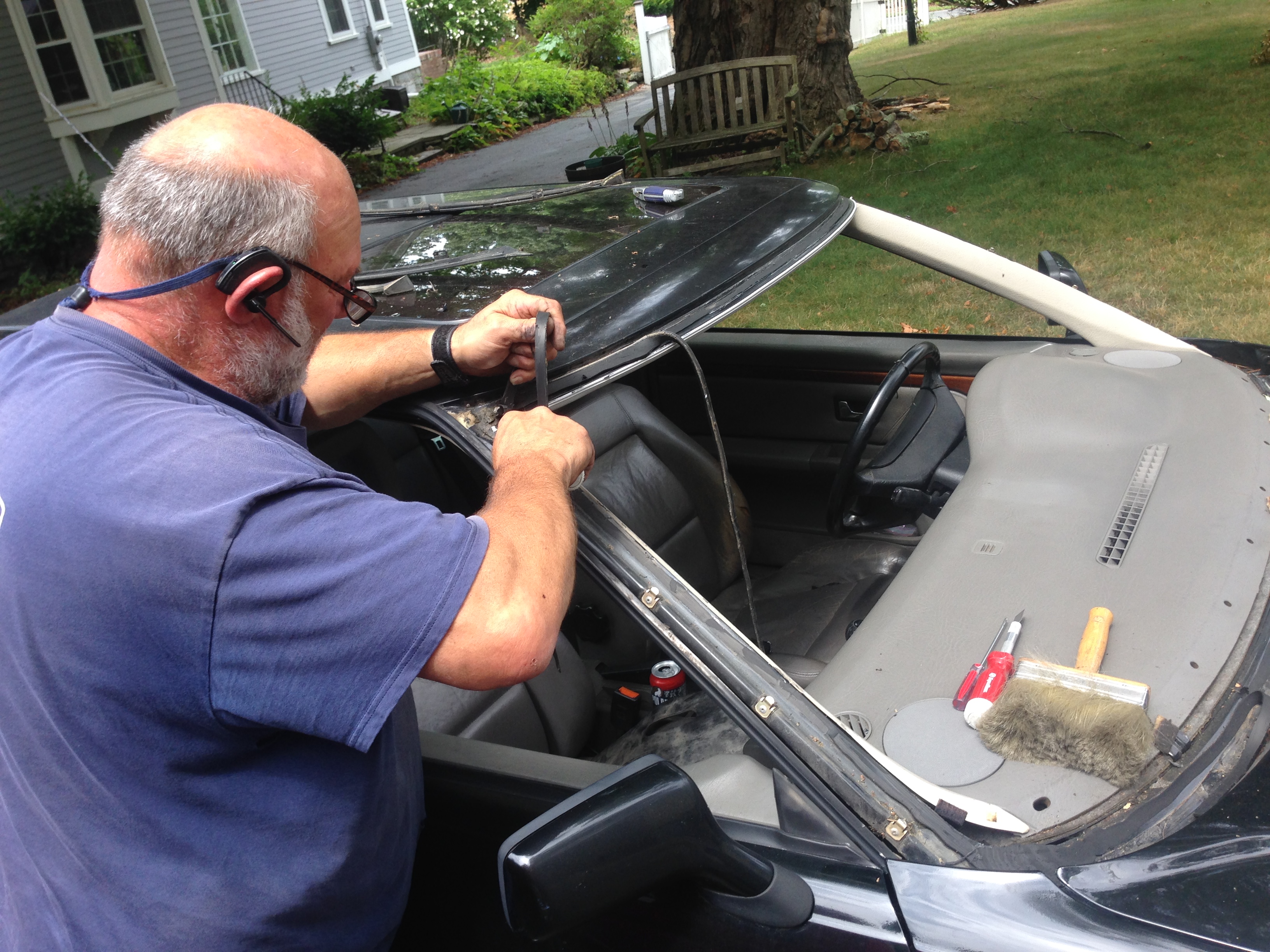

Don replacing a Coupe Quattro Windshield for me this past summer
- DonCotton - 1.JPG (2.33 MiB) Viewed 40723 times
