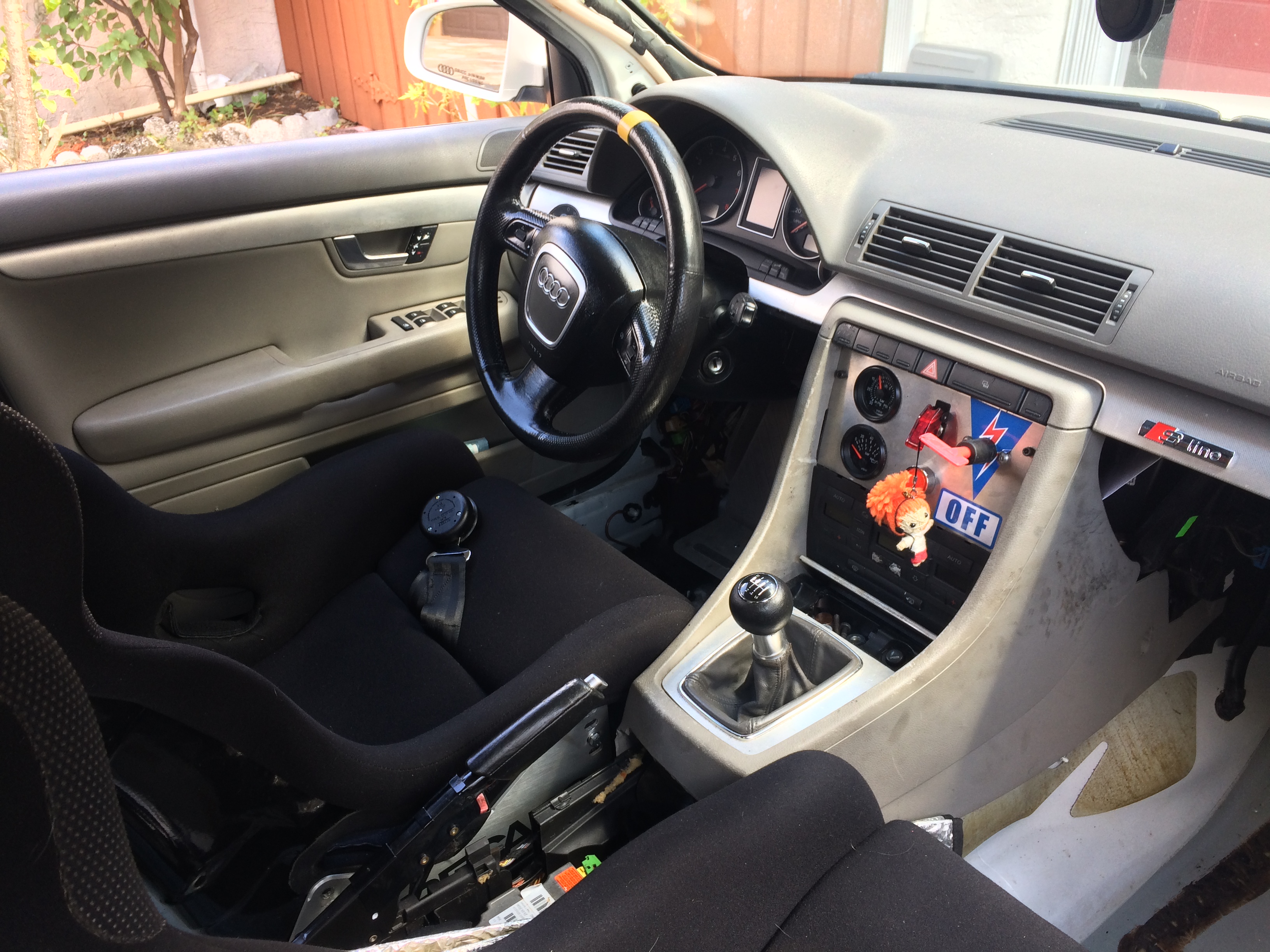

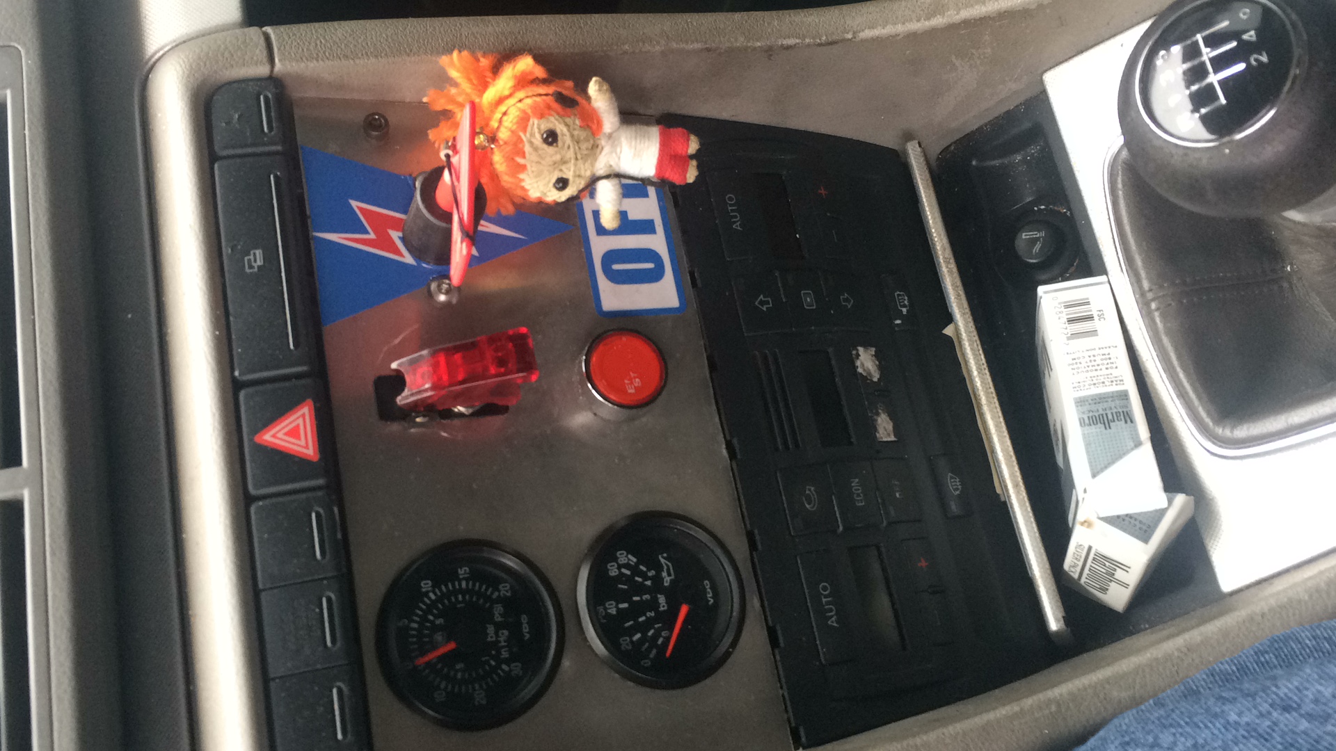

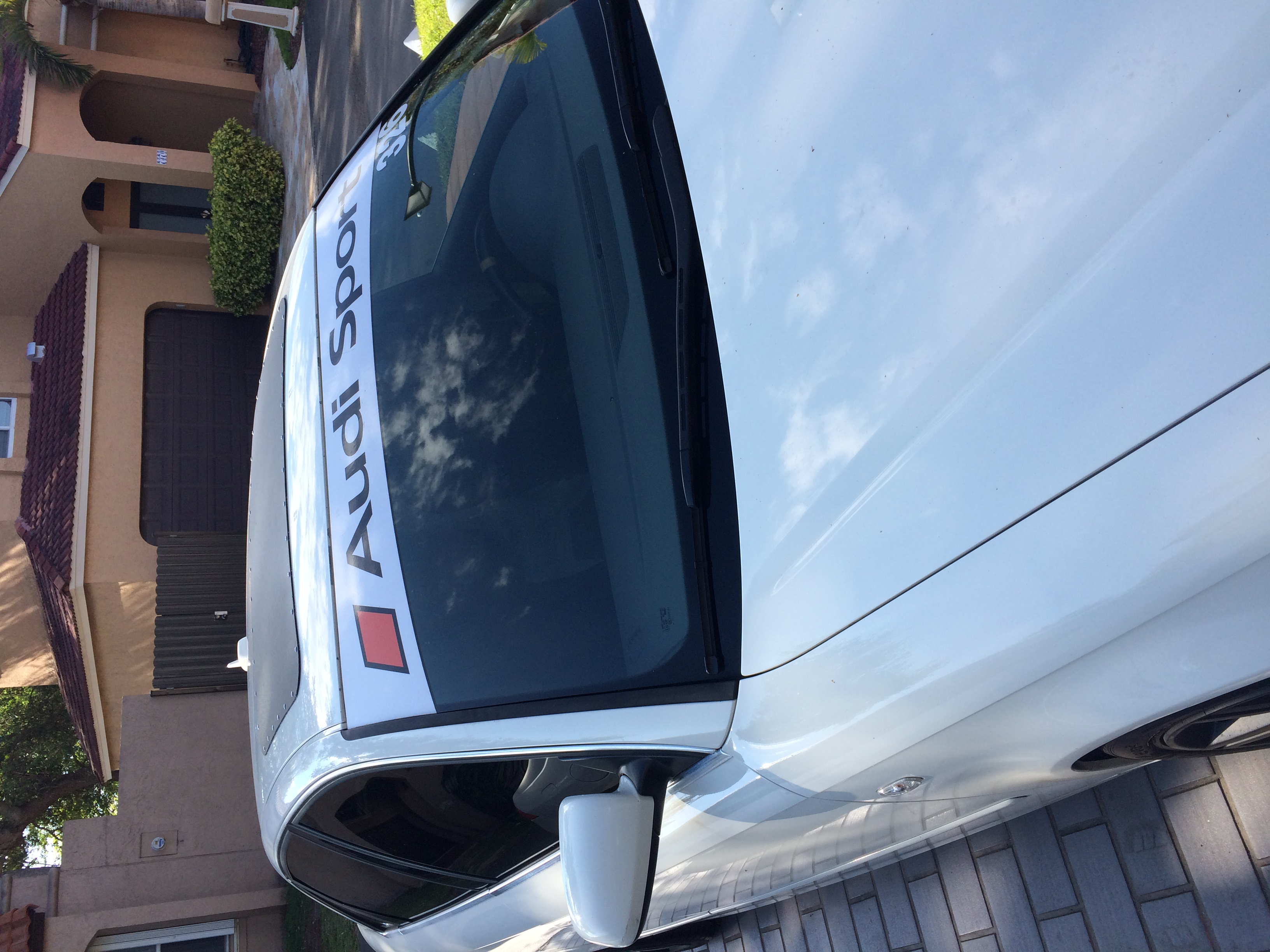

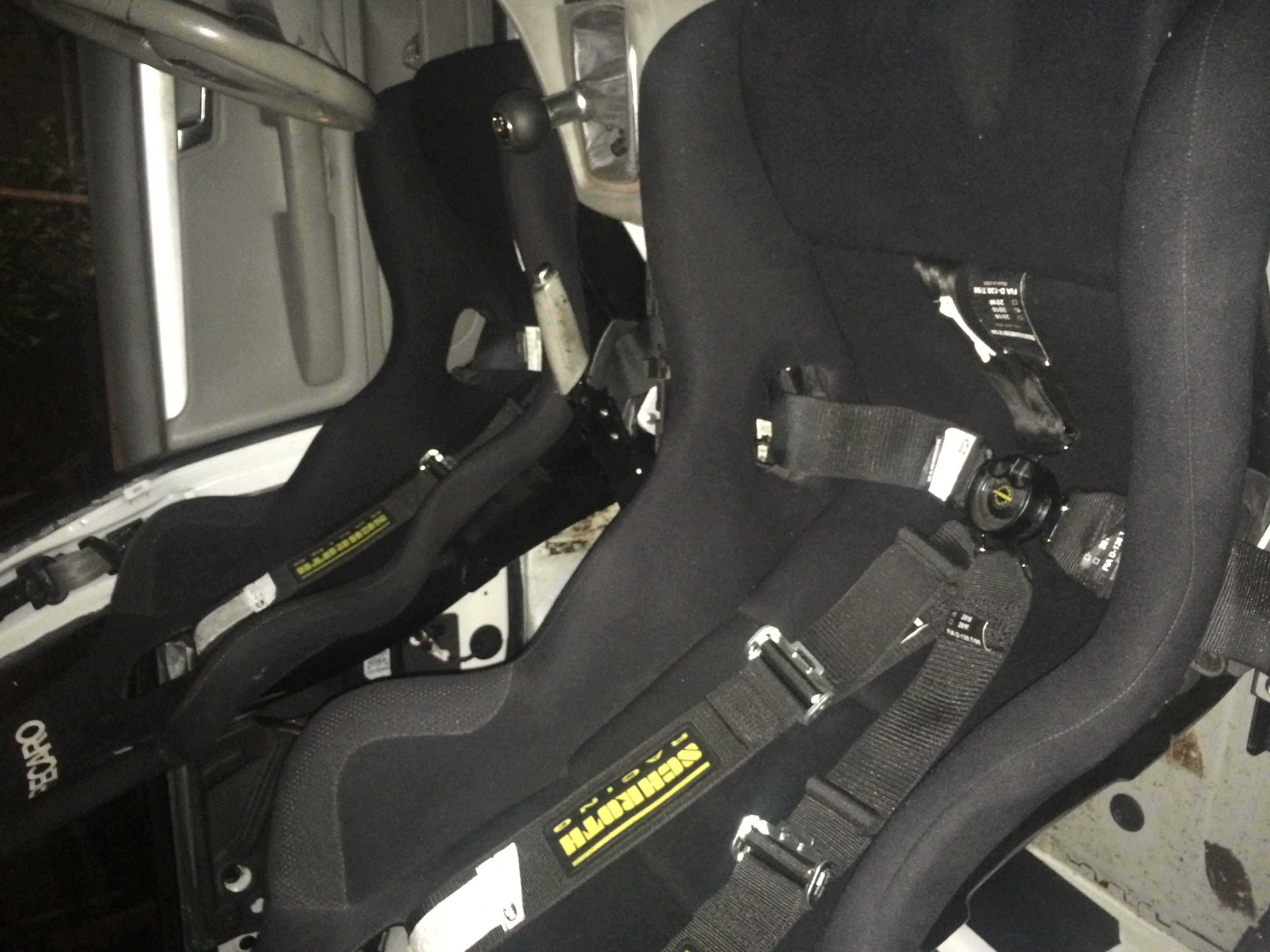

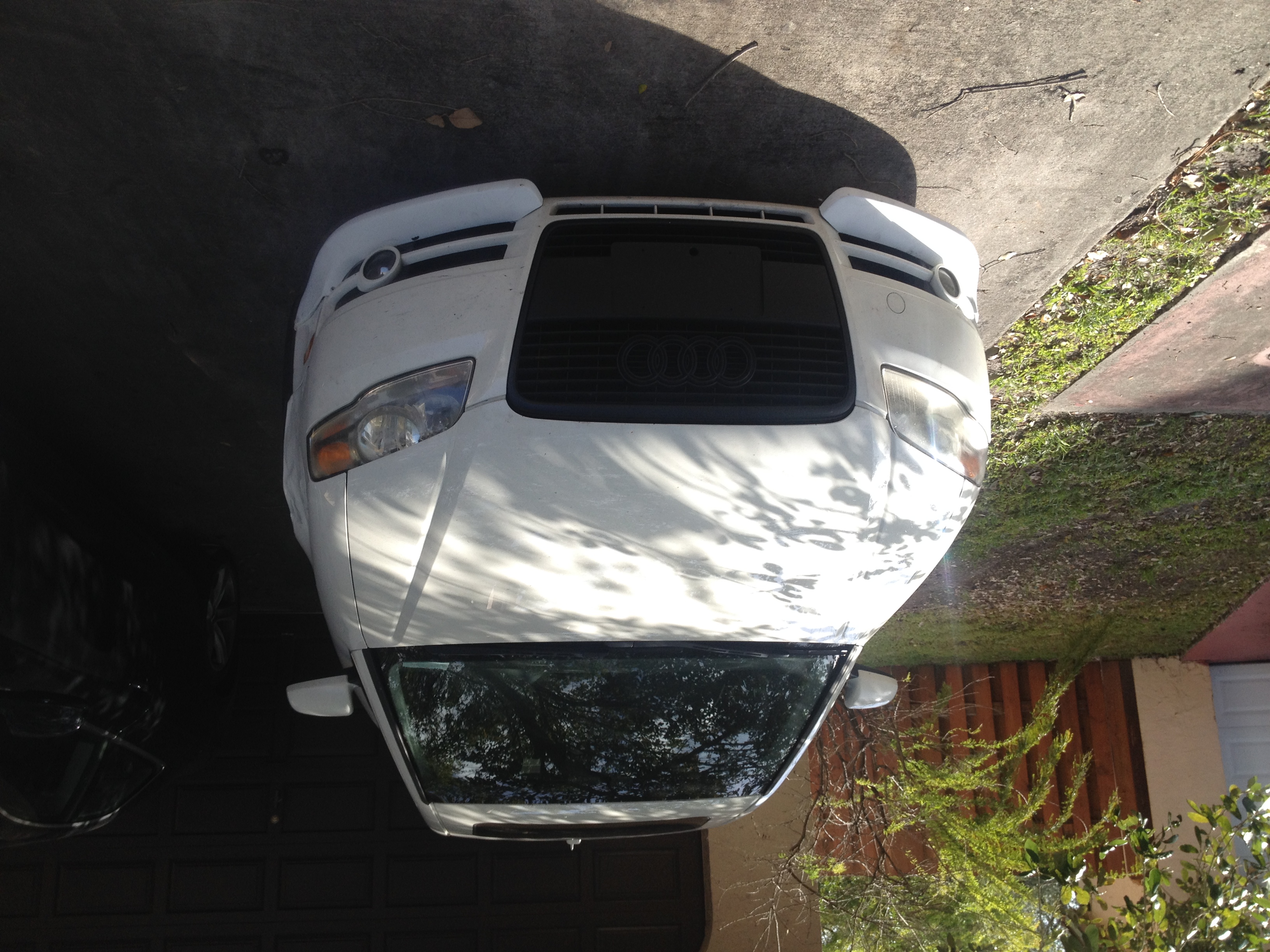

Hi.
Here are some pictures of my project. enjoy.

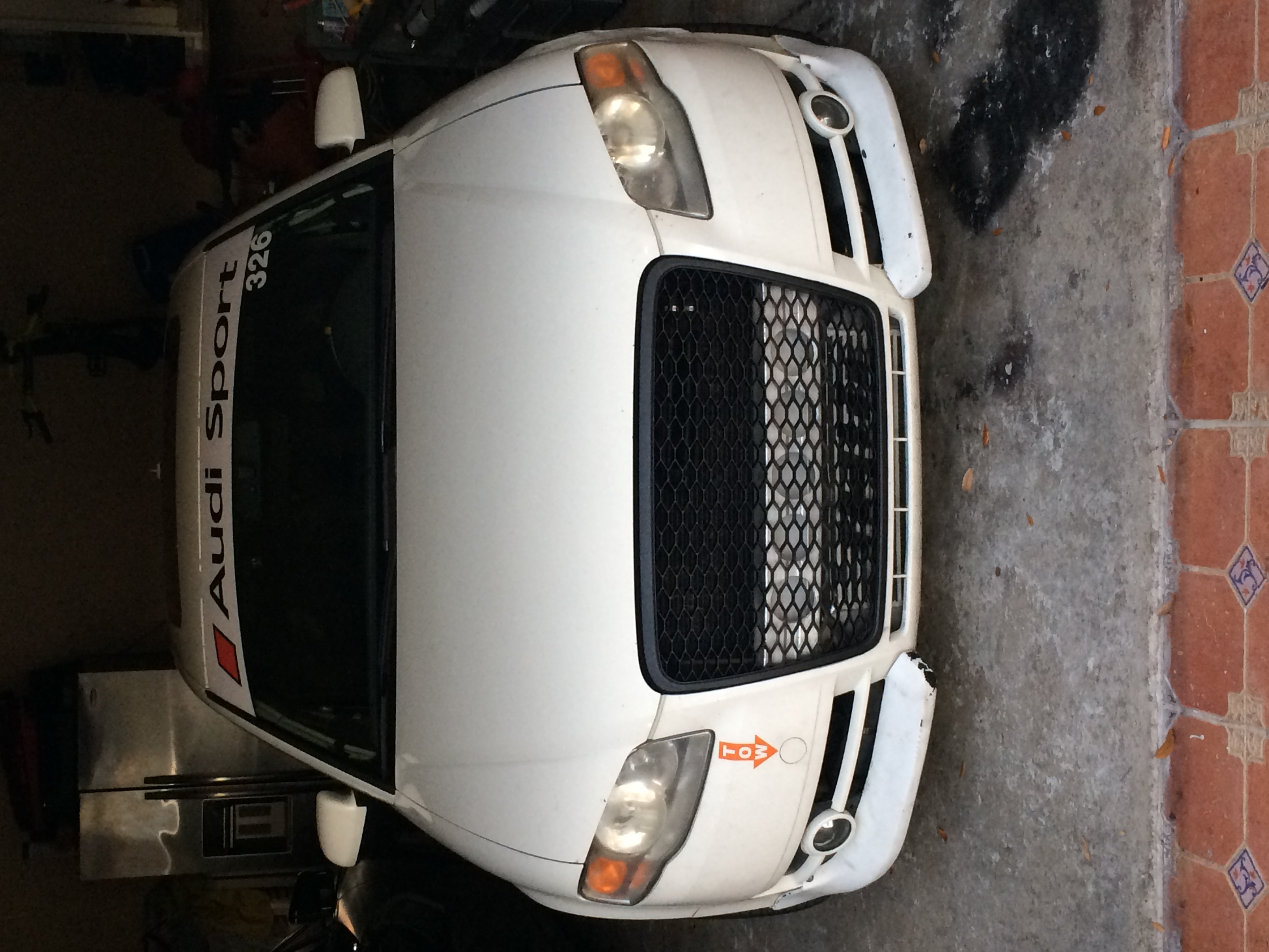

Nice car and welcome! Good to see a newer project around- I have a B6 1.8t project as well.
What are your plans motor/turbo/power wise?

well motor, turbo will come as need it, right now im running REVO 2+ intercooler.

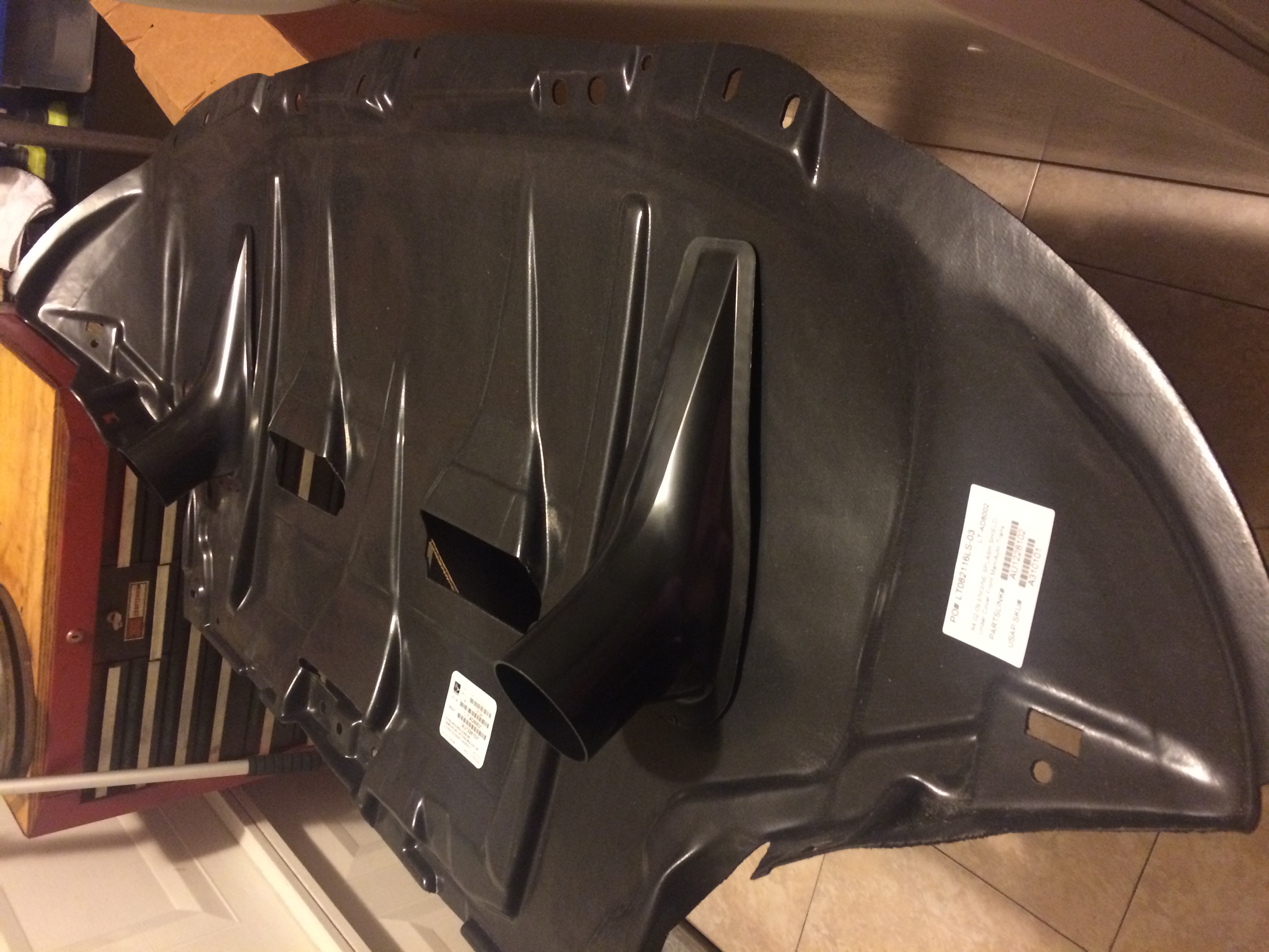

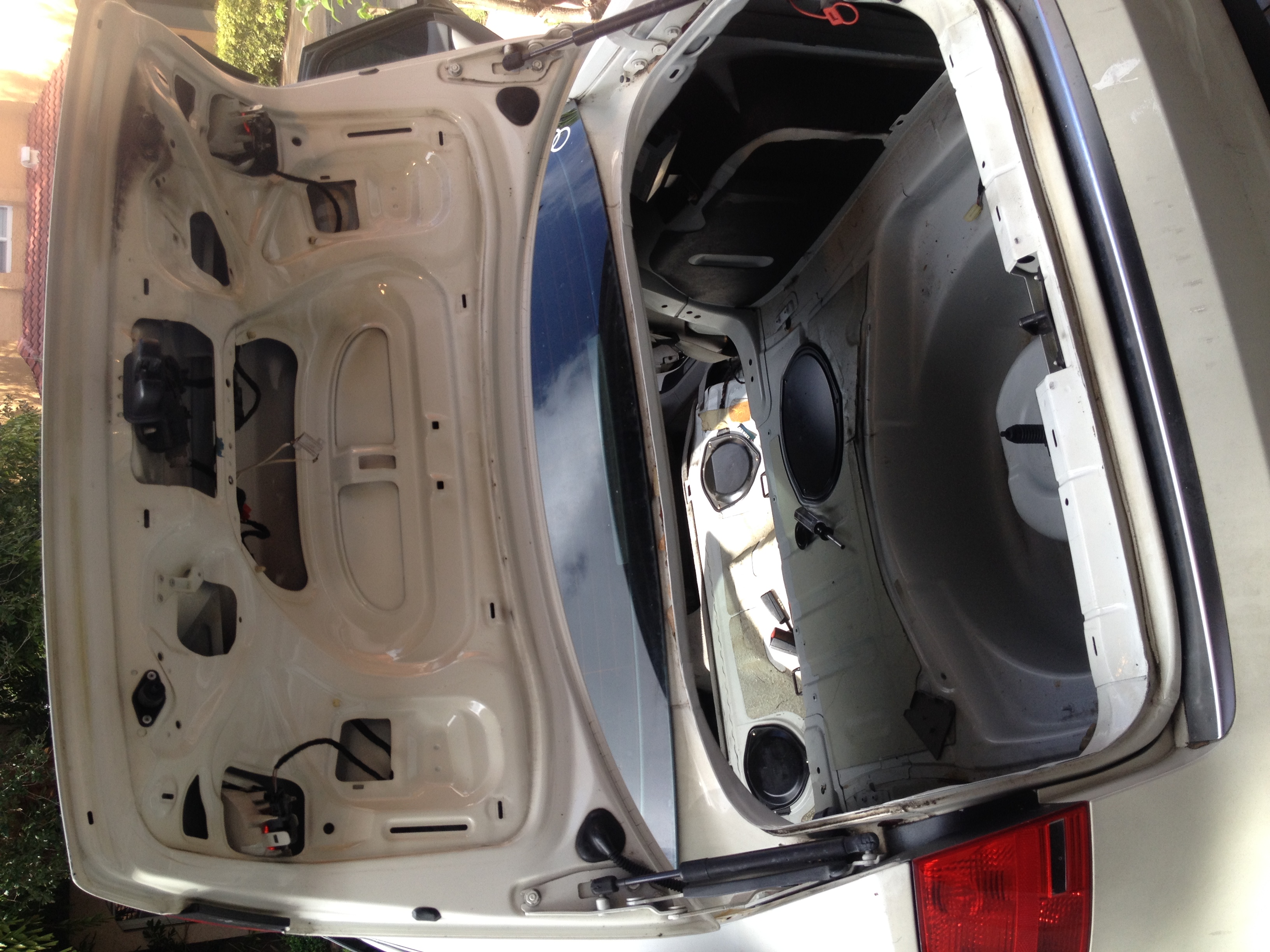

Re: B7 track car
looking good!

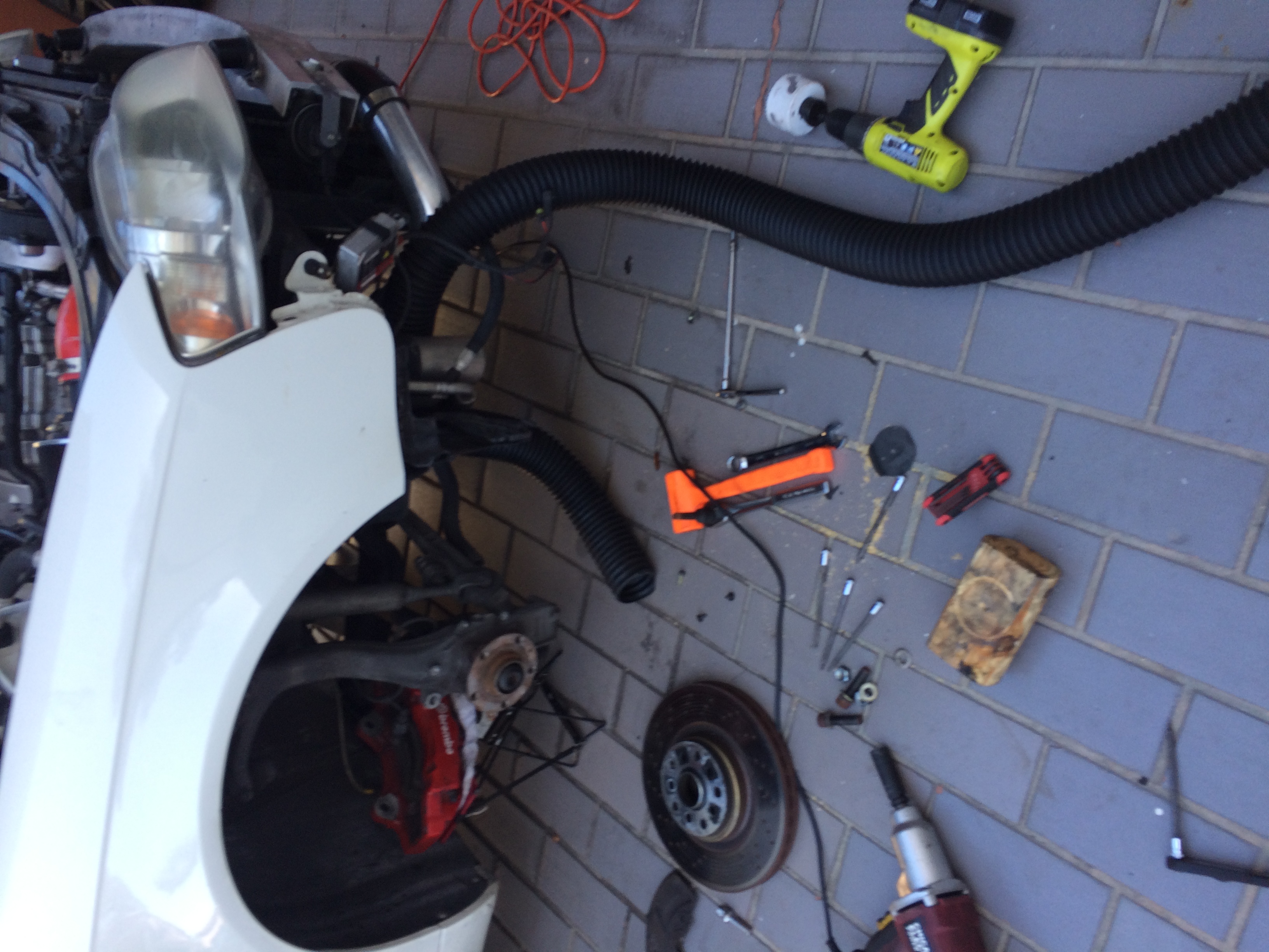

On the last picture of the under tray... looks like you are adding brake ducting from the low pressure area under the car. It will be much more effective if you relocate those intake ducts to the grilles by your fog lights on the front bumper. HTH

Re: B7 track car
I try that and there is no much space, so Im pulling it out and putting them in the under tray. I want to keep the fog lights so I will give this a try. I was working with the sunroof delete, I think i will have ready by tomorrow.

Re: B7 track car
the german wrote:looking good!
yes I think you where right, I don't have space under the engine for the Naca duct. so I guess no fog light, but I saw some that i can mount next to the original ones but they ask to much money for them. so i will try that.

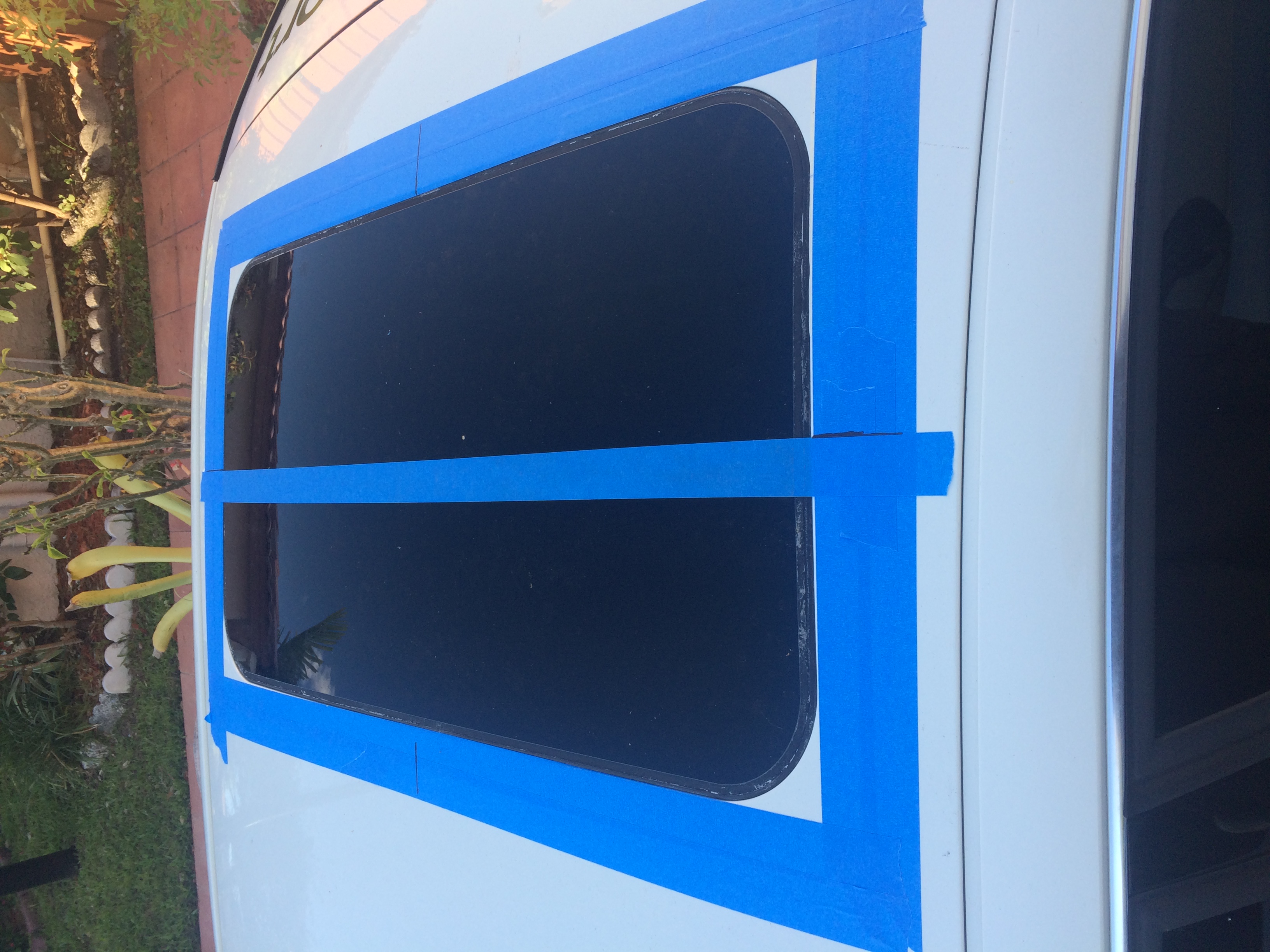

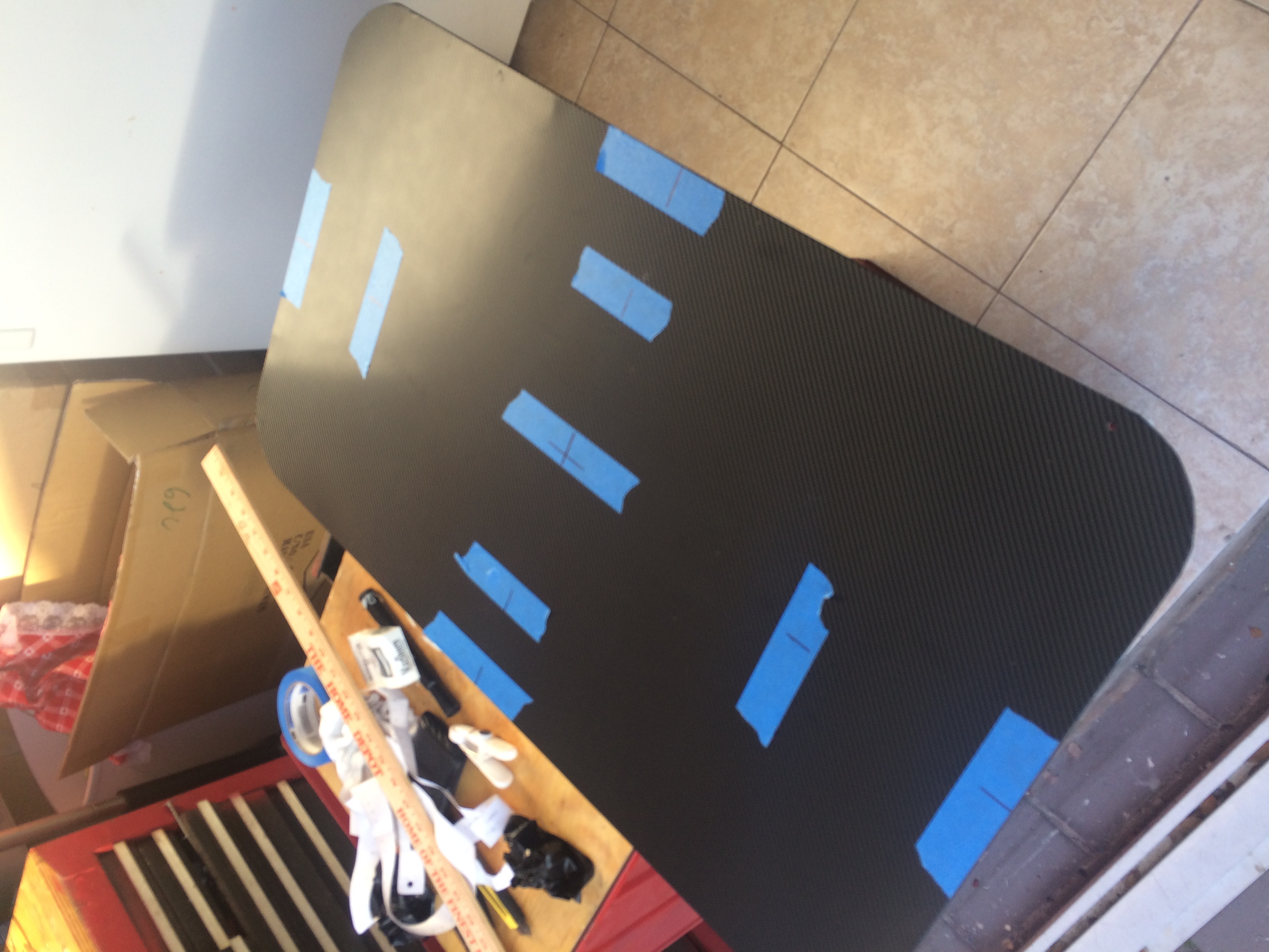

Re: B7 track car

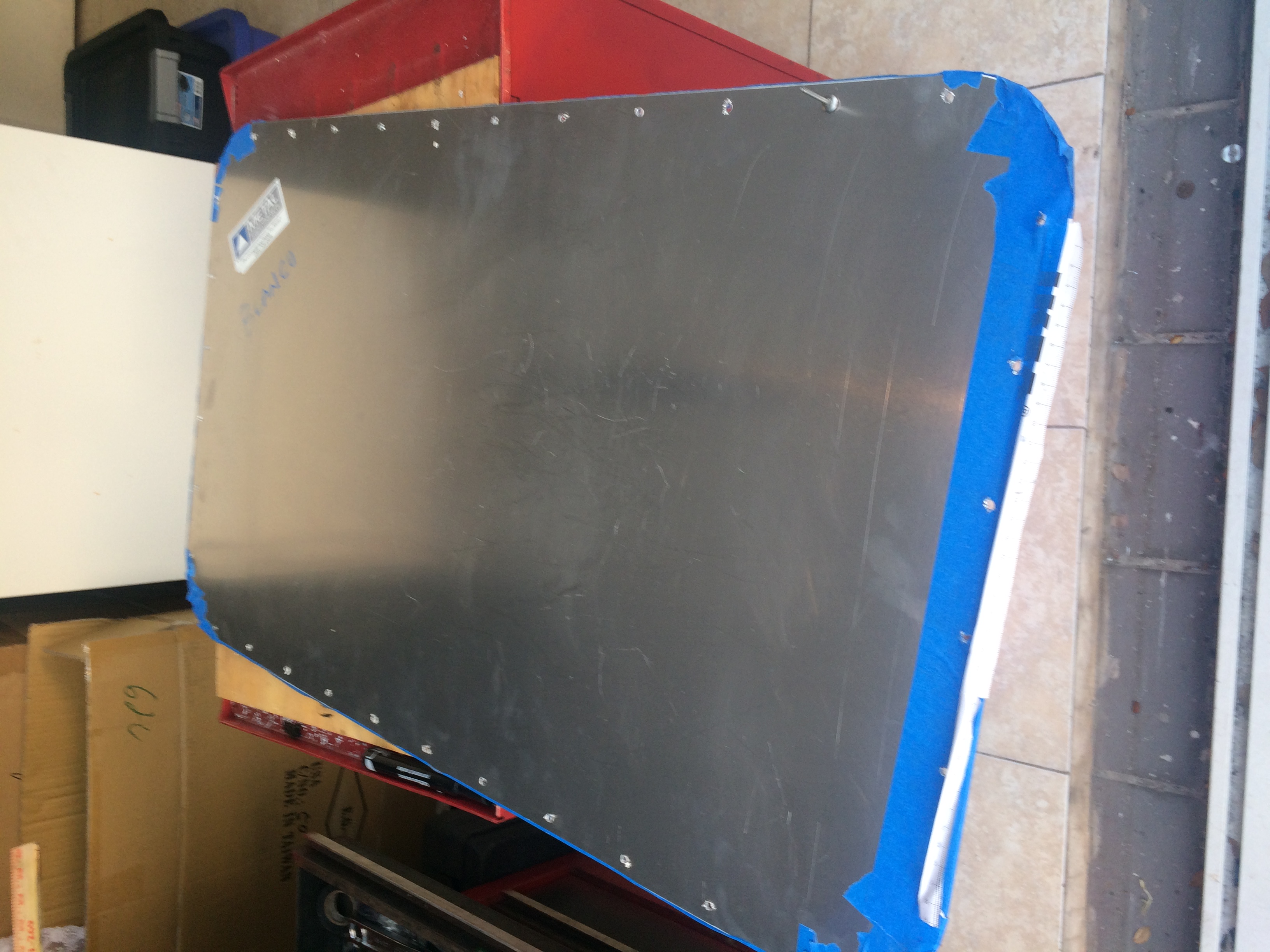

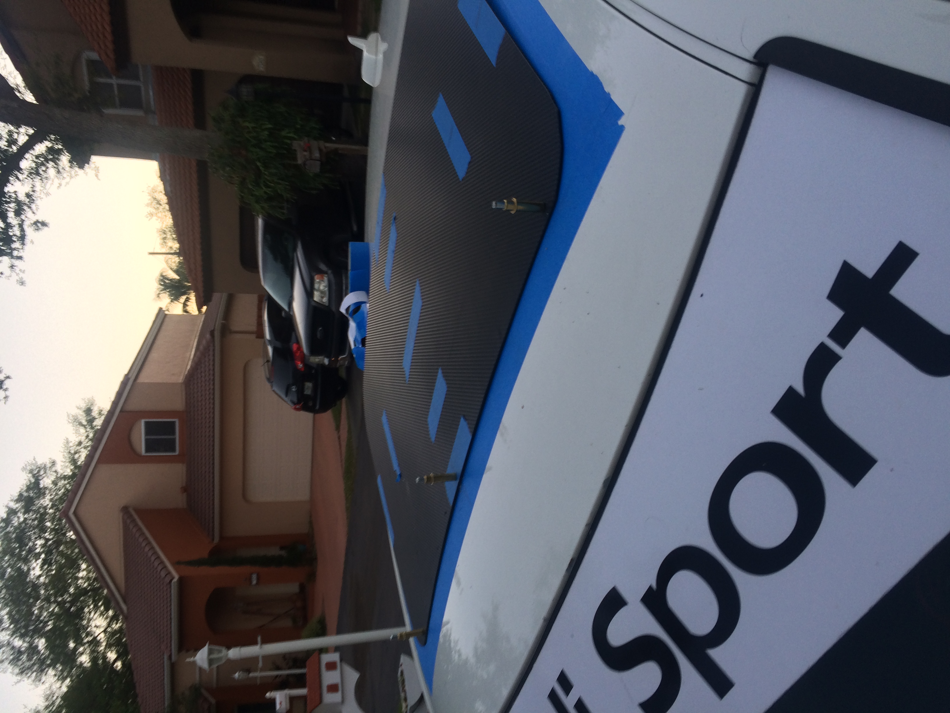

So here is my sunroof delete
- IMG_1546.JPG (1.56 MiB) Viewed 29211 times
- IMG_1543.JPG (1.7 MiB) Viewed 29211 times
- IMG_1529.JPG (1.26 MiB) Viewed 29211 times
