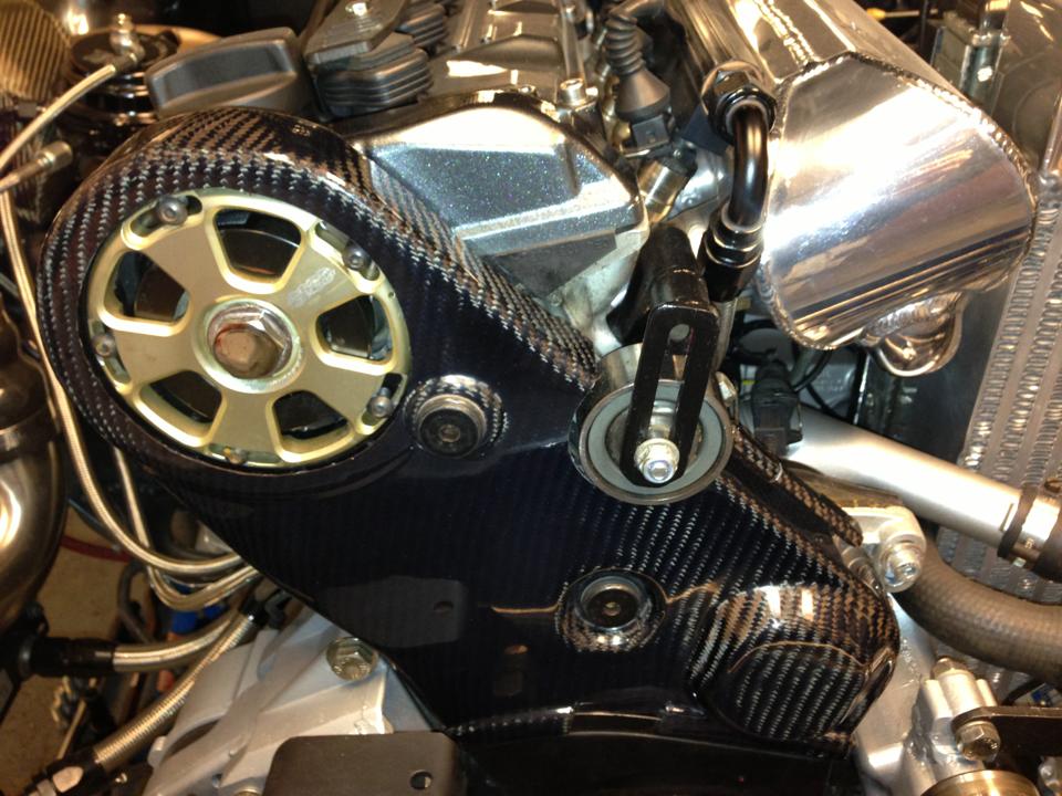

Have a look on the group buy thread on S2F re: 3B kevlar covers, IIRC. Think that's the one I kickstarted, back in the day.
Re: Timing belt gear upgrade mileage question
Posted: Wed Sep 06, 2017 10:39 am
by 88a5tq
Those look awesome! One thing that's killing me is not being able to find this build thread using reverse image searching :wah:
I'm being told that the efiexpress cover should fit over the 16v Autotech gear since it's not terribly unique in design from the others available.
My main concern was really it's center section since when I would push down on the cover, every part would flex except that center area. It's supposed to fit fine though so I will do a start up later today with the cover nuts loose and slowly tighten them while observing any noises.
I am surprised how common the belt "flapping" against the inside cover is. I would like to diminish belt damage from it before changing the TB components of course. Maybe "my belt needs cinched up slightly" :hammer: between the cam gear and water pump lol
