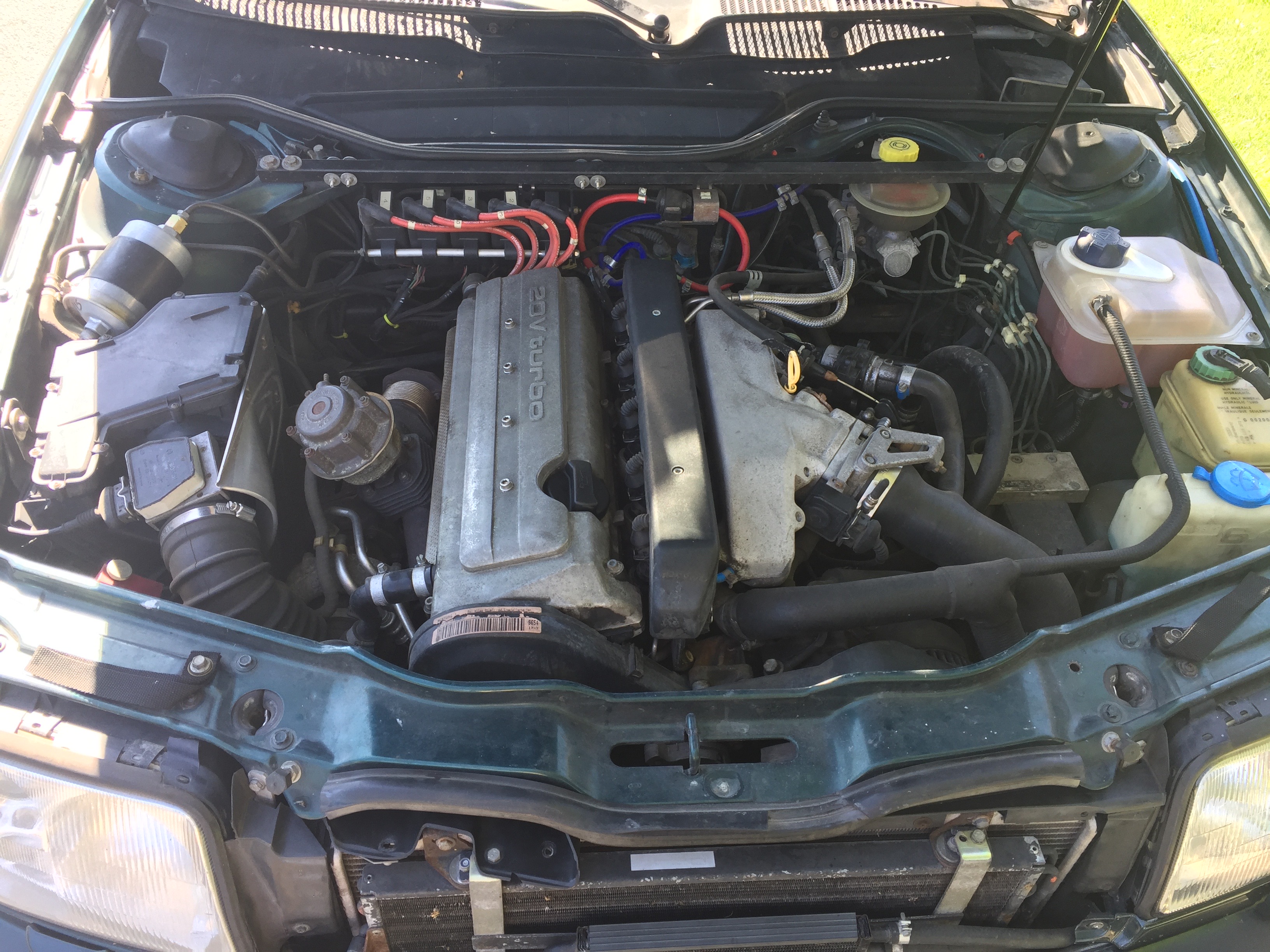

- Pretty clean engine bay
- IMG_6039.jpg (1.89 MiB) Viewed 116225 times

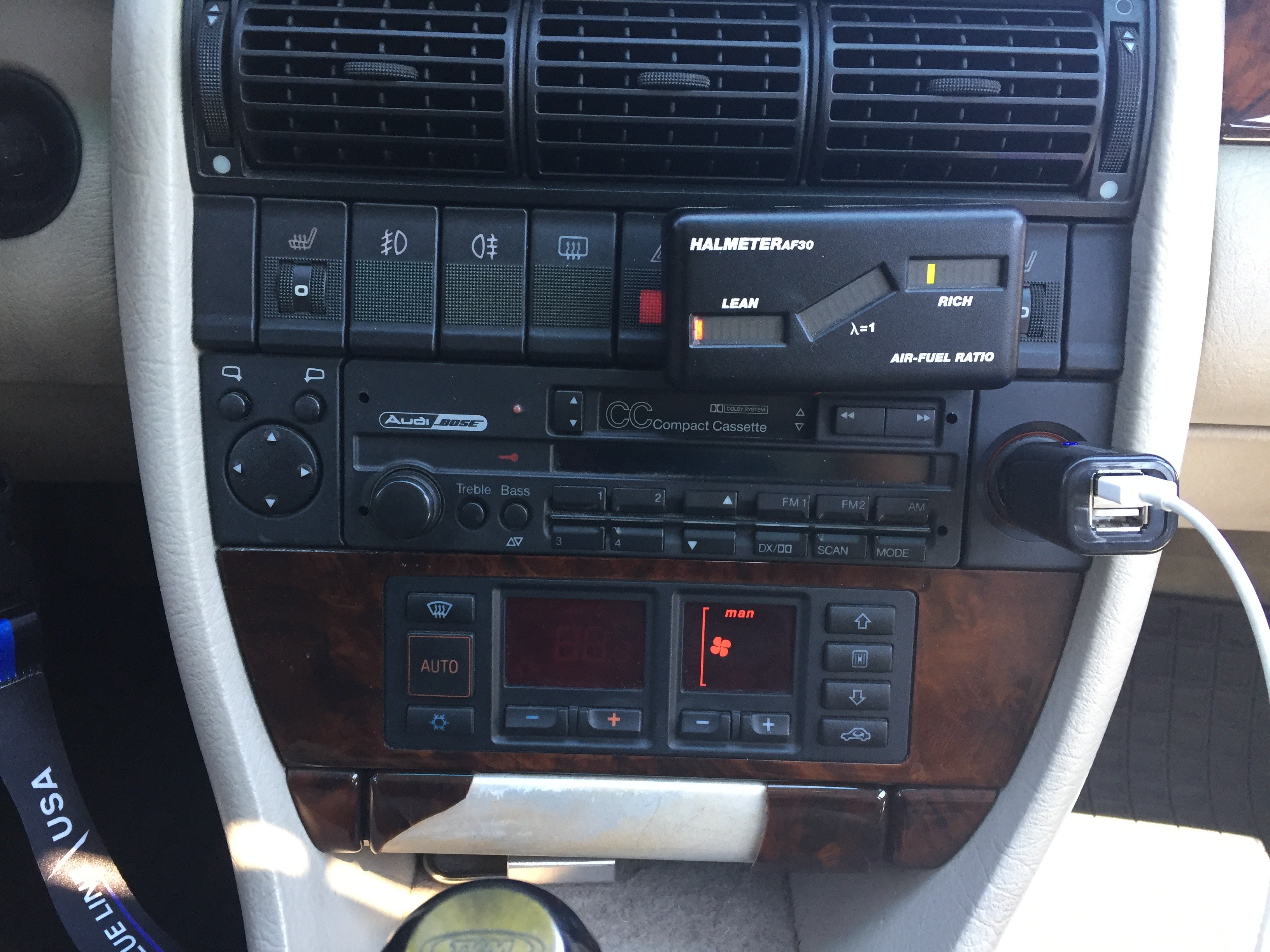

- A/F gauge
- IMG_6026.jpg (1.63 MiB) Viewed 116225 times

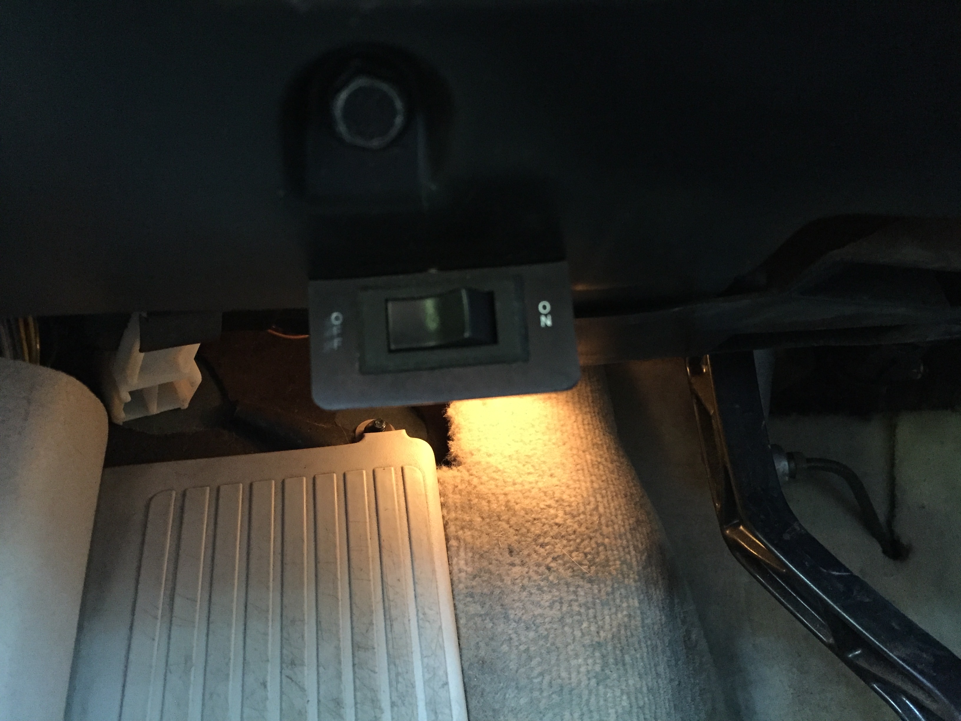

- Toggle switch under knee/kick panel for servo

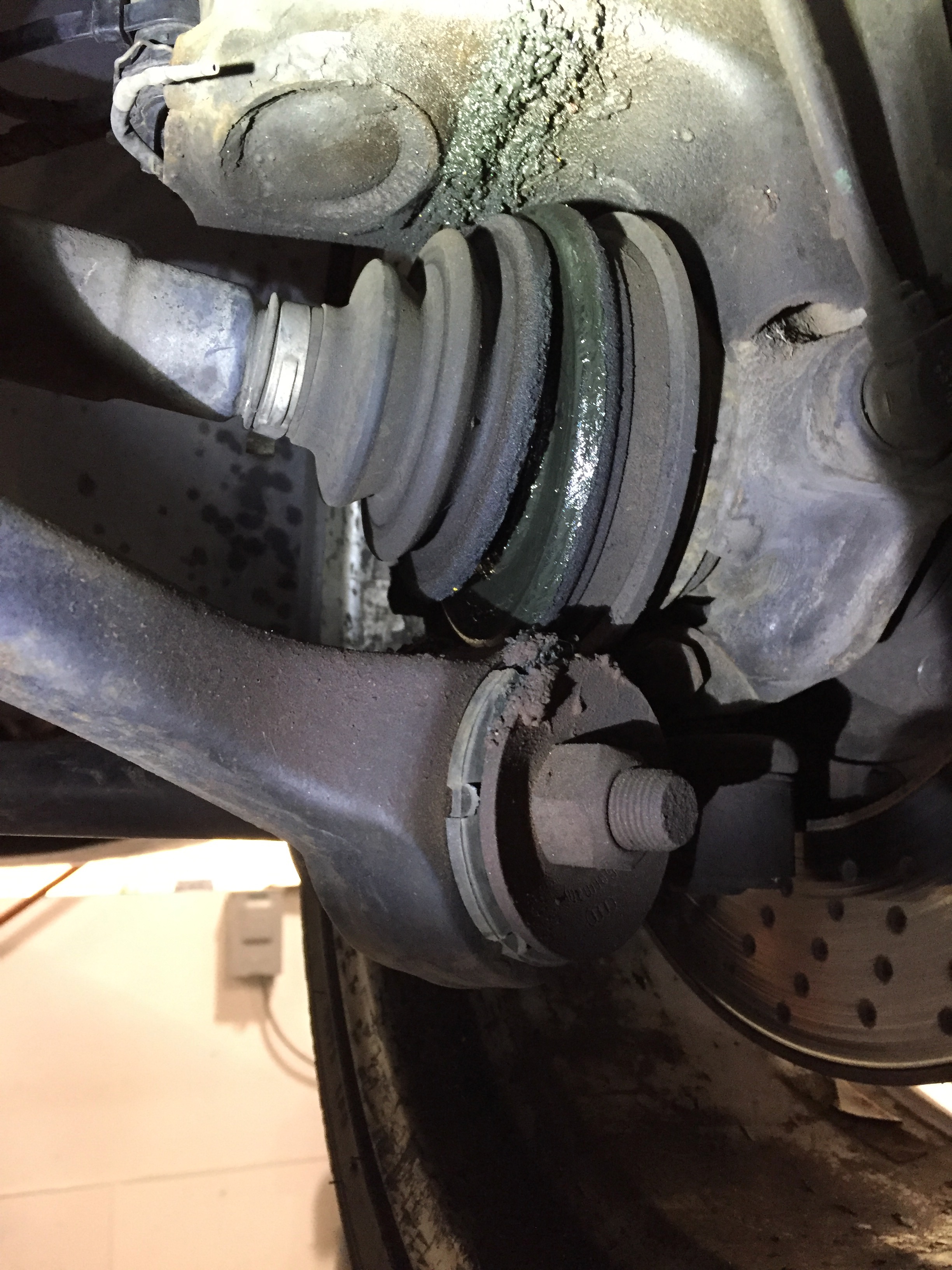

- Torn boot
- IMG_6073.jpg (1.41 MiB) Viewed 116224 times
- After
- IMG_6055.jpg (1.25 MiB) Viewed 116224 times
- Before
- IMG_6045.jpg (1.48 MiB) Viewed 116224 times

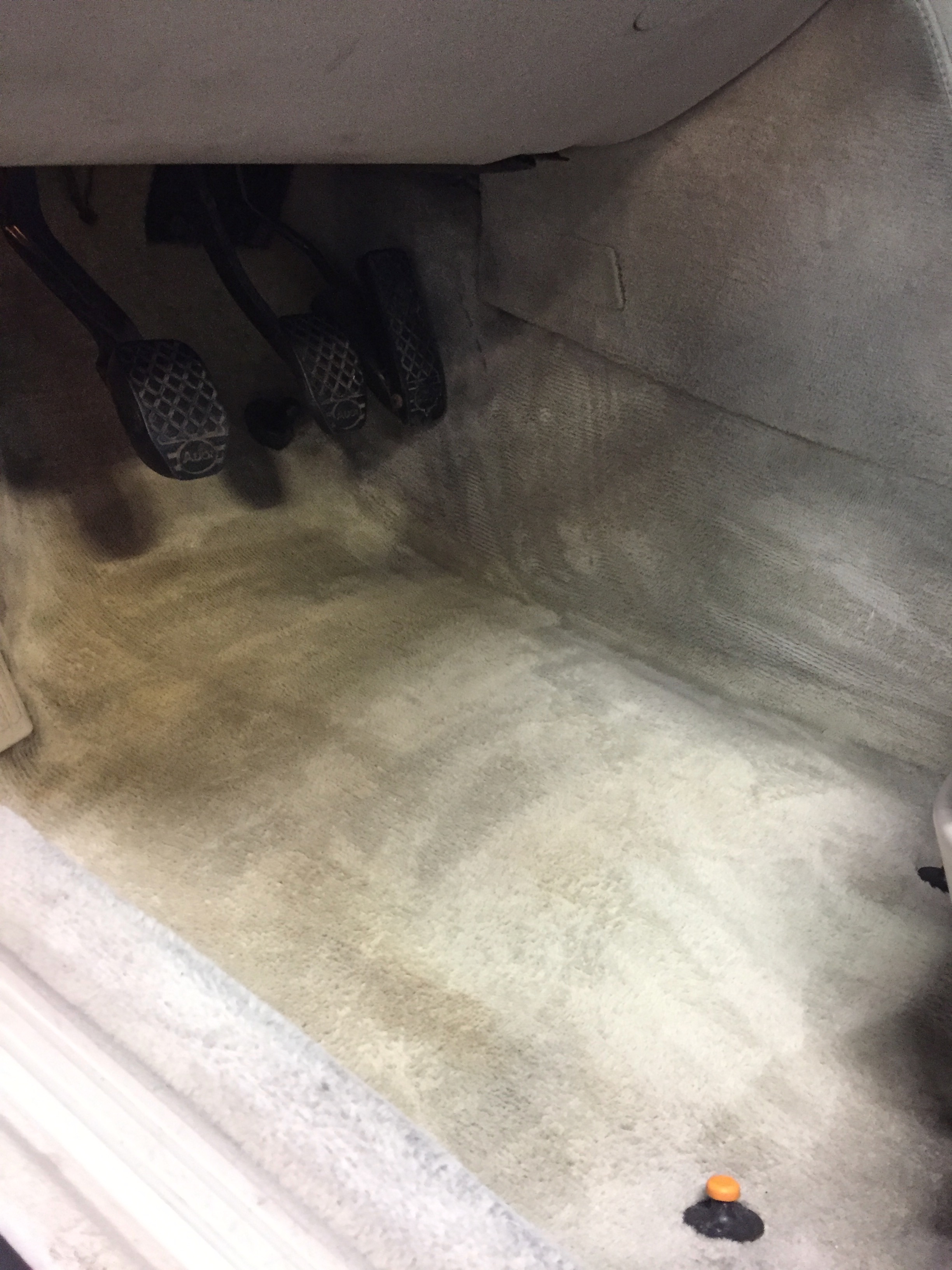

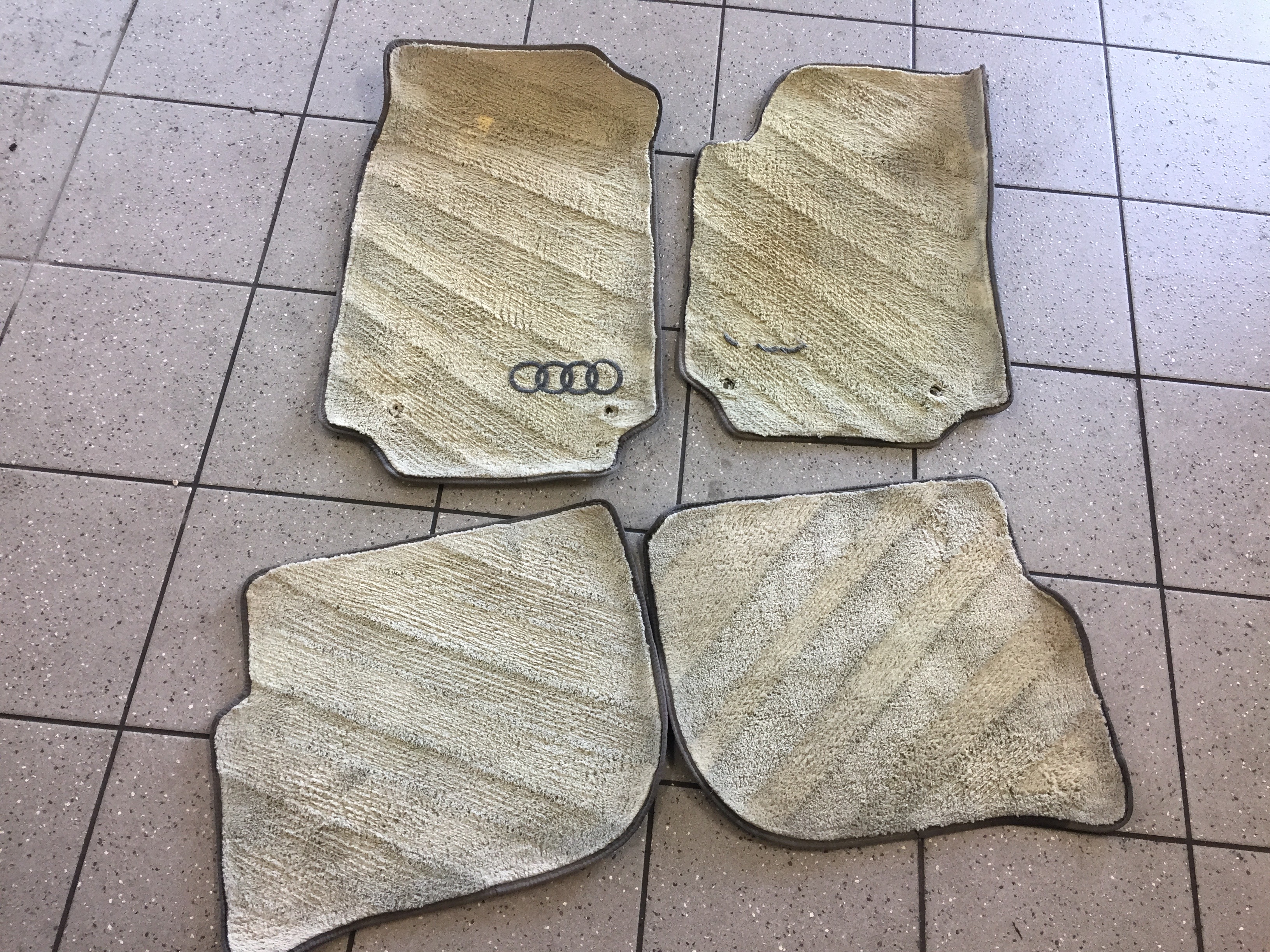

- Mats shampoo'd after I got it home
- IMG_6044.jpg (3.33 MiB) Viewed 116224 times

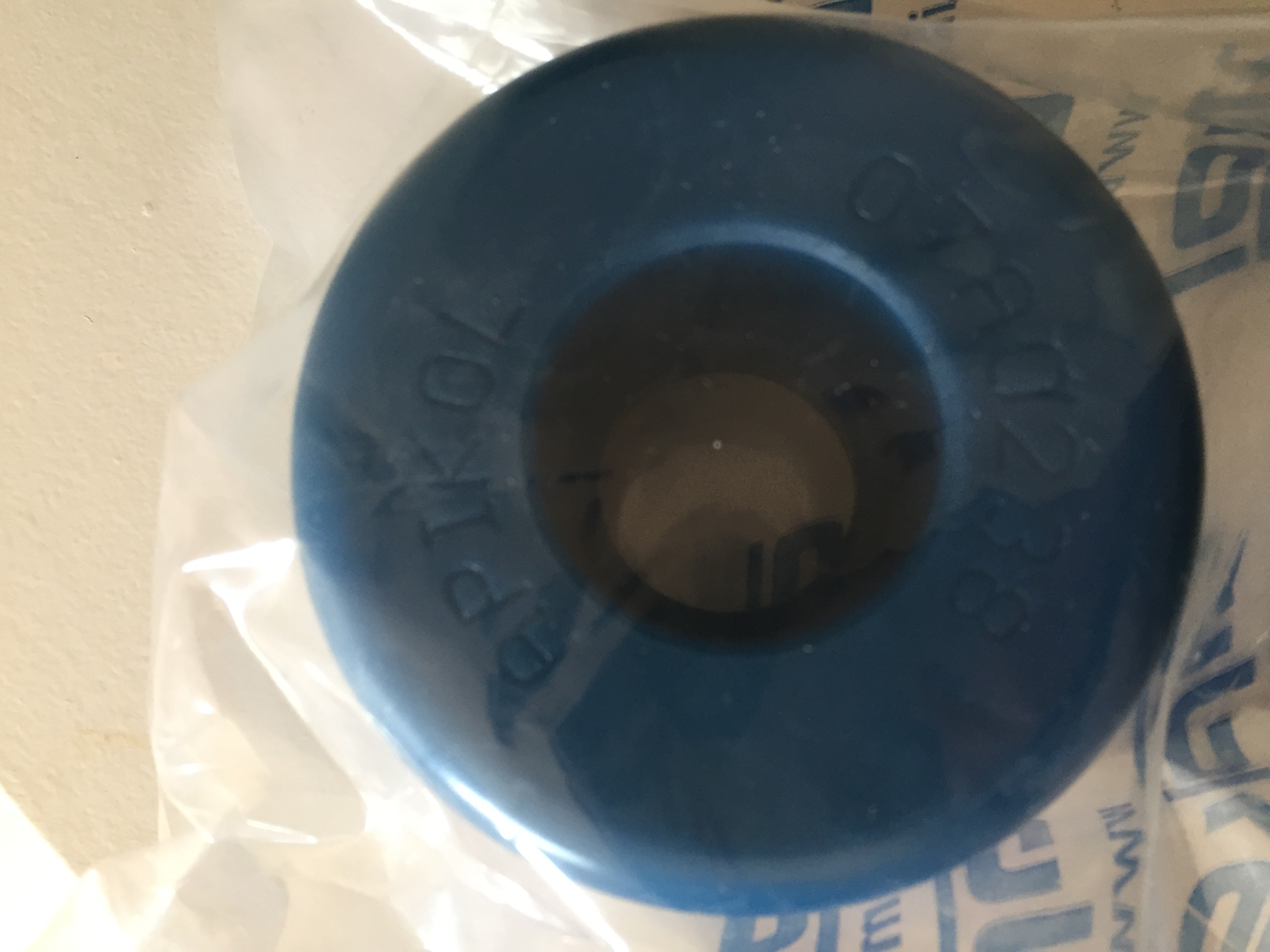

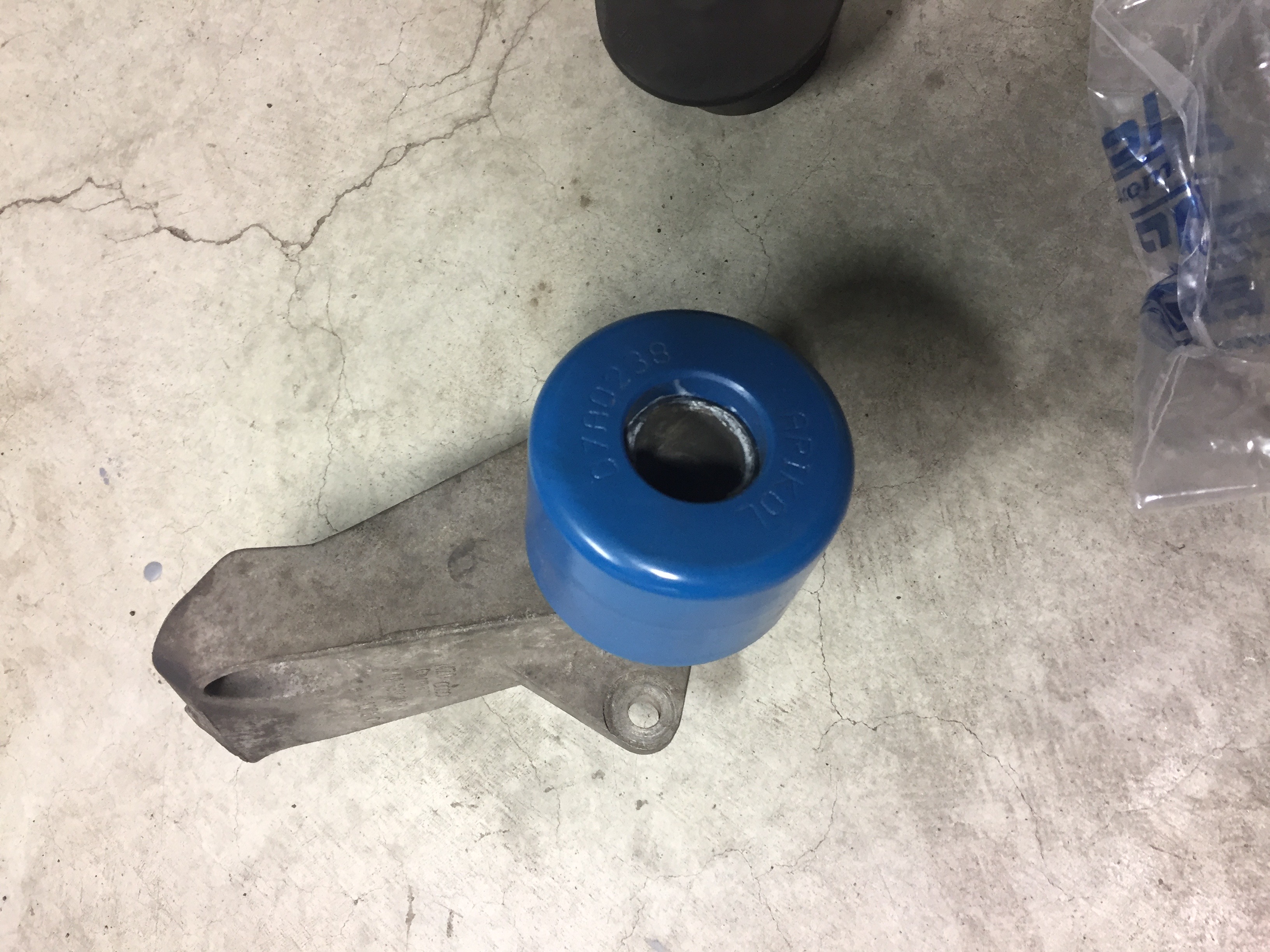

Got my Apikol snub today. Buddy of mine hooked me up for xmas. Need to install it soon. Seems pretty straight forward, any tips or tricks to help install it? I have heard it helps to freeze poly, the night before you want to install?

Maybe I missed it, but what is the toggle switch for?

The switch is to turn the servo steering not assist on and off. The first time I turned it on was a huge surprise. Ha it was like going from no power steering to actually having it, however I just left it off.Nateflix56 wrote:The car looks great on the Otts!

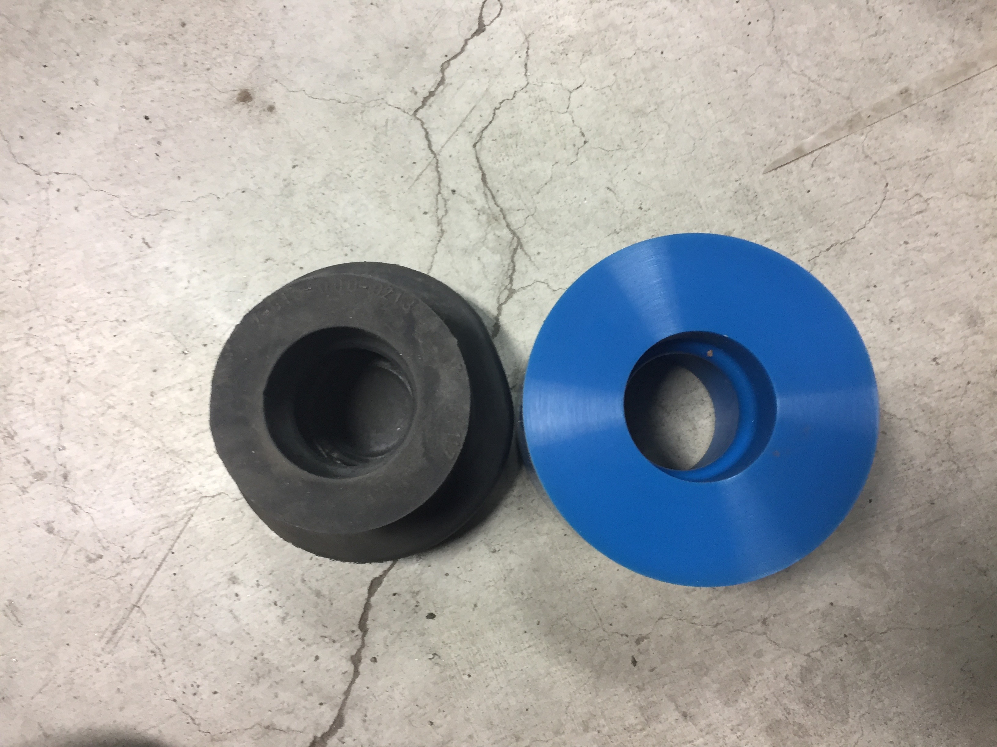

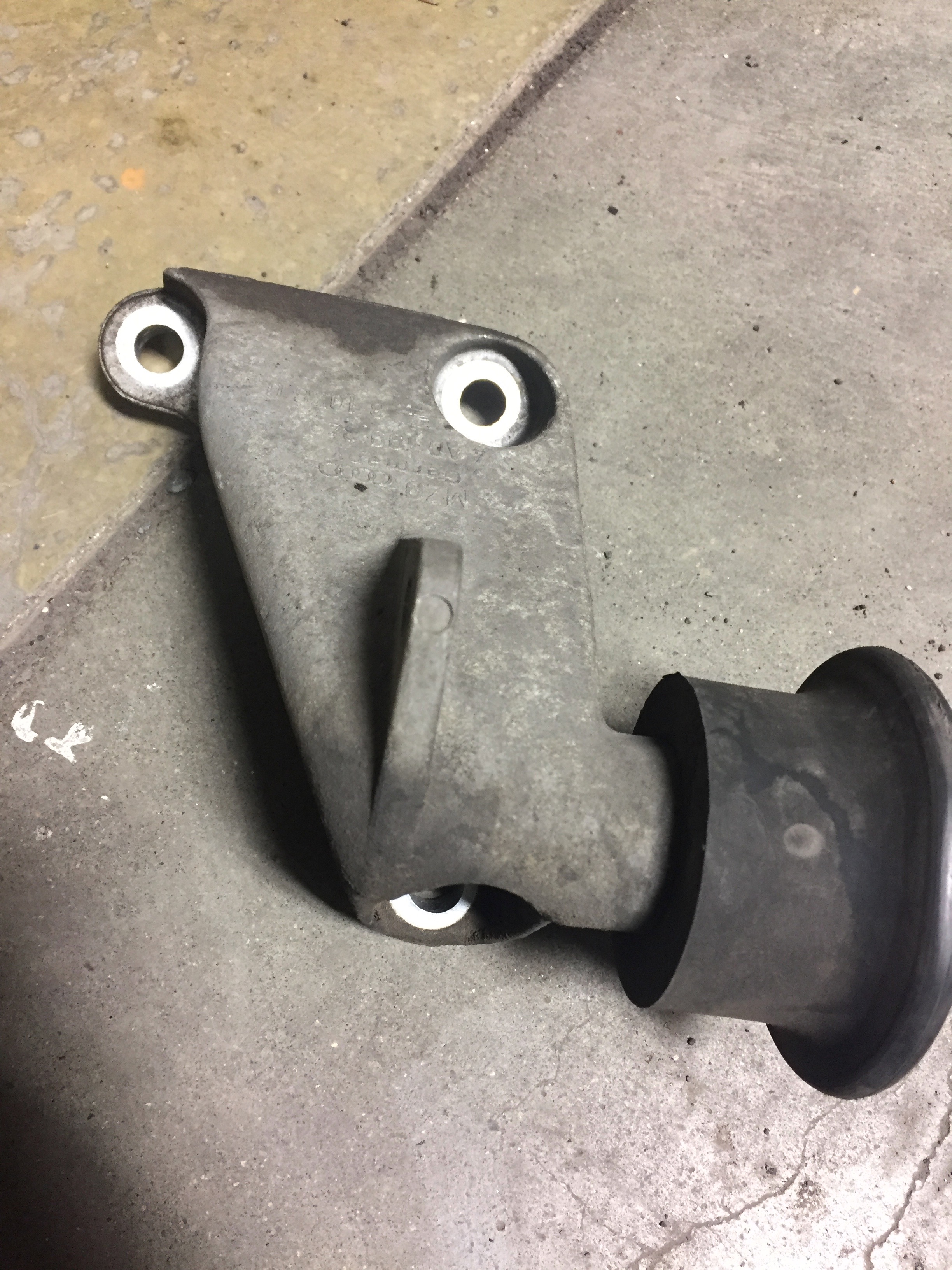

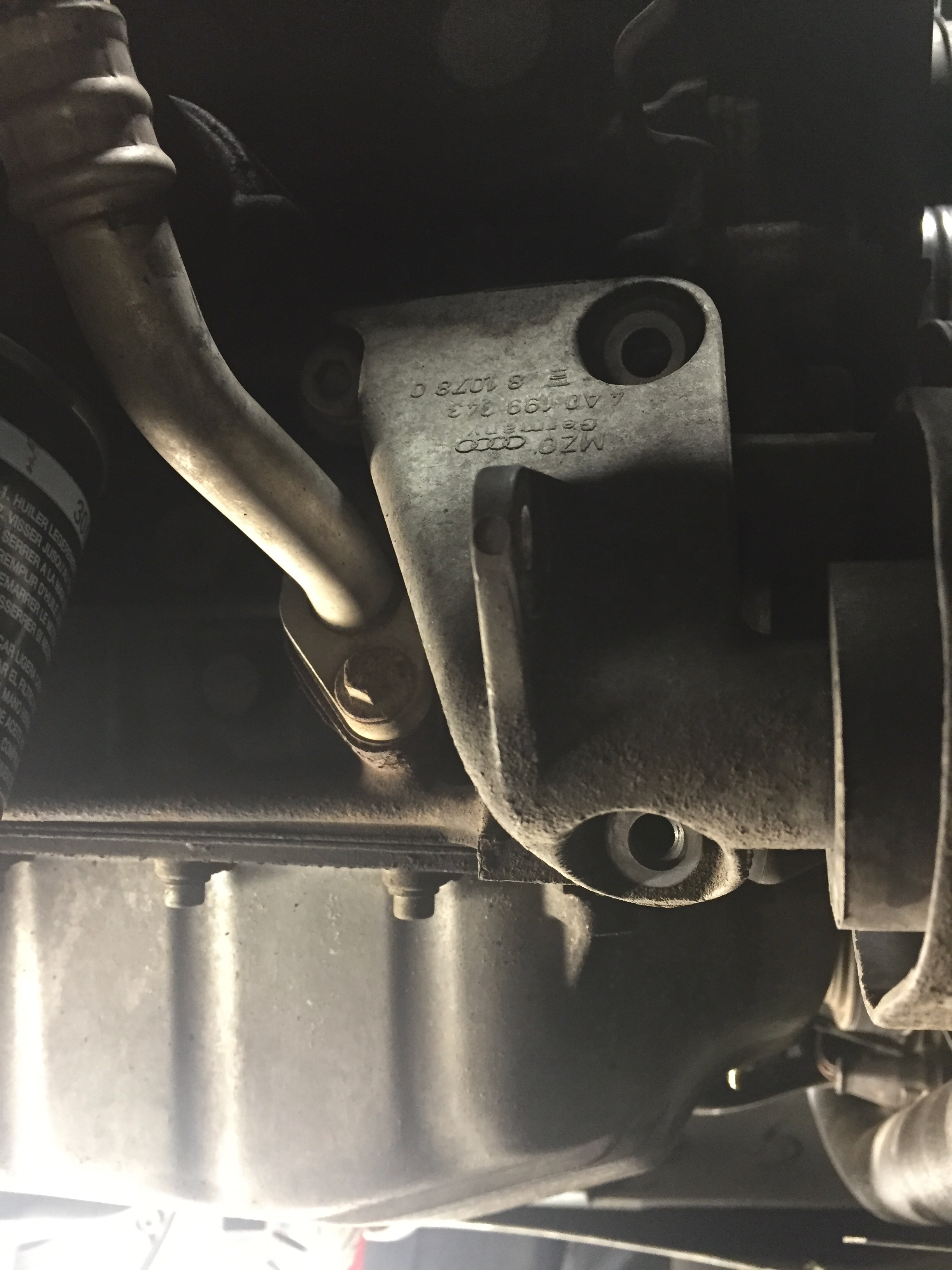

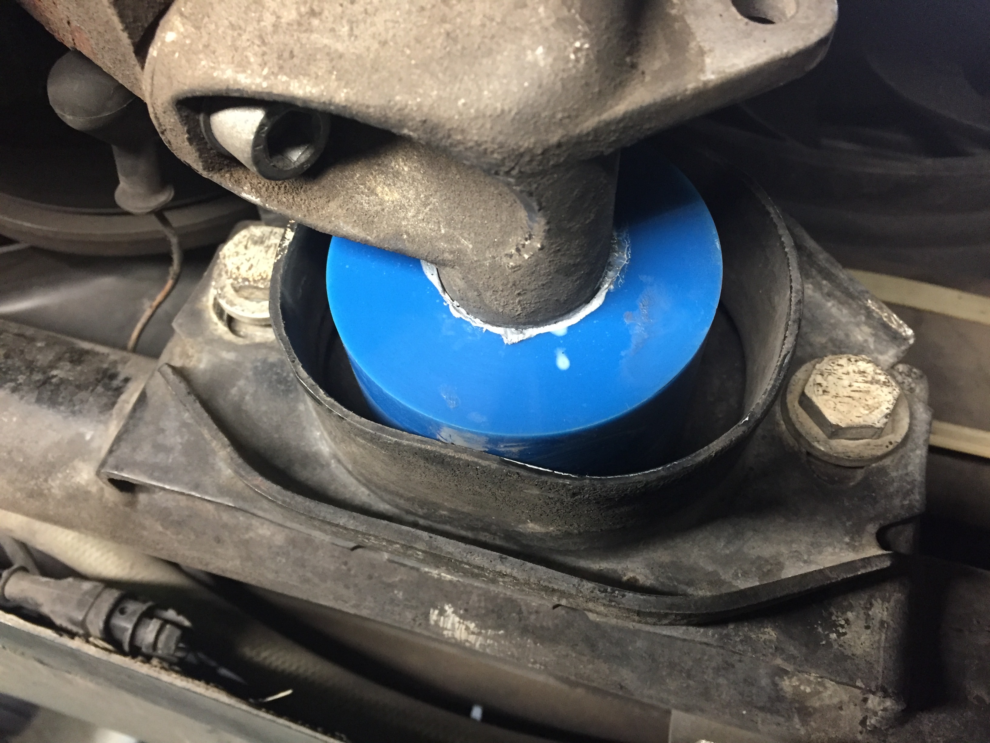

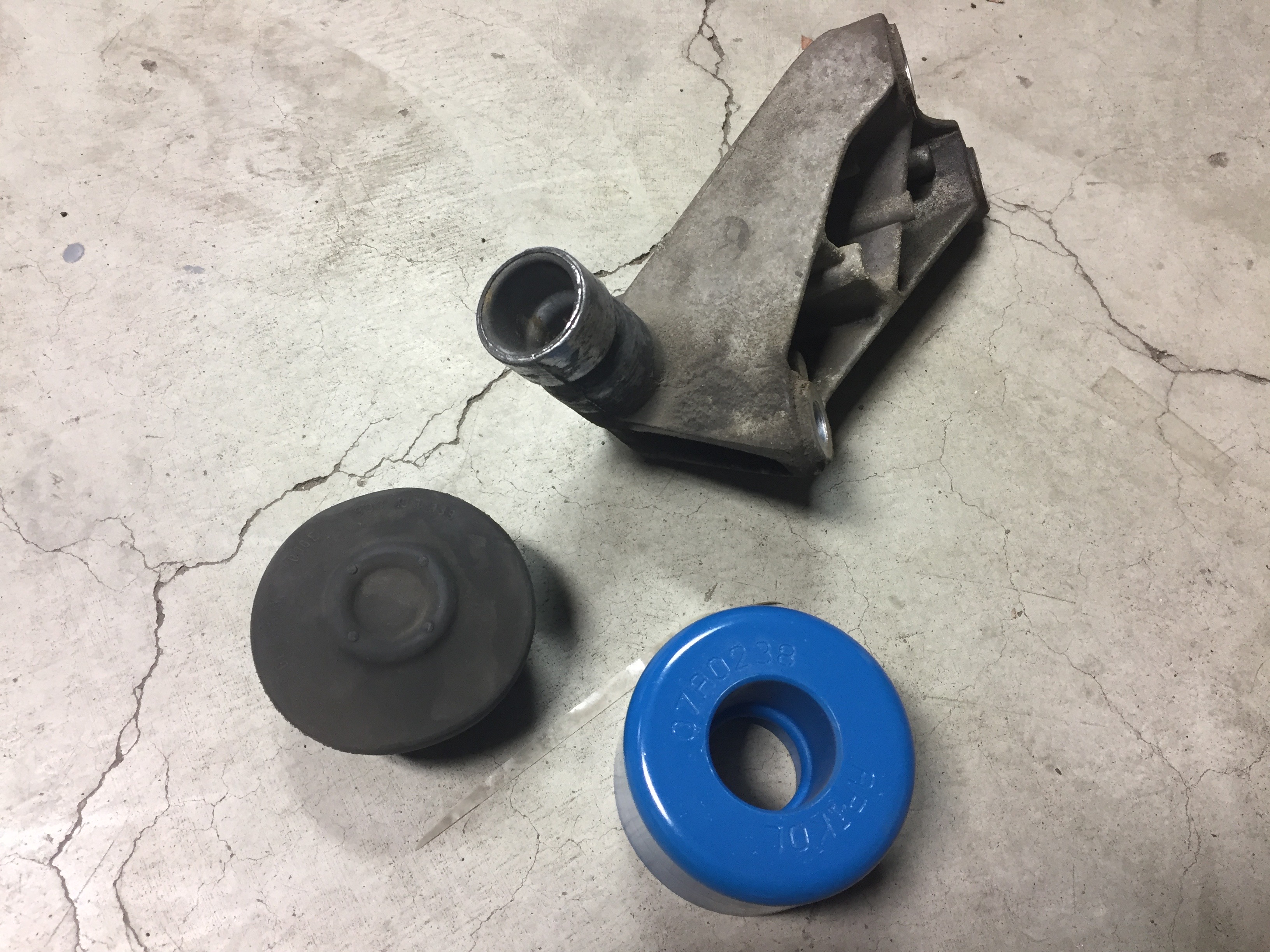

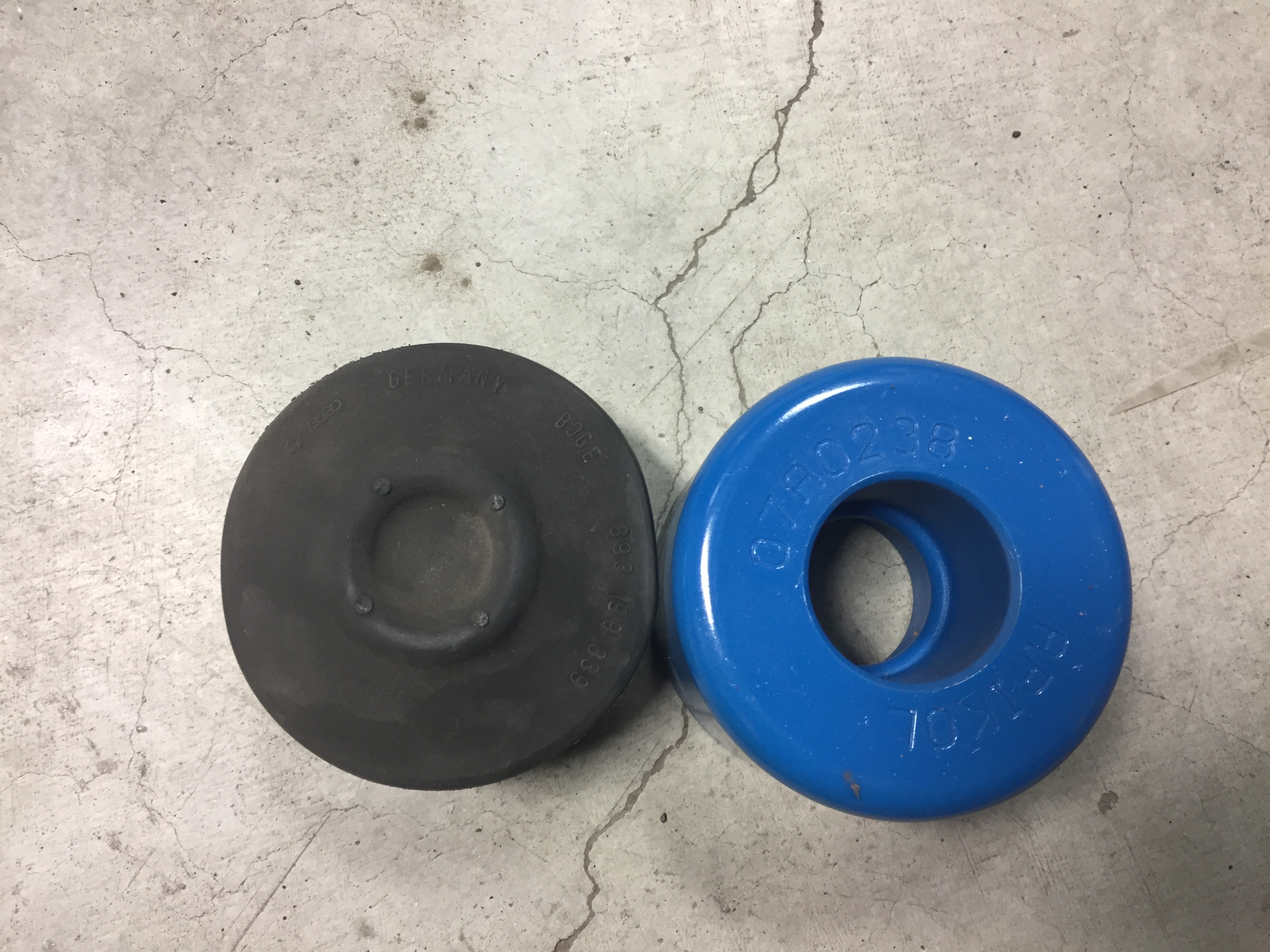

Finally got around to installing my new snub mount. I can't if there is a real difference or not, but I'm sure there is. The old mount wasnt in that bad of shape at all, just wanted to get the blue one in there! Pretty easy to change out. Took three bolts ha.
- IMG_6801.jpg (1.81 MiB) Viewed 115817 times
- IMG_6800.jpg (1.36 MiB) Viewed 115817 times
- IMG_6799.jpg (1.83 MiB) Viewed 115817 times
- IMG_6798.jpg (1.66 MiB) Viewed 115817 times
- IMG_6797.jpg (1.06 MiB) Viewed 115817 times

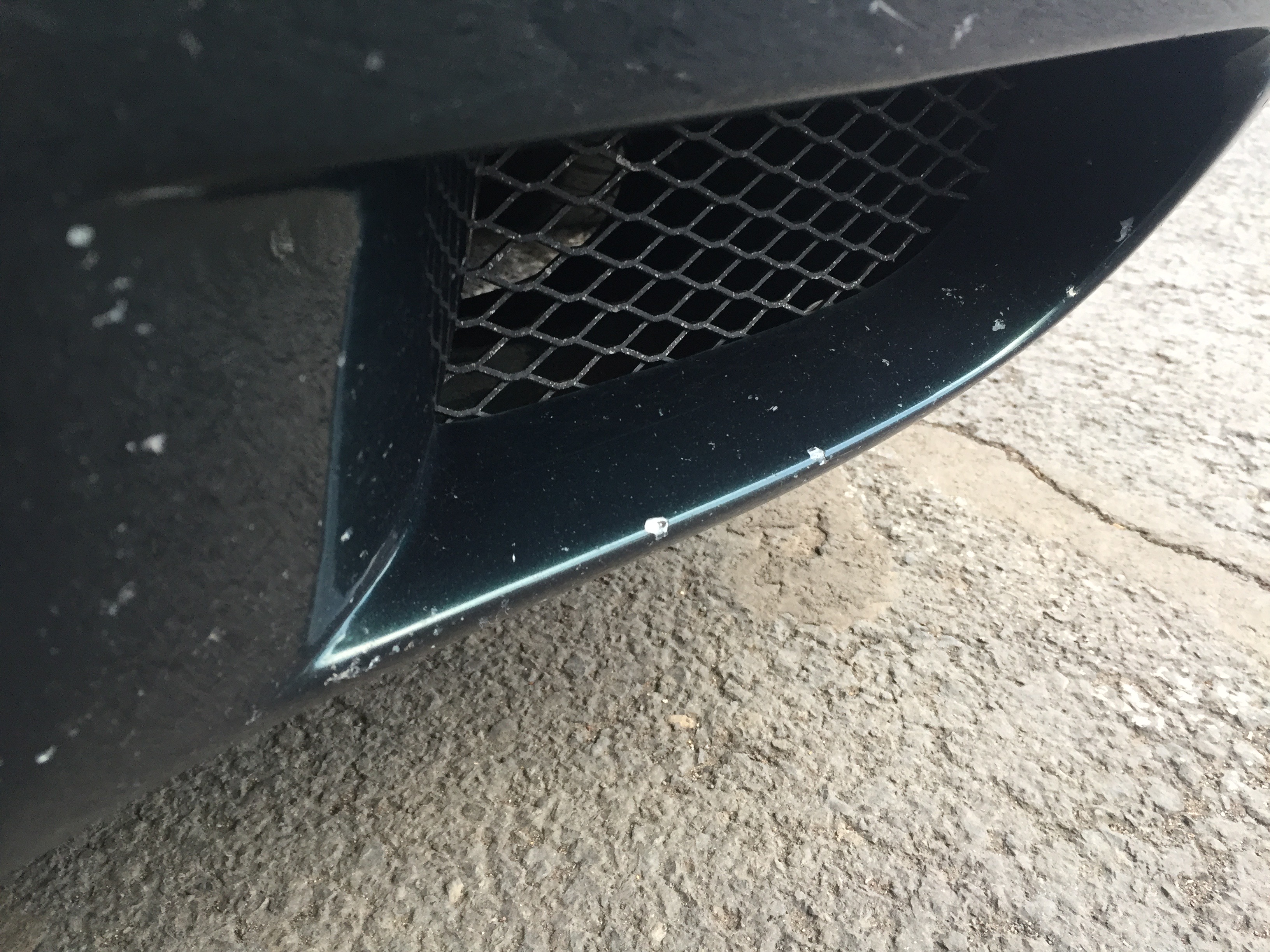

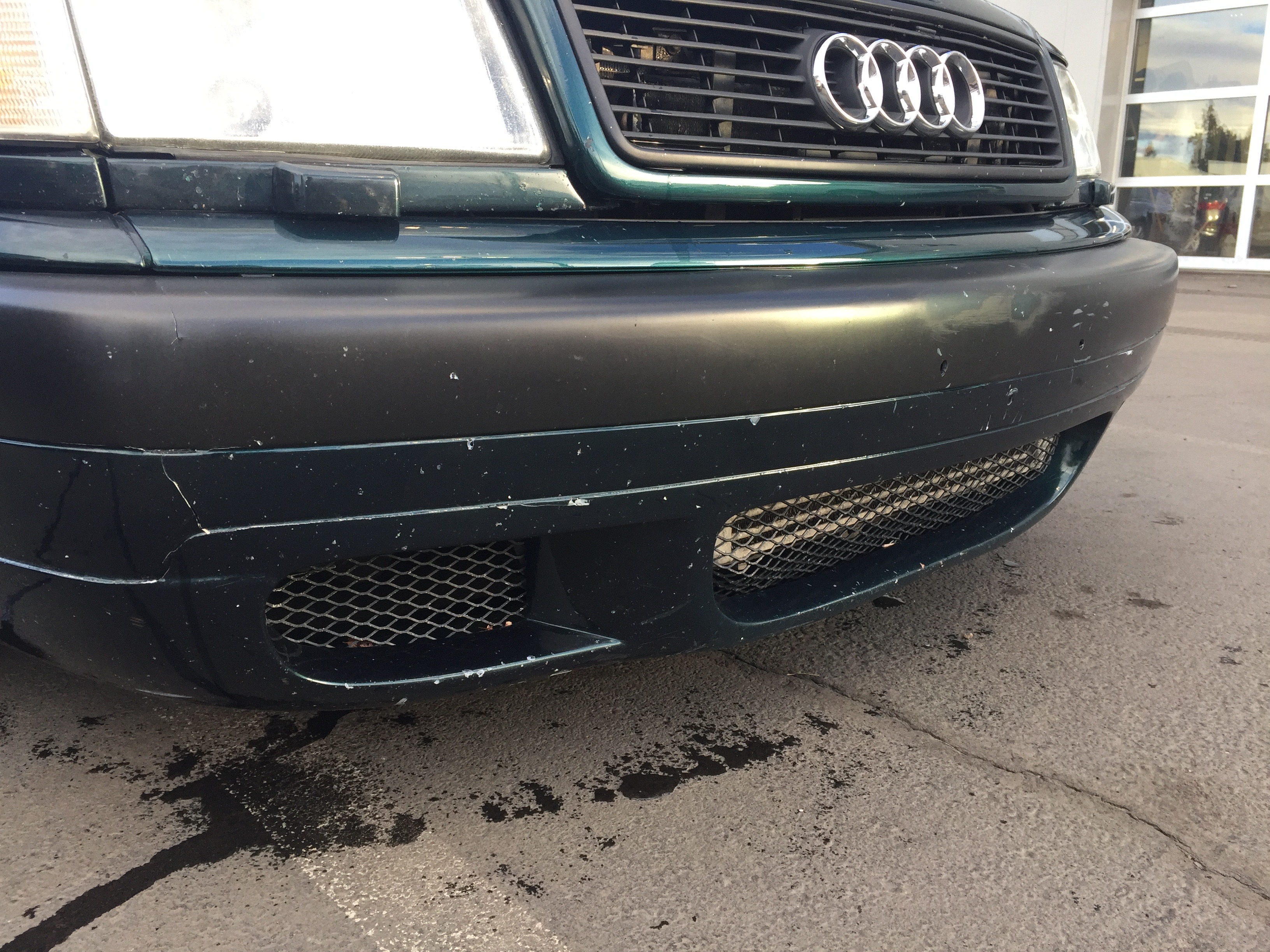

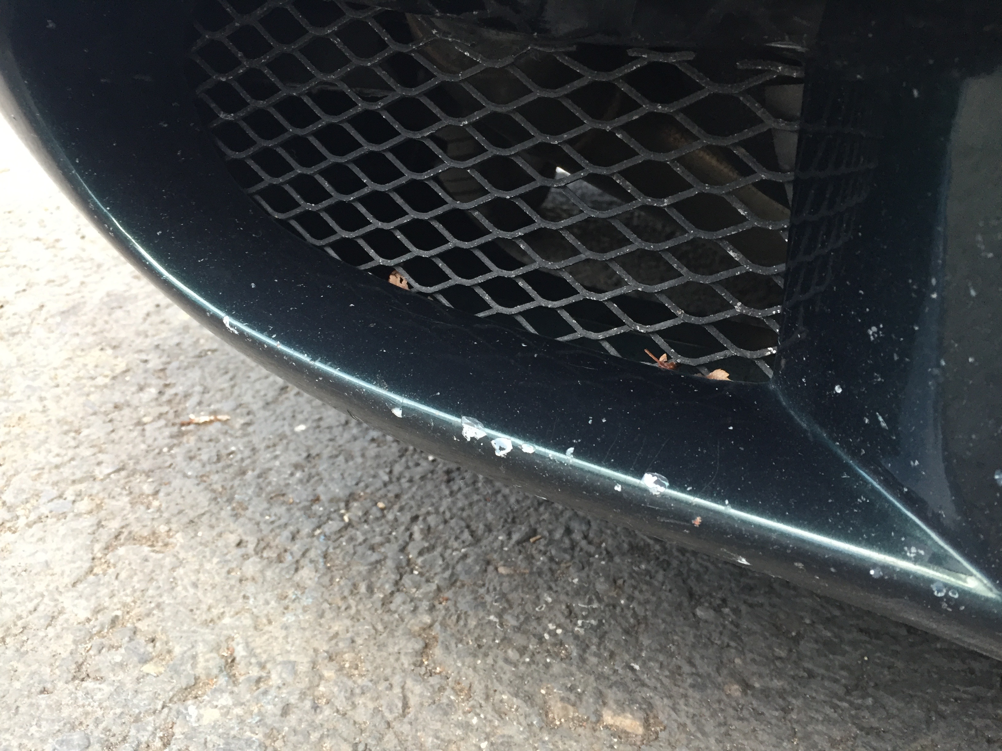

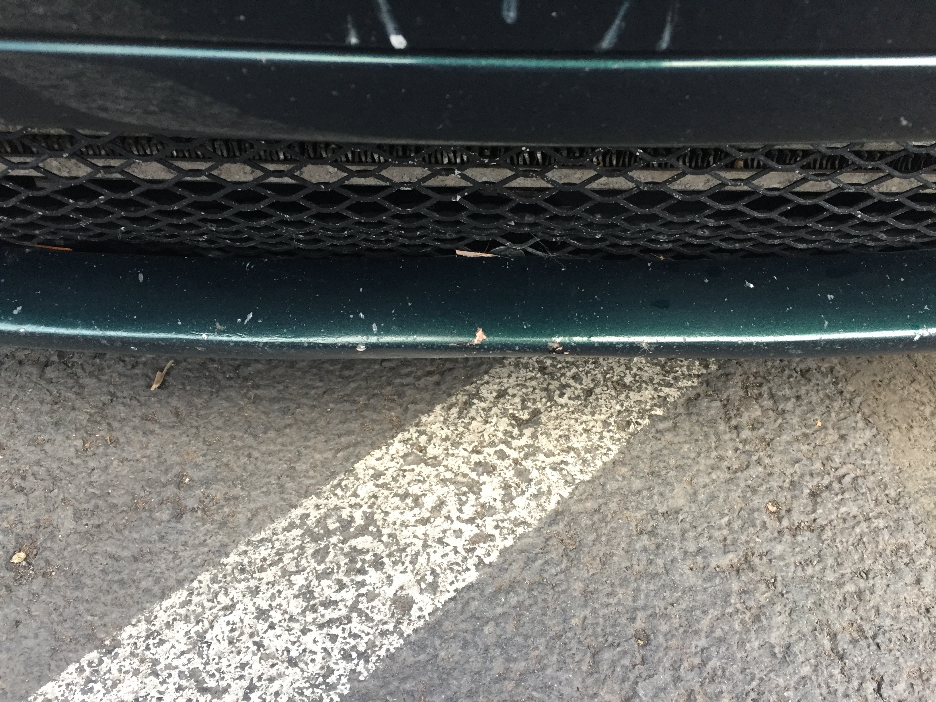

Took a trip and the front of the car got chipped up quite a bit from a gravel truck that started to dump right in front of on me, on dry roads. Made no sense to me, and damaged the paint. The paint wasnt in the best shape to begin with, but the front end was pretty clean.
- And the left
- IMG_6879.jpg (1.72 MiB) Viewed 115592 times
- Right inlet
- IMG_6878.jpg (2.05 MiB) Viewed 115592 times
- Front valance
- IMG_6877.jpg (2.44 MiB) Viewed 115592 times
- All the white!!
- IMG_6874.jpg (2.19 MiB) Viewed 115592 times

Sorry to hear about the gravel, there are few things more frustrating than a truck driver oblivious to his unsecured load.

Man that really sucks. Did you get a license plate number?
One time in my A4 I was driving behind a truck/trailer and a piece of angle iron flew out the trailer, hit my bumper. I chased the guy down and ended up getting almost $2k to cover the repairs from the company he worked for. Was able to massage in a bunch of little touch ups for the price, so it was a win after dealing with all the hassle.
Re: New UrS4
PRY4SNO wrote:Man that really sucks. Did you get a license plate number?
Nah I didn't. I was to worried about the front, and when I backed off I was too far away. When I passed him I was just over it, and wanted to make sure there wasn't and oncoming car. I will do a bit of sanding and get some color match rattle can for a fix until I really want to paint it. I could have followed him or contacted ODOT but it was a mountain pass, and even if they road were dry they probably could have just claimed it was just in case it snowed later and tell me to pound sand. Im not sure if he knew he was laying down gravel or not, but I'm 99% positive that he stopped for a short stretch and then laid it back down, who knows. Although it bothers me, I really like the idea of old sleeper Audi's so it kinda just adds to the car. Just need to up the power a bit(;

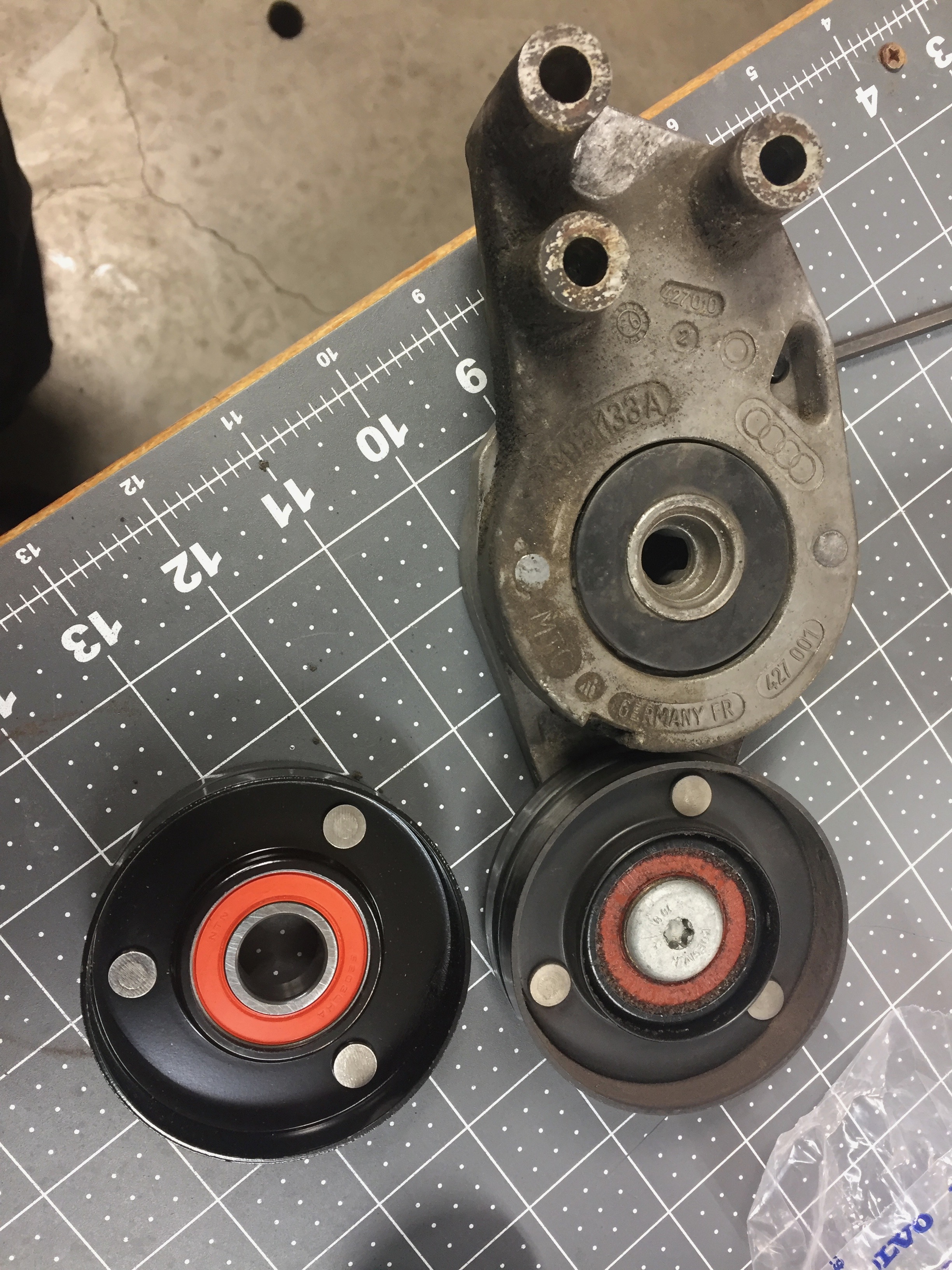

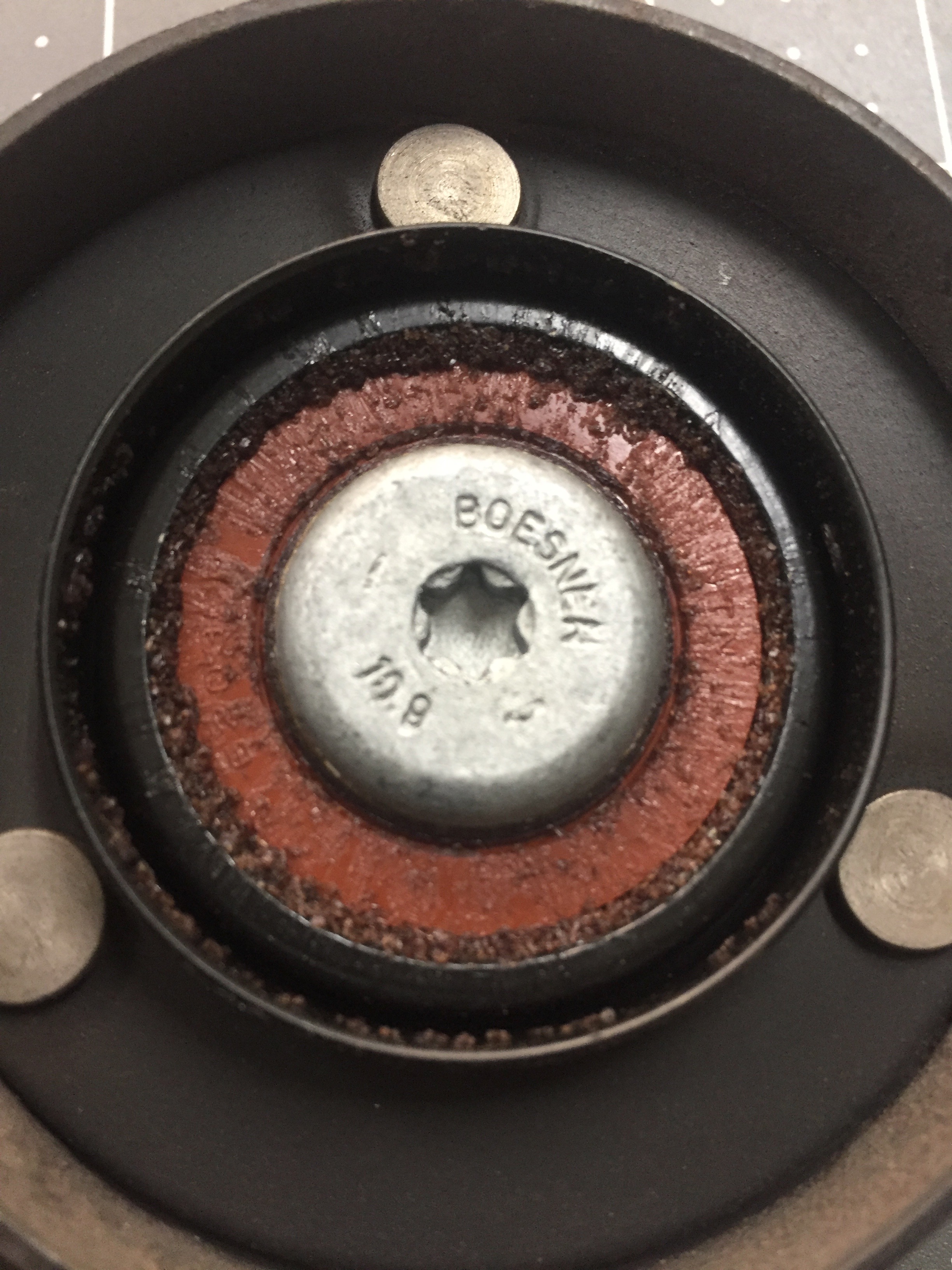

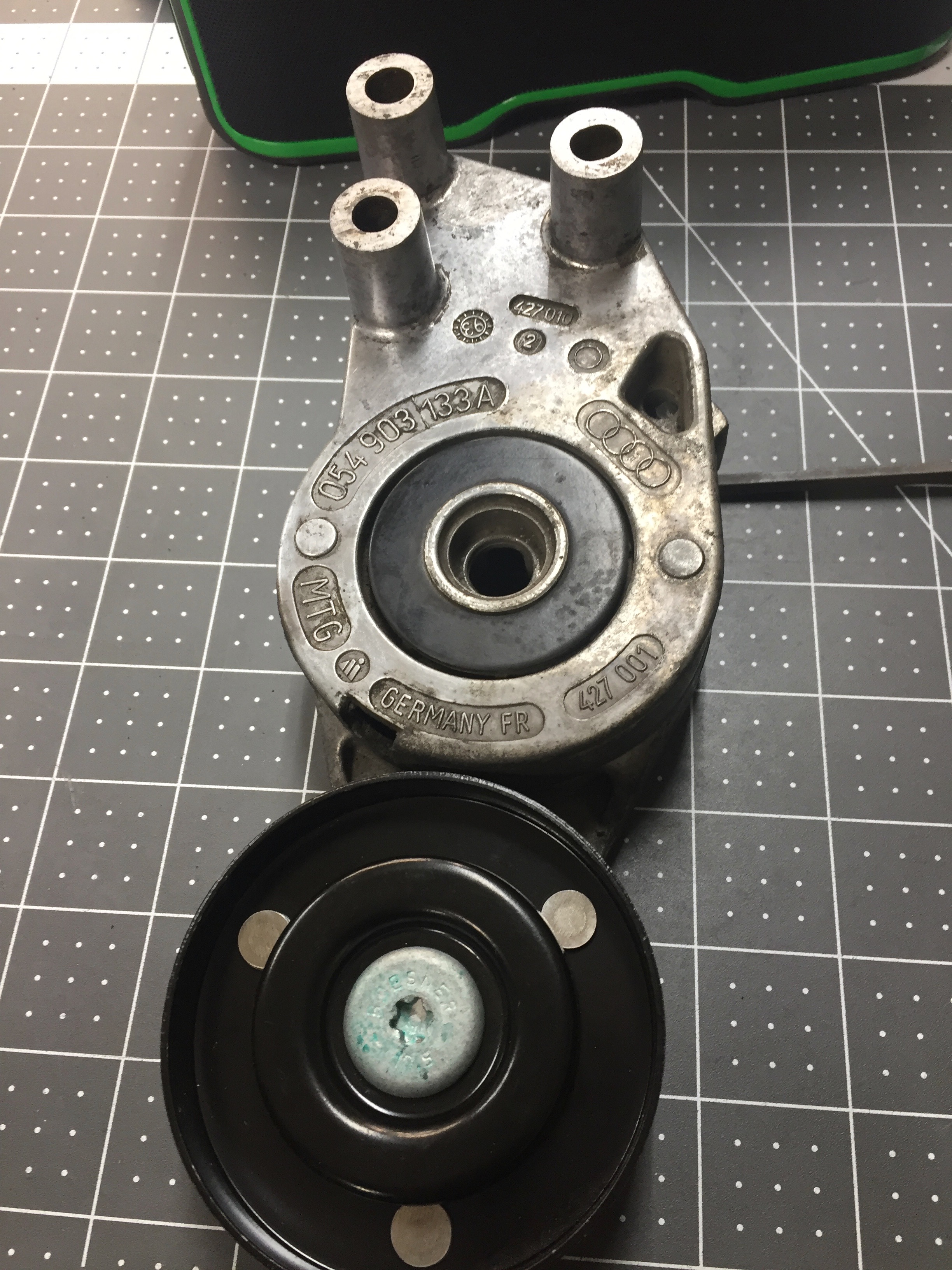

Last weekend I got a few small things done. Thanks to a couple guys on MG and here I now have a proper function horn and I successfully replaced my drive belt tensioner pulley. Found some write ups with good info and part numbers, and I went with the Volvo pulley. Couldn't get the bolt out, and I was afraid I was going to strip it with hand tools. Called a buddy of mine and less then half a second with and impact, the old one was off. A quick clean and the new one was back in. The car still makes a bit of noise so I'm thinking the water pump.
In a couple weekends I will be installing my Wagner EVO RS ex. manifold. Any tips and tricks to help with that one? I'm going to soak with penetrating oil every night, starting a week in advanced. Also probably going to to some 034 motor mounts while I'm in there. Are the density line mounts good stuff? Another brand that is maybe better? Anything else I should take care of while that side of the engine is clear? Thanks for the help with everything so far! Ill be sure to take pictures.
- Cleaned up w/ new pulley.
- IMG_7003.jpg (1.72 MiB) Viewed 115276 times
- New pulley next to the old.
- IMG_6998.jpg (1.84 MiB) Viewed 115276 times

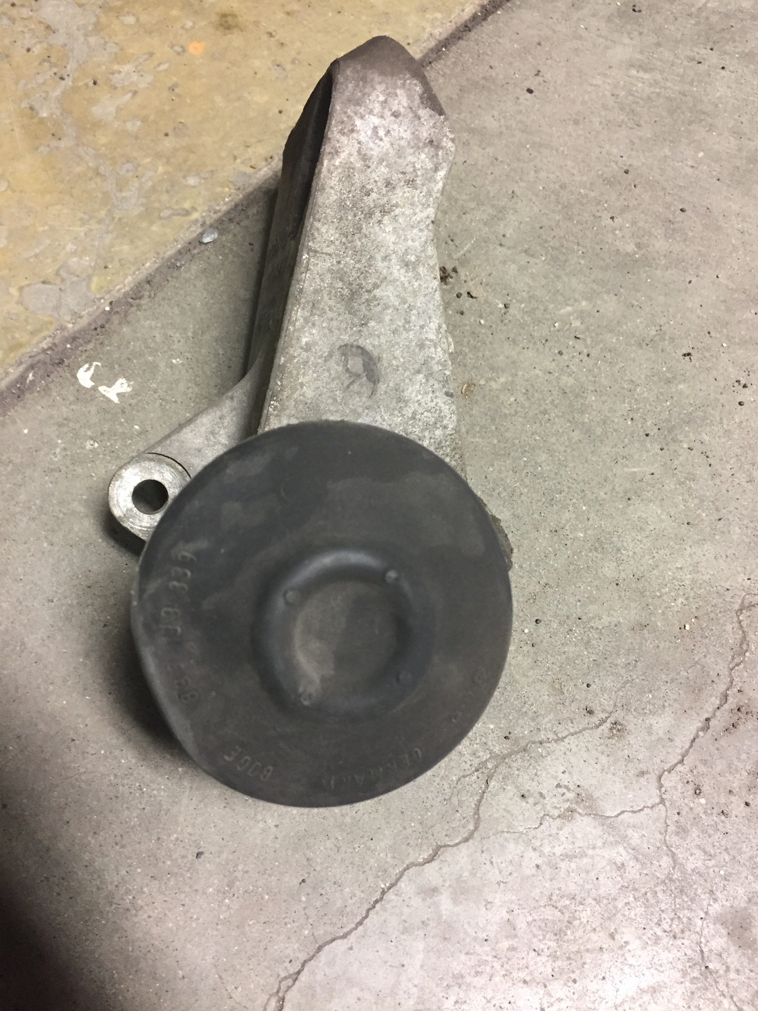

Re: TCombs UrS4
I'd opt for HPR mounts instead of the 034 ones. Higher quality design that will last longer, work better, and you're supporting a small company that still cares about the older cars. PM Jared (Angry Taco on here) for more info, or via his website:
http://hershperformance.com/index.html

TCombs wrote:Last weekend I got a few small things done. Thanks to a couple guys on MG and here I now have a proper function horn and I successfully replaced my drive belt tensioner pulley. Found some write ups with good info and part numbers, and I went with the Volvo pulley. Couldn't get the bolt out, and I was afraid I was going to strip it with hand tools. Called a buddy of mine and less then half a second with and impact, the old one was off. A quick clean and the new one was back in. The car still makes a bit of noise so I'm thinking the water pump.
I did the same swap with the volvo pulley and also had a stubborn bolt. I couldn't even get it to budge with an impact, so I grabbed my torch and put flame on it for a minute or so. Once hot, it zipped out like was finger loose.

I'll vouch for Jared's products. I have HPR engine and tranny mounts and couldn't be happier with the quality and fit of them. Been running both for a couple thousand km's and they definitely have helped with reducing drivetrain slop. Bonus is that if we keep supporting him, he'll be more willing to make more parts for us C4 folks!PRY4SNO wrote:I'd opt for HPR mounts instead of the 034 ones. Higher quality design that will last longer, work better, and you're supporting a small company that still cares about the older cars. PM Jared (Angry Taco on here) for more info, or via his website:

Re: TCombs UrS4
Awesome info, ha looks like I will go with the HPR mounts then. What durameter are you guys running? I was thinking 70A? The car has some performance upgrades on it (i.e. exhuast, FMIC, manual boost con.) just supporting mods really.IslandRinger wrote:I'll vouch for Jared's products. I have HPR engine and tranny mounts and couldn't be happier with the quality and fit of them. Been running both for a couple thousand km's and they definitely have helped with reducing drivetrain slop. Bonus is that if we keep supporting him, he'll be more willing to make more parts for us C4 folks!PRY4SNO wrote:I'd opt for HPR mounts instead of the 034 ones. Higher quality design that will last longer, work better, and you're supporting a small company that still cares about the older cars. PM Jared (Angry Taco on here) for more info, or via his website:
Thanks for the input, glad I ask about different brands.
Anything while I'm in there, that you guys can think of?

Re: TCombs UrS4
I used 70A as I'm going for an OEM+ feel. No plans on tracking the car for me. If anything, spirited driving at most. As mentioned before, feels much more solid and loses any slop without creating too much NVH.TCombs wrote:Awesome info, ha looks like I will go with the HPR mounts then. What durameter are you guys running? I was thinking 70A? The car has some performance upgrades on it (i.e. exhuast, FMIC, manual boost con.) just supporting mods really.IslandRinger wrote:I'll vouch for Jared's products. I have HPR engine and tranny mounts and couldn't be happier with the quality and fit of them. Been running both for a couple thousand km's and they definitely have helped with reducing drivetrain slop. Bonus is that if we keep supporting him, he'll be more willing to make more parts for us C4 folks!PRY4SNO wrote:I'd opt for HPR mounts instead of the 034 ones. Higher quality design that will last longer, work better, and you're supporting a small company that still cares about the older cars. PM Jared (Angry Taco on here) for more info, or via his website:
I may recommend a Poly Snub Mount. Got mine from Apikol but can be had from AK Motorsports and perhaps 034(?). I added my components while doing a suspension rebuild so there was a whole lot of "while-you're-in-there."
Not sure how far you want to go. Easiest access to the PS engine mount is by removing the airbox. Good time to replace your air filter if it's been a while. Not hard while installed but doesn't get easier than this. O2 sensor is another candidate perhaps. My last piece of advice is to not forget the little metal heat shield that sits on top of the PS engine mount. It may look like a random piece of metal on top of the OEM mount but it's there for a reason.

Re: TCombs UrS4
That’s what I was thinking as well. You guys have convinced me. I have the snub mount. Thought I posted it up a few threads back. I went with the Apikol. Kinda like the look of the blue bushings. I have looked up the post on how to install the manifolds and I have to take out the air box anyway.
I’ll keep in mind that heat shield. Thanks for the info. I didn’t know if there was anything else I should do while the air box, ex manifold and the turbo were out of the car.
I have been trying to convince some Audi technicians from the dealership to help me, and I think they are on board.

Re: TCombs UrS4
You'll be happy with your purchase!TCombs wrote:That’s what I was thinking as well. You guys have convinced me. I have the snub mount. Thought I posted it up a few threads back. I went with the Apikol. Kinda like the look of the blue bushings. I have looked up the post on how to install the manifolds and I have to take out the air box anyway.
Missed the Apikol snub part. Looking forward to some updated posts when you get them in!

Re: TCombs UrS4
A good buddy of mine who has help me quite a bit brought up the noise I was having and we believe it is my Viscous Clutch Fan Bearing. I am wondering if any one know what all do I need to replace? Can i just pull it and replace the bearing or do I need to buy a whole new bracket? Do I need the old style with the ears, or the new style without the ears? I have read the post on QW about it, but its not to clear what all I need to do, or maybe its just me. If someone could point me in the right direction that would be very helpful.
